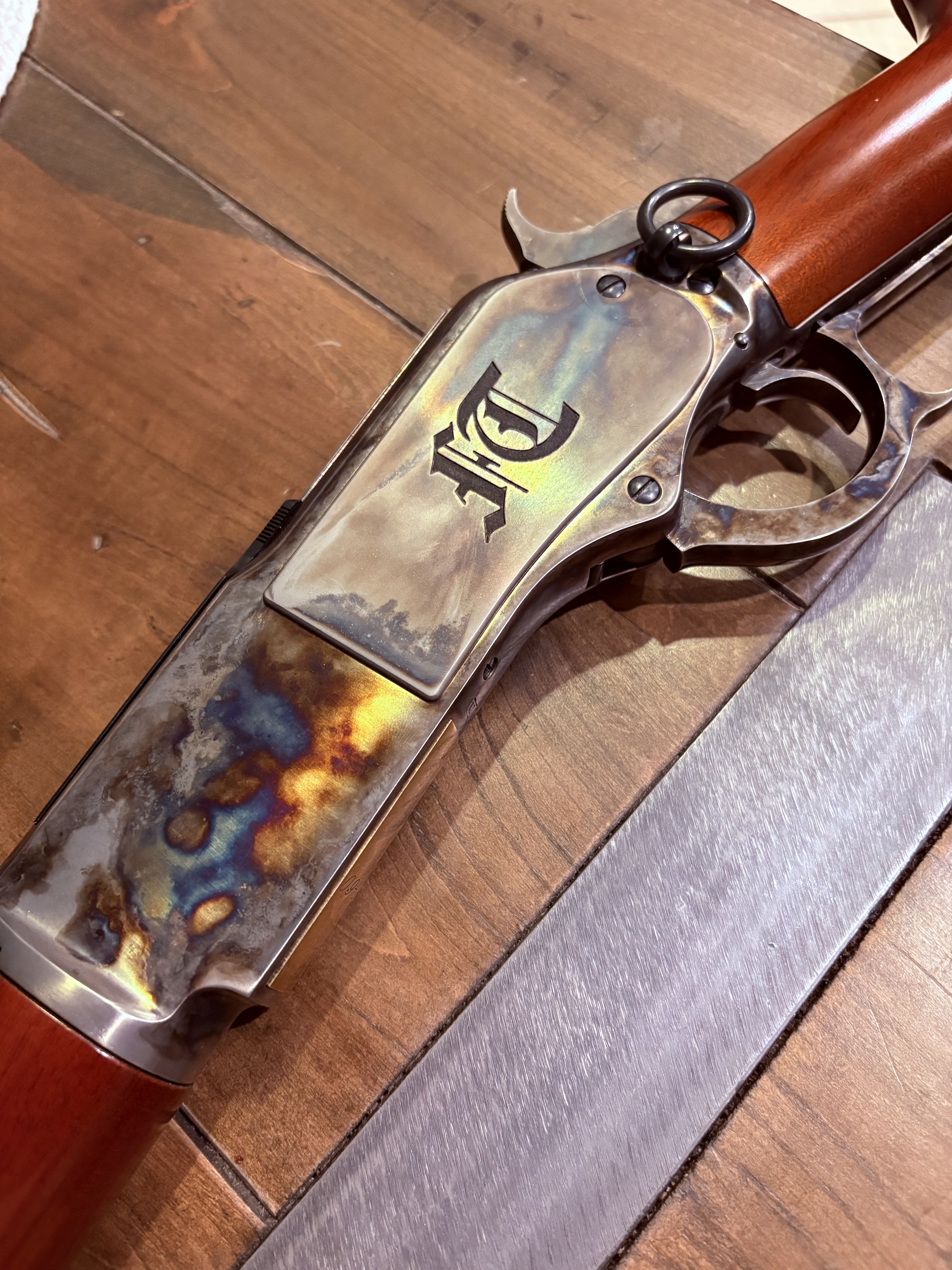

Last update, I wanted the engraving to stand out just a bit and not look so fresh and I have zero patience to wait for normal patina from aging to happen. So I ordered some 44/40 bluing cream from Brownells (the stuff is AMAZING) and carefully applied a thin brushing of it to the engraved area with a water color brush. Blotted it out in about a minute, quick rub with an oily rag and done. The whole process took about 5 minutes. I think it came out ok. I certainly like it.

Posted: Thu Aug 28, 2025 3:31 am
That brought it out nice!
Cool it came out that well, especially as an afterthought.

PFD45 wrote: ↑Thu Aug 28, 2025 3:31 am That brought it out nice!
Thanks! I’m rather pleased with the results.

Posted: Thu Aug 28, 2025 4:26 pm
That is SIGNIFICANTLY better.
As lasered engraving looks fine on some things. It did not look right on that rifle.
The blue job fixed it.

Wambli Ska wrote: ↑Thu Aug 28, 2025 3:25 am Last update, I wanted the engraving to stand out just a bit and not look so fresh and I have zero patience to wait for normal patina from aging to happen. So I ordered some 44/40 bluing cream from Brownells (the stuff is AMAZING) and carefully applied a thin brushing of it to the engraved area with a water color brush. Blotted it out in about a minute, quick rub with an oily rag and done. The whole process took about 5 minutes. I think it came out ok. I certainly like it.
The blueing is the icing on the cake for that well executed engraving. Great work!

CPJ 2.0 wrote: ↑Thu Aug 28, 2025 4:26 pm That is SIGNIFICANTLY better.
I liked it from the beginning but it did need "something". I do agree it looks better once I darkened it a bit. Thanks
