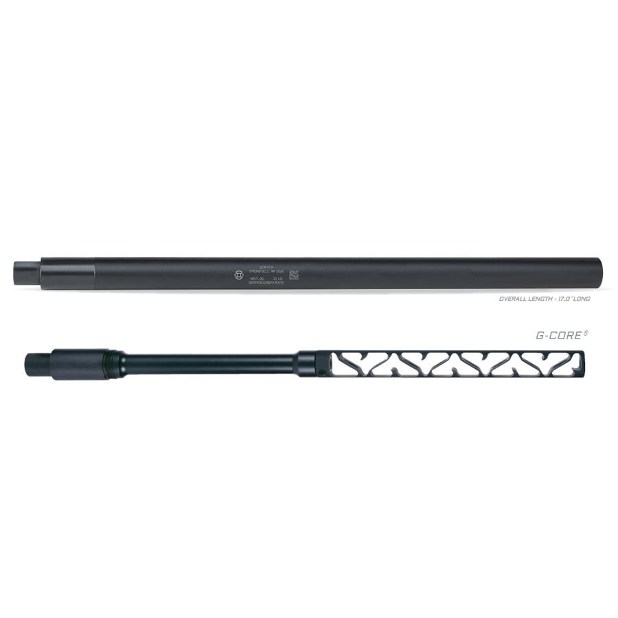

I was just about to pull the trigger on a charger for a full time Jeep gun but damn this guy with an RDS and a small can might be the way to go!!! If there’s no $200 pay to play, why not cut the barrel to 12” and build a shroud type suppressor over the barrel?
You have skills………. and machines 😈
Re: New .22.
Posted: Sun Aug 31, 2025 10:39 pm
Wambli Ska wrote: Sun Aug 31, 2025 9:39 pm I was just about to pull the trigger on a charger for a full time Jeep gun but damn this guy with an RDS and a small can might be the way to go!!! If there’s no $200 pay to play, why not cut the barrel to 12” and build a shroud type suppressor over the barrel?
Someone already has. 😬
Re: New .22.
Posted: Sun Aug 31, 2025 10:51 pm
Yeah that but more like the Gemtech
