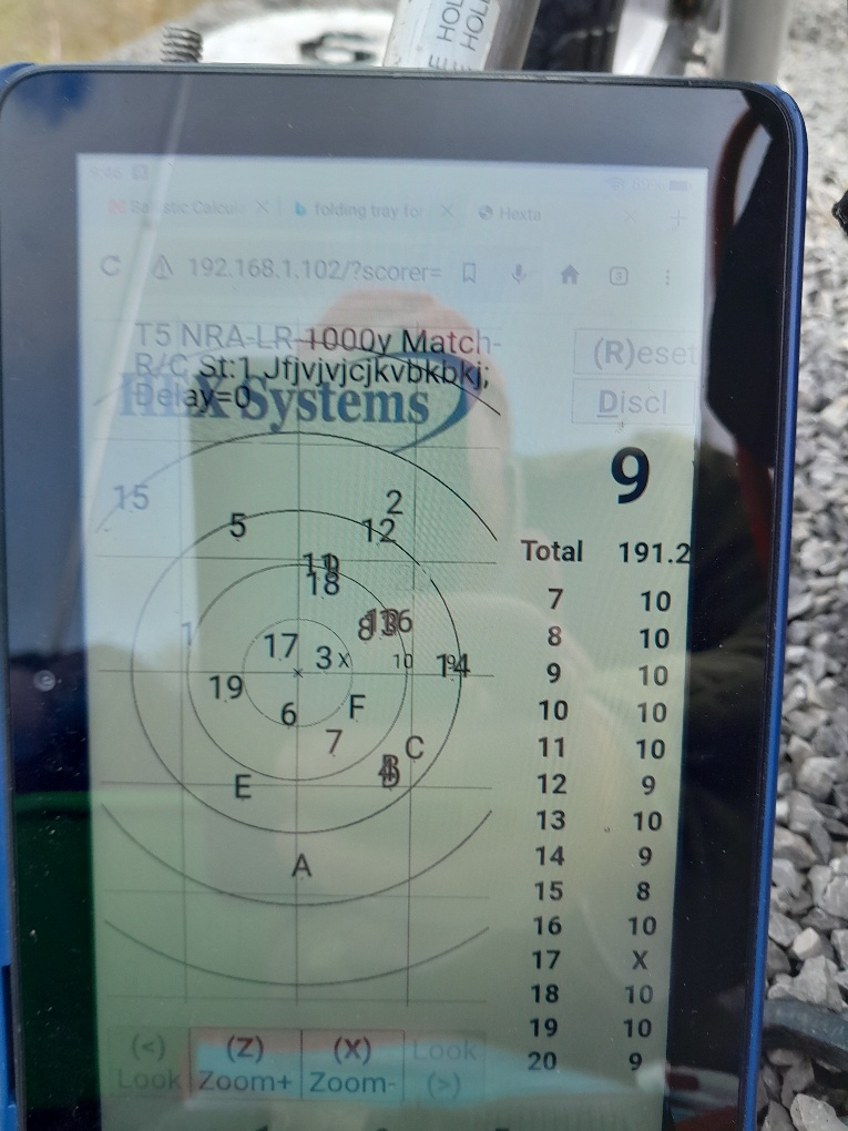

6.5x55SE; 28" bbl; Rem700 LA; 142gr SMK over N165; 15 shot string 2921fps avg; SD @14.5; verified 24 MOA drop at 1k w/200 zero. Hanging right next to 6.5 284's and 6mms.

Out there, I'd like t get really comfortable with the rifle/chambering combo out to 500+ yards because I doubt I'll ever take a shot at game at much past 300-400 MAYBE max. So for many folks here that's not much of challenge shooting wise, for me it's a stretch since I grew up hunting in the 75-200 yard club all my adult life, and I'm still becoming comfortable with shooting the longer distances. To 300 yards I don't break a sweat but anyone can do that.
I do have a 6.5 Gibbs, and I even have a few hundred cases properly headtstamped. From what I've read forming brass is a PIA and I still have not ordered the custom dies I need for it since, well, I keep forgetting I own the damn thing. It is a beautiful custom, I have to decide what it's place in my life is after I get around to really playing with it. It was a purchase of opportunity without much thought except, hey, I really like this gun.

The MV with the 6.5 isnt why the 6.5 is interesting. The sectional density of the bullet of the bullet carries better down range, meaning it will stay stable and supersonic farther out than most in a reasonable package.
Posts: 535
Re: Someone talk to me about 6.5 cartridges that fit…
Wambli Ska wrote: ↑Sat Sep 20, 2025 7:55 pm Out there, I'd like t get really comfortable with the rifle/chambering combo out to 500+ yards because I doubt I'll ever take a shot at game at much past 300-400 MAYBE max. So for many folks here that's not much of challenge shooting wise, for me it's a stretch since I grew up hunting in the 75-200 yard club all my adult life, and I'm still becoming comfortable with shooting the longer distances. To 300 yards I don't break a sweat but anyone can do that.
Ok, so nothing you listed wont do that wont do that well. If you are going to play in wind, again, I would hang with 139-140-142gr bullets. Stick a heavier bbl on it in a decent stock. I think you will find that the real difference going out to a mid range 500 ish is more with wind, and if it isnt all that fooky, the 6.5 will still behave.
Once you get it built, put a sling on it and look for a mid range competition. :) You will find out how it shoots at 600.
