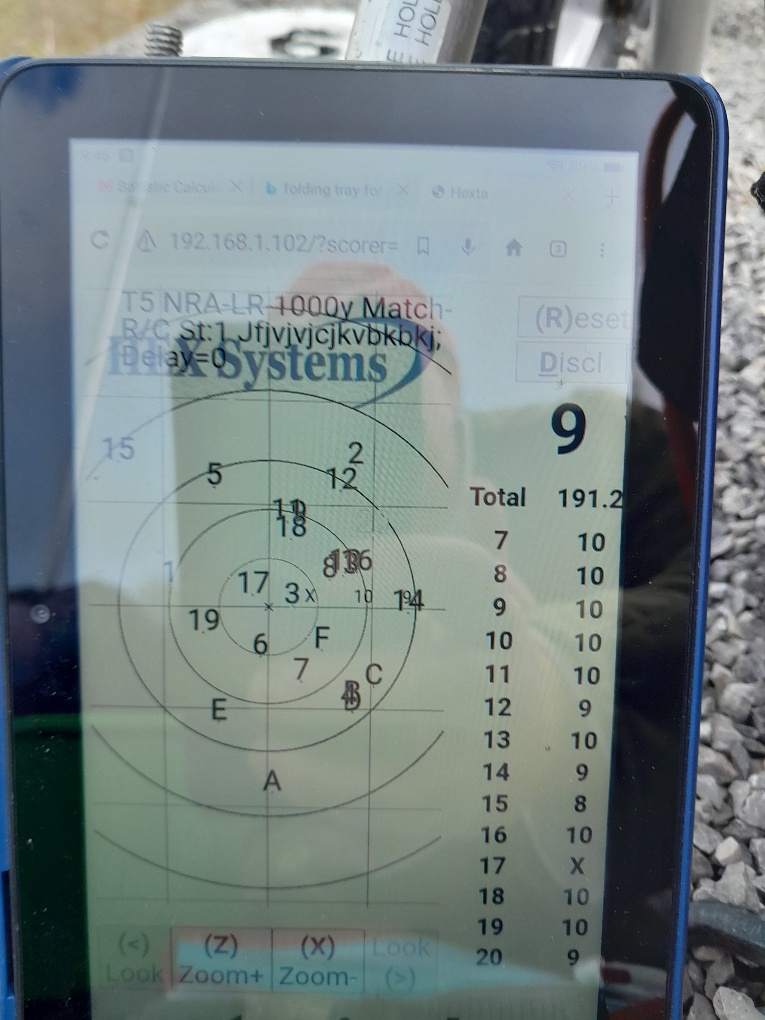

Wambli Ska wrote: ↑Sat Sep 20, 2025 7:55 pm Out there, I'd like t get really comfortable with the rifle/chambering combo out to 500+ yards because I doubt I'll ever take a shot at game at much past 300-400 MAYBE max. So for many folks here that's not much of challenge shooting wise, for me it's a stretch since I grew up hunting in the 75-200 yard club all my adult life, and I'm still becoming comfortable with shooting the longer distances. To 300 yards I don't break a sweat but anyone can do that.
Ok, so nothing you listed wont do that wont do that well. If you are going to play in wind, again, I would hang with 139-140-142gr bullets. Stick a heavier bbl on it in a decent stock. I think you will find that the real difference going out to a mid range 500 ish is more with wind, and if it isnt all that fooky, the 6.5 will still behave.
Once you get it built, put a sling on it and look for a mid range competition. :) You will find out how it shoots at 600.

Buddy of mine has a 6.5x55 Shielen comp bbl 1:9.5. Bought from Midway, had installed by the guy by the guy who built mine. Cloverleafs at 100 with 123 gr SST in a hunting rifle.
