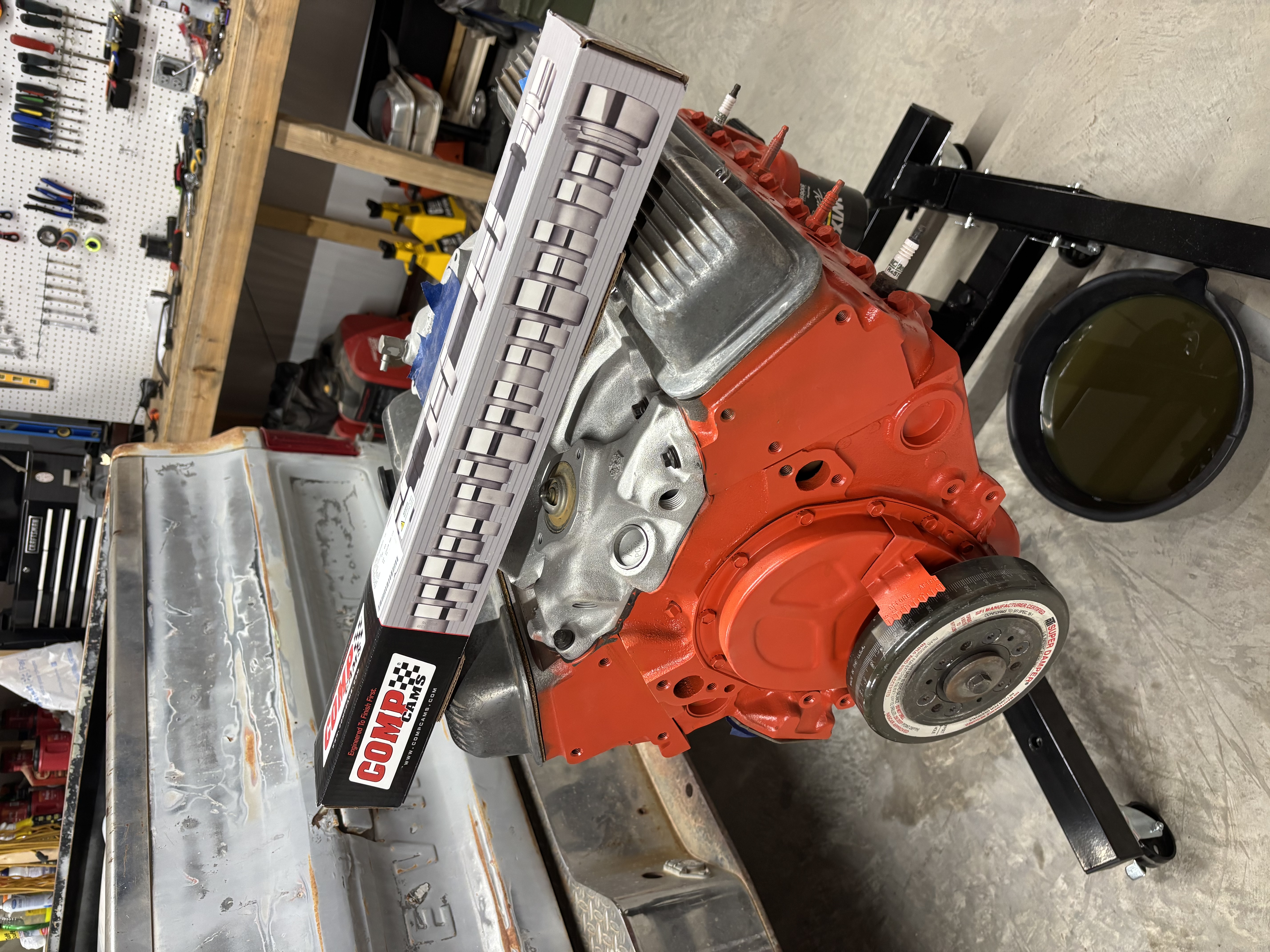

With flat tappet cams, there’s a trend of lifter failure, wiping cam lobes out and destroying the engine. Seems to boil down to 3 things. Metallurgy, oil and break in. Cam and lifter metallurgy has gone down hill. Most common off the shelf oils don’t have zddp additives needed for proper flat tappet break in and use. A good break in oil is needed. Then follow a good break in procedure. Usually something like 30 minutes at 2000 rpm, varying rpm throughout to get oil splash on the cam and lifters.
I’m trying tech. Bought a nitrided cam and “DLC” lifters. Basically a very slick and very hard carbon coating. It wasn’t cheap. But still cheaper than a roller cam setup.

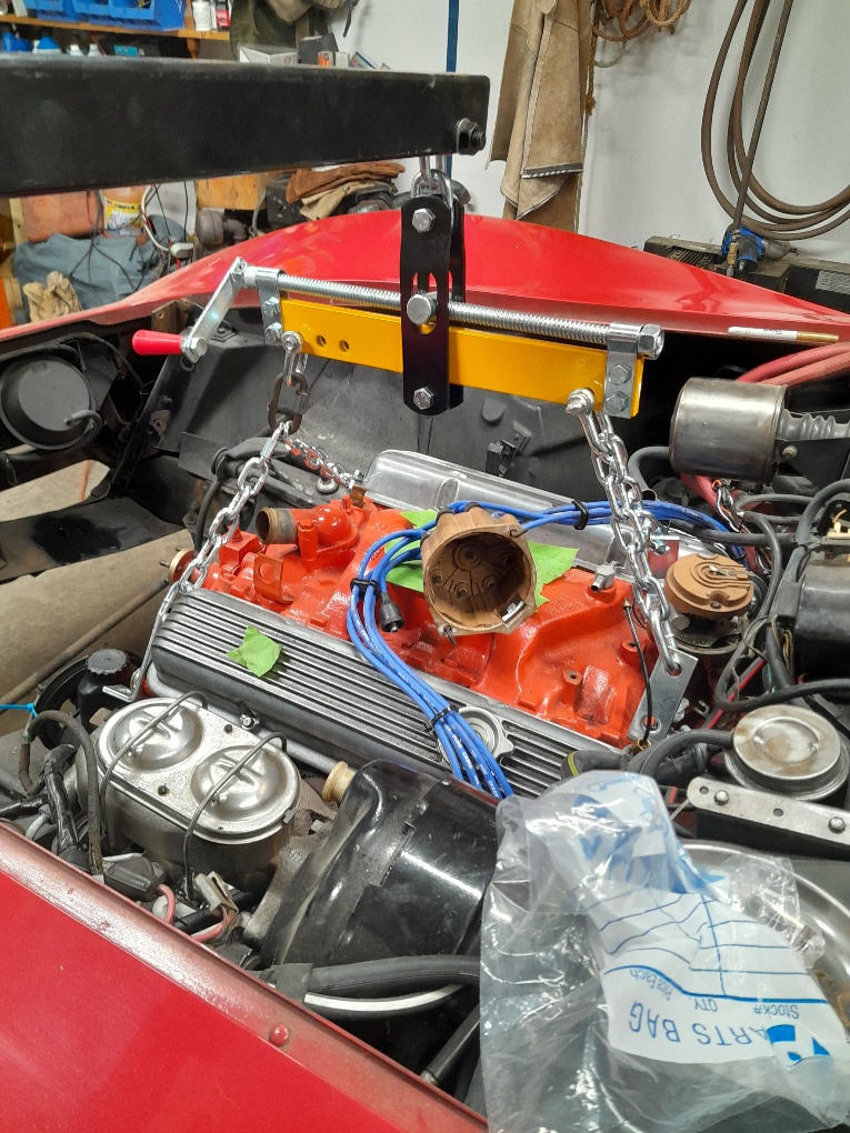

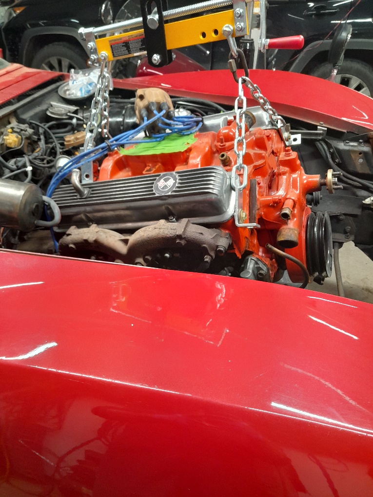

Ok, got into it after lunch again
Pwr steering off, right side pipe, starter out, fuel lines, pipe u bolts. alternator.
Little coffee break and figure out next thing.

I’d be curious to know the casting number on those heads when you get a valve cover off.

That motor looks nice and clean. It’s obviously been apart before. At least the intake manifold has been off. Something with that kind of age, seems logical.

Jay wrote: ↑Tue Nov 25, 2025 3:49 am That motor looks nice and clean.
It’s gots then double hump heads. Probably a 3/4 race cam. Most likely the front tire can clear a Coke can at launch.

CPJ 2.0 wrote: ↑Tue Nov 25, 2025 3:51 am
Yeah. That’s what made me curious about the casting numbers. There are multiple different casting numbers for the “camel hump” heads.
That motor looks very clean and somebody has been into it before. The crank pulley bolt has overspray on it and the intake was installed with RTV on the china wall instead of the rubber china wall gaskets, which should always immediately go in the trash can. Kinda makes me wonder how much freshening up that motor needs. 🤷🏻‍♂️

Cam swap.

Looked like a little leaking at the front china wall. Obviously can’t see much more. Very well could be a rattle can rebuild. And JBOhio brings up a great point. It’s pretty likely it had hardened exhaust valve seats put in at some point.
Rotella works. It’s what I put in the old motor in my C10, just to play with it. If doing a new cam and lifters, I’d probably go with a dedicated break in oil. Or at least conventional oil with a break in additive. Flat tappet cams aren’t what they used to be. They’re going flat at a pretty dumb rate. Mobil has their Classic line of oil that has the ZDDP additives in it for operational use. I still personally wouldn’t use that for cam break in. But strongly considering running it after break in. I’ll use Comp Cams break in oil to break in my cam. Even with the nitrided cam lobes and DLC lifters.

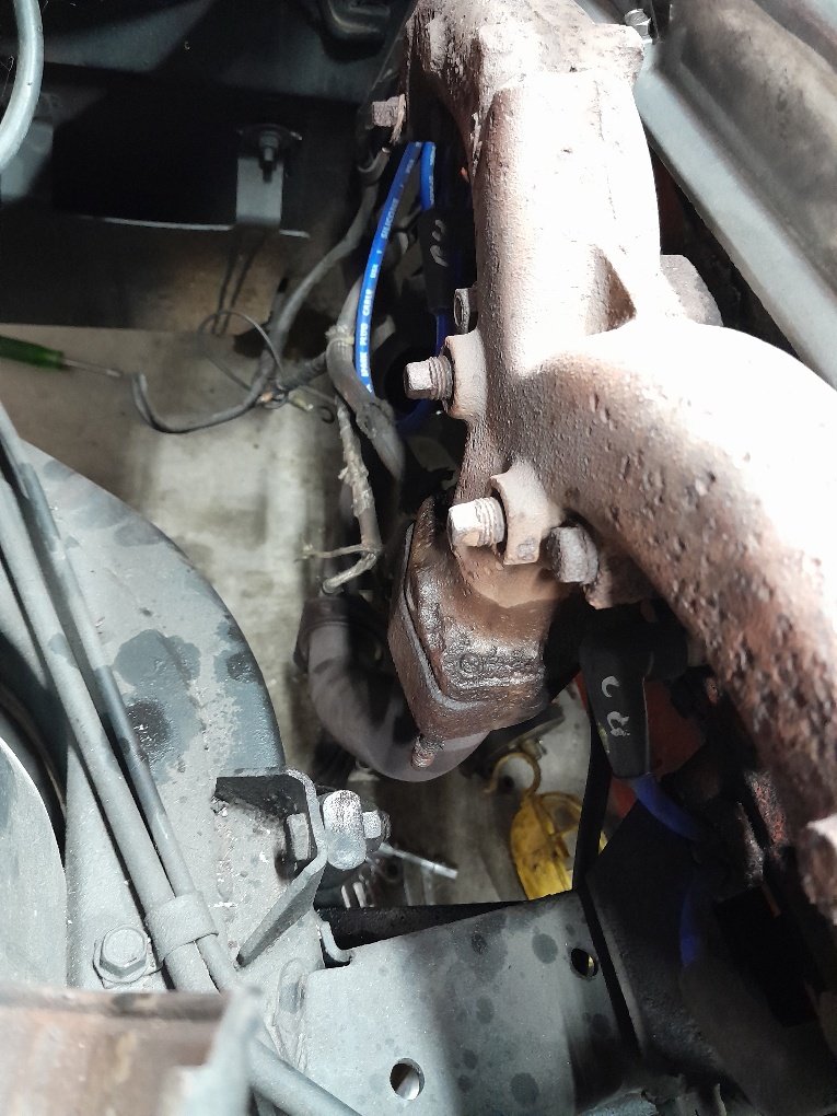

Just a bit more.
Pulled the carb and some more wires and vac off, dropped the left pipe off the manifold, then stared at the transmission for a while.

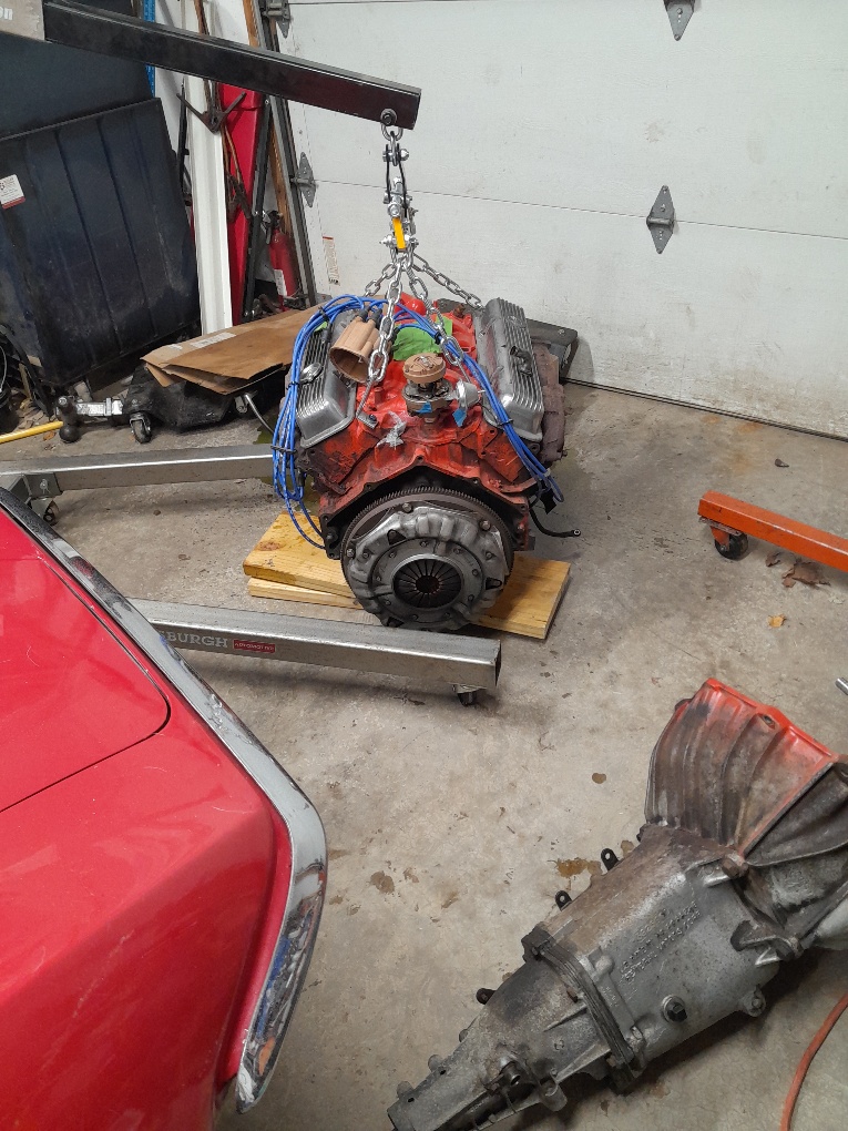

Ok, t day, family toys for tots and MCL presentations later..............
Driveshaft is off, all the transmission linkage, wires cables, got some fresh grade 8's and connected the crane and pulled the engine mount bolts, still need to pull a couple on the trans

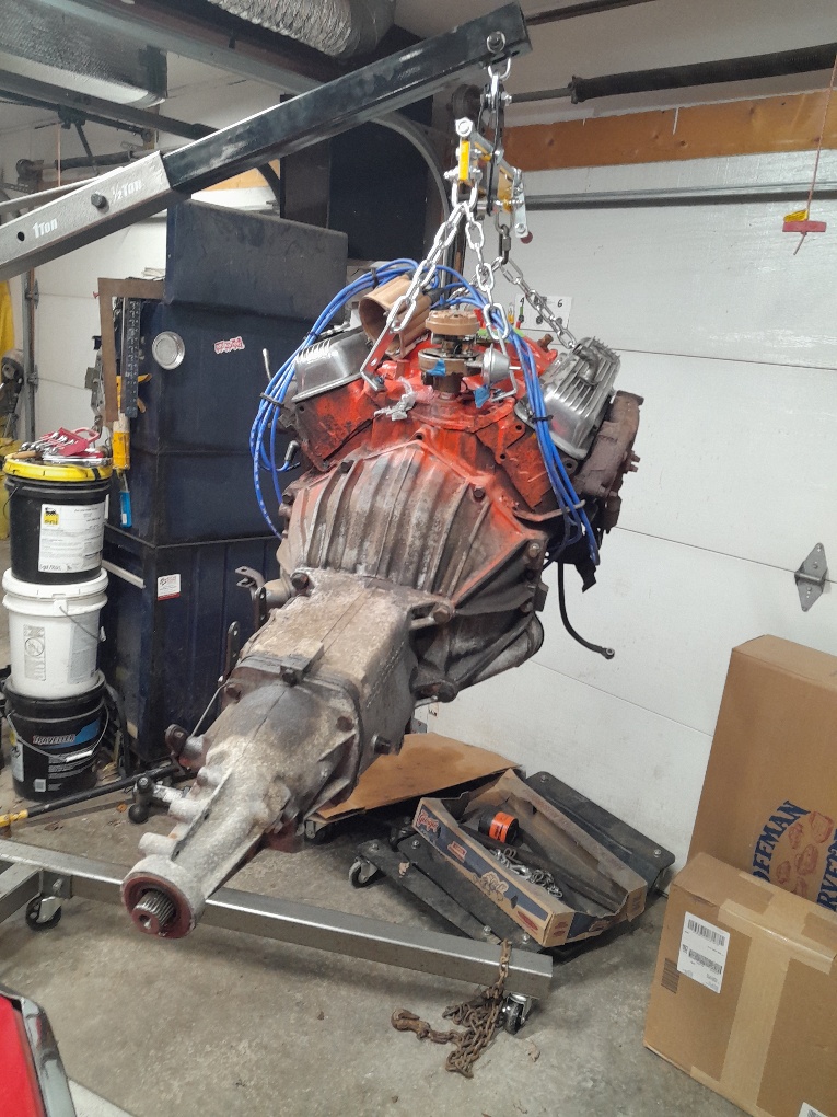

Posts: 531
Re: Engine refresh
Worked out this AM. Put the coveralls on, jacked the transmission and pulled 8 bolts from the transmission mount and heat shield, and away we went. Only had one thing still fastened so I did OK with merely slight blood loss. Getting a call from the rebuild shop in an hour. I know my limitations.
