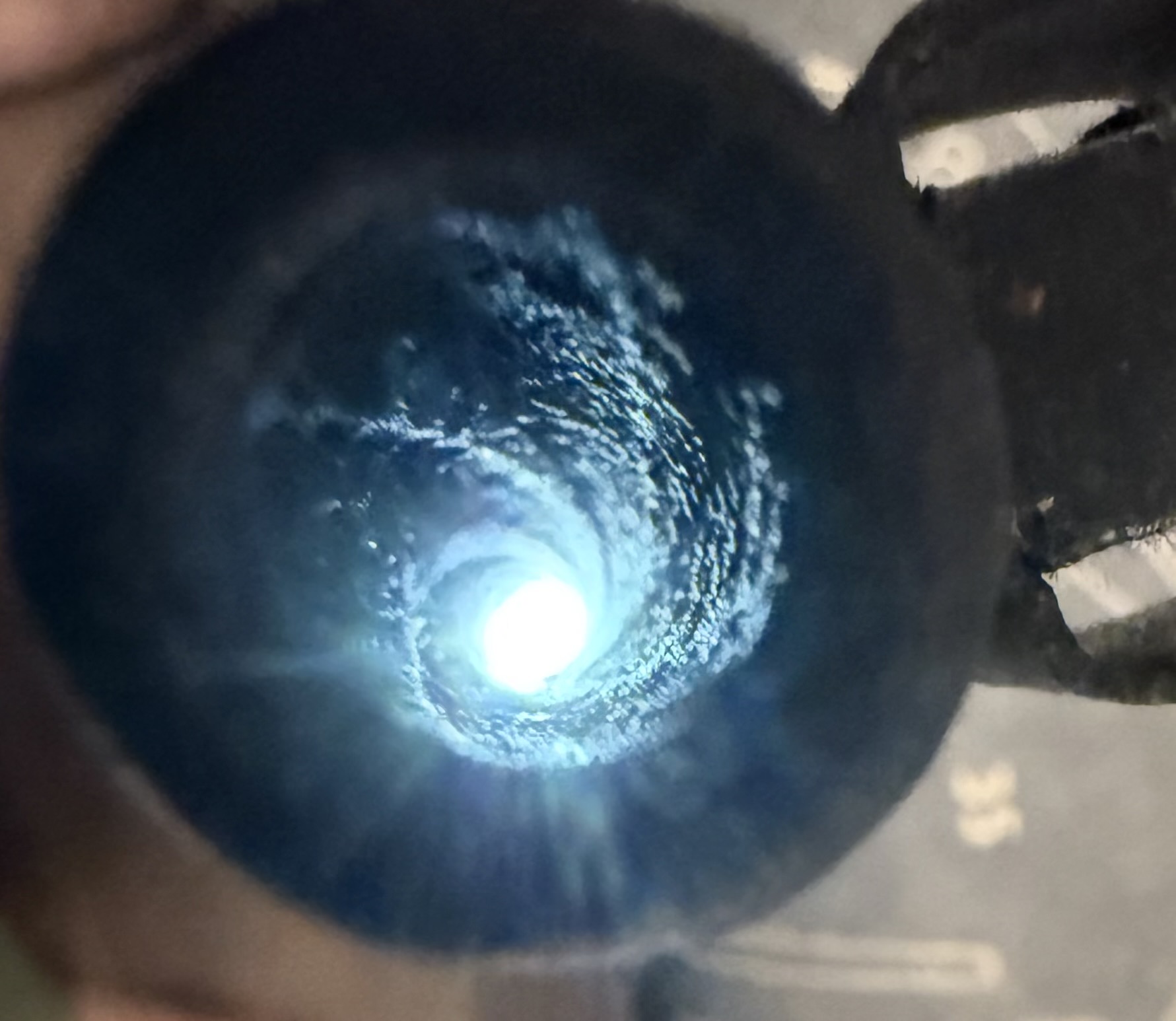

Wambli Ska wrote: ↑Tue Dec 09, 2025 7:18 pm
Zee wrote: ↑Tue Dec 09, 2025 5:12 pm That bore looks like a train wreck!!! Hope is not corroded.
I think that’s just packing grease and hopefully will just punch out with the first pass through the bore.
Well so much for my hoping… 🤣

I bought an Enfield years ago, N1 MkIII that had a bore like that after cleaning. I actually shot decent after a few shots. Don't give up hope yet.

Ouch!! Be happy if the bullets on target aren’t sideways.

Green Mountain and rebarrel that sucker?
$100 and Bob’s your Uncle!

I've gotten a few of those over the years. Wrap a bore brush you don't care about with coarse steel wool (hey you have nothing to lose) soak in solvent and punch through the barrel back and forth a bunch of times. Keep doing it until no more junk comes out of the bore. I alternate between copper solvent and carbon solvent. The rifling looks like it's still strong so there is a chance it will shoot.

I had to do that with my 7x57 Mauser. Original barrel was toast. Looked like a poorly done asphalt road. Bullets hit sideways. Got a green mountain barrel, she’s a dream now. While not original, it was a relatively cheap fix to use the action and sporterized stock. For a salvage plan.

Somebody long before you made that barrel junk. No sense wasting time, effort or money on it. The bore determines the condition of the rifle. If the bore is bad, it doesn’t matter what the rest of the rifle is, at that price point. That’s an action with junk currently attached to it. New barrel, stock and trigger. Go from there. 8-)

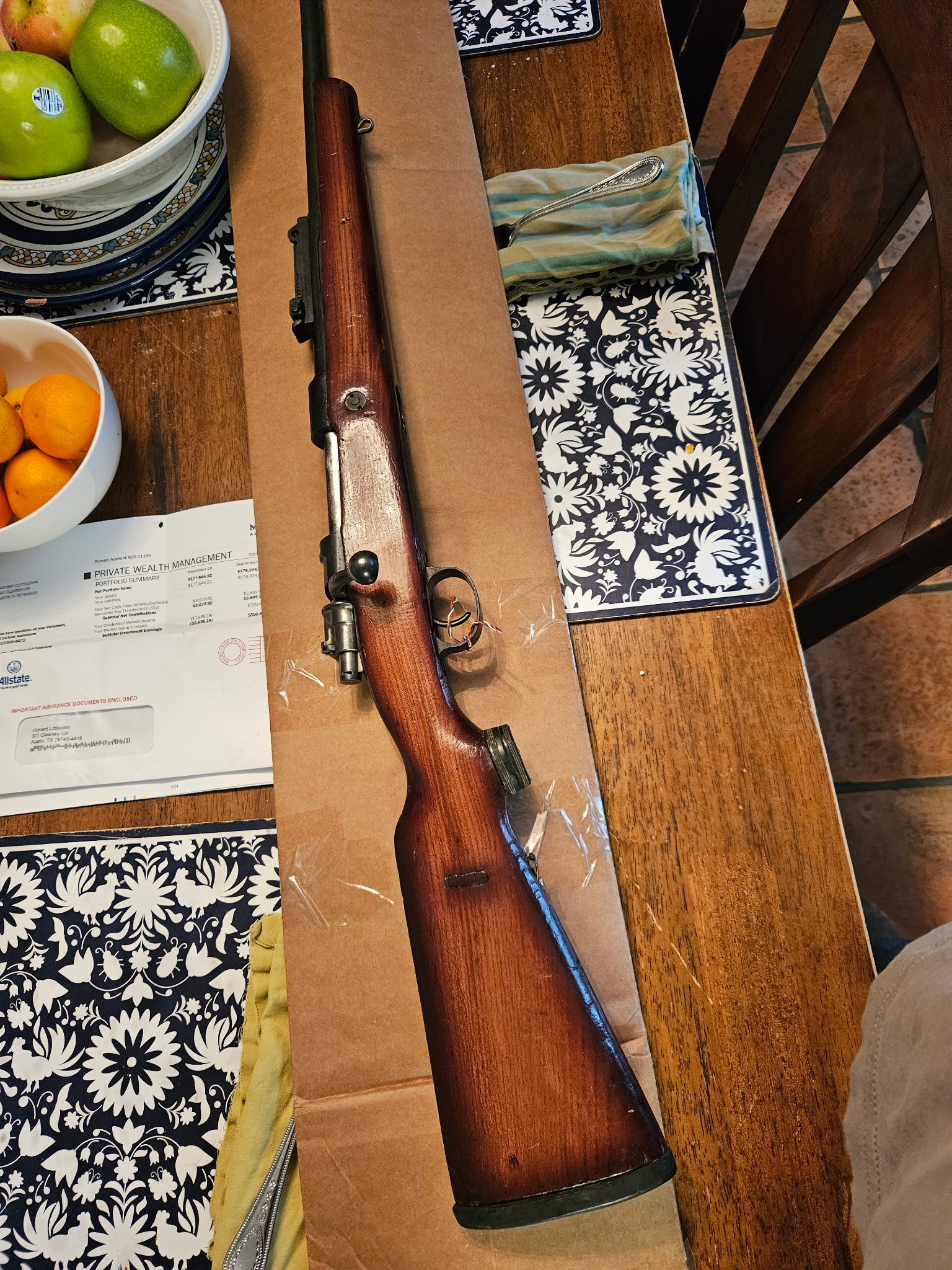

My buddy that got me into this met me at the range with HIS rifle, which externally is in “better” shape, and internally is only slightly better. His bore also looks like a 100 year old iron sewer pipe, but externally looks like this:

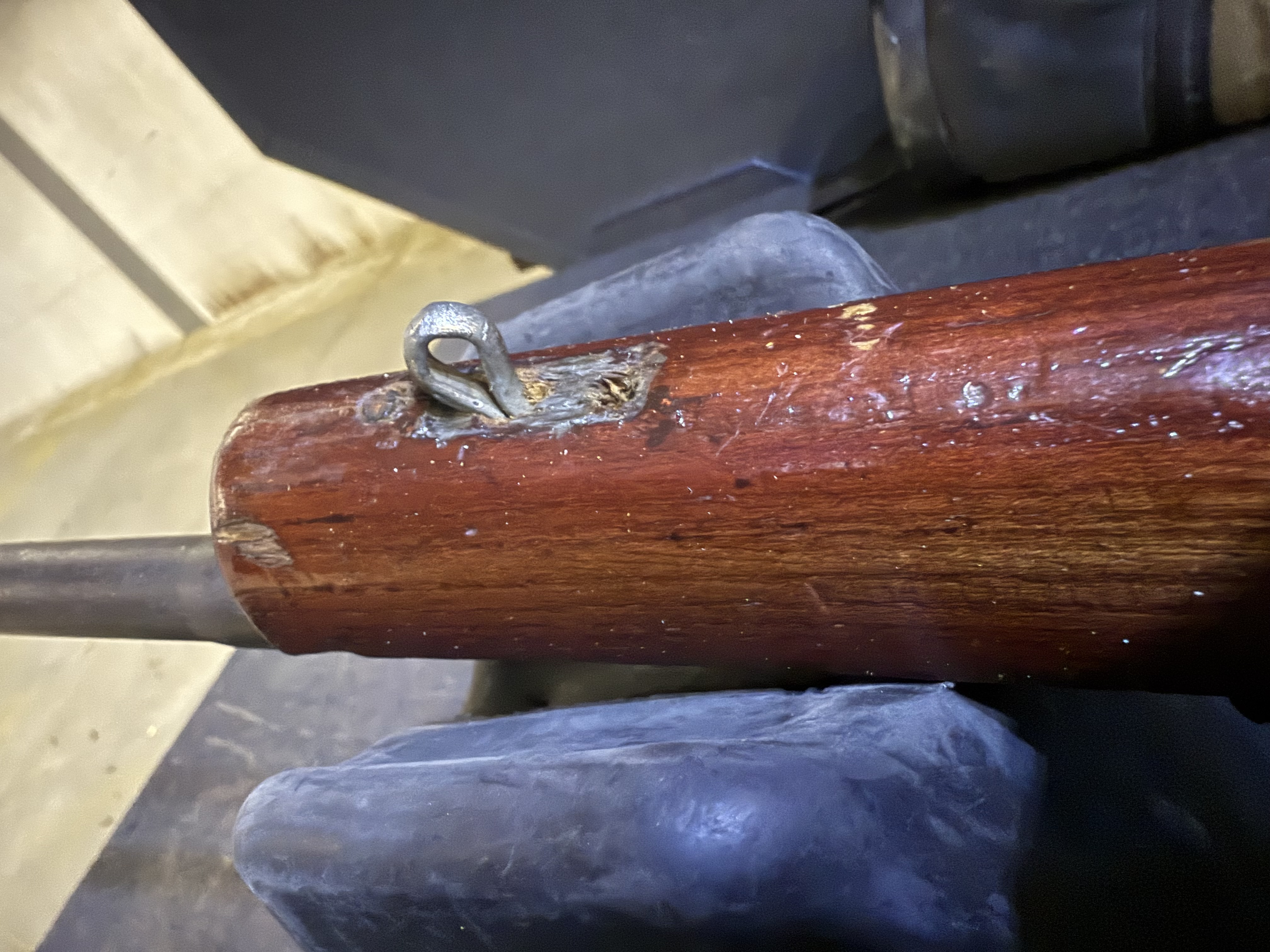

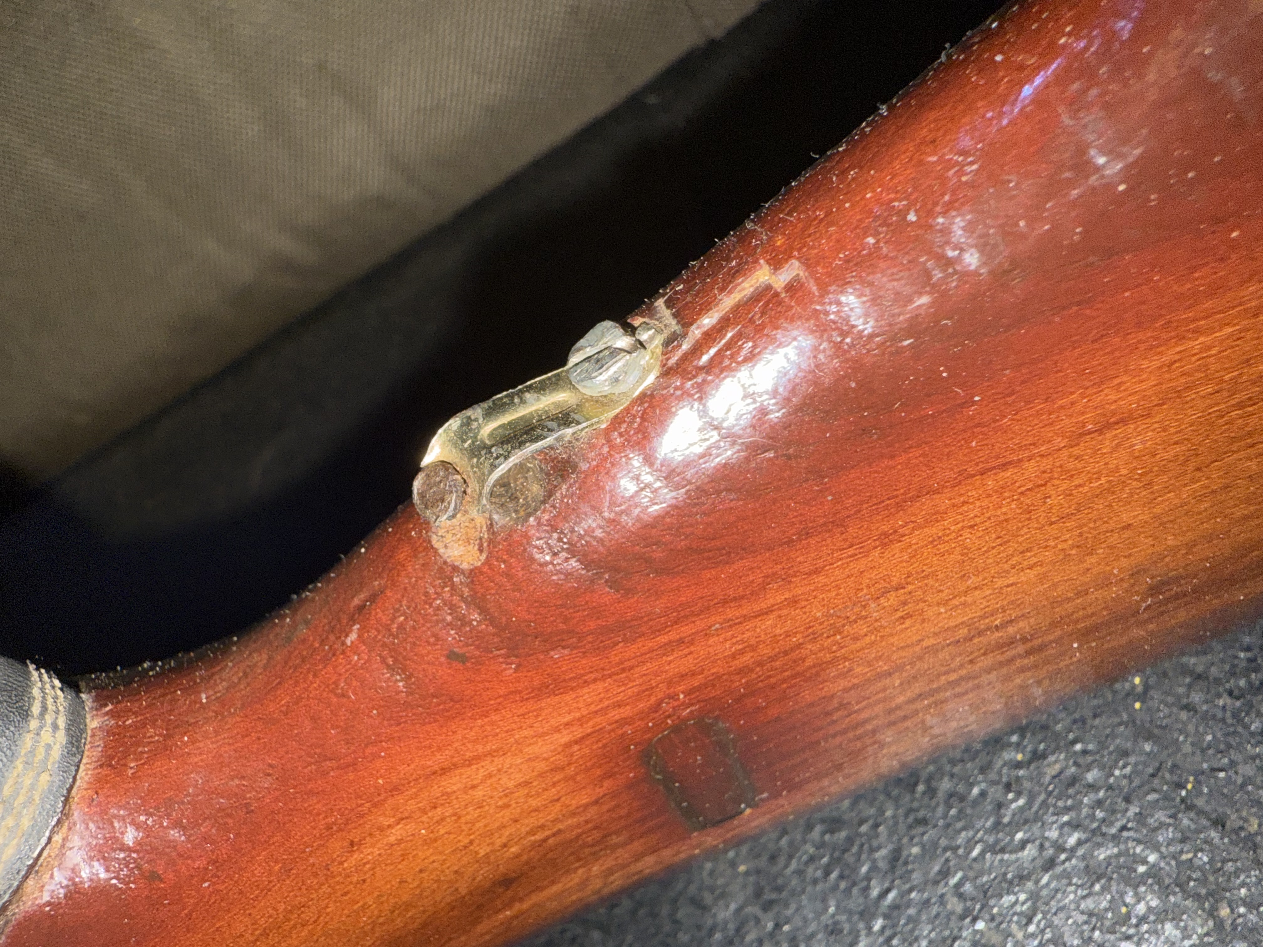

He did point out that the “sling attacment points” looked like they were made from leftover office supplies:

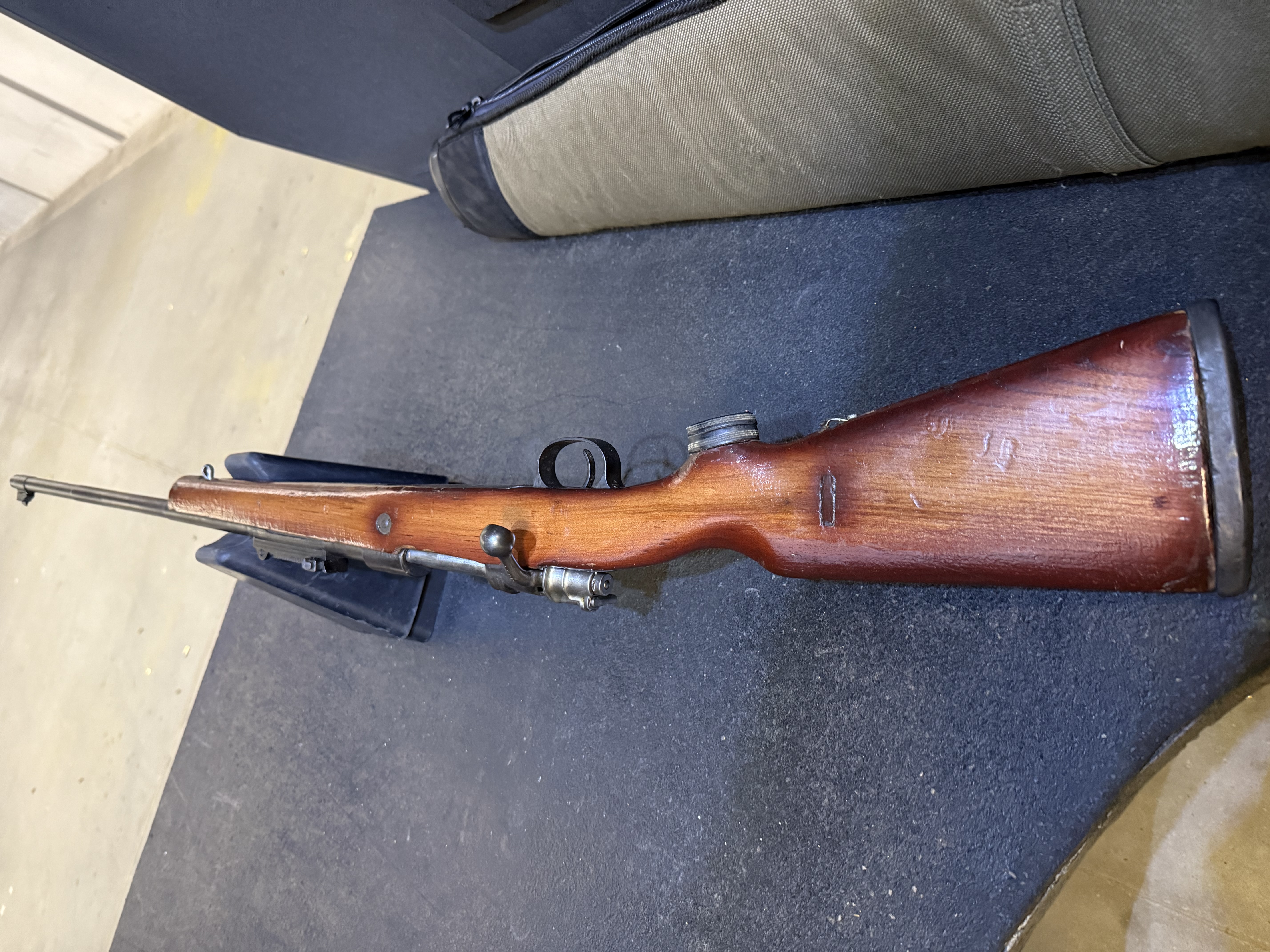

But then I tried to load the next round… well, the bolt would not unlock. After beating on the bolt handle with a board, and doing some other sketchy stuff, I finally got in opened. You can see what the issue was in the picture above. Obvious pitting and boogered up chamber in the neck and shoulder area in the chamber.

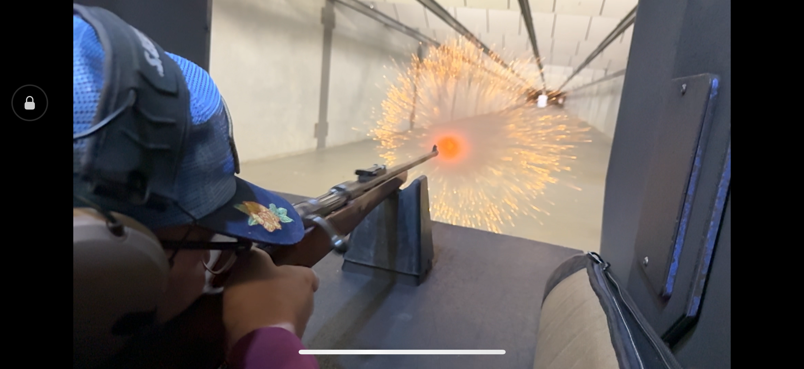

My buddy’s rifle fared a bit better, printing 12” ‘groups’ at 50 yards, but was at least able to cycle rounds without using a hammer. Here is a cool shot I got of his gun running some ancient surplus crap through it.

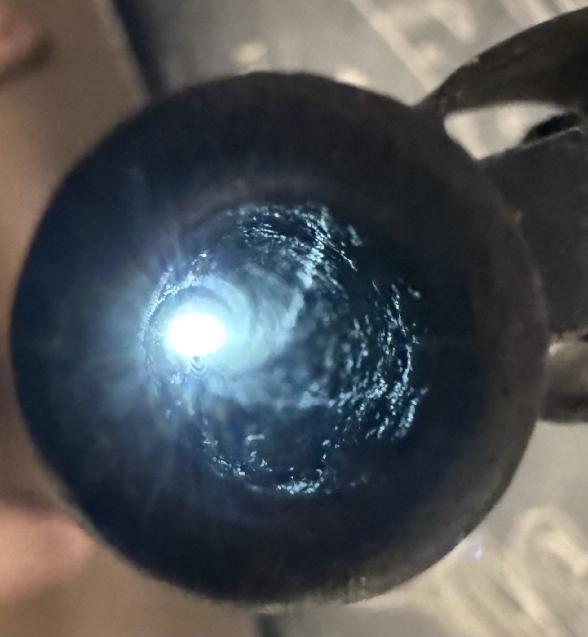

After I got it home, I looked down the bore to see if the 3 rounds might have cleared things up.
Nope. Guess it’s time to start saving for a barrel
