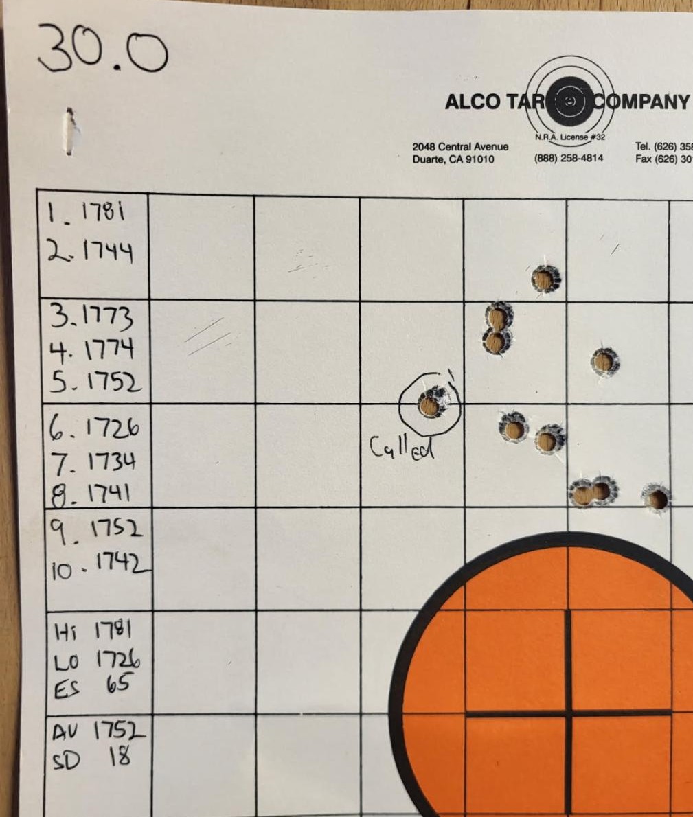

The work continues:
I went back and tested ten shot groups for five of the flattest spots on the velocity curve from the initial ladder test. Best results was 30 grains of 3031 for about 2MOA at 1750 fps:
3031 30gr flat spot test.jpeg (176.26 KiB) Viewed 695 times
The max test was 36 grains at 1998 fps, and while the departing velocities were the tightest of the day, three of the ten were clearly tumbling when they hit paper. Either this bullet doesn't want to go fast, or 3031 may not be the fuel of choice.
Have had very good luck with H414 on another bullet, aside from occasional ignition delays possibly due to a too-small charge of a spherical powder. Since H414 is basically intended to be a spherical replacement for 4350, 4350 is next on the testing block, with no other changes to the cartridge. Seating depth and lube change experiments on tap to be tried if warranted.
Real life throwing some minor curve balls, so might be a couple weeks before I get back to it, but the game continues...

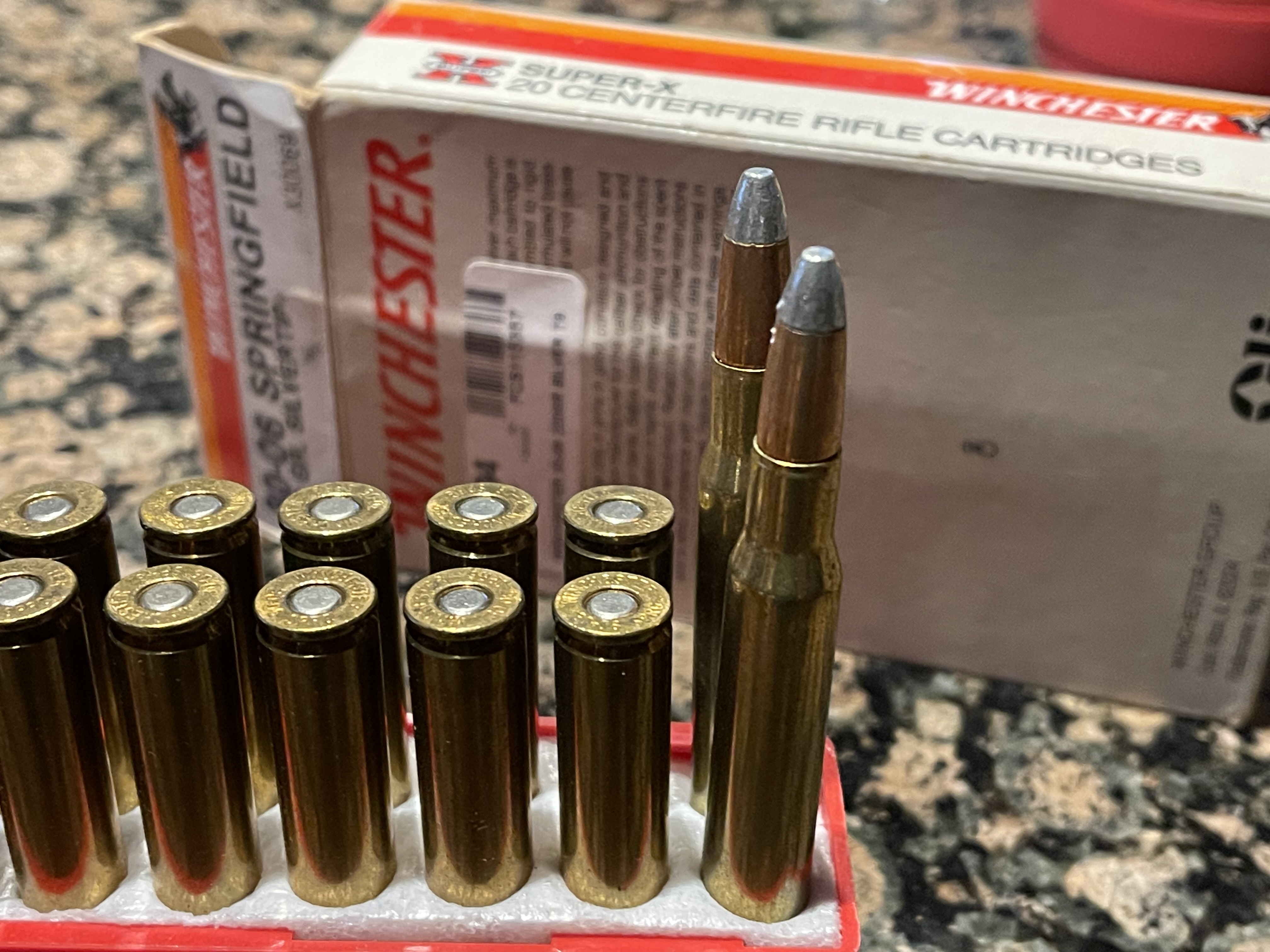

Not junkcollector level scrounging but found these today…..
Posts: 1400
Re: Cast Bullets, the .30-06, and Going Heavy
Awesome find
Posts: 982
Elk Creek wrote: ↑Tue Sep 01, 2026 2:18 am Not junkcollector level scrounging but found these today…..
Id say it qualifies

Bigslug wrote: ↑Sat Aug 29, 2026 11:48 pm The work continues:
I
This is an interesting read. You have a slick new bullet mold, a commitment to non-spitzer heavy bullets with gas checks,
But! If the center of gravity of the bullet is too far aft it is much more likely to yaw excessively and then become unstable as in tumbling. You likely discovered the critical velocity for that particular bullet
Moving more mass forward the velocity can be increased before instability. Could find a shorter taper nose, test how the gas check changes performance, or concave the tail end
Thats the physics view but you are the expert bullet caster
Posts: 1302
Japhy wrote: ↑Tue Sep 08, 2026 4:05 am
I
A number of items to contend with - balance point being one of them. I believe that to be slightly forward of the .311" diameter driving band section and into the .300" bore ride section. A known problem with cast bullets is RPM threshold - basically if your twist rate is too high, and you take your velocity above a certain point for that twist rate, you start to exceed the material/structure capabilities of the projectile. In the .30-06's standard 1-10" twist, the wheels seem to start falling off the accuracy cart around 2100 fps with most bullets. There are guys going significantly faster, but they're using custom 1-14" to 1-16" tubes. I'm running a lot of vintage toys and stock hunting rifles, so a twist rate change is not an option.

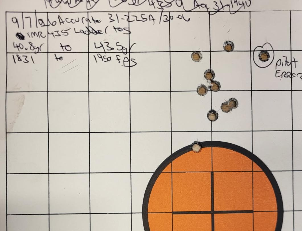

HOWEVER: I did start to re-try the experiment with IMR 4350 and it looks like a more promising option:
IMR4350 Ladder Test 1.jpg (113.59 KiB) Viewed 386 times
IMR4350 Ladder Test 3.jpg (110.39 KiB) Viewed 386 times
A couple ten shot samples from the ladder test (every shot a slightly higher powder charge than the last). Going to go back and re-visit the flat spots in the velocity curve to see what works best. May also try those same flat spots with a change in bullet lube to see if that makes a difference.
Posts: 806
Those results look good. What is the bullet mix?
Hoping you dont tell me you just tossed in a handful of wheel weights in the pot.
