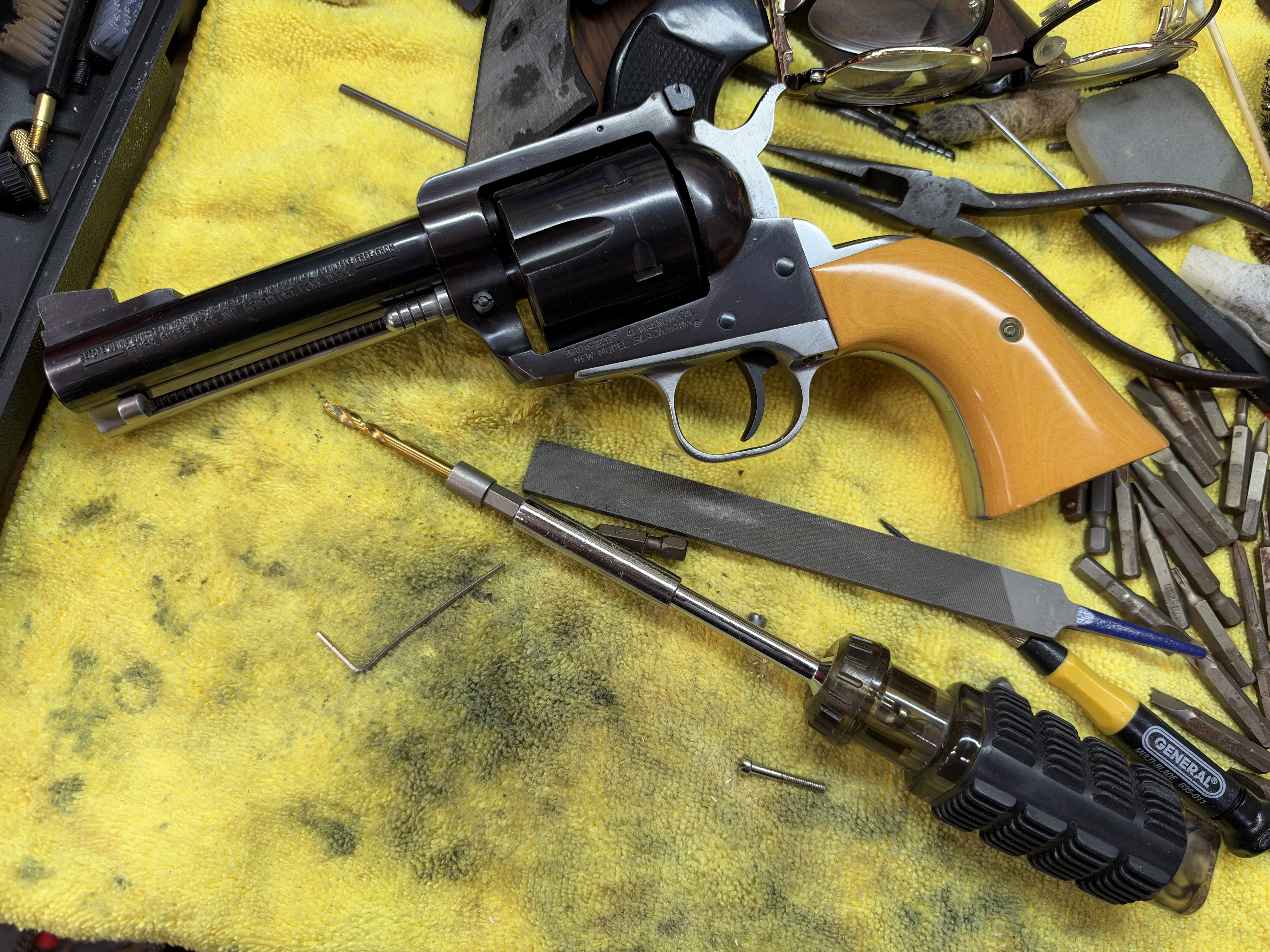

Thanks to Paul and his usual generosity the gun is now outfitted with FINE!!! grips. I wish I knew the maker of these I'd buy 5 more pairs. They are absolutely Mycarta and they are HARD!!! Fitting SA grips is not for the inpatient, sloppy or faint hearted. One slip and you'll take too much material out and end up with really ugly gaps/holes that are nearly impossible to disguise. Properly fitted you'll end up with grips that basically need a whack with a rubber mallet to take off.
I've been working slowly for short periods of time for two days using a fine file and the proper bit for the stud hole inserted into a screwdriver instead of the drill. Way better way to "feel" how much material is being removed. It's a matter of removing C hairs until you have a perfect fit and these are now there.
The last few things I need to do are changing the base pin latch for a stainless one to match the other pieces (ordered and on its way). Then it will be taken apart again, the internals polished and a new set of springs, maybe a little judicious tuning of the trigger. We'll end up with a fine working field gun.
What my SIL knew about horses could fit on the tip of a pin, but he was really interested in learning how to ride because my daughter is an accomplished rider and she misses it, and both of them wanted the kids to grow with horses. We also talked about doing a mounted Elk hunt in Montana or Wyoming in a year or two after he became better on a saddle. This was going to be his side arm...
We never got to those things but maybe someday I can take his gun along on that adventure while I'm the caregiver, before I pass it along to one of the G'kids.
Anyway, here she is.

Now that looks NICE.
Well done my friend, very well done

Not liking those grips on that gun. The tri coloration is not melding for me. Grips look like baby crap. Clash with the stainless.

Zee wrote: ↑Sun Oct 04, 2026 8:59 pm Not liking those grips on that gun. The tri coloration is not melding for me. Grips look like baby crap. Clash with the stainless.
I think it’s well established that you and I don’t exactly share our taste in grips for handguns 🤣
The grips show more orange on the pics than up close. In person the color is more of an old aged Ivory. Dark enough to stand out from the stainless and light enough to show off the blue. At least in my view. And just as important, these things are tough. The kind of material you want in a hand boomer.
