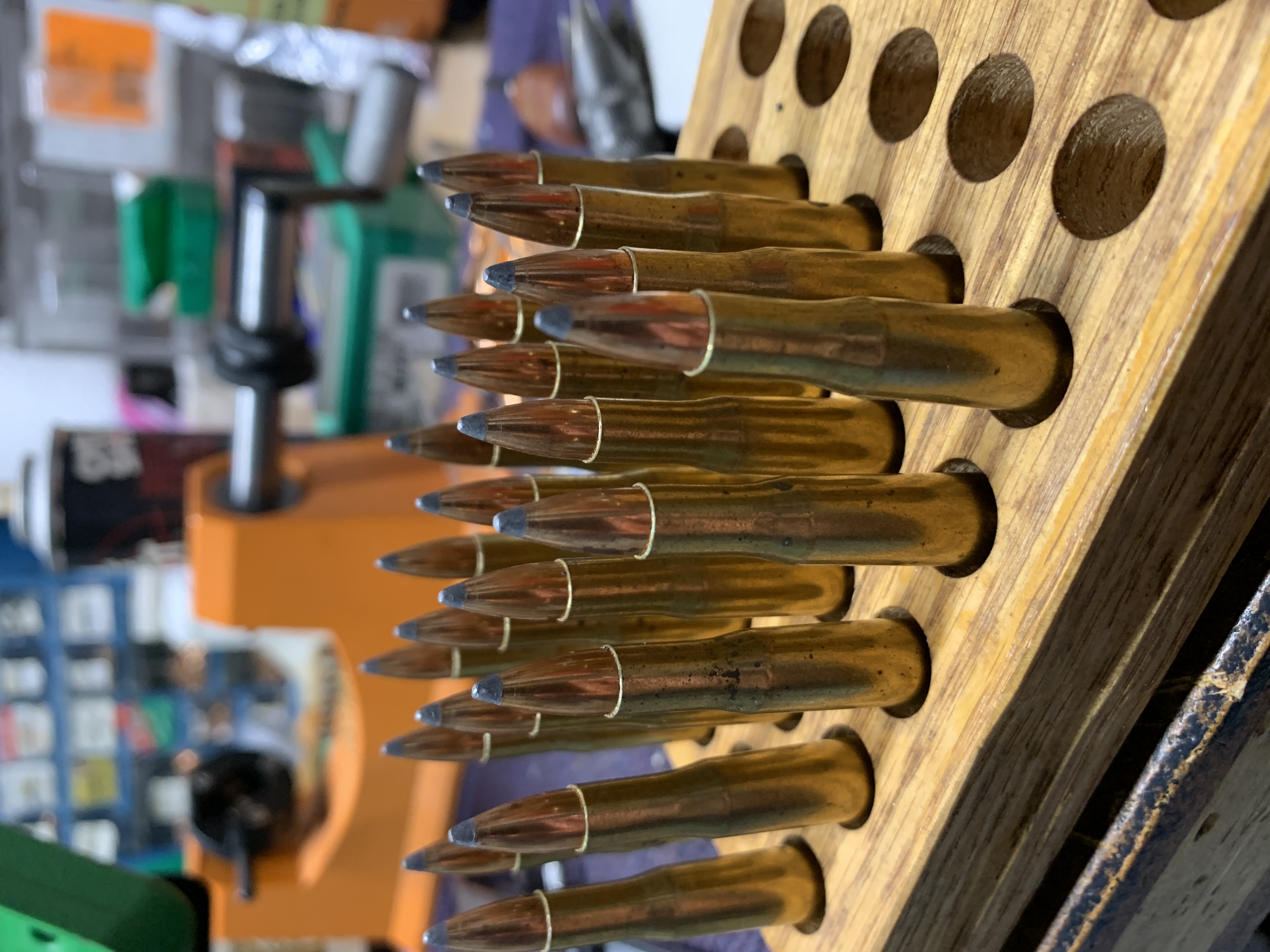

:lol: Interesting! Could be lee dies are not the best choice for the intended purpose. That's what I get for being thrifty, the Lee's were 10 bucks cheaper
Posts: 844
Re: case forming
Ready to launch!
Re: case forming
I usually use Lee dies but I got the .25-35 dies at a gun show!
What load is that, powder/bullet??
Posts: 844
Re: case forming
117 gr BTSP 19.5-22.5 gr H4895
Re: case forming
Yup! 4895 is what I used, don't remember the powder charge!

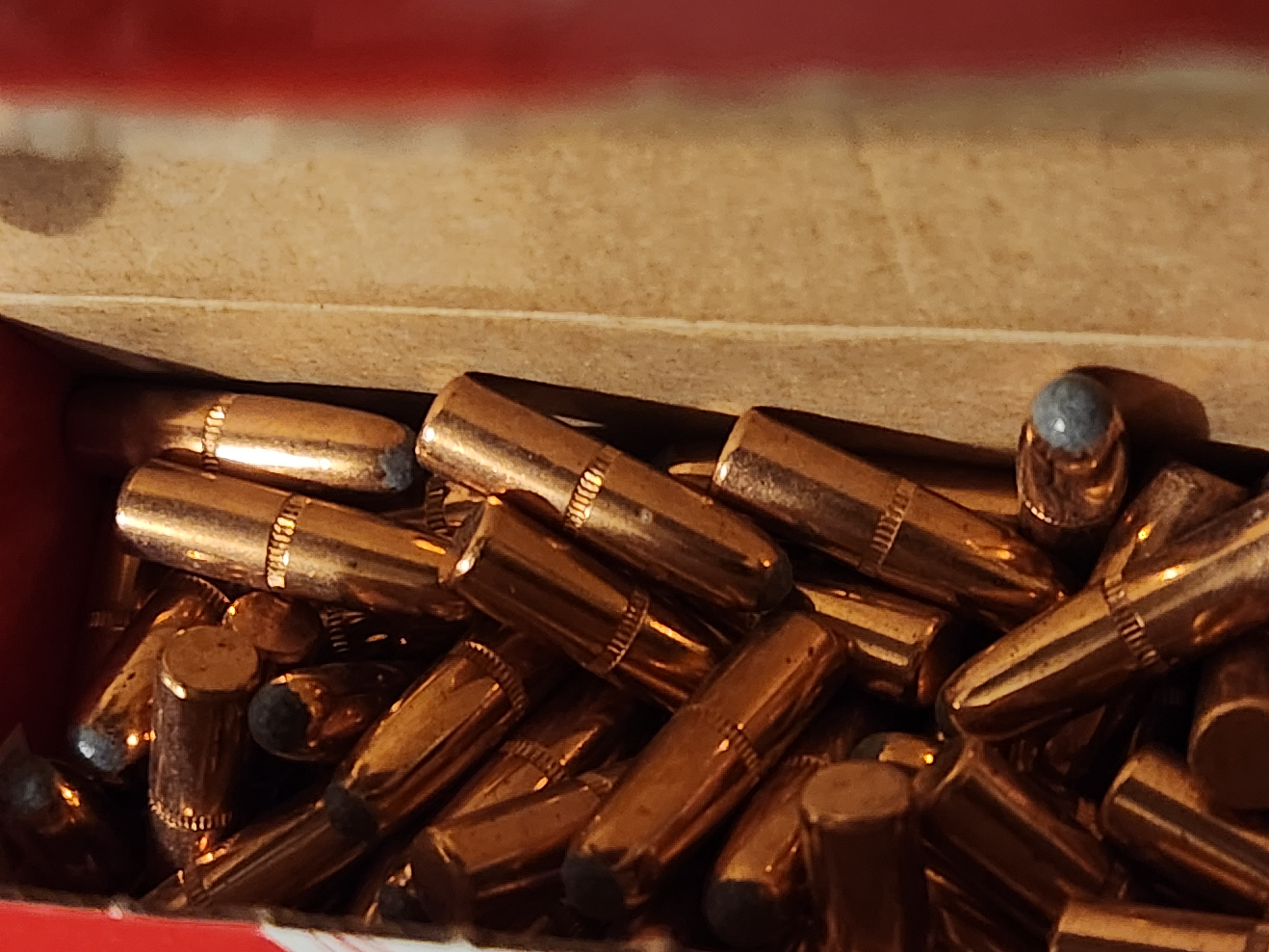

Re: case forming
I'd like to try some 120gr RN if I can find some. I need to look and see what mold options are available.
Re: case forming
Mine really likes the 117 RN's. It's an 1899 take down and for some reason it won't feed spitzers. The case mouth catches on the rim of the chamber!
Posts: 844
Re: case forming
I suspect it will be a while before Hornady, assuming they even do, tools up to make the RN in ether weight. I've got a pretty good supply of 117 & 120 gr BTSP bullets to shoot while I wait!
