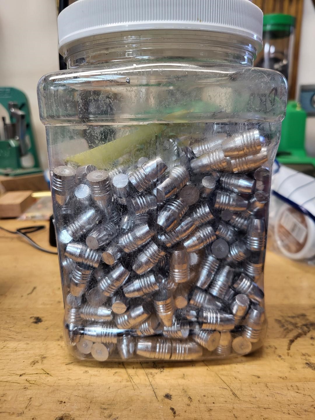

Brought along the pin gauge set to get diameters on the cylinder throats and bore, and pounded a couple of .457" round balls through the barrel to get the groove diameter:
Pretty danged happy about that. The throats are all uniform at .434", and half a thousandth bigger than my tumble lube bullets are dropping out of the mold, so we have the perfect snug slip fit. The barrel's groove diameter at .430" will be giving that bullet a little bit more squeeze than the .001" to .002" that's regarded as ideal these days, but it should seal tightly and shoot clean.
Melted up 20 pounds of 0.3% antimony alloy rendered from jacketed range scrap bullet cores, added four ounces of tin, and got busy.
Hoping to have a range report on it between Xmas and NYD. My Dad is using the same bullet in a powder-puff Special load for his 4" Mountain Gun. We'll probably start with that, tweak the charge up or down to get it to shoot to the sights, and move the adjustable sights on the Mountain Gun to that load as the new standard for .44 SPL.

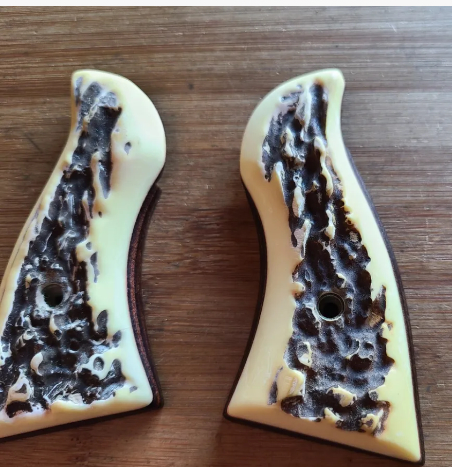

Here’s an alternative that was quite popular in old school cop guns. It’s Jay Scott fake stag grips. These look darn good for $40.
https://www.ebay.com/itm/155935940339?m ... media=COPY

Never really could warm up to stag as a grip material, and ivory has always been a tough sell. In .44 Special, this one's not really a candidate for the WWII "pinup under plexiglass" category either.

I don't like fake stag. They're obvious at being faked. Something else I don't like for looks is a Pachmayer grip on an old gun.
Re: HANDS OFF MY BARREL, DR. JONES!!!
All stag looks like ass, real or fake. Same with pearl.
Unless you’re a pimp.
Rubber Pachmayers are the ugliest grips known to man, on any vintage.

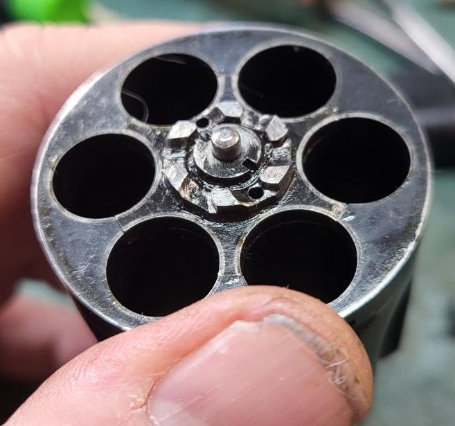

Got it home today and dove inside to face some honest grease of ages past:
Broke out the Ballistol and got busy. Found a bit of an odd thing:
Somebody had padded the ends of the sideplate where it bears against the inside of the frame. Some kind of oil-soaked paper on the left; brass on the right. Not sure what the reasoning behind this was, as the sideplate settled down nice and flush without binding anything after reassembly. Weird.
Clean and shiny lockwork bits: Absolutely no reason for S&W to mirror polish the side of the rebound slide or the DA sear, but they went and did it just because. Yes. . .the Old Time Rock & Roll has its charms...
A close up of the A.E.F. eagle head I mentioned:
Gotta wonder how many frames S&W churned out as fast as they could for Uncle Sam, only to have Uncle Sam yell "WHOA!" on them after 11/11/18. I like my 1921 inventory clean-up.
Clean and back together: It can't be properly described with the photos, but it's got one of those actions that you'll cycle slowly all day just to listen to the thing.

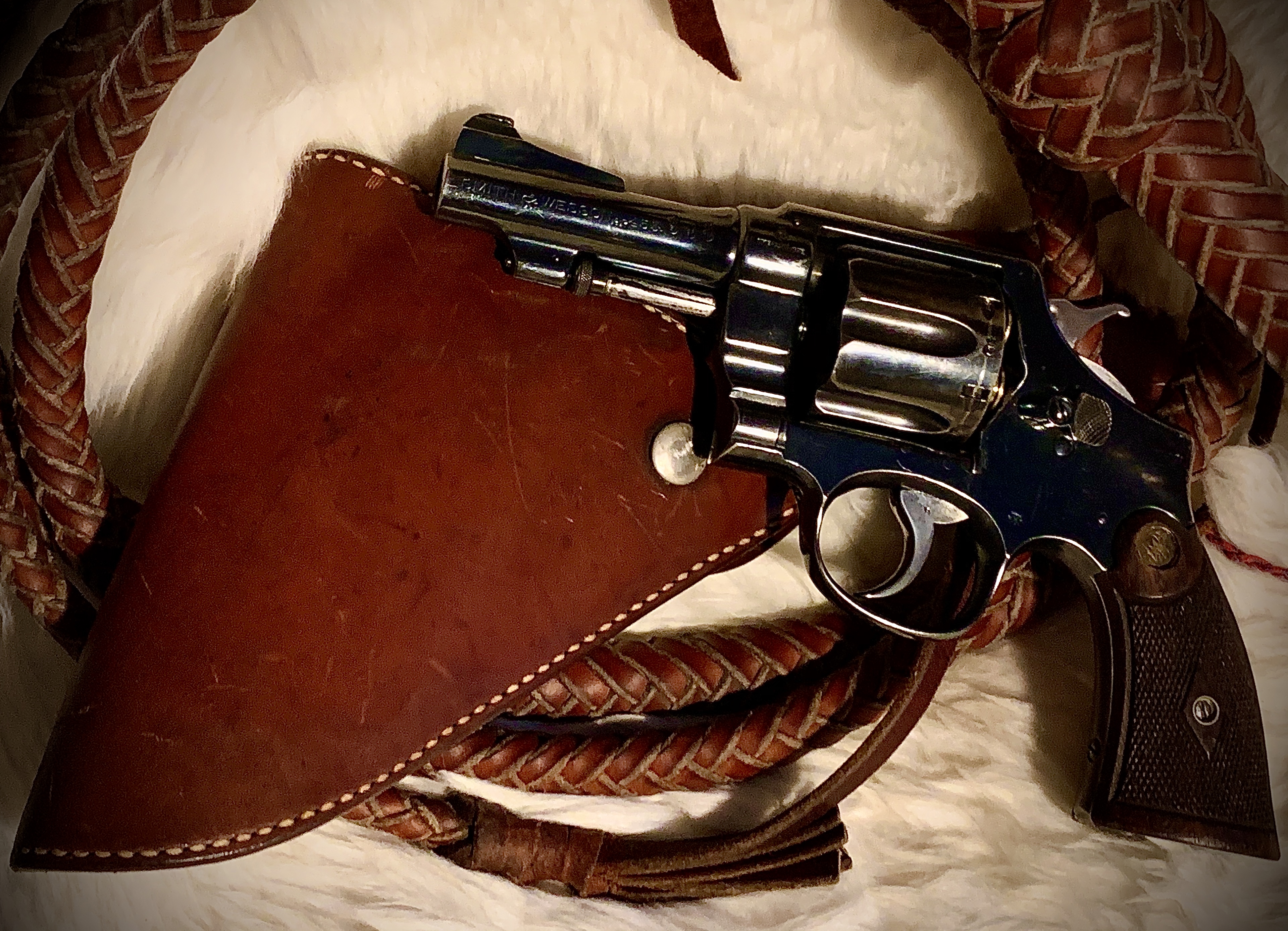

It came with a holster. Kinda cool: I don't think I've encountered the George Lawrence Company before, but as they marked it for a 38/44, it's probably nearly as old as the gun.

Very cool take down, not brave enough to do that myself to my one old Smith, had a gun smith do it for me, hope that trigger makes you giddy

George Lawrence holsters are very good quality and they were huge in the first half of the 20th century. That are becoming a little collectible with others like Heiser and Bauer and the prices are coming up on eBay.
Worth giving that leather a little cleaning and TLC

Now you see gaps between parts. . .
. . .and now you don't.
Between helping my Dad clean up some of his acquisitions and my own interests, I've been lucky enough to work on things like a Sharps carbine produced a the height of the Civil War on one extreme, and a few Maxim-pattern belt-feds of WWI on the other. Even though they were operating under the press of their greatest national calamities EVER, they were turning out stuff at this level - mainly because that was just how they did stuff.
So yeah. . .a little bit giddy.
