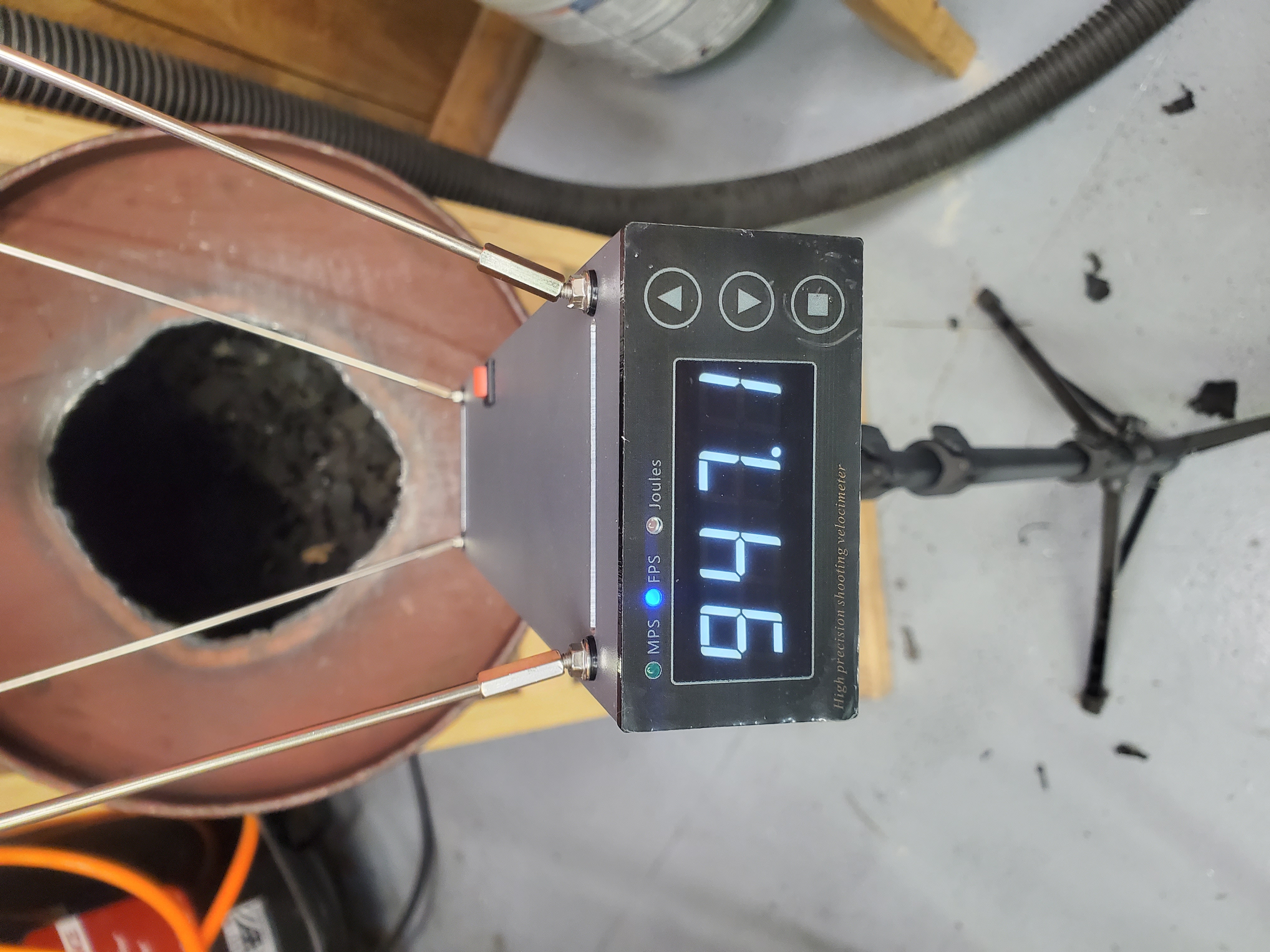

Pinned the valve and tested a 65 grain slug at 3000psi. It'll be right where I want it at 4500psi, granted way short of what I initially thought but this also isn't my spiffy valve design, just a poppet valve.

A little progress. I don't know how the hell I managed to do it, but I altered the valve a little, mostly to keep it from slamming internally when it functions but it's only dropping about 250 psi with each shot and I'm still getting nearly the same velocity as I was when it was dumping the whole tank. I'll take that.
Got the hammer and trigger done and taped the assembly into the stock so I could test fire it from the shoulder 😅.

I'm not sure on the barrel length. That one is for testing purposes only, which is why its shorter than the air tube. It's actually a 7.62x39 blank that I had so there's some blow by with my .308 slugs. I actually have enough data to graph velocities so I might actually try that.
