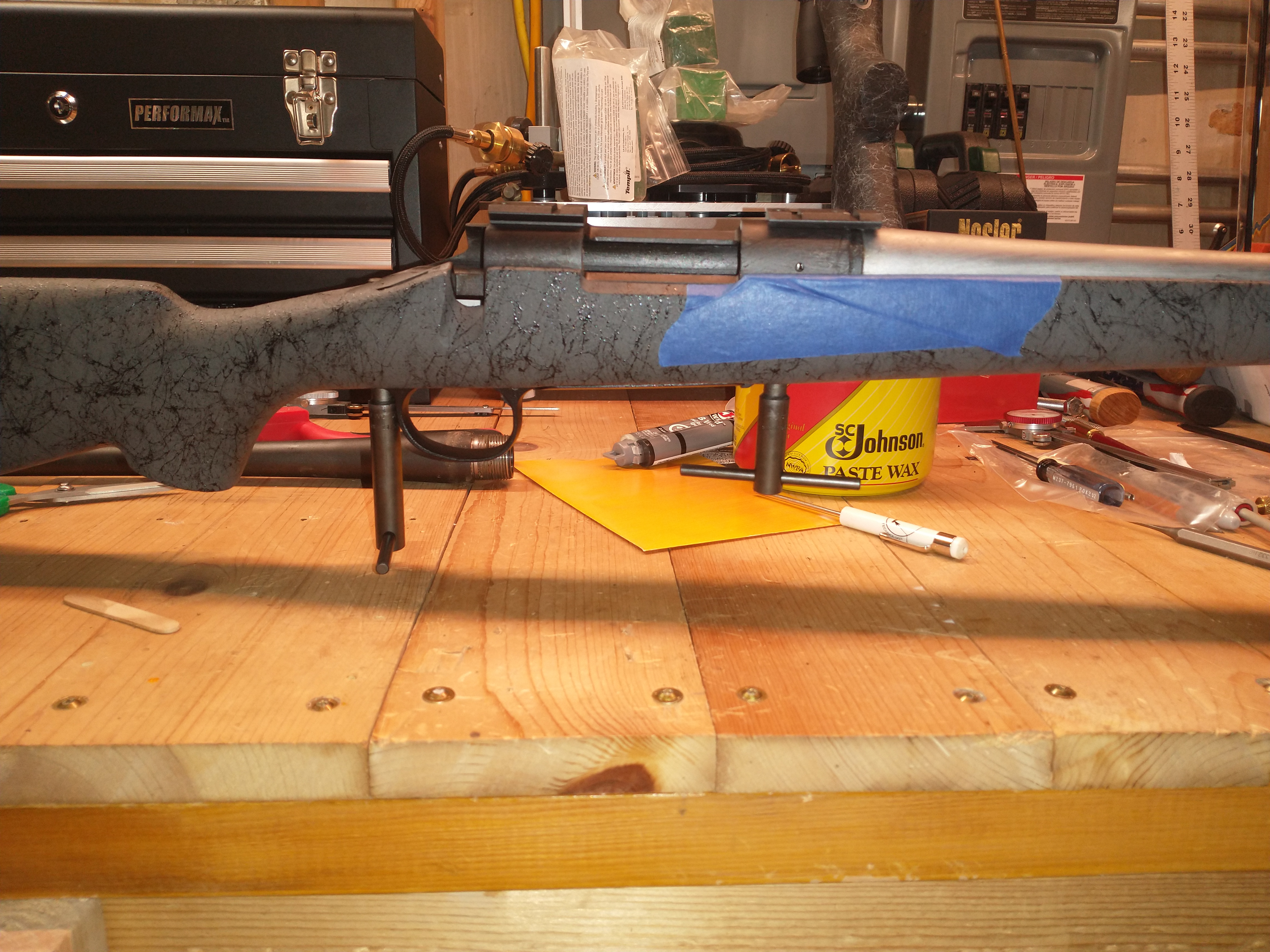

I'm not sure if I'm going to stick with the current stock or go back to a Remington SPS like it was in before. Current setup in the pictures is new Remington 700 short action (ADL when new), Remington take off stainless barrel, Timney 510-V2 trigger, take off Remington BDL bottom metal, Leupold VX-Freedom 4-12x40, Leupold rings and bases, and Bell and Carlson stock. I'm a little conflicted on the barrel and receiver combination and may look at either blackening the barrel or putting it on a stainless R700 action. Current weight is 7lb 10oz as assembled.
Posts: 463
Re: R700 .243 "build"
Decided to go with the Bell and Carlson stock. Now I just have to wait till tomorrow to pull it back out of the stock once the two part has cured.
Still not sure how I feel on the two tone. I don't love it, but I don't hate it either.

Zee wrote: Sun Jan 28, 2024 2:11 pm The two tone looks great! I have a few that way. Quit your bitching! 😁
I'm leaning toward leaving it. It is kind of growing on me. This rifle may or may not stay a .243 in the long run. It was intended to be a learning experience with changing a R700 barrel before the 6.5-06 prefit arrives. The chamber on this one is tighter than the chamber on my M70 .243 and the chamber on the no good barrel. I have Forster gauges and in their own admission the NO-GO gauge is not the correct dimension based on SAAMI specs, but what they recommend. Both my M70 and the 26" barrel will allow the bolt to close on the Forster NO-GO gauge where as the 24" stainless will not. Not that its really that big of a concern for me since I will probably be neck sizing for the most part. I do have a Forster field guage on the way that I'm going to check the M70 with, but I'm not really concerned about it. Not like it isnt already headed toward a barrel replacement anyways. I need to check my 6.5-06 gauges to see if they are Forster or Manson. I know my reamer is Manson.
