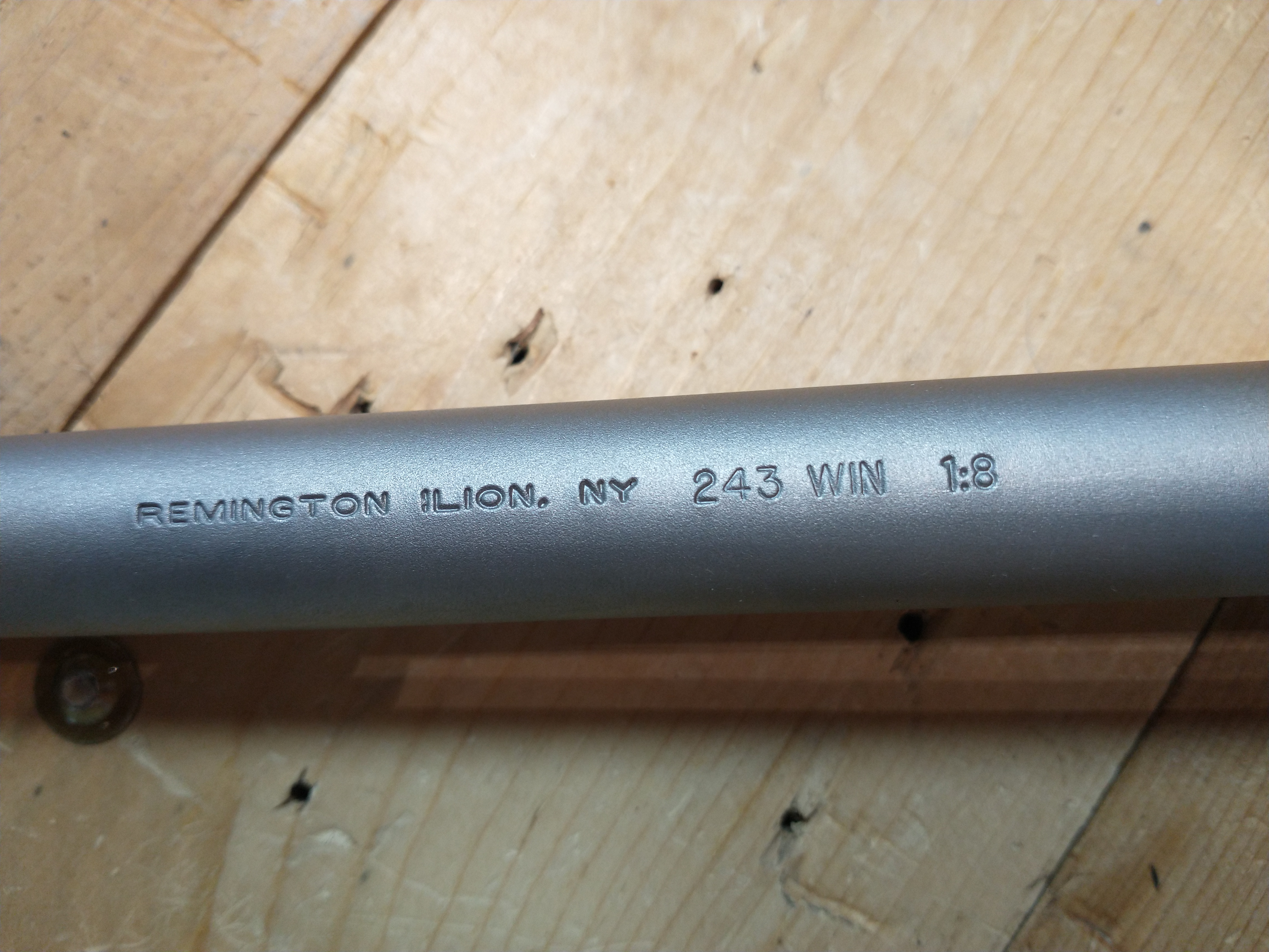

Working on a refund with the first barrel. I was looking forward to it since it was a 26" heavy contour barrel. Unfortunately not only was it rusty, but it turned out to be a 10T barrel. Current production heavy 26" barrel .243 is an 8T per Remington's website.
On a more positive note, I found another new take off barrel. It is a stainless 24" barrel with an 8T barrel. I checked it with the cleaning rod method and a bore scope and it is actually 8T. It's shorter and slimmer than I wanted, but it's not rusty and it's an 8T. Is 2" going to make that big of a difference in a .243 barrel??

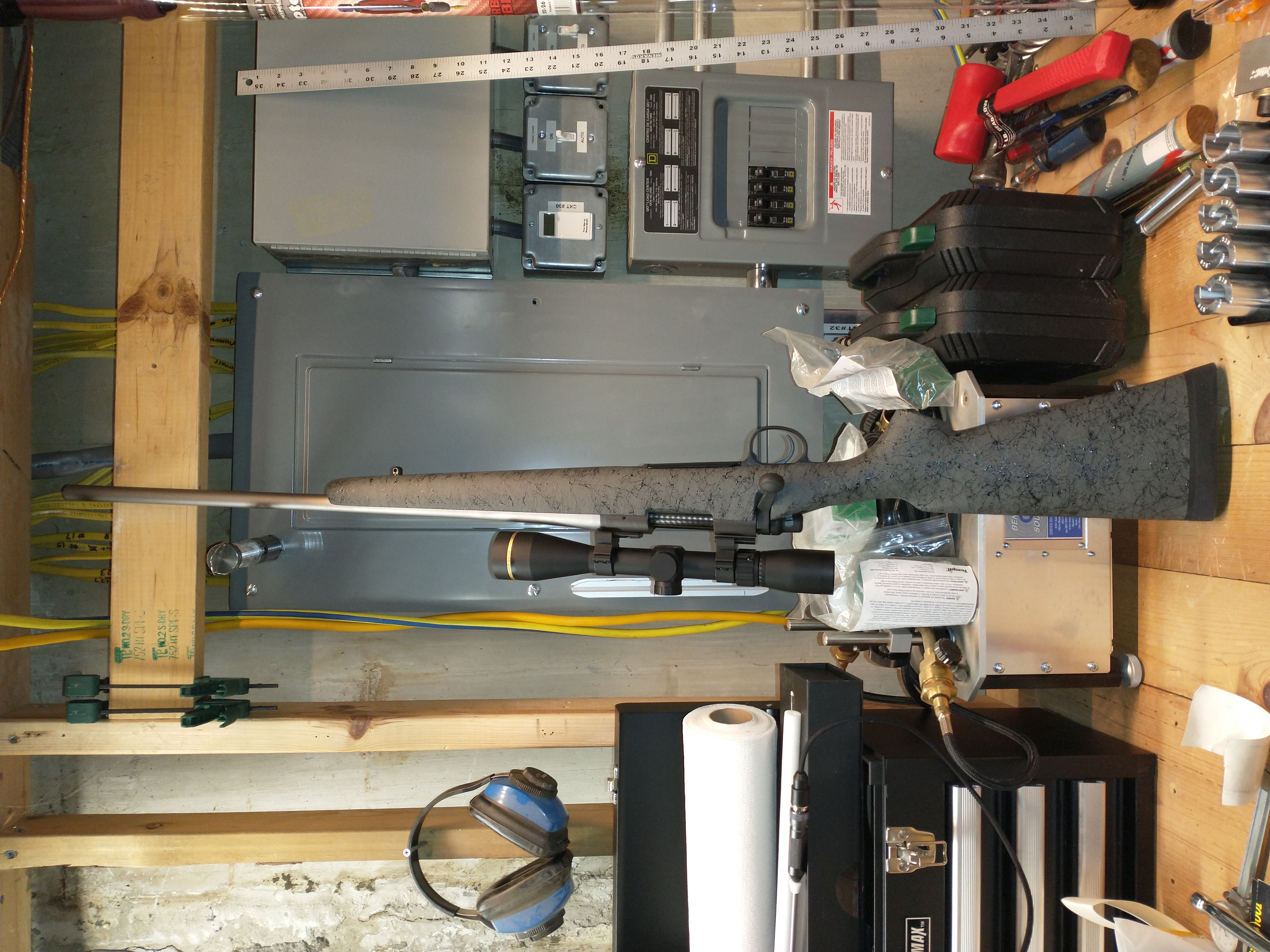

I'm not sure if I'm going to stick with the current stock or go back to a Remington SPS like it was in before. Current setup in the pictures is new Remington 700 short action (ADL when new), Remington take off stainless barrel, Timney 510-V2 trigger, take off Remington BDL bottom metal, Leupold VX-Freedom 4-12x40, Leupold rings and bases, and Bell and Carlson stock. I'm a little conflicted on the barrel and receiver combination and may look at either blackening the barrel or putting it on a stainless R700 action. Current weight is 7lb 10oz as assembled.

Decided to go with the Bell and Carlson stock. Now I just have to wait till tomorrow to pull it back out of the stock once the two part has cured.
Still not sure how I feel on the two tone. I don't love it, but I don't hate it either.

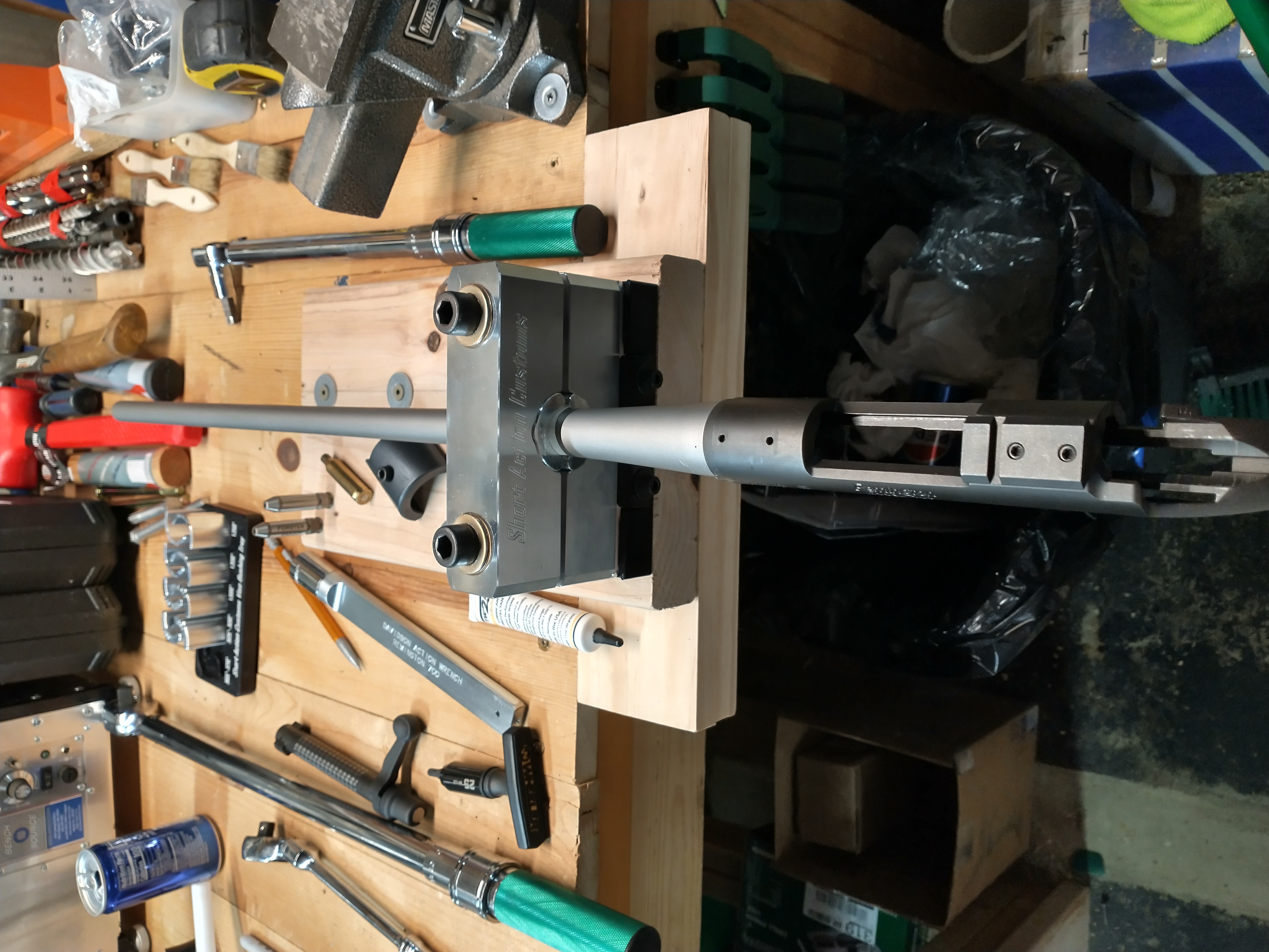

Barrel channel barrel support pads removed, recoil lug bed, and all reassembled. Now I need to find time to load up some test rounds and then get to a range. I'm thinking my earliest chance will be next weekend. This weekend is booked and not enough time after work to get to the local outdoor range during the week. I'm thinking initial test loads will be with a 100gr InterLock before I start working on a load for the 90gr CX. I have plenty of the 100gr to start with. Another possibility would be the 85gr InterBond, but I can't exactly replace those anymore and I don't want to completely give up on the M70 .243 yet.

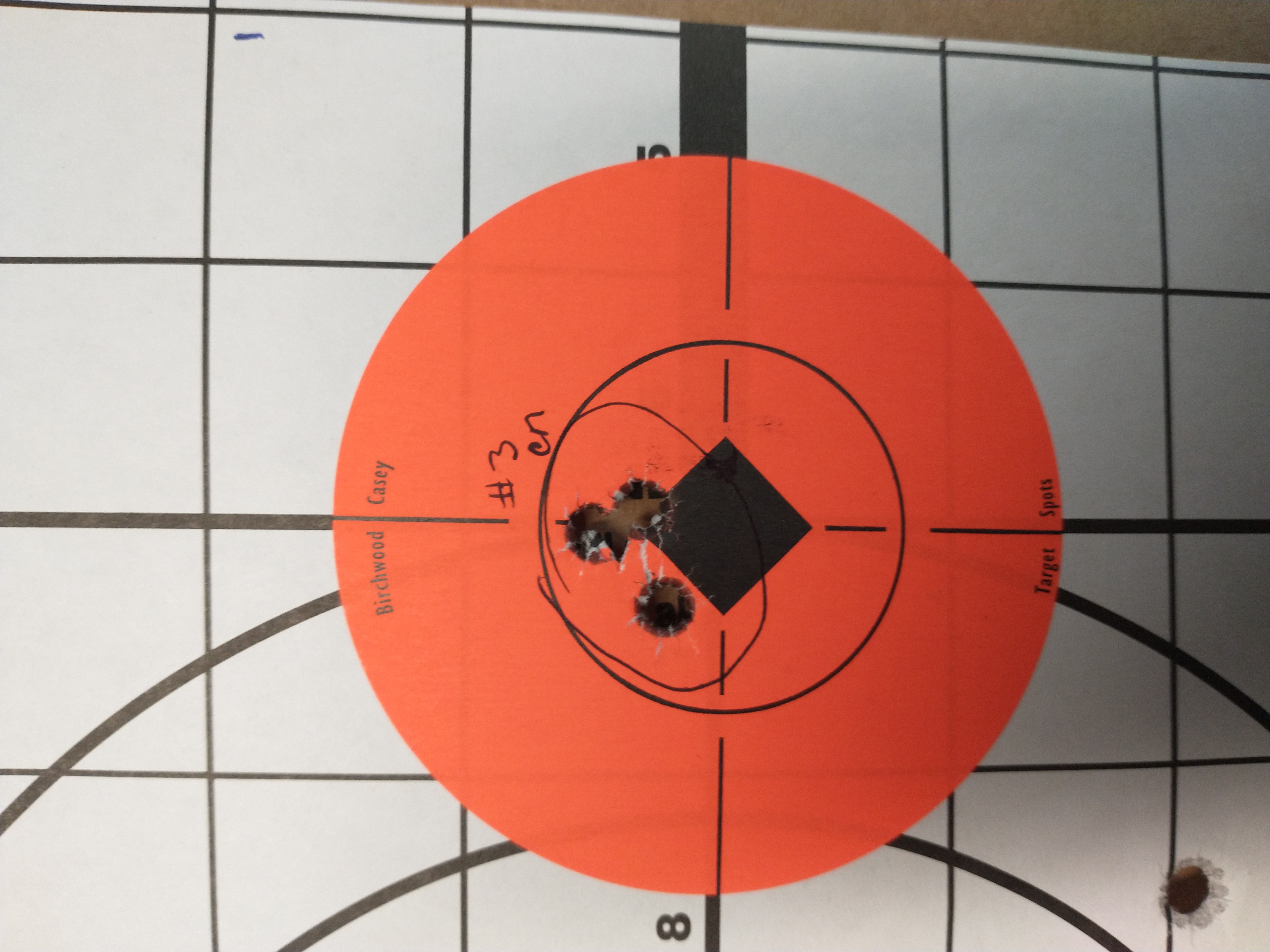

I managed a range trip today and did some shooting at 50 yards. I was more concerned about velocity than I was group sizes as my 50 yard and 100 yard groups are usually about the same size. My performance was lacking today.
Factory 95gr SST Superformance ammunition averaged about 3015fps. I'm not upset by that as my 22" M70 .243 was about 100fps slower if I recall correctly.
I took the remaining 7 rounds of my 85gr InterBond load to try out as well. The 7 rounds averaged 3084.1 fps. This is a slight disappointment since in my 22" M70 that same load runs at 3160 fps. I'm not sure if the tighter twist is part of the reason or if it's just a bunch of factors stacking up. The M70 also shoots much tighter groups with this load.
The main loads I wanted to try were using RL-22 with the 100gr InterLock bullet. I was not terribly impressed with performance as velocity spreads got a bit out of hand at the top end. Brass and primers looked okay, but 50 fps swings concern me. These were only 3 shot averages since I just wanted a ball park velocity figure.

The 44.4 gr load seemed to do the best today. It also had a SD of 6.8 fps, but a sample size of three shots isn't going to provide the most reliable numbers. The top two loads had SDs in the upper 20s.

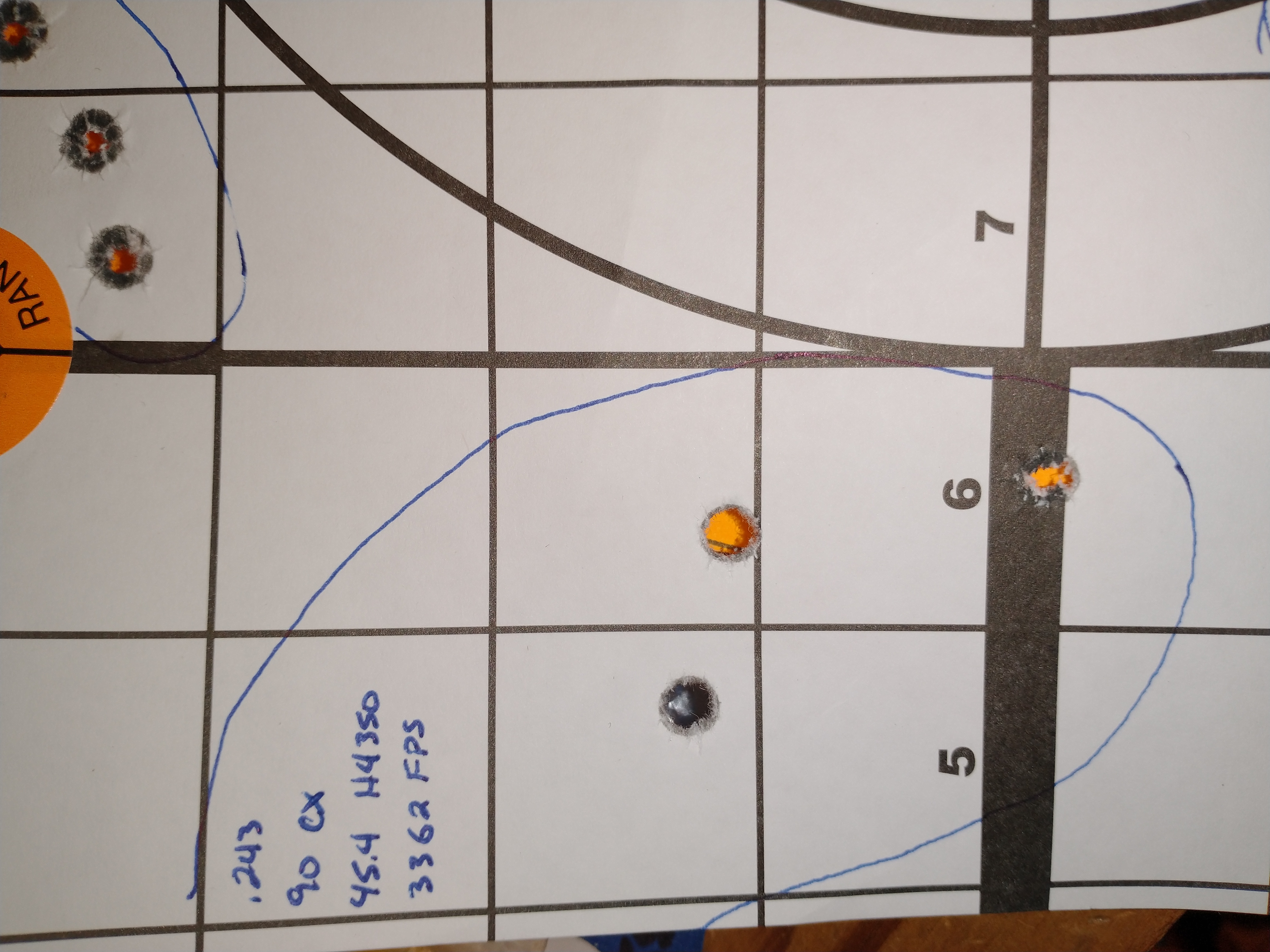

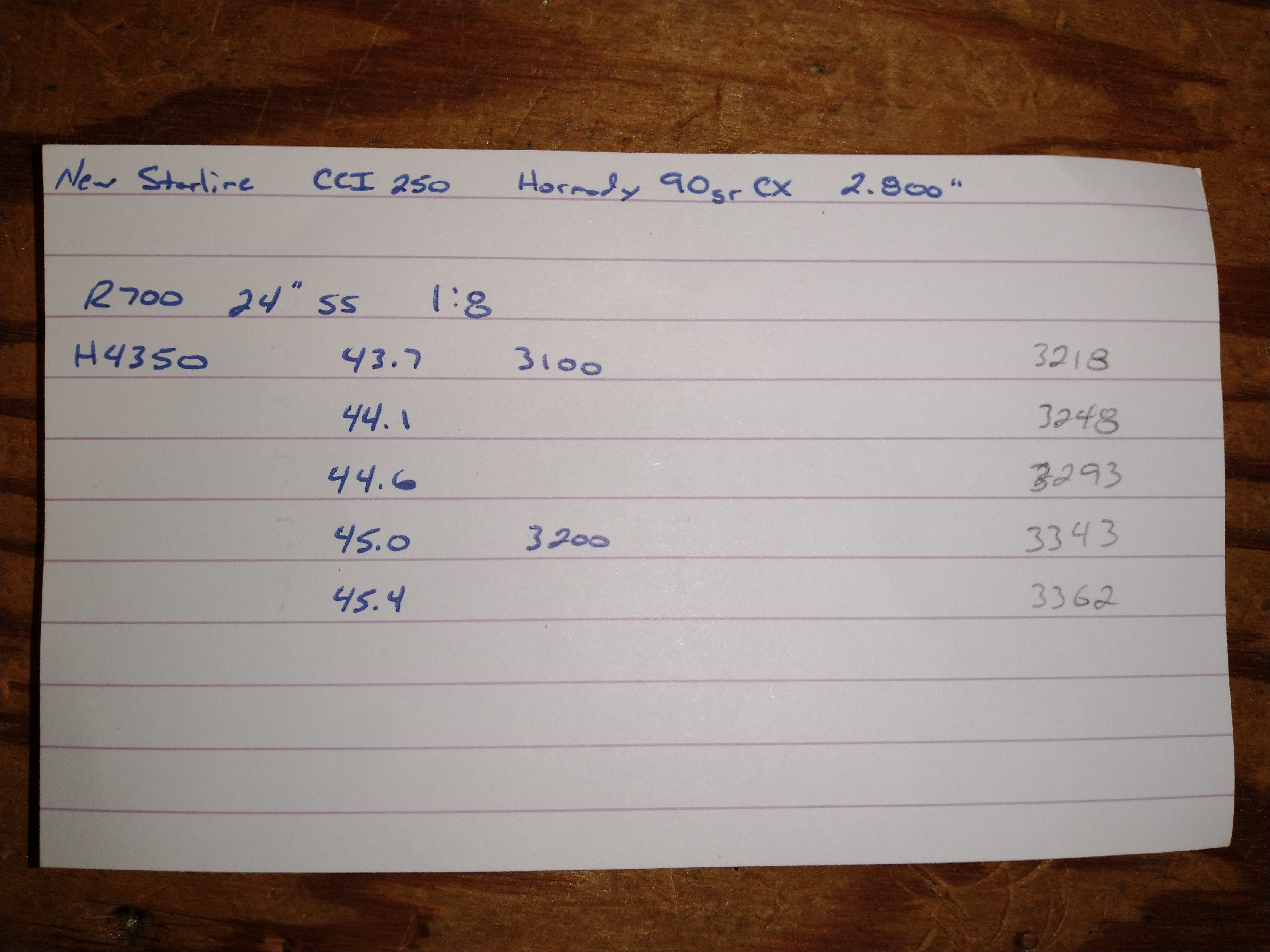

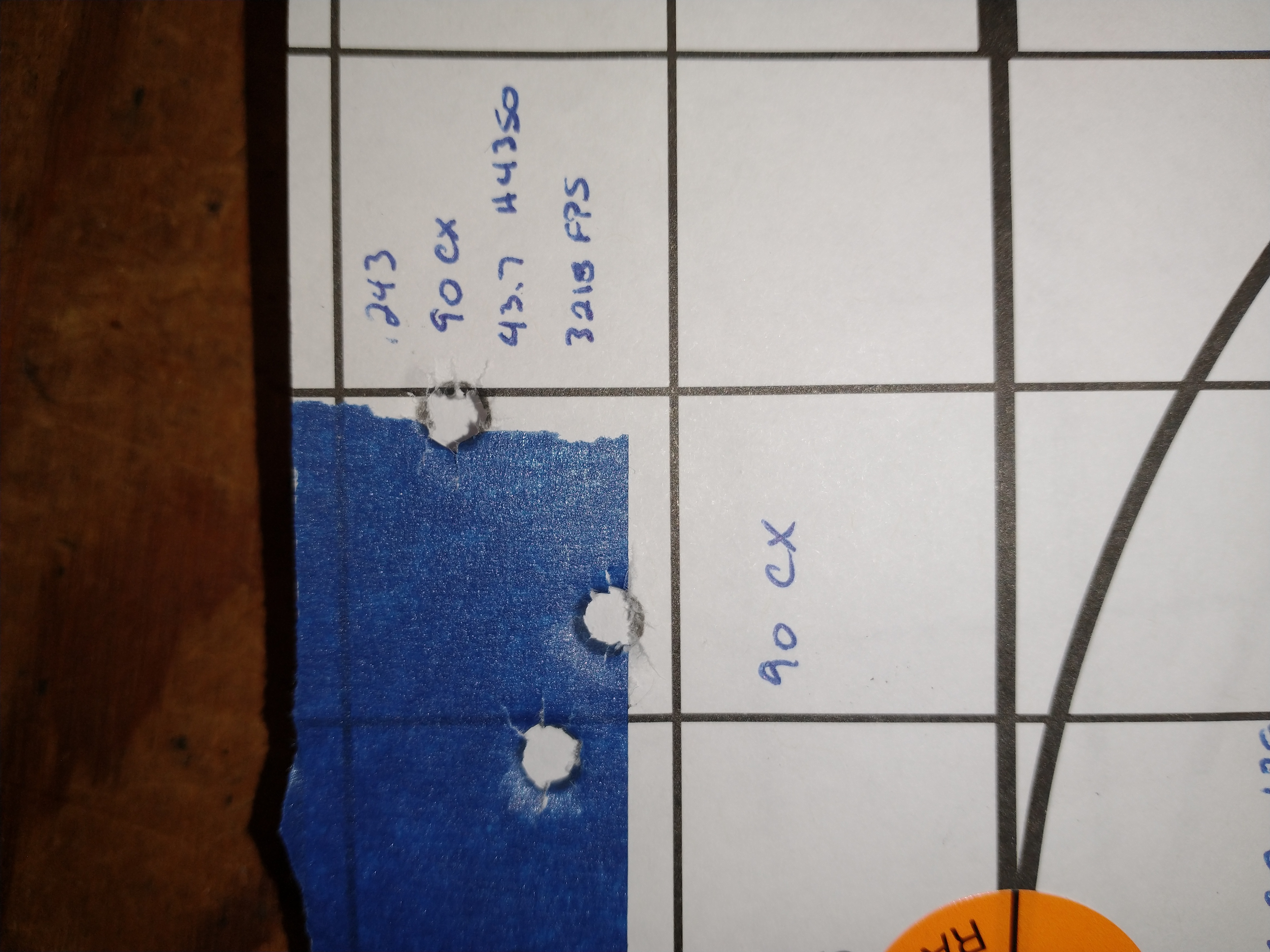

I did try a couple different loads today. I went with a 100hr InterLock load with H4831SC and 90gr CX with H4350.
The 100gr loads were a mild disappointment with lackluster groups but some decent velocities. I don't know if I want to.keep burning components chasing the 100gr option.
The 90gr CX shows potential. It looks like it wants to perform and velocity exceeded the book data. I may need to play with seating depth some with this bullet. I may also try to push this load a little and see if I can get it to 3400fps. I'm pleased with this bullet and powder combination so far. I have found with some other cartridges in the past that adjusting seating depth/jump made big differences in group size. The limit I have while still maintaining at least 0.020" off the lands is 2.870", and book length is 2.710".
Pen is book velocity and pencil is recorded velocity.

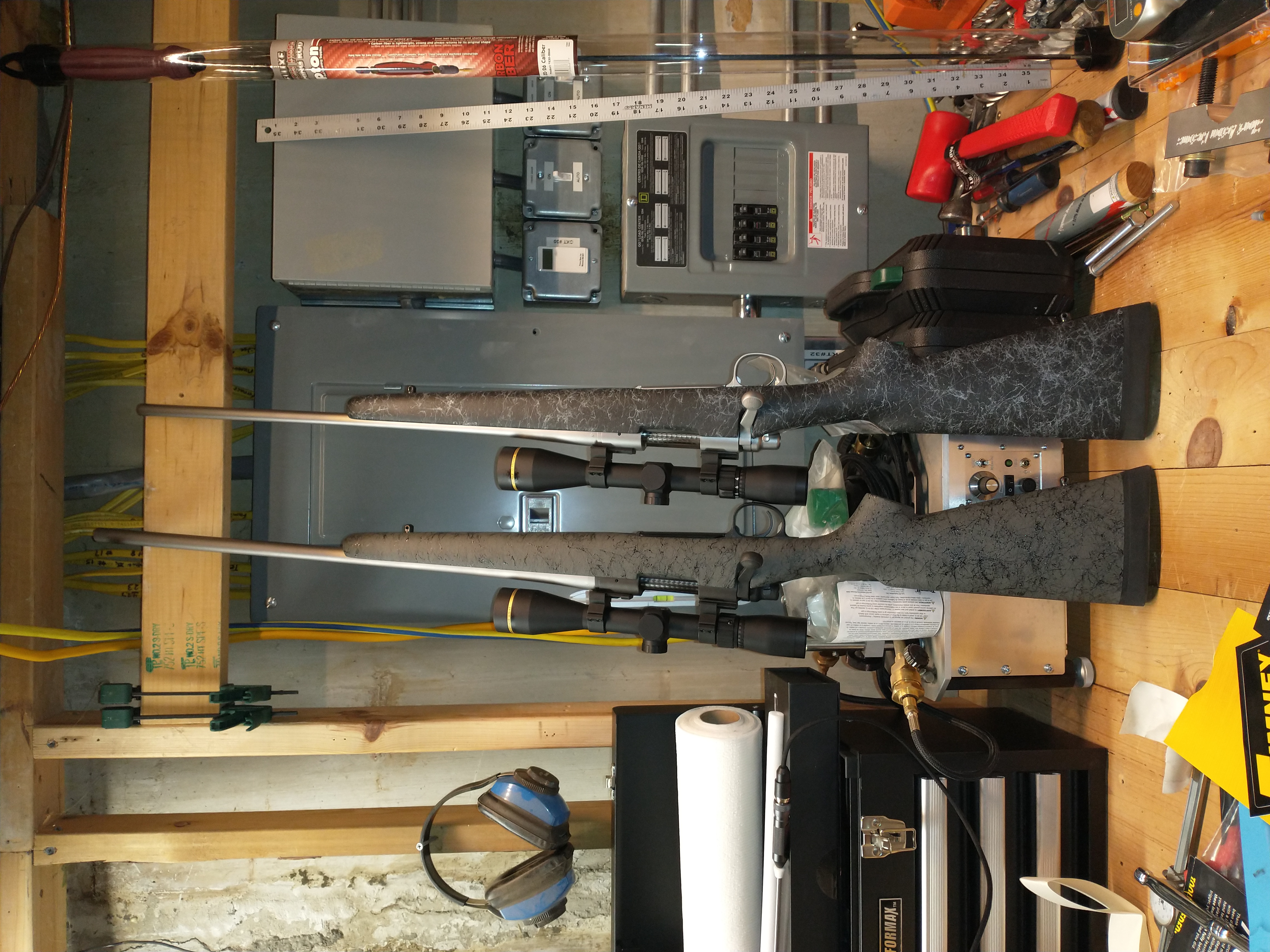

Apparently I doubled one of the target pictures before.
