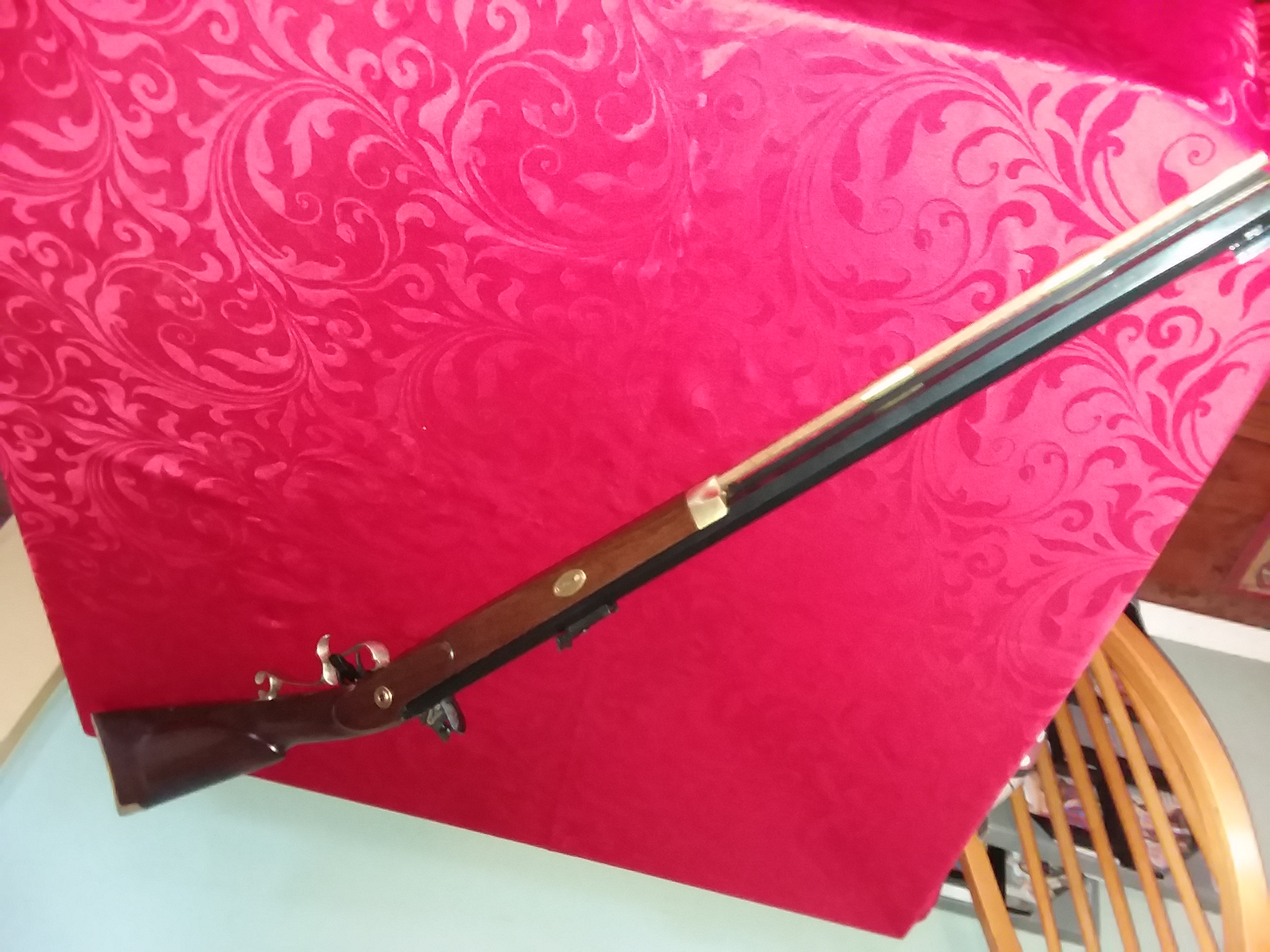

I REALLY wish this rifle was mine. Such a neat gun to shoot. And Rich (Woodsrunner) was such a damn good dude.

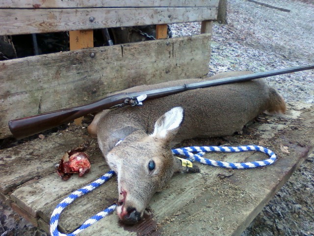

I am using 70gr of 2F and it has pushed the ball through the deer I have shot with it in this 54 cal barn gun. The Lyman great plains rifle (1:60) 50 cal I had ramped up to 90 3F because it liked it and it also pushed the ball through both sides.

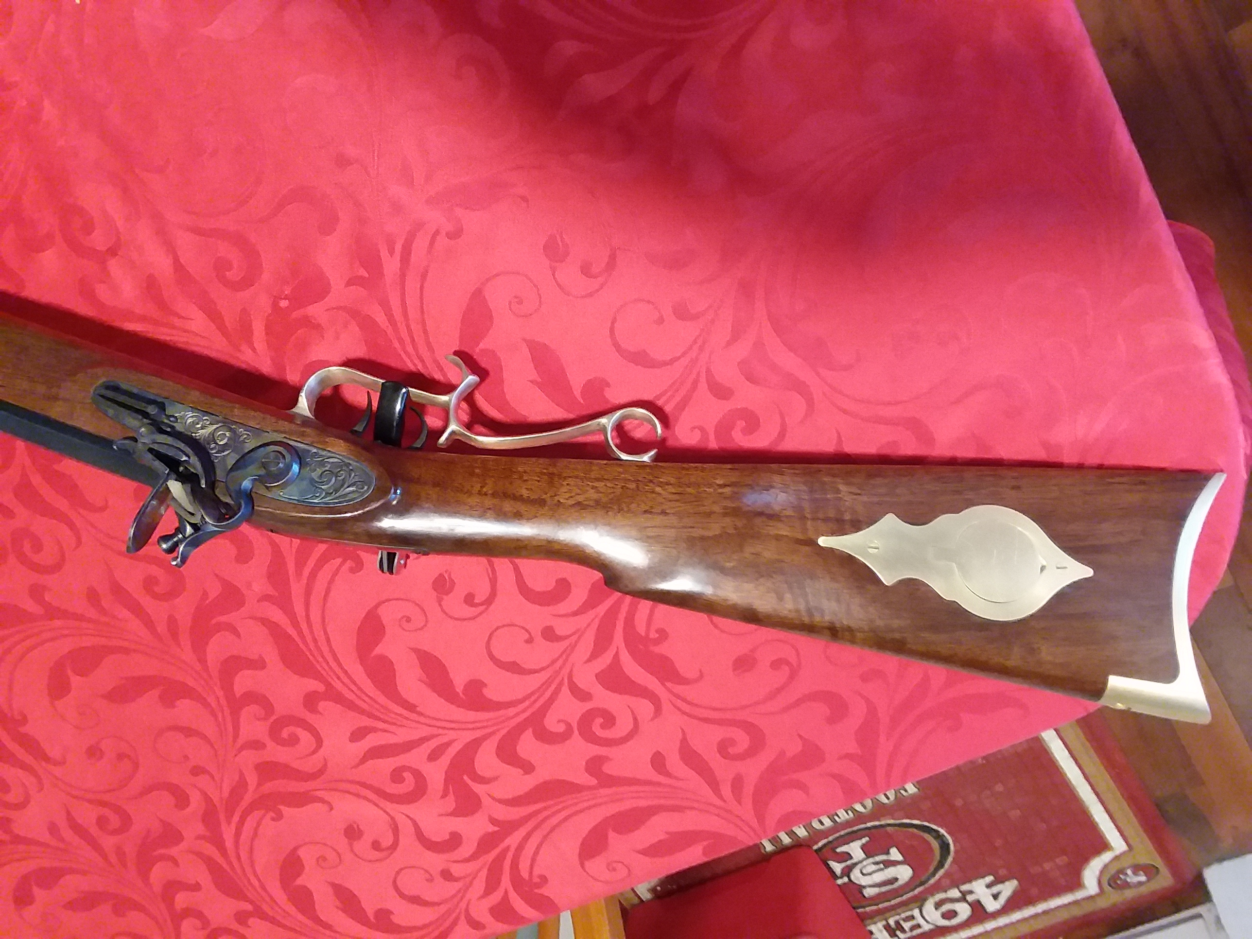

Gentleman, thank you. I have no idea why I went to another forum for answers to my quest. My humble apologizes. My hunting partner swears by sabots in his T/C Hawken, but I could not take one man's opinion, as I said before I'm "former military". After I finished building this rifle, I will start a RB load work up, starting with 50 gr of fffg going up until the accuracy suffers or doesn't improve. I watched a number of beginners videos and learned a lot, but it fell short of what you told me.
I'm a tinkerer, I salvage guns from the scrap pin or that have suffered at the hands of abuse, neglect or the USMC's Pvt 1st class Stush Bubba. The Marine Corp's very own Polish redneck mill hunky.(Sorry guys, I'm a Corpsman, 1/2 Marine) These last two Ml builds have sparked a fire in me for a slow spot and stock hunt when most folks are sitting in their beds or at work after I retire this year.
I started adjusting the wood to metal alignment this evening only to discover the wood in letting on this gun sucks! It will take a lot of bedding compound to make this a tight rifle. After spending 80 hours on a T/C, I had to do some bedding on that one but, I'm afraid I'll be disappointed with this late 70's CVA, but I'll give it my best shot, time will tell. I will have pics on the other post I started. I may just make this period almost correct, sell it and buy a Traditions Deer hunter synthetic and tinker with that, especially if it has a different twist rate. Time will tell. This ugly duckling may be a swan! I'm just not into dressing up like Jerahis Johnson or a mall ninja in a tine warp, I want to hunt.
BTW they make a ML inline that fits the AR Platform, just not FL yet!
Thanks again guys, I' be referring back to this post a lot.

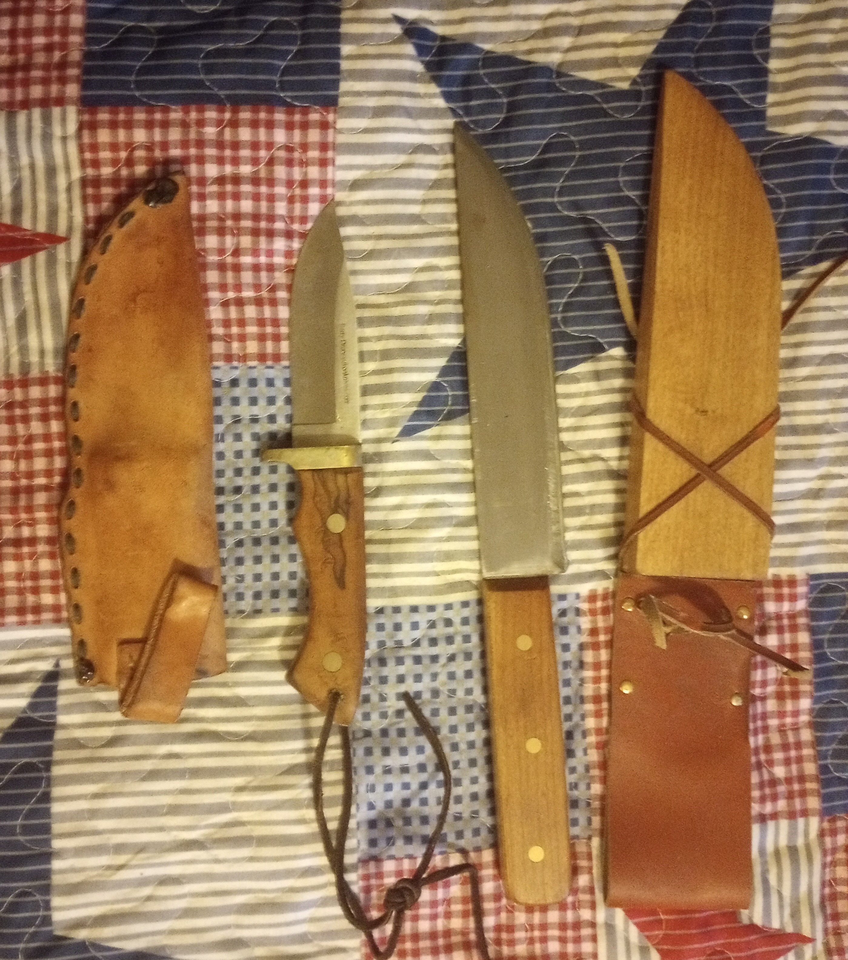

I made a scalper knife from a saw blade for the coworker I made the Hawken for. It was a very nice sharp knife with walnut grips, brass pins and a stained poplar case with a leather belt loop. It's the one on the right. I also gave him a leather fringed jacket and leather fringed case for it. He's young enough that he and his kids might enjoy that kind of stuff. Me, a nice slow quiet walk hunting in the woods will suit me just fine.
- Attachments
- IMG_20220905_090642110_2.jpg (1.78 MiB) Viewed 1946 times
- 20220402_134306.jpg (1.43 MiB) Viewed 1946 times
- 20220402_134050.jpg (1.61 MiB) Viewed 1946 times
- 20220402_134039.jpg (1.32 MiB) Viewed 1946 times
