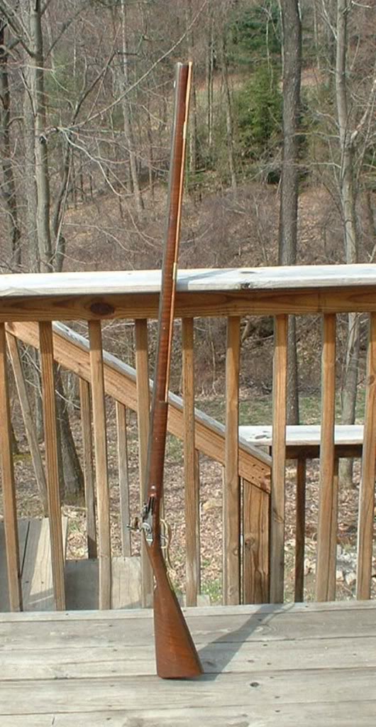

I REALLY wish this rifle was mine. Such a neat gun to shoot. And Rich (Woodsrunner) was such a damn good dude.

CPJ 2.0 wrote: Tue Feb 27, 2024 1:17 am I REALLY wish this rifle was mine. Such a neat gun to shoot. And Rich (Woodsrunner) was such a damn good dude.
I regret I only got to eat lunch with him. Wish I had morectime.
I regret I only got to eat lunch with him. Wish I had more time.
Darn fine fella.
The only front stuffer I ever shot was his
