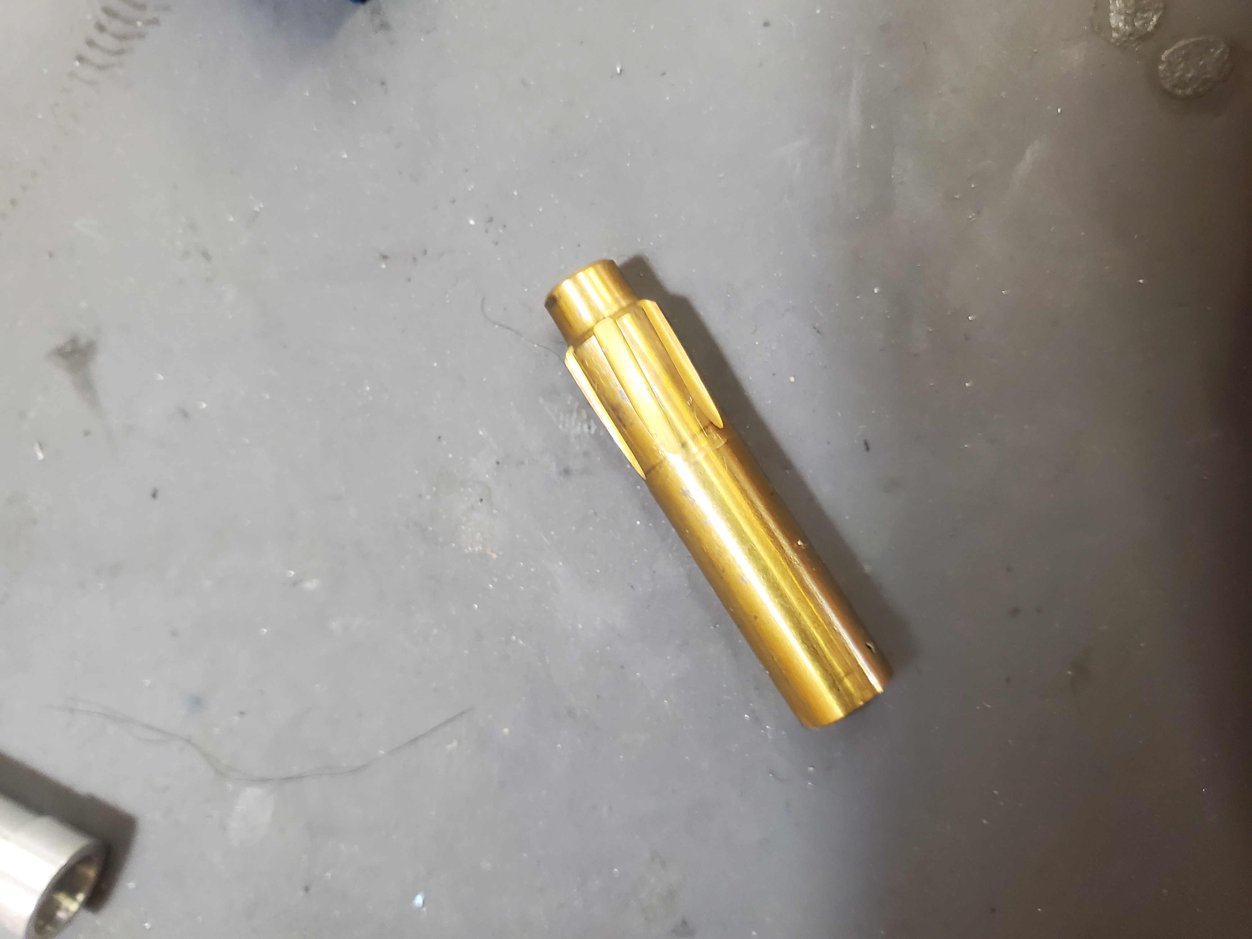

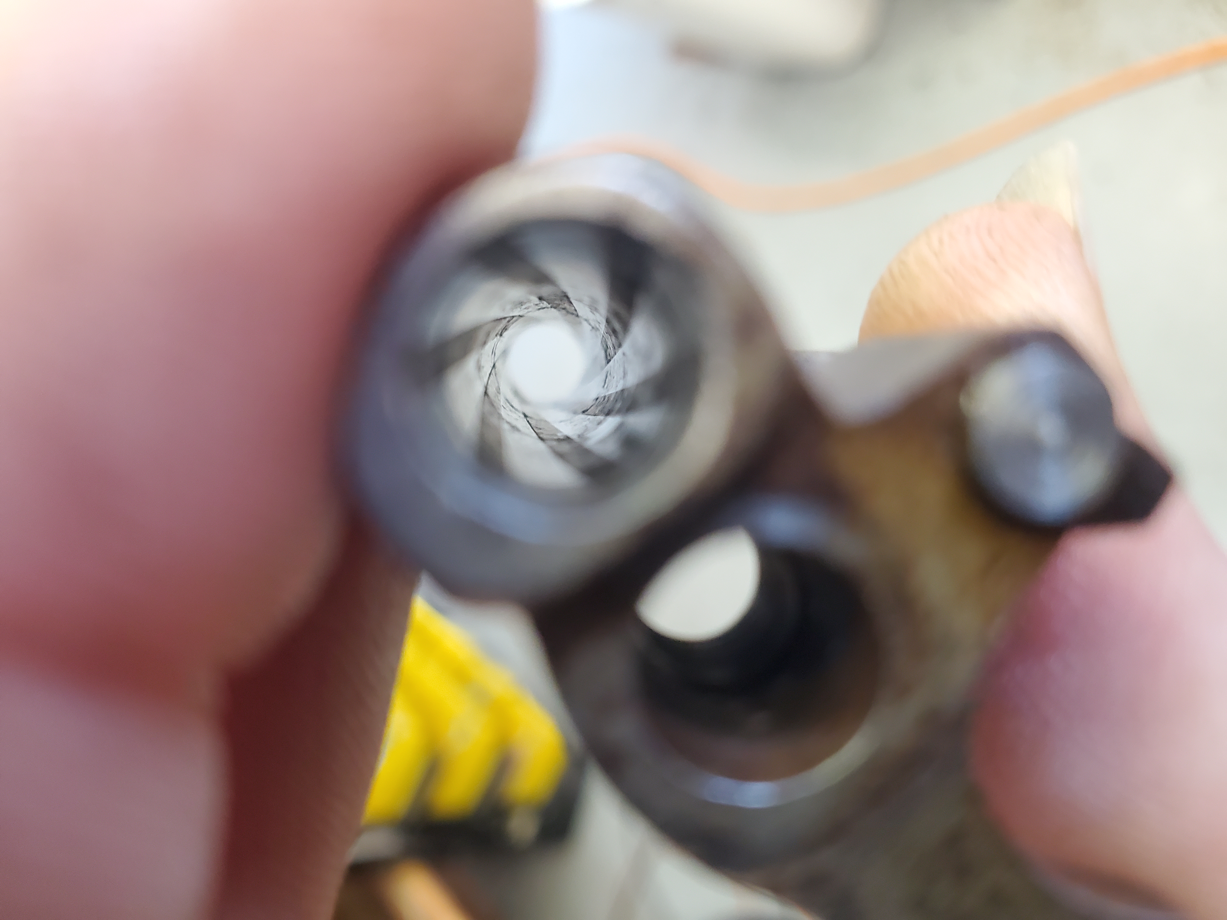

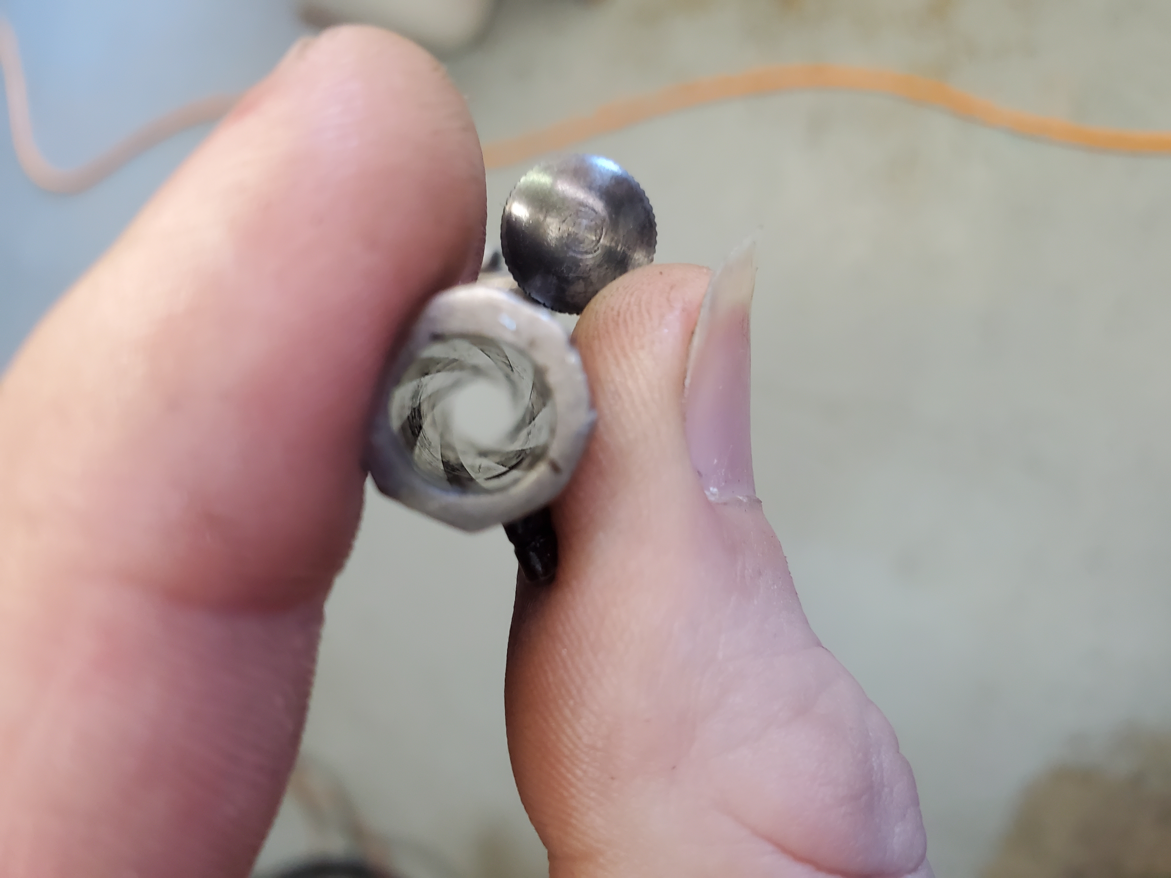

Well I got the barrel rifled. I had to hone out what damage I could, so it took the bore more open than I'd like it be prior to pushing the rifling button through it, but it's good enough for what it is.
Posts: 566
Re: I bought a weird pistola.

What are rifling buttons made of and how long do they last?
Thanks for the update!
Posts: 1310
They are tool steel with a titanium nitride coating so they should last quite a while under normal use. I did a test barrel with a piece of 12L14 steel that I drilled and reamed then used my 25 caliber button to push through and it made pristine rifling in it.
