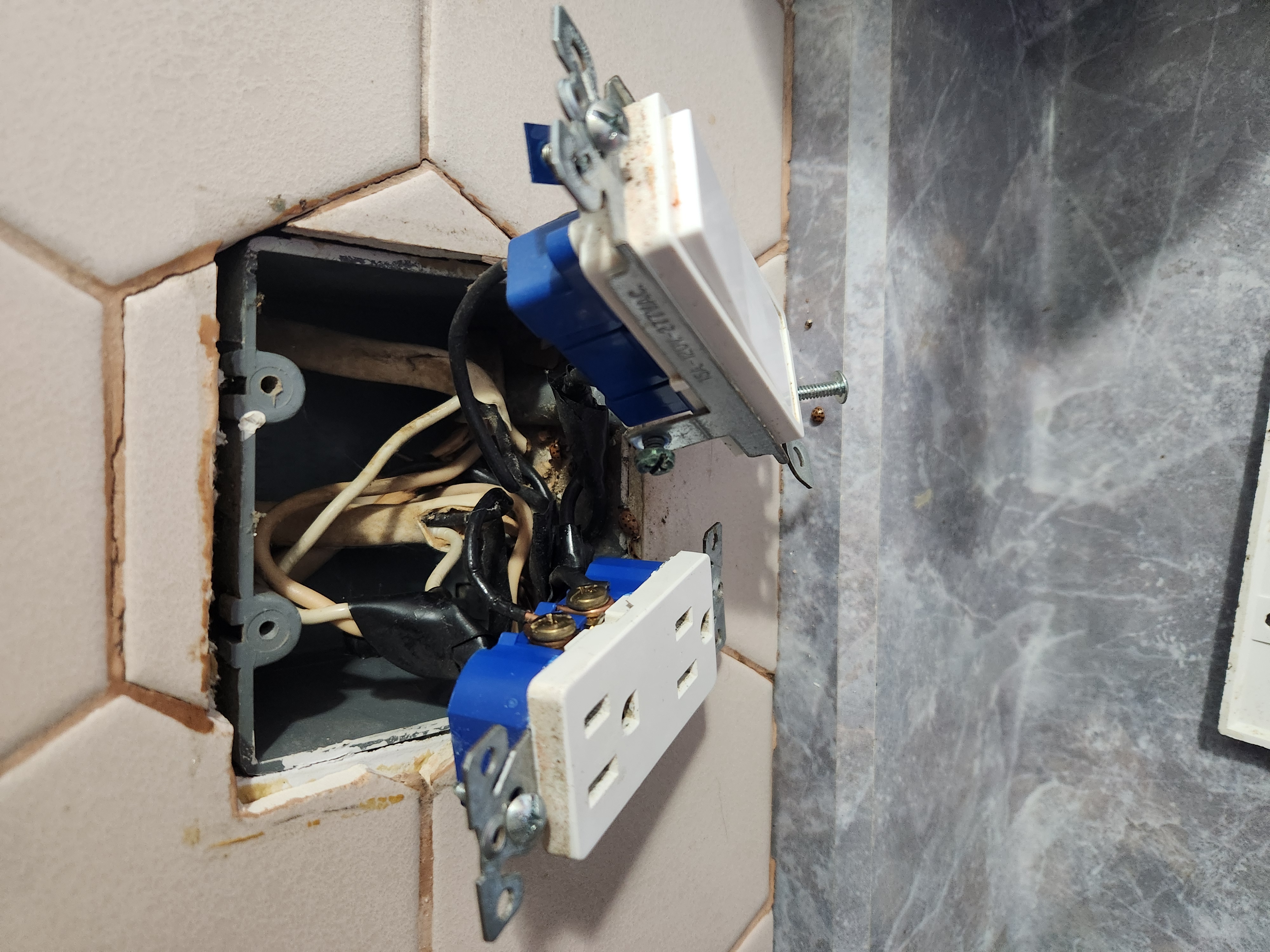

Outlet to microwave lost power. This is second one I pulled looking for source of power. First had five 12/2 neutrals in one red wire nut with no tape. This is ONLY tape....
Time to buy more smoke alarms.....
Posted: Mon Dec 11, 2023 8:58 pm
And more fire extinguishers!

Jesus. Thats some hack poop if I’ve ever seen it. Best grab a bag of wire nuts and new switches and receptacles. If one switch has the wire stabbed in the back, I’m betting other switches and receptacles do also. I’ve made a pile of money reworking outlets, thanks to the stupid/lazy

I haven't seen a stab anywhere except the light switches in the kitchen. This cluster fudge is where they ran the power to the microwave over the stove and replaced switches and outlets in the kitchen with the rockers and square outlets. Rest of the house is normal switches.
My stepson is in the 'biz'. I have like six 5# extinguishers and four 10#ers....... free
SIx wire nuts and three jumpers and everything works again.

I am not an electrician but even I would not think that looks right. I usually do my own wiring and on occasion my son, electric engineer, looks at my work and criticizes it.

It’s easy! Black wires go on the brass connector. White wires go opposite. Ground ago to the case.
GFIs can be daisy chained so a single GFI can protect multiple outlets if wired correctly.
Often when wiring is added outlet boxes and switch boxes are used as junctions rather than stringing a home run cable to the main box as it should. If there is attic access that shouldn’t be a problem but it does take more wire which is expensive these days.
