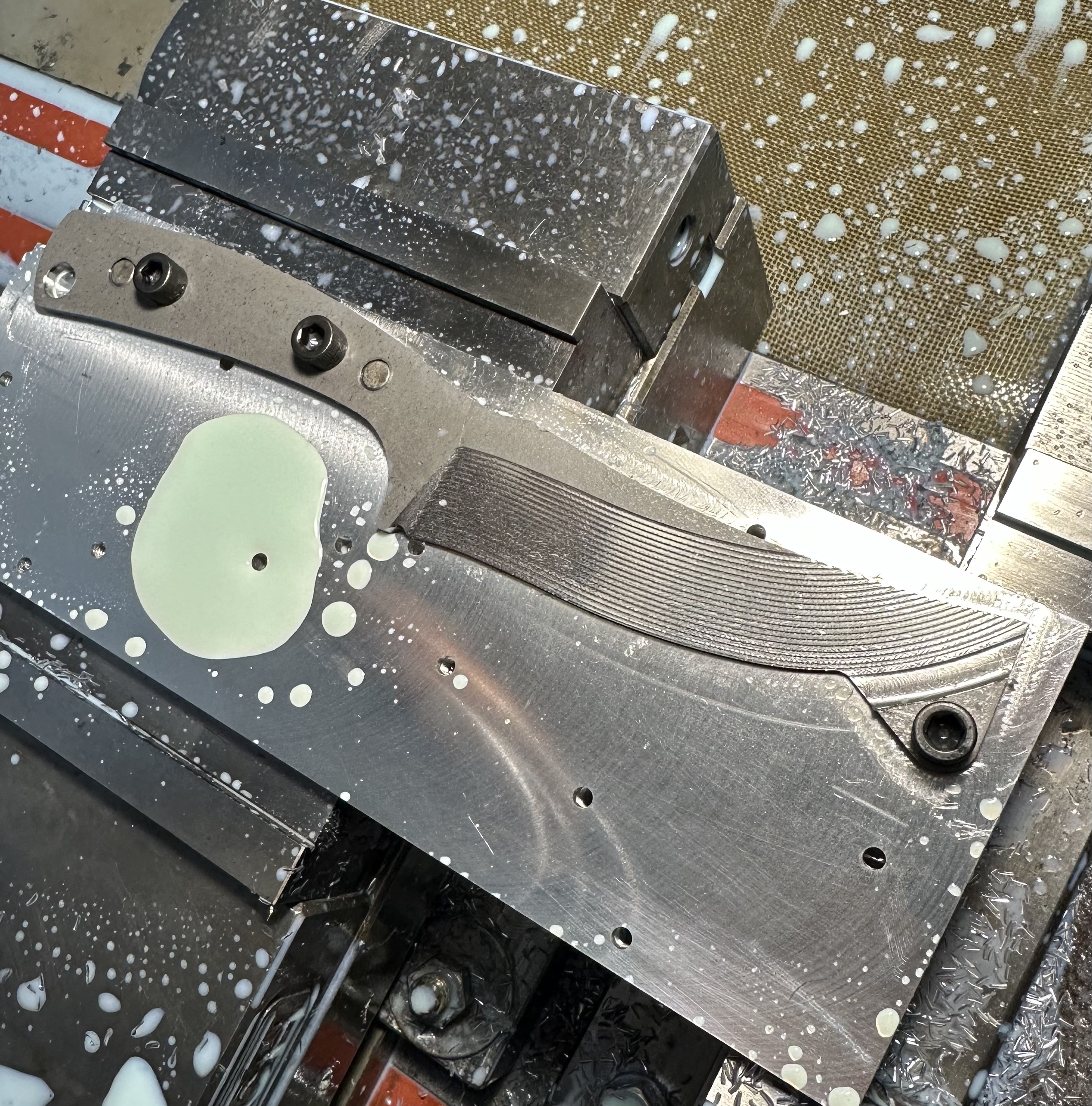

I actually like the blade with the z axis step-down pattern instead of being ground flush on a belt sander or however the hell it's done. Gives it some character.
Posts: 4268
Justsomedude wrote: ↑Mon Feb 19, 2024 1:56 am I actually like the blade with the z axis step-down pattern instead of being ground flush on a belt sander or however the hell it's done. Gives it some character.
Its a feature, not a bug. :lol:
I like it also though. at first the stepover was a little too great, left too much "texture." Once its bead blasted and tumbled it will be pretty awesome I think

Almost looks like a Damascus-ish pattern. You gonna sell these or just dickin around with a few? I'd be interested in one.

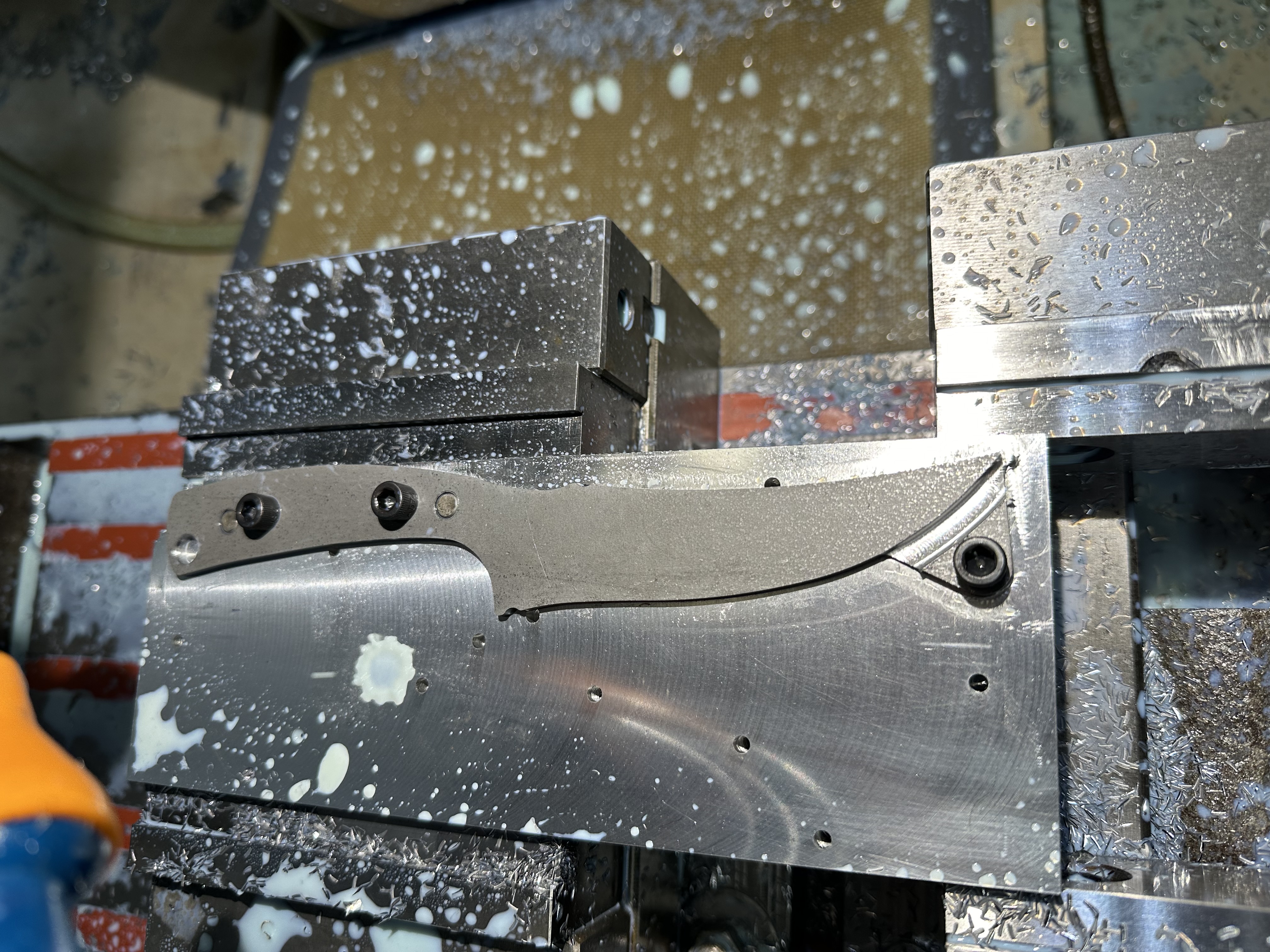

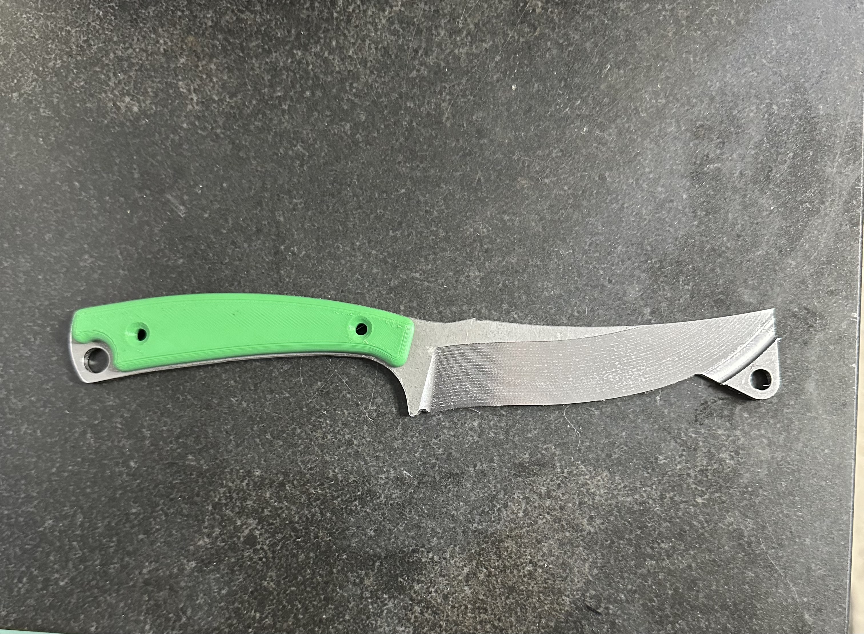

But heavy on the dickin around part. Ill see how the first batch goes. The machining is....mostly down. Im gonna have to phone a friend again for a tweak. Because the way it cut the bevel on the second side looks like it was programmed by a tweaker.
So machining SHOULD be easy. If this garbage steel (used hardware store stock because it was cheap to test) did as good as it did, the good stuff should be better. Finishing I dont for see any issues. Bead blast then tumble. Then heat treat. Maybe not in that order. The heat treat doesnt scare me, but it can make a nice flat knife into a banana quick fast in a hurry.
Scales shouldnt be horrible, but the design is still pending. The nice thing is that I will be able to swap scales at will. Not sure how much fun milling micarta will be, but I guess I will find out.

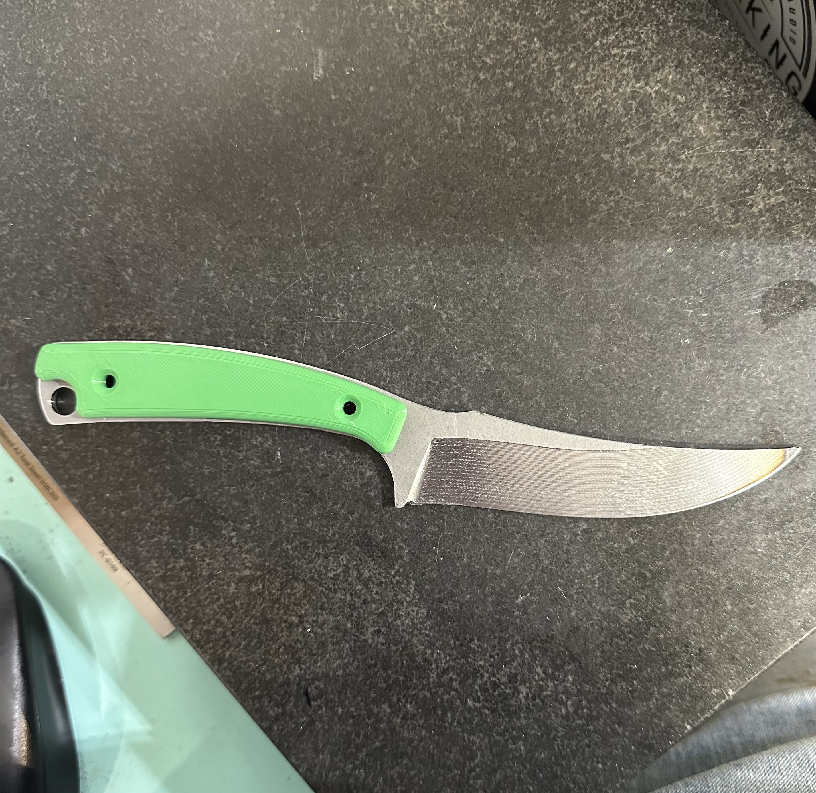

That’ll do pig, that’ll do.
Posts: 1344
Jeebus, you got a DAMN good finish for some gummy 1018 from Blowes or the depot. Thatll be fantastic in a high carbon content steel. Let me know when you get it dialed in and please leave the step over finish in mine 😁

Justsomedude wrote: ↑Mon Feb 19, 2024 3:20 am Jeebus, you got a DAMN good finish for some gummy 1018 from Blowes or the depot. Thatll be fantastic in a high carbon content steel. Let me know when you get it dialed in and please leave the step over finish in mine 😁
Yeah, I was shocked how well it finished. Didn’t expect that AT ALL. I even sharpened it. It slices the tip of your thumb quite nicely.

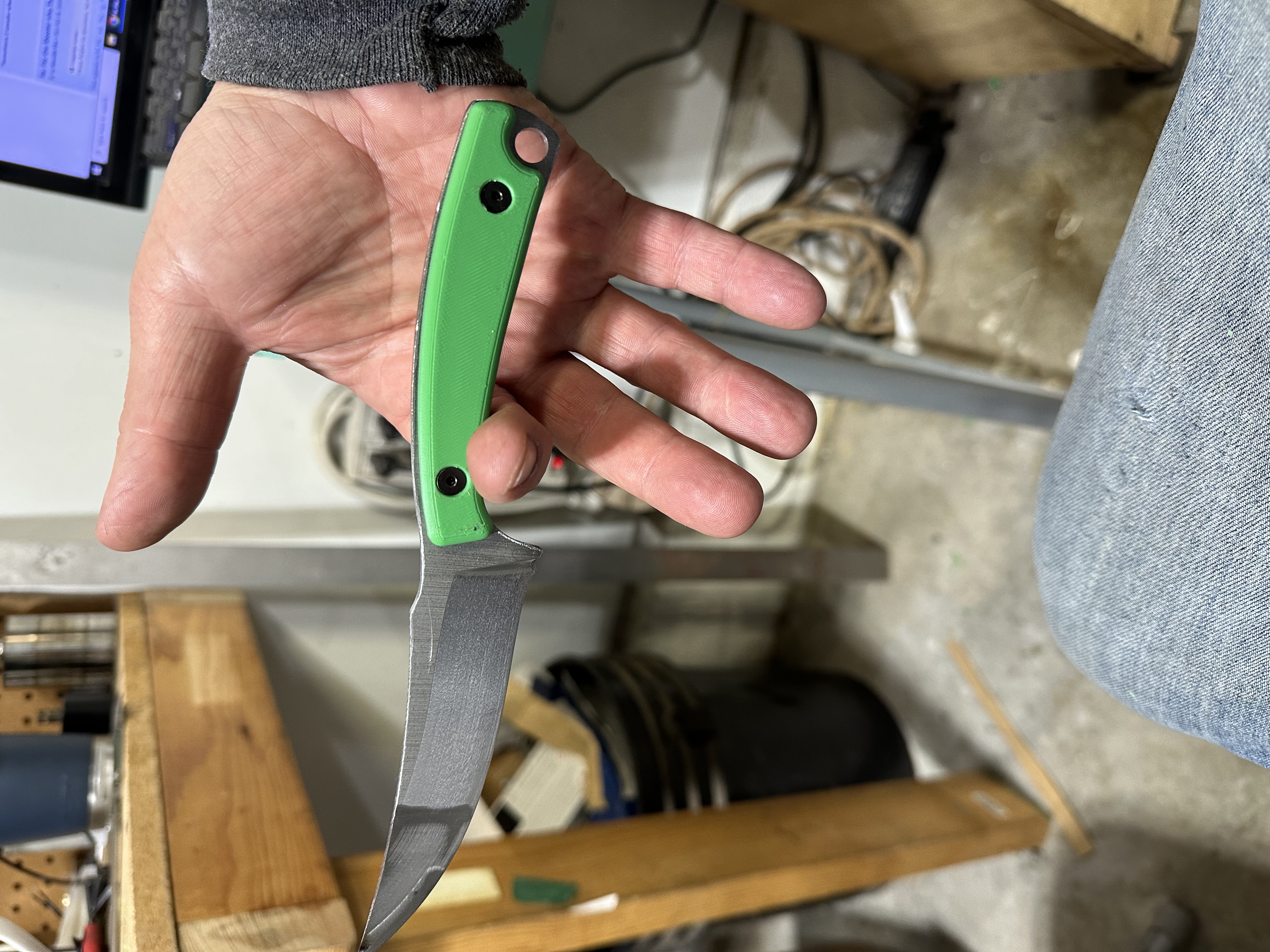

Haven’t figured it out just yet. But below $669. 😬
It’s well balanced. Don’t mind the ugly on the blade, I was grinding the tab away.
