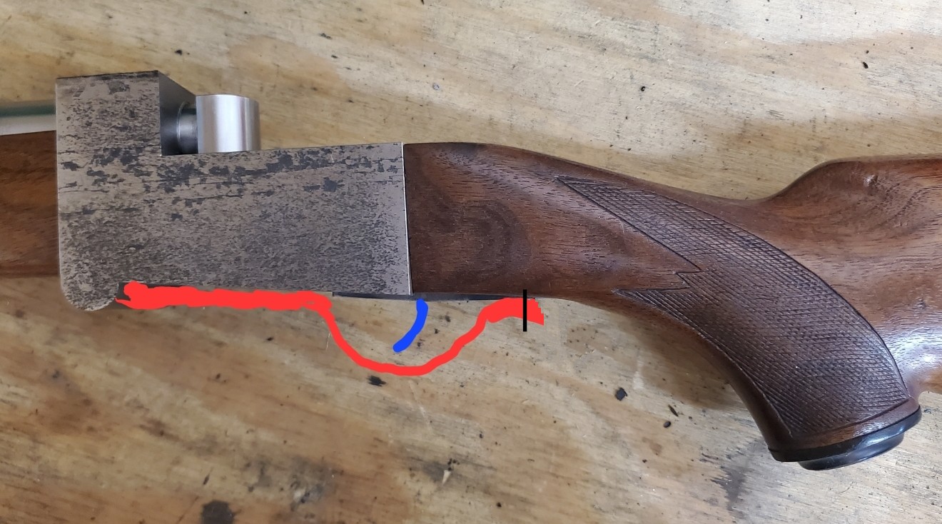

sakodude wrote: ↑Wed Jul 02, 2025 9:05 pm Martini-henry style. you could make it long enough to blend with the curve of the stock.
That was my original idea but I'd have to get rid of the grip cap/protrusion or else it'll look weird.

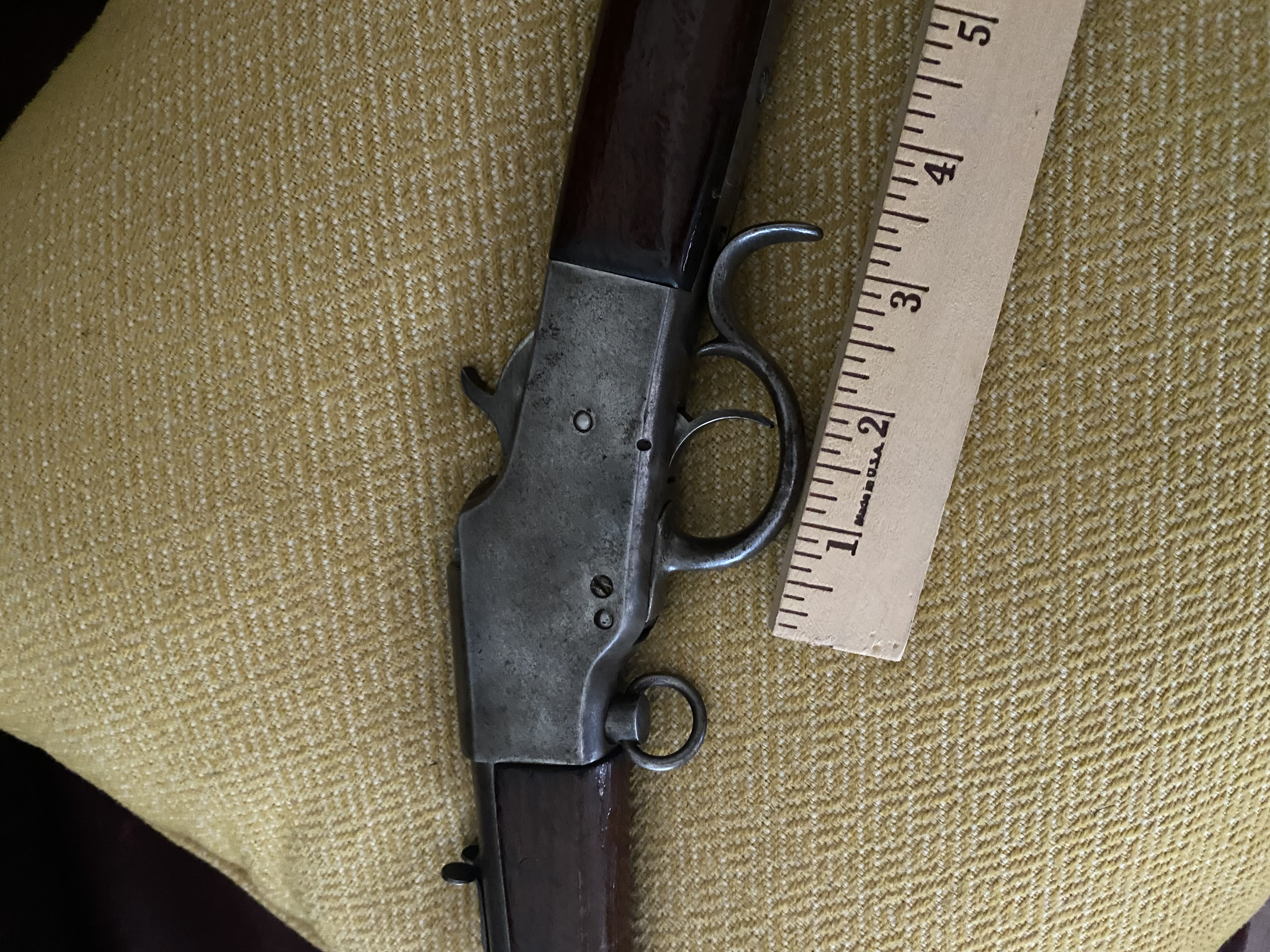

This is the lever on my Hopkins & Allen Junior 922.

Re: Pinfire rifle.
That's what I was going for in my last sketch. I think that would look good with my style stock.

Posts: 2324
Re: Pinfire rifle.
Looking better, but I'd do away with the bent down "tail" at the end
Posts: 1339
Re: Pinfire rifle.
I just thought it would give a positive purchase to get it past the detent.
Posts: 2324
Re: Pinfire rifle.
Justsomedude wrote: ↑Thu Jul 03, 2025 2:48 am I just thought it would give a positive purchase to get it past the detent.
You're doing the designing and building, so feel free to do as you wish.
You asked for ideas/input, so I figured I'd put mine out there. It's worth everything you paid me for it ;)
Making the trigger guard large enough to hook your thumb in it would serve the same purpose, I'd think though.

For the lever, look no further than the Winchester 1885.
Posts: 572
Re: Pinfire rifle.
Experiment with a slightly longer, more “gentle” curve.
Posts: 2324
Re: Pinfire rifle.
Bigslug wrote: ↑Thu Jul 03, 2025 4:17 am For the lever, look no further than the Winchester 1885.
I looked at a pic of one. I like the 1884 Sharps better :P
Though from JSD's drawing, it appears he likes the 1885's style better
There's no accounting for taste, which is probably why I'm in the minority of people here that demands my 1911s have an arched MSH ;) (Depends on who you ask whether I'm the one WITH or WITHOUT taste because of that ;) )
Posts: 4390
Re: Pinfire rifle.
On the last picture, recoil will drive your hand into the lever and pop it open. Also looks like a knuckle rapper to me. I think your original direction was correct or go with the 922 design to allow your grip hand to help lock down the lever.

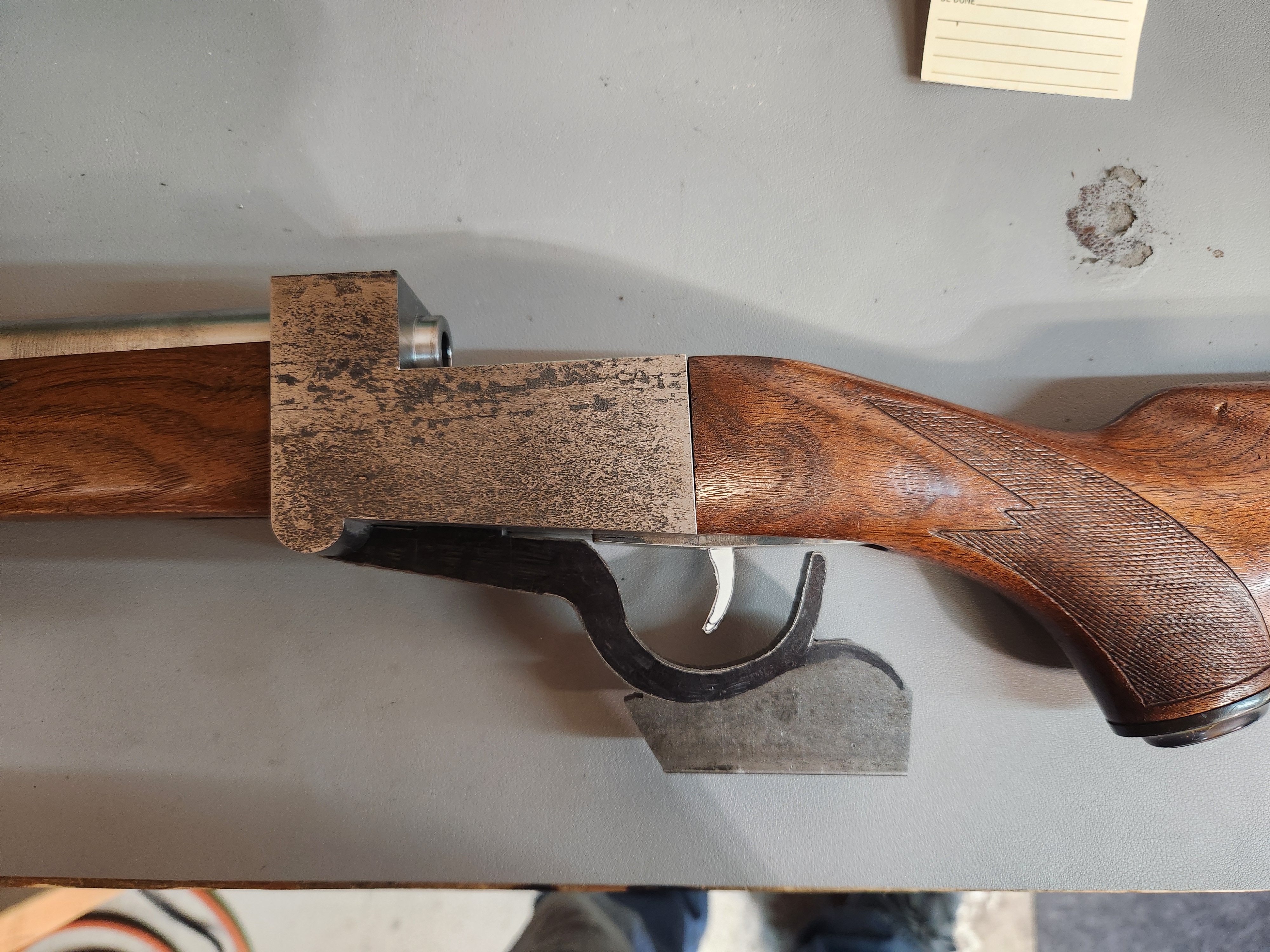

I finally gathered enough time to pick this project back up. The lever is 4140 that's 3/8" thick. I rough cut it but my bandsaw blade had to snap and leave me with the chunk that you can see in the picture, and I'm out of replacements. It'll obviously get filed and contoured nicely, but I'm pretty happy with the overall shape of it and it clears my fingers very well, even the tail of it. The rest of the build should go pretty quickly from here.

Thank you. It'll look much better once I file to my scribe lines and do the contouring as well. It's grossly oversized right now.

Oh yeah, an updated picture.
