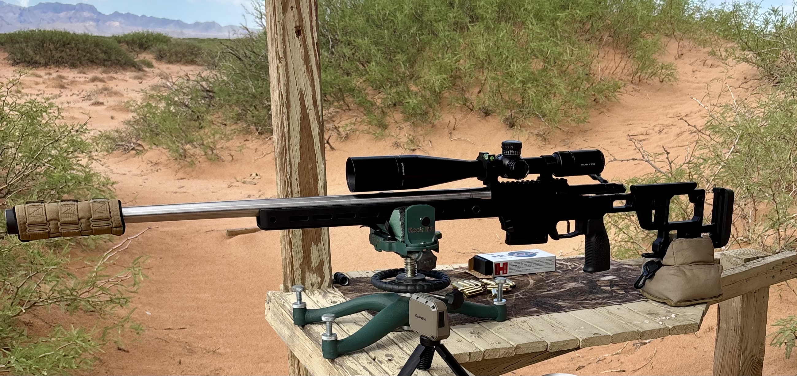

I picked up a box of 147gr Hornady Match ammo yesterday and decided to take the new rifle out for a test session. I ordered brass, bullets and powder for it and am waiting for it to get here. But this allowed me to measure the necks of loaded ammo to get an idea of what size bushings Im going to need for my sizing die. The test run also allowed me to get the scope mostly zeroed and get some rounds through the barrel.
I boresighted it the best I could, being rather difficult to do since the chassis limits the ability to look through the bore. With 20 MOA on the rail, I knew it would need a good amount of adjustment down to start. I dialed 20 MOA down and was able to tell I was at least on cardboard at 100 yards. Fired one round at the center of the cardboard and used the reticle to determine it was 6 MOA high and 1 MOA left. So I dialed that and the second round hit the 1” target paster. Then started shooting for groups with the rest of the box of ammo. The groups moved a little low and left after a few rounds. I dialed for that once it was consistently hitting the same spot.
Every group fired was 1” or less, with several groups being one ragged hole plus a flier. Mostly shooter error, getting used to the rifle. Probably a little being the factory ammo. While it shot good, extreme spread and standard deviation was a tiny bit high for what I would like. Average velocity was 2920 fps.
Here are the best two overall groups of the day. It’s a good start, got me some info to work with and an extra 20 pieces of brass.

My little scrap lumber bench also isn’t long enough for this rifle. At least with my front rest. Couldn’t get the rest as far forward as I would have liked. I think that brought in a little instability.
The rifle doesn’t move up at all during recoil. It’s just a little shove straight back.

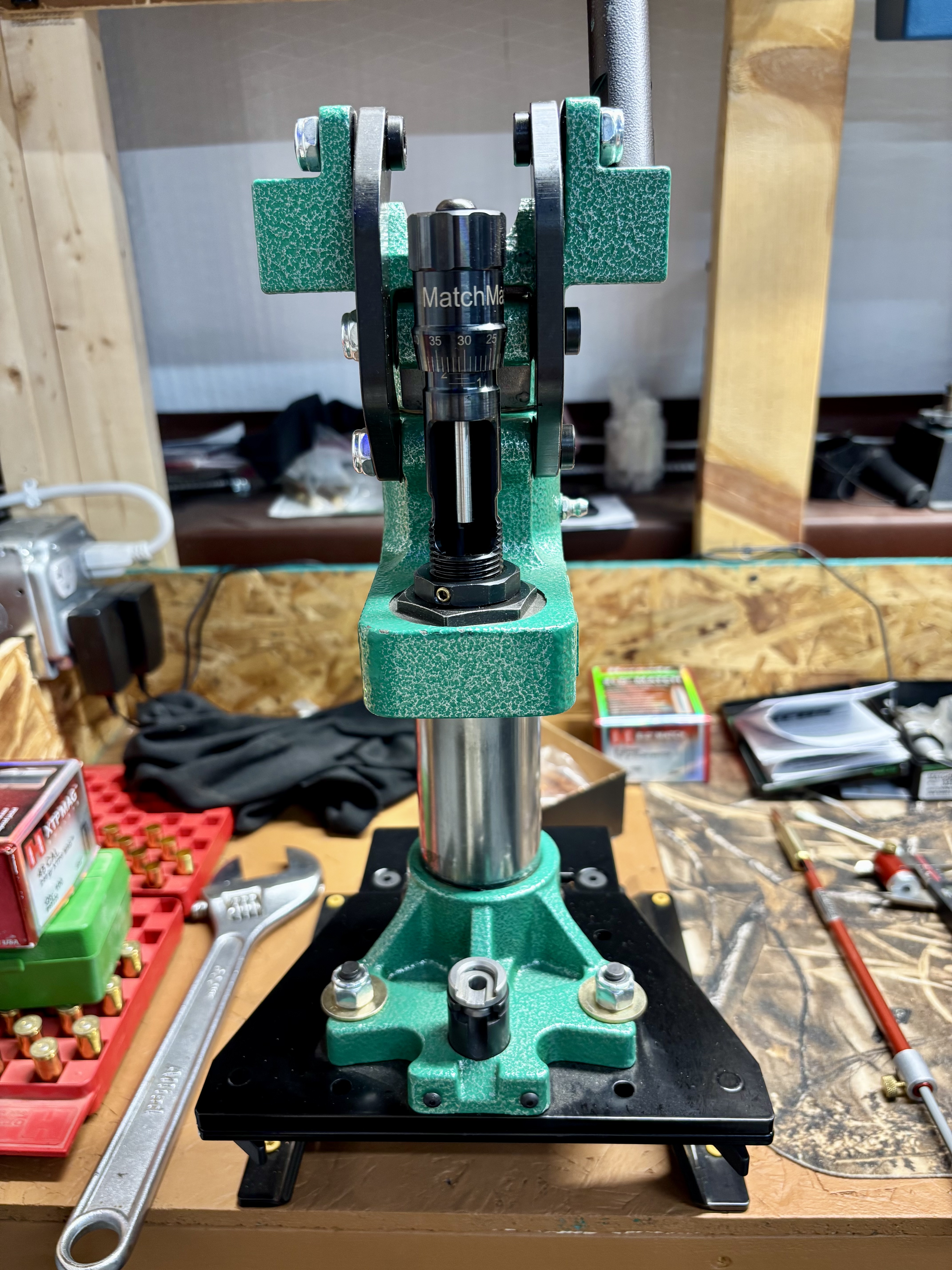

I finally got all the stuff together I needed and got some test loads ready to try. Using Hodgdon data, max load with this bullet and powder is 59.5gr. I’ve measured the length from base to ogive to the lands and Im seating .031 off the lands. That number just to make the loaded length a round number. Probably a good bit shorter than it needs to be and could move it out closer to the lands. But still a bit longer than book OAL and gives me some room to fine tune if or when I find a load that seems worthy of working with. While they do fit in the magazine, it isn’t practical to do so. Pushing them into the mag is already putting pressure on the polymer tips. So they will be single load rounds. If I end up seating any longer, they won’t fit in the mag at all.
I’m starting off trying Winchester StaBall HD. Because that’s what was available right now. Primers are Federal GM210M. Brass is new Hornady. Bullets 147gr Hornady ELD Match.
Im not sure when I’ll take it out to try them, but they’re loaded. Also, in case of an outsider looking in, I’m obviously starting close to max and working slowly above max. Don’t try this at home…
Re: New project underway
Posted: Fri Aug 01, 2025 4:08 pm
by Jay
The rig I’m using to seat is an RCBS Summit press and Matchmaster seating die. Until now, I’ve only used this press to size brass. It seems to be working very well for this job.

Finally took it out and tried my hand loads. I was glad to see it shoot better than factory ammo and a bit more velocity. Definitely gives me something to work off of. The rifle still only has 35 rounds out of it. This barrel is shooting great. Several loads before this shot good. I still had loads at 60.0 grains that I didn’t test. The barrel got hot and I didn’t have enough time to cool it down. No pressure signs so far. Hard to beat sub 3/8” while exceeding factory ammo velocity.
Fwiw, all my hand loads were better than factory Match ammo. All under 1”. I worked up in .2 to .3 grains to this one and called it for today.
More to come as I tweak loads for it.

The only thing is, while that was the best group out of all my loads, it’s also the one that my chronograph only picked up one of the rounds. That velocity was it. The group before at 59.5gr shot just over 1/2”. The chronograph picked up all of them at 2932fps avg with a spread of 43.1. So I’ll load more at 59.7 and try to get more data on it over a longer string. If it stays consistent, that will be the load.
At this point, it’s not about trying to get it to group any better. Changes in group size at under 1/2” is far more dependent on me than the loads. I’m looking to keep groups close to that size and be as consistent as possible on the chronograph.
Things could also still change as I put more rounds out of the barrel. It still only has 35 rounds out of it.
