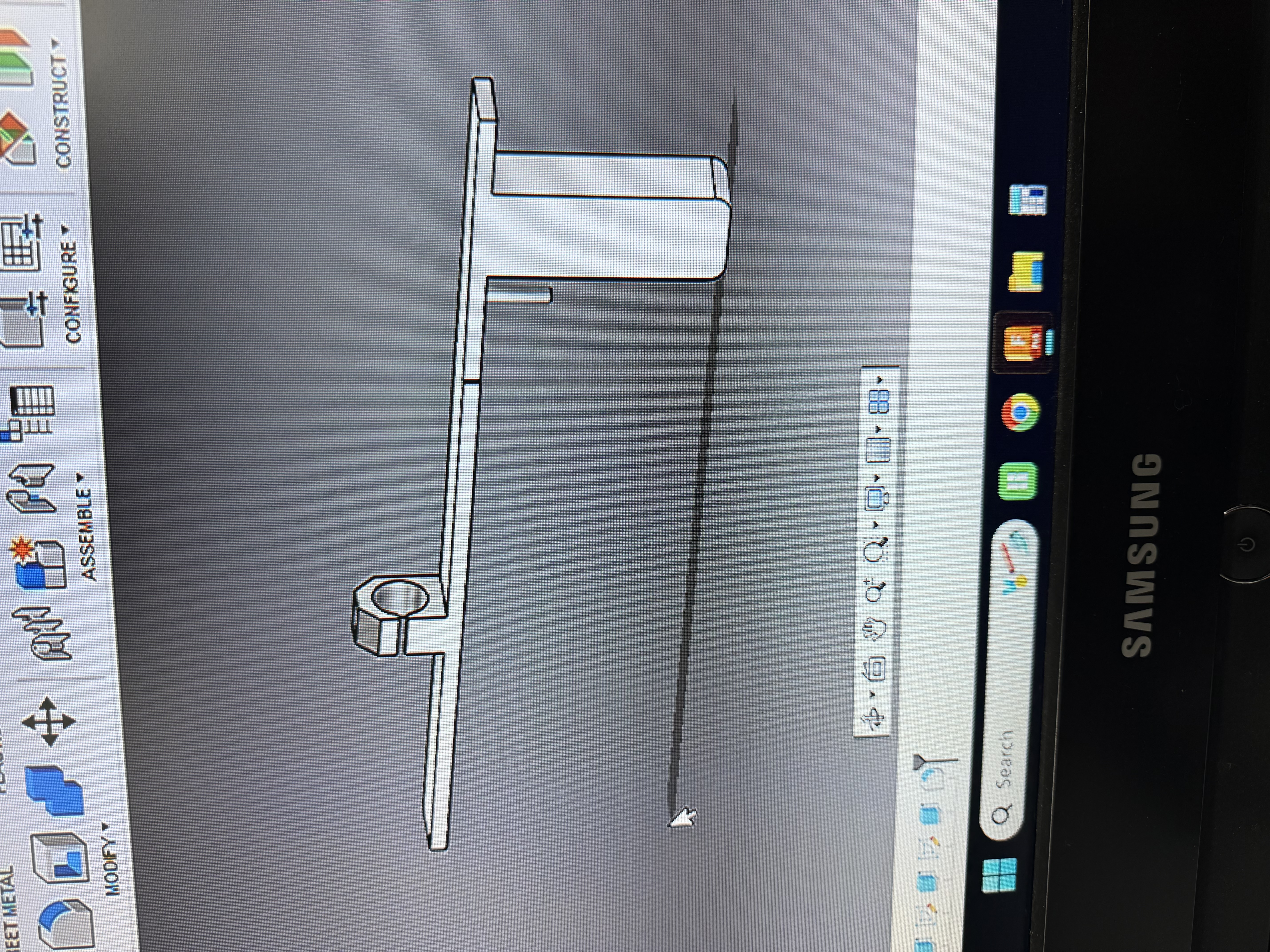

So. Development continues. Since I suck at CAD modeling, I do things in multiple steps. Rather than do one drawing producing a completed result, I instead make several 3rd grade level blobs, then stitch them together, improve one till it works, or start fresh to unclutter the design tree in Fusion. (The design software)
Such as this “masterpiece”.
Shown is the barrel clamp, which will be ahead of the action, the base, the trigger and grip. (Block and rod) Trigger and grip are simply there for a visual representation of the space I’m dealing with.
Breaking it down though, that’s a large chunk of the chassis “design” done. It’s a flat bar with a block mounted to it.
Here we enter the DFM process, (design for manufacturer) choosing not what will be made, but how. This could go two ways. In a store bought chassis, they start with a billet of aluminum (billet aluminum isn’t a grade of aluminum, much to the chagrin of internet folks, it refers to a solid block…I digress) and machine away everything that doesn’t look like a chassis. That’s a lot of waste, and would require a $pendy chunk of material. I’ll be making the base, the sides, the barrel block, the trigger guard, and the arse end block which will integrate the grip attachment point, as well as the stock all separate. Then bolt it all together. Had the idea for years, finally have something where I know it will work.
Posts: 2361
Re: New .22.
Impressive Chris (tips hat at computer screen)

Posts: 1345
Re: New .22.
You've probably told me, but which program is that? I use tinkercad and have gotten really good with it, but it could use some better features than it has.

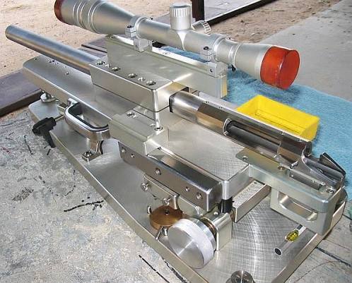

So tell me why we’re free floating the receiver? That’s a new one on me.

Justsomedude wrote: ↑Tue Sep 16, 2025 10:07 pm You've probably told me, but which program is that? I use tinkercad and have gotten really good with it, but it could use some better features than it has.
Autodesk Fusion. Free to hobbyists. Just say you’re a hobbyist. 😬
The hobby license is limited function, but not limiting for hobby/homeshop/frugal users. Mainly on the file storage, and especially on the CAM side, but if you aren’t using my a CNC machine, that doesn’t matter. If you are, there’s ways around things. Even without getting around things it’s not horribly limiting in your abilities, more in time saving and convenience. For instance I can make an operation to mill a block round, and drill 3 different sized holes. Paid version lets me do just that in one operation. It does the thing, then pauses. Change tool. Repeat. Free version that would be four totally separate programs. Which is starting and dropping each one, and changing the tools. There’s ways around it, just takes some work.

Wambli Ska wrote: ↑Tue Sep 16, 2025 10:39 pm So tell me why we’re free floating the receiver? That’s a new one on me.
Cause I saw it on the internets. 😬
I’ve seen some bench guns set up that way, and that’s how I’ve seen a lot of the guns I can’t think of the name that are basically an action and barrel clamped in a vise. I’ll have to find a pic.
But the main reason is, I need something to do, and want something different. Will it be better than regular? I dunno. We’s fixing to see.

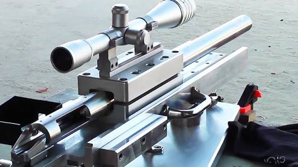

Posts: 1345
Re: New .22.
Rail guns?
Posts: 1345
Re: New .22.
At least I think that's what they're called. Either way, those things will shoot ridiculous groups that put benchrest guys to shame. I guess I'd expect that for removing the human element though.

Justsomedude wrote: ↑Wed Sep 17, 2025 12:28 amRail guns?
That’s the one.
Posts: 4534
Re: New .22.
Cool!!! Thanks for the explanation. Makes for potentially interesting science for sure and I learned something new today. I have some “parts guns” that I might have to look at in a new way.
Posts: 2361
Re: New .22.
Yep, rail guns.
I've gotten to "shoot" one, once.
They are the penultimate 1 trick pony. Weighing in at up to 50 lbs, they're great for shooting TINY groups (0.039" 5 shot group, 0.1262" 5 group agg)* , but pretty much worthless for anything else.
*Group size and agg pulled from here: https://bulletin.accurateshooter.com/20 ... s-it-gets/
I've seen it done to 10/22s with bull barrels also, because the steel barrel is a LOT stiffer than an aluminum receiver, so bed the heavy ass barrel and let the action "float"
Posts: 4305
Re: New .22.
GrapeApe wrote: ↑Wed Sep 17, 2025 1:54 am Yep, rail guns.
Pfffft. It’s the perfect walk around hunting gun.
Like you’d have to walk around the truck your hauling it in to get in posistion to shoot. 🤣
But, you could make eyeball shots, very accurately. Or choose which nostril you wanted to send a bullet in. Or, make the perfect Texas heart shot.
