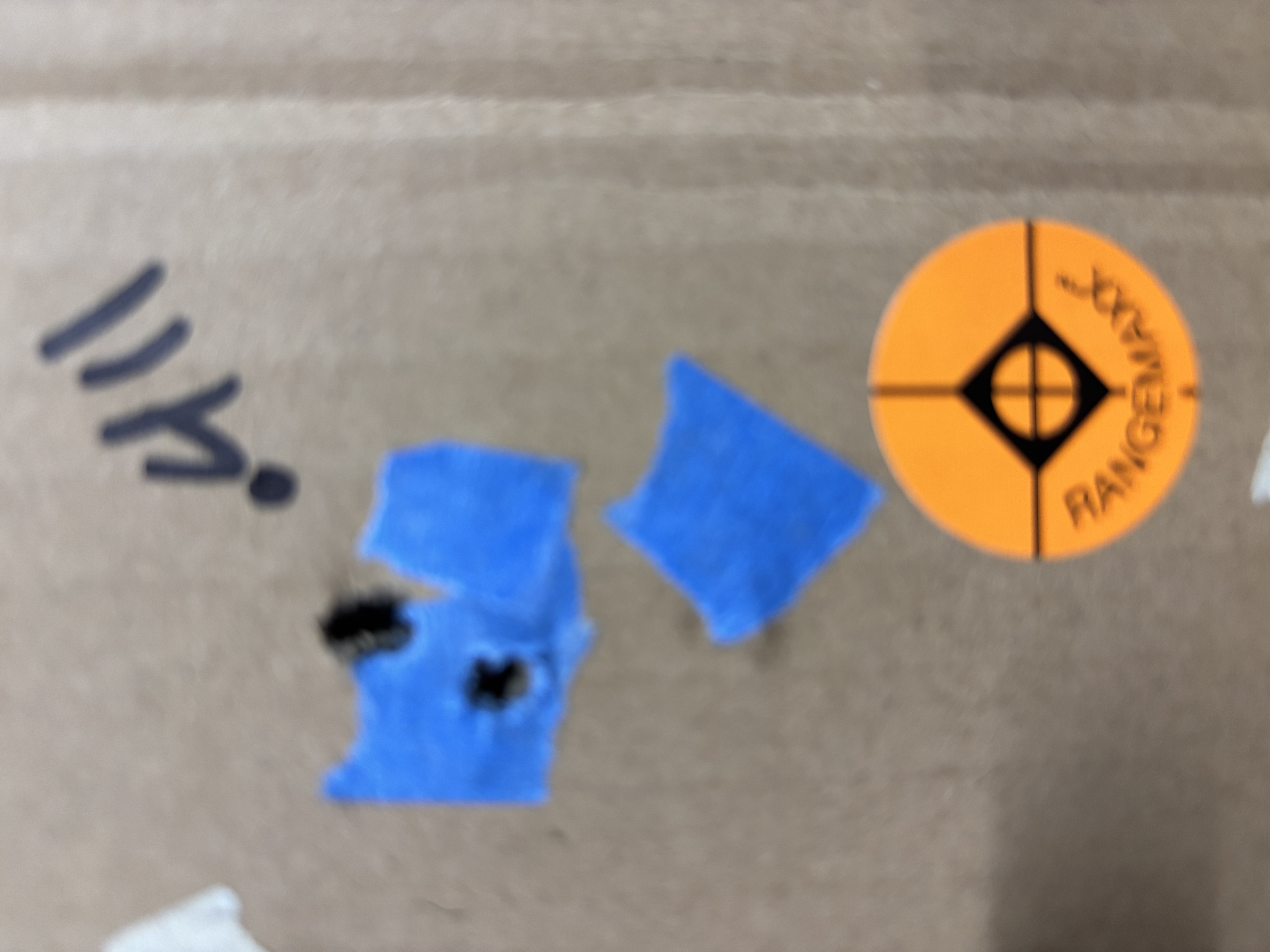

I worked up a different load for the 20 Practical and finally took it out to test yesterday. I had been using 34gr hollowpoints in this cartridge at 3900 fps. I wanted to try something different and a little heavier bullet. And came out with a winner. 39 grain Sierra Blitzking. This is the new load for this gun. Extreme spread and standard deviation aren’t great. But it shot .4 and isn’t intended to be a long range gun. Now I just need to load more, zero it and take it out for coyotes.
Re: The 20 Practical
I wouldnt be thrilled with that spread, but if it works......
The spread is definitely not good. The load before with .5 gr less powder was 110 fps spread. I have to wonder how much of that was due to me loading them in the mag and shooting with a suppressor. I was loading all my test loads into the mag, then shooting groups. Good amounts of hot gas being blown back into the action, heating up the top round in the mag. Then that round sits in a hot chamber until the next round was fired. But, all 4 groups fired shot under an inch with this one shooting the best two groups. Maybe I’ll try single loading it next time, just for fun, and see if spreads tighten. Powder in this load is H335.

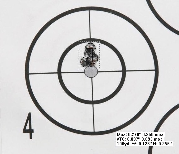

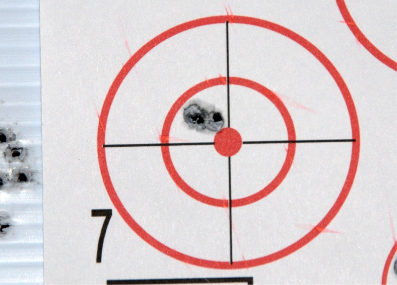

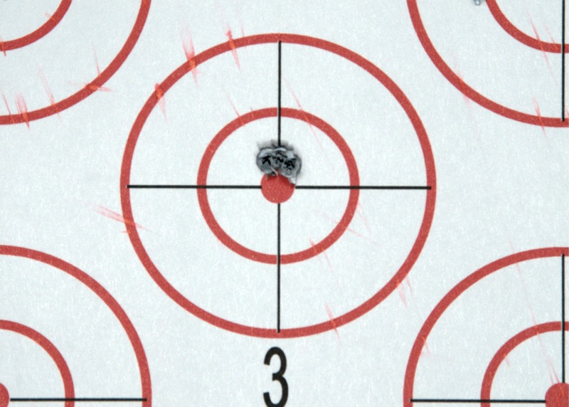

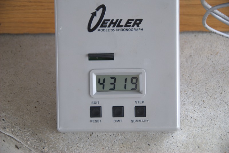

I shoot a 20 Tac. I shoot mainly 32 gr. bullets. I've found that with these bullets it's hard to get velocities below 4000 fps. I've used many different powders, 10X, N133, and Tac. I started working up loads when powder was scarce so I have a lot of good go to loads. When I shoot ground squirrels, instead of hearing a whump, you hear a pop. Here are some of my 5 shot groups:
