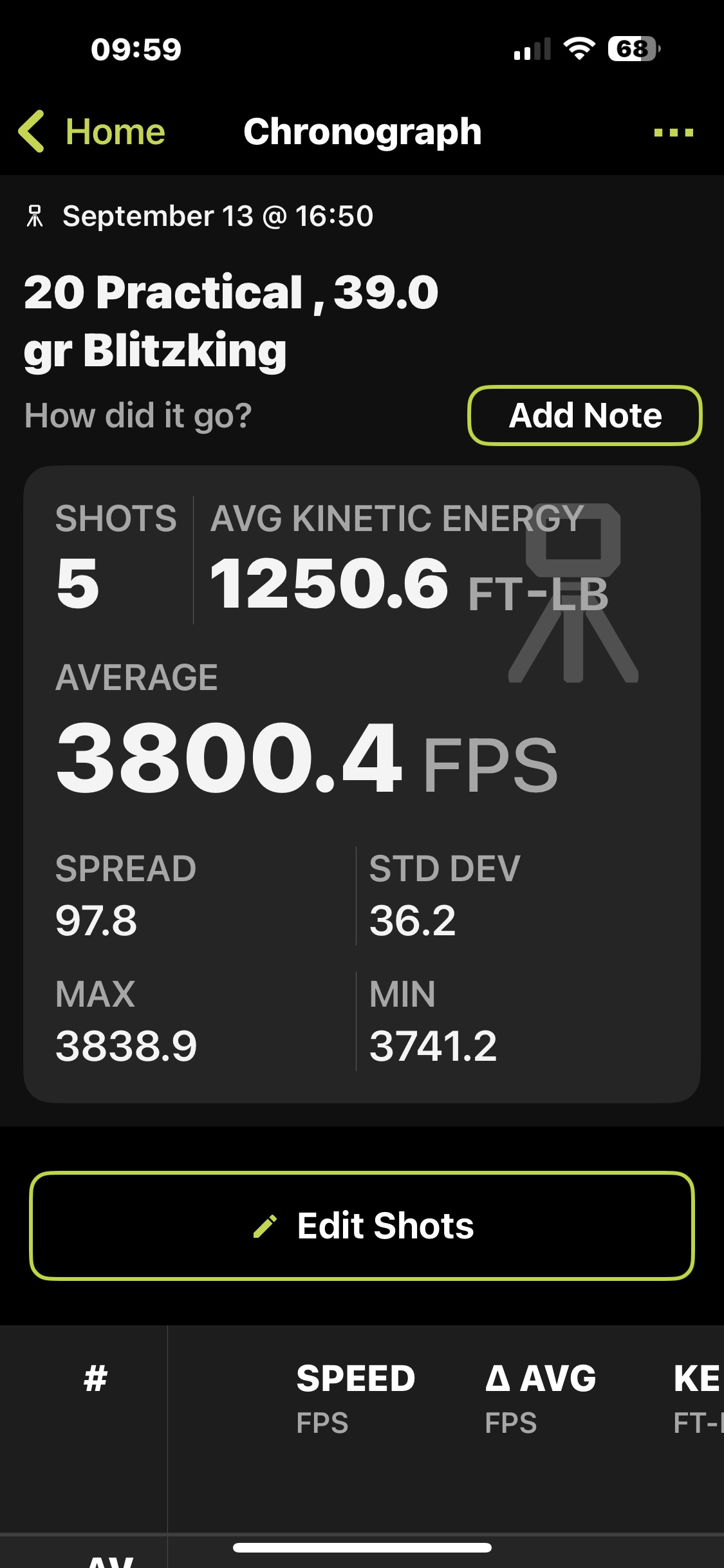

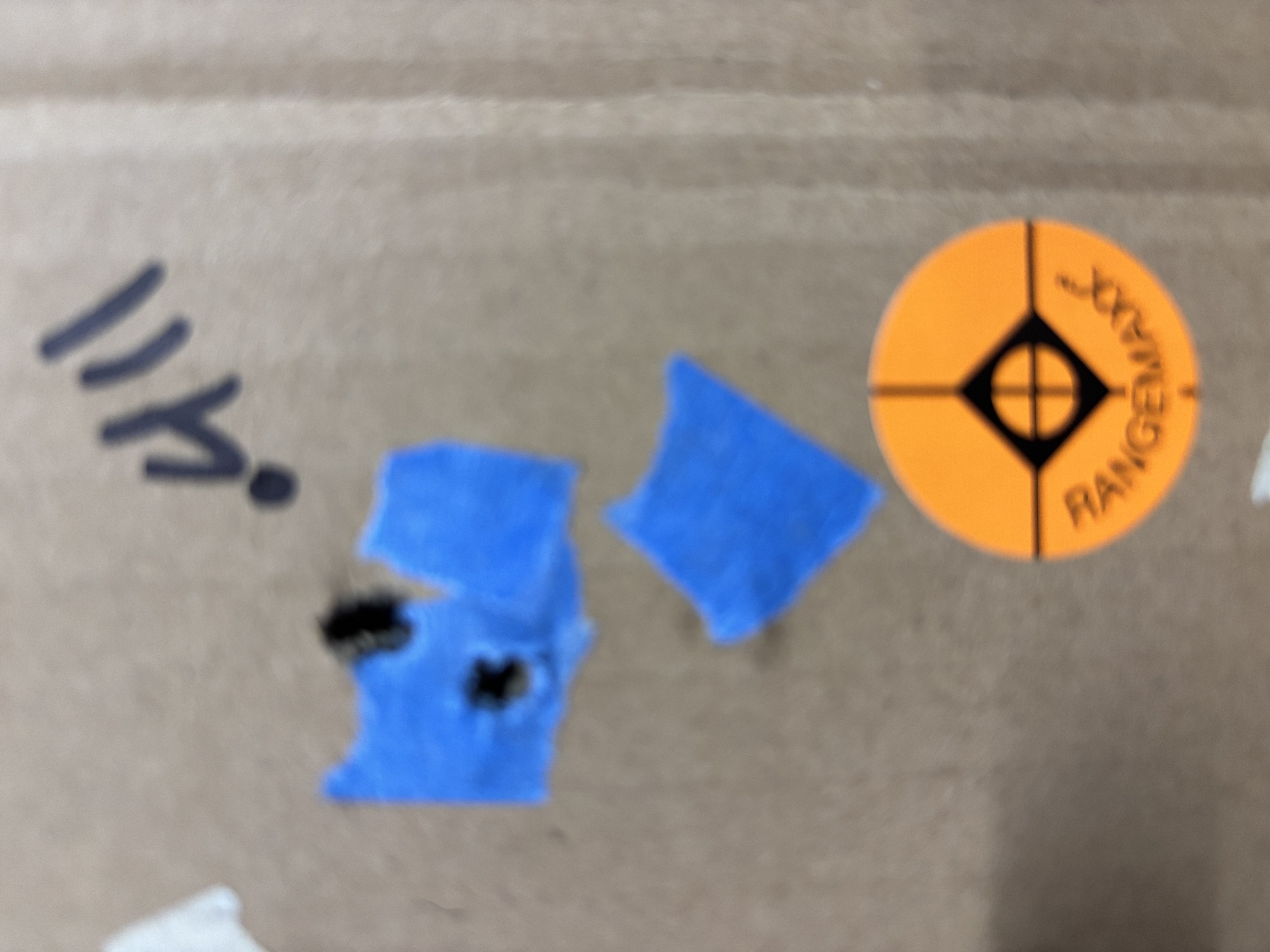

I’ll bump this old thread back up and add some new info.
I worked up a different load for the 20 Practical and finally took it out to test yesterday. I had been using 34gr hollowpoints in this cartridge at 3900 fps. I wanted to try something different and a little heavier bullet. And came out with a winner. 39 grain Sierra Blitzking. This is the new load for this gun. Extreme spread and standard deviation aren’t great. But it shot .4 and isn’t intended to be a long range gun. Now I just need to load more, zero it and take it out for coyotes.
Re: The 20 Practical
Posted: Sun Sep 14, 2025 6:12 pm
by mitdr774
I wouldnt be thrilled with that spread, but if it works......
Posted: Sun Sep 14, 2025 7:32 pm
by Jay
The spread is definitely not good. The load before with .5 gr less powder was 110 fps spread. I have to wonder how much of that was due to me loading them in the mag and shooting with a suppressor. I was loading all my test loads into the mag, then shooting groups. Good amounts of hot gas being blown back into the action, heating up the top round in the mag. Then that round sits in a hot chamber until the next round was fired. But, all 4 groups fired shot under an inch with this one shooting the best two groups. Maybe I’ll try single loading it next time, just for fun, and see if spreads tighten. Powder in this load is H335.

Interestingly, in some of their load info, they list a 40 grain bullet and H335 as a “barrel break in” load and 3500 and some change FPS. I used this to start my loads with H335 and the 39 grain bullet. I get 3800 with 35.5 grains. It pays to start a little low and work up….

Previously, I just wasn’t able to get decent velocity with Xterm. That was the main reason I stopped trying it. I am handicapped a little with the AR platform and shooting heavier for caliber bullets. Further handicapping it is that the chamber throat was cut a little shorter than I’d like. I have to seat shorter for them to chamber and not stick bullets in the lands. H335 is giving great velocity and accuracy. Just the extreme spread and standard deviation aren’t great with this new load. At least mag feeding it with a suppressor. And that makes everything dirty anyway..
