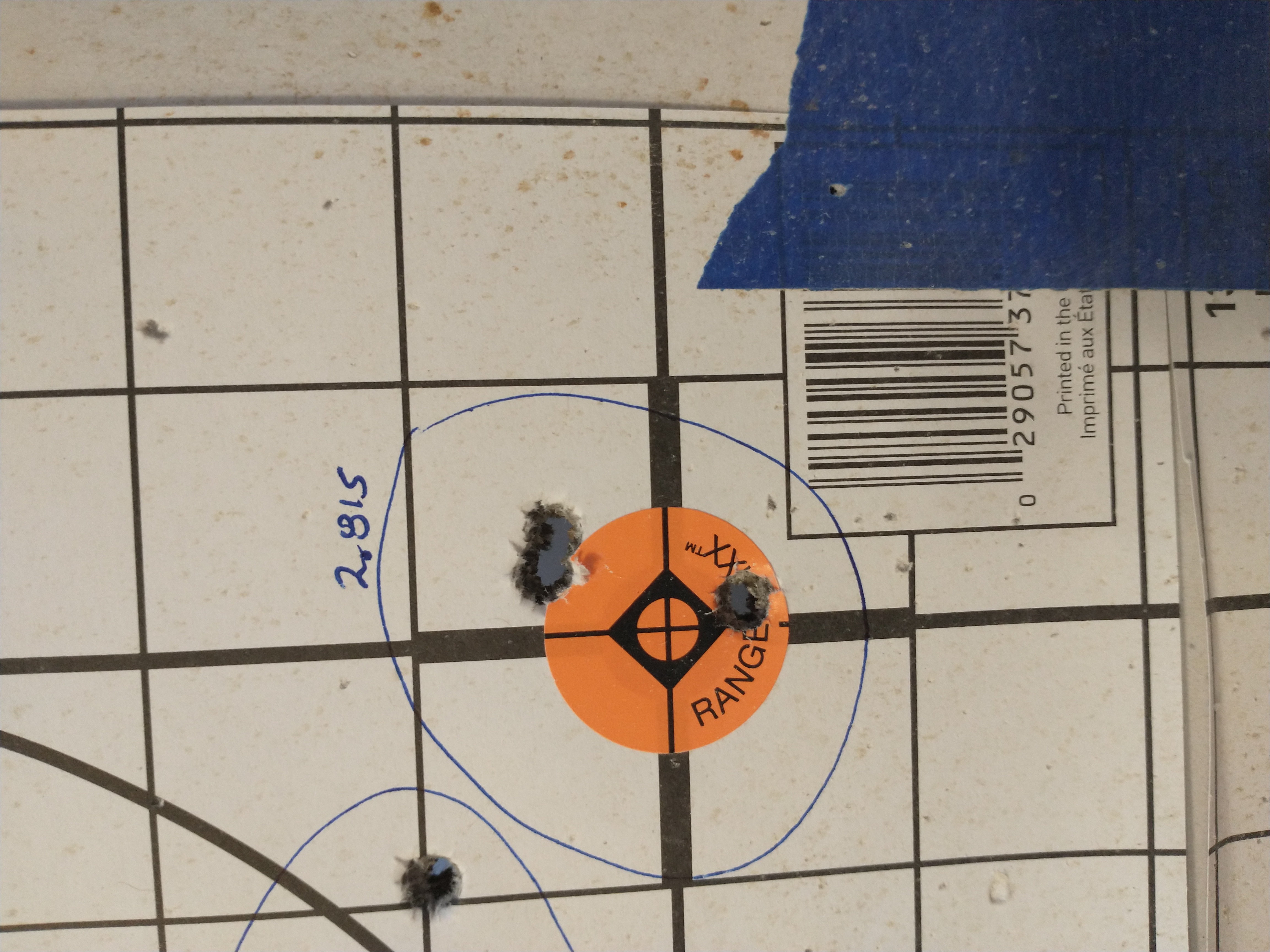

Minor update after the range trip on the weekend. It was cold and that kept the number of people at the range low.
I did drop the charge weight by 0.1gr to bring it to 44.5gr of H4350. This is below book max, but probably actually over where my max should be. I am getting witness marks from the ejector hole on some cases. The mark is there, but not really pronounced, but is not being smeared when the bolt rotates. I have to look really hard to spot the mark on most of the cases I have found it on. These test loads were done with new Starline brass.
Still not where I would like the groups to be, but acceptable for the ranges I would anticipate using it at. Maybe on a warmer day the groups would have been tighter? Who knows for sure. The following would be the two best groups from the test batch.

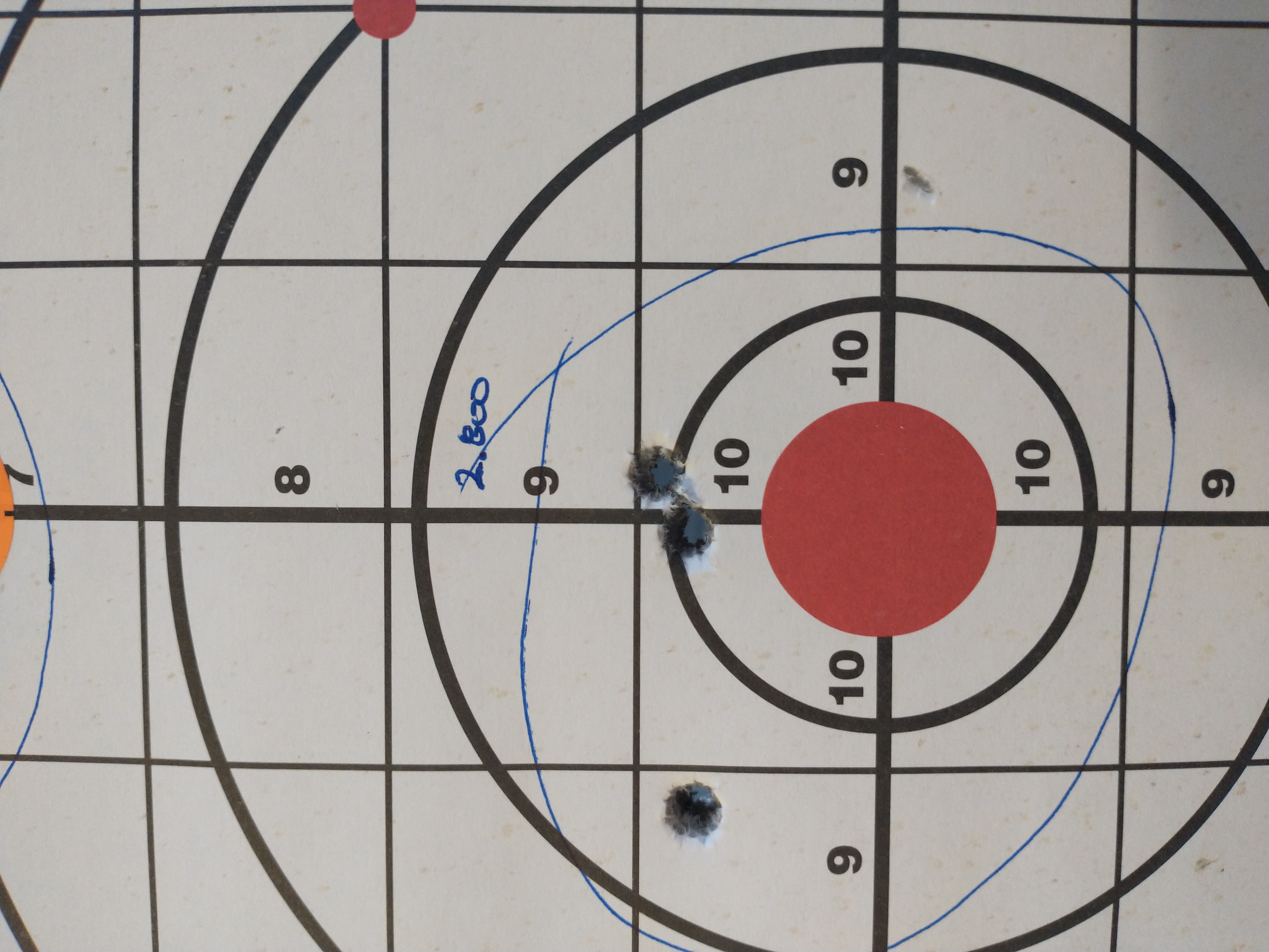

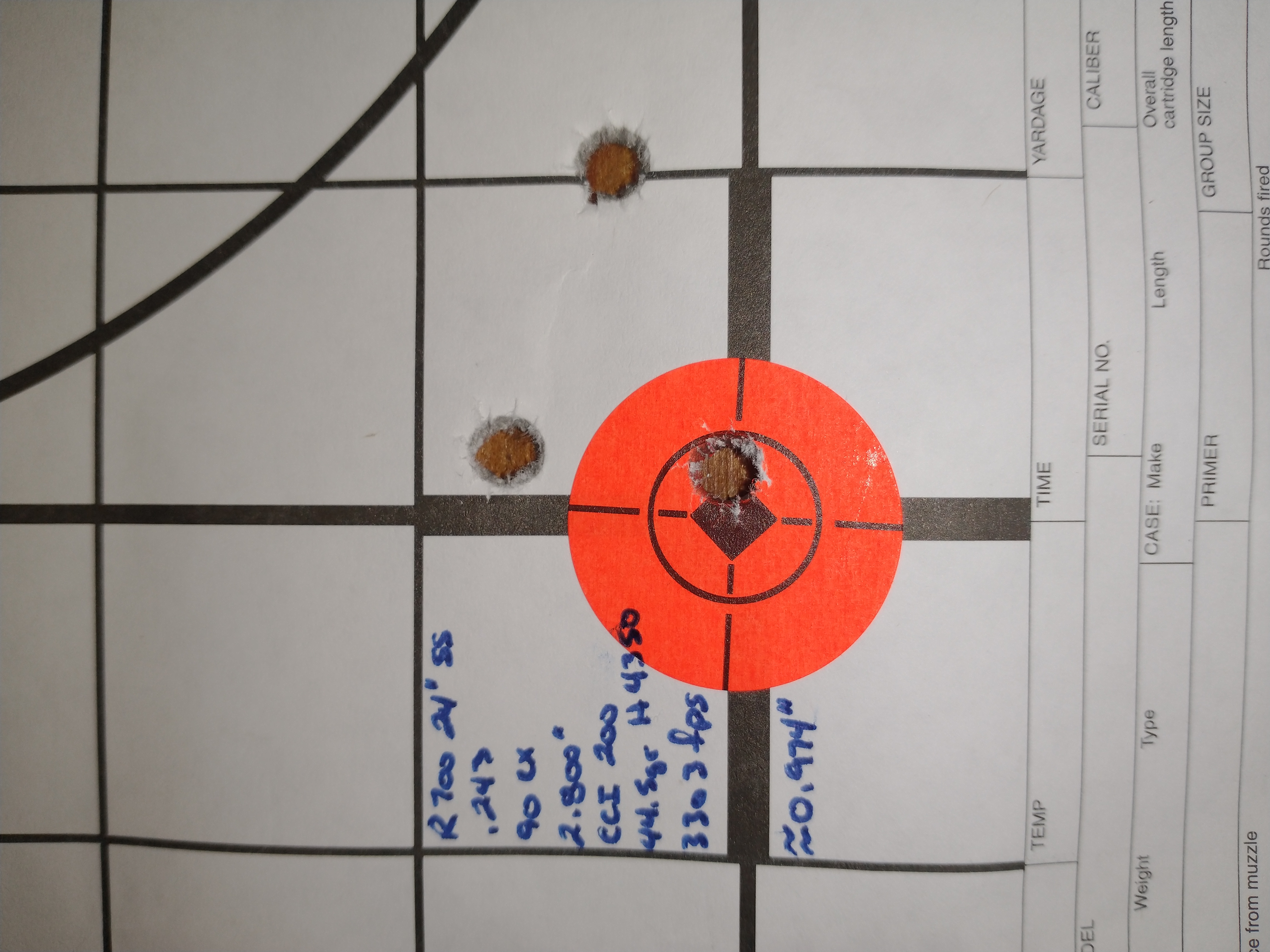

Another range visit and some more results. I wanted to retest the 2.800" and 2.810" OAL loads. I am stil using the same 445.gr H4350 powder charge and new Starline brass. The faint ejector marks and primers tell me to quit pushing and either accept this as it is or start working back down the charge weight path and find the next charge weight that still at least tries to group. Not every case had an ejector mark, but its enough to know im pushing limits a bit. Some required a lot of careful inspection to find, but others were somewhat obvious. None were raised to a point that I could feel it with a finger nail, but you can see it. For reference, my dad's .25-06 was pushing a 90gr CX to about 3350fps today.
I ran two three shot groups with each length.
2.800"
2.810"
