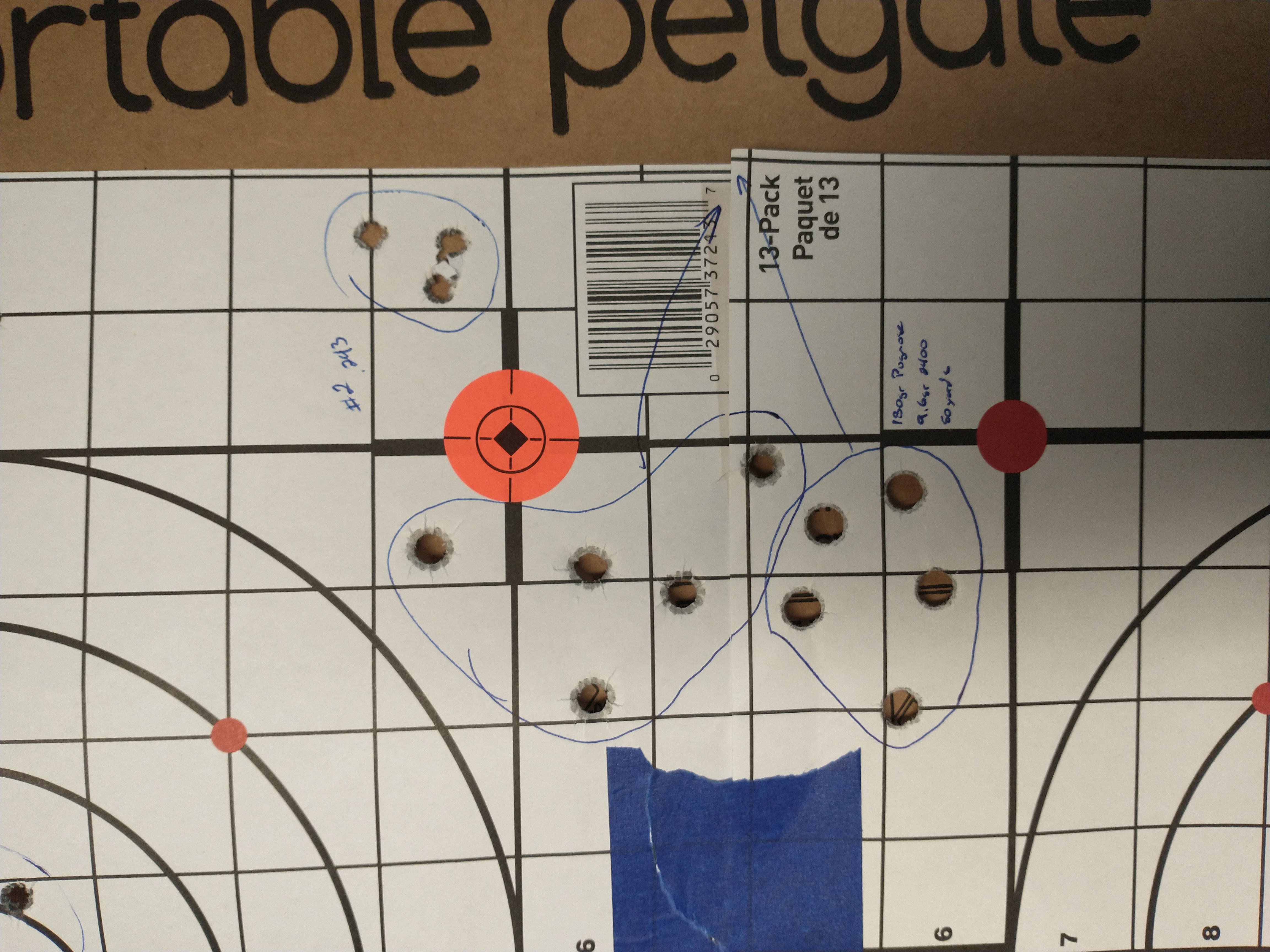

Quick range report without much excitement. Time to get the excuses out first.... Its cold, my right eye is irritated, I dont do well with open sights, I needed to eat soon, I have never shot this rifle in this configuration, ect. With that out of the way, I had a whole lot of fun and snickering when shooting it today. I did come across the potential issue I was warned about with primers flowing into the firing pin hole on hotter loads. This was expected and I did find a limit with the loads I was using today. I may revisit the upper loads with a different primer in the future though. Winchester primers have always seemed soft to me.
7.2gr
Pugnose AVG 971.2 Striker AVG 912.1
8.4gr
Pugnose AVG 1116.0 Striker AVG 1084.5
9.6gr
Pugnose AVG 1261.5 Striker AVG 1243.8
10.8gr
Pugnose AVG 1416.3 Striker 1441.1 (Average of 4 for the Pugnose and 1 for the Striker)

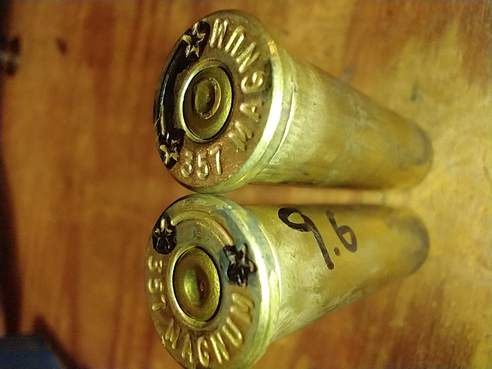

The 10.8gr load was forcing the primer to flow into the firing pin hole and the block would have to flatten the ring back out to open. Seeing as how this is just for going out and having fun I think the 9.6gr load will be plenty though.
Bottom group is with the Pugnose and the top group is with the Striker. Disregard the .243 mixed in there.

is there an option to bush the firing pin hole? Or make a new whatever it is and make the hole smaller?
Posts: 470
Re: .357 Cadet finally made it home
It is possible to remove the block and do some work to put a bushing in it. The other easier option is to just not use hot loads in it and have fun. A 180gr cast lead bullet a 1250 fps isnt exactly out of line for what the rifle is. The .310 Cadet cartridge was only pushing a 110-120gr bullet at around 1500 fps if I recall correctly. CCI primers may also reduce the primer deformation into the firing pin hole if I want to push it further, but I have a bunch of Winchester primers and 180gr cast bullets. Also, the 9.6gr load vs the 10.8gr load means an extra 81 rounds from a pound of Alliant 2400.

Here is what is happening with the primers. Keep in mind it's a Winchester small pistol magnum primers. They have always seemed to be on the soft side in my past experiences.
The ring that is created does get slightly flattened as the breech block drops to remove the spent case. It's fairly obvious when working the lever that there is an issue.
My first two rounds from the gun were factory Sig ammunition. I do not have the box from them and do not recall the bullet weight. They were over 1800 fps though and both had the ring on the primer.
I am good with dialing back to a reasonable load for paper punching and just having fun. Next time I'm going to use a bigger target paster that I can actually seen decent at 50 yards and see if it can group better with me shooting.

I never use magnum pistol primers for 357 mag. My dad does, and his loads need beat out of my Blackhawk. Same charge with regular primers is fine. Upper end but not max load of H110.
Posts: 4311
And the be fair (Insert Letterkenny fans) that looks like it’s smacking the poop out of the primer. Ain’t no lack of penetration.

I used them because I had them on hand and was hoping the primer cup would be a little tougher. Chances are that I will.justnload up a bunch of the 9.6 gr load and call it good. Maybe even drop it slightly and be less concerned about precision on the powder charge. I don't think it will make much difference if I drop to 9.0gr and accept 8.9-9.1 charge weights. Chances are that my eyes are a bigger factor in the group size than the difference in charge weight will be.
The firing pin indents on the primers did surprise me. Must be a big ass firing pin and it don't think I need to worry about a weak strike on a primer.
I had a load that I tried in my GP100 that left the brass colored primer and case looking like one piece. Needless to say one test rounds was enough on that loading. Prior to and since that round, I had/have never had a primer flatten out enough to make it look like the back of the case was just one piece of metal. Oddly enough the empty dropped out just fine.

Looking at it again, I don’t think it’s that the loads are that hot, but the firing pin hole is too big. The primers are still radiused.
I think it’s just a hot dog in a hallway firing pin.
Which….can be “fixed” by loading down. Which in reality, a few hundred FPS (if that) ain’t gonna make a bit of difference.
