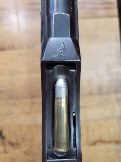

Posted: Tue Apr 30, 2024 12:19 pm
Red Menace? Red Scare?
Looks like the H110 is running great in the gas gun, so probably zero reason to change anything.
If you've got access to AA#9, you might give it a spin. It's been outstanding in my blown-out ".32-20-Kinda-Sorta" Martini Cadet with 130 and 150 grain bullets in the 1400-1600 fps range, and the Blackout looks to be damn near a rimless copy of what I'm shooting.
Binky & New Bullet 2.jpeg (30.83 KiB) Viewed 3408 times
If it'll pressurize a gas tube better than H110, I can't say, but it's a slowish-burn magnum pistol powder, so I don't see why it wouldn't work.

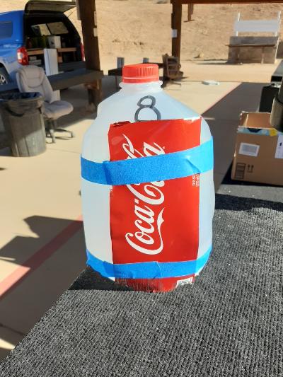

We had a long thread going over on Castboolits about the legend of the WWII British Webley .38 S&W with a 200 grain round nose being a tumbling bullet. Since I had tried a Lyman 358430 - 195 grain round nose of basically the same shape - out of a J-frame Smith at 570 fps into FBI spec gel and had it pencil through in a perfectly straight line, I was doubtful, but a few years later I got an actual Webley and a legit clone of the MKI bullet mold and was able to test it out.
My clever plan for being able to confirm tumbling:
380-200 Jug 1.jpg (47.27 KiB) Viewed 3375 times
I slapped a layer of soda can between every jug in the stack and let fly.

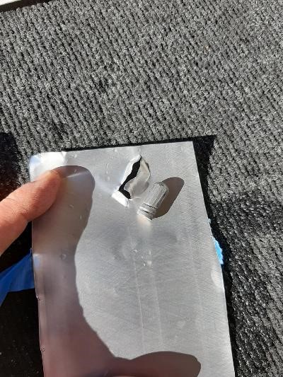

Recovered bullet next to the hole:
380-200 Jug 4.jpeg (89.46 KiB) Viewed 3375 times
And a banana bend - proof of lateral stress even at only 600 fps:
380-200 Jug 6.jpg (15.39 KiB) Viewed 3375 times
NOT what I was expecting at all, and was really a case of SCIENCE (!) shredding what I thought was solidly grounded reasoning.
