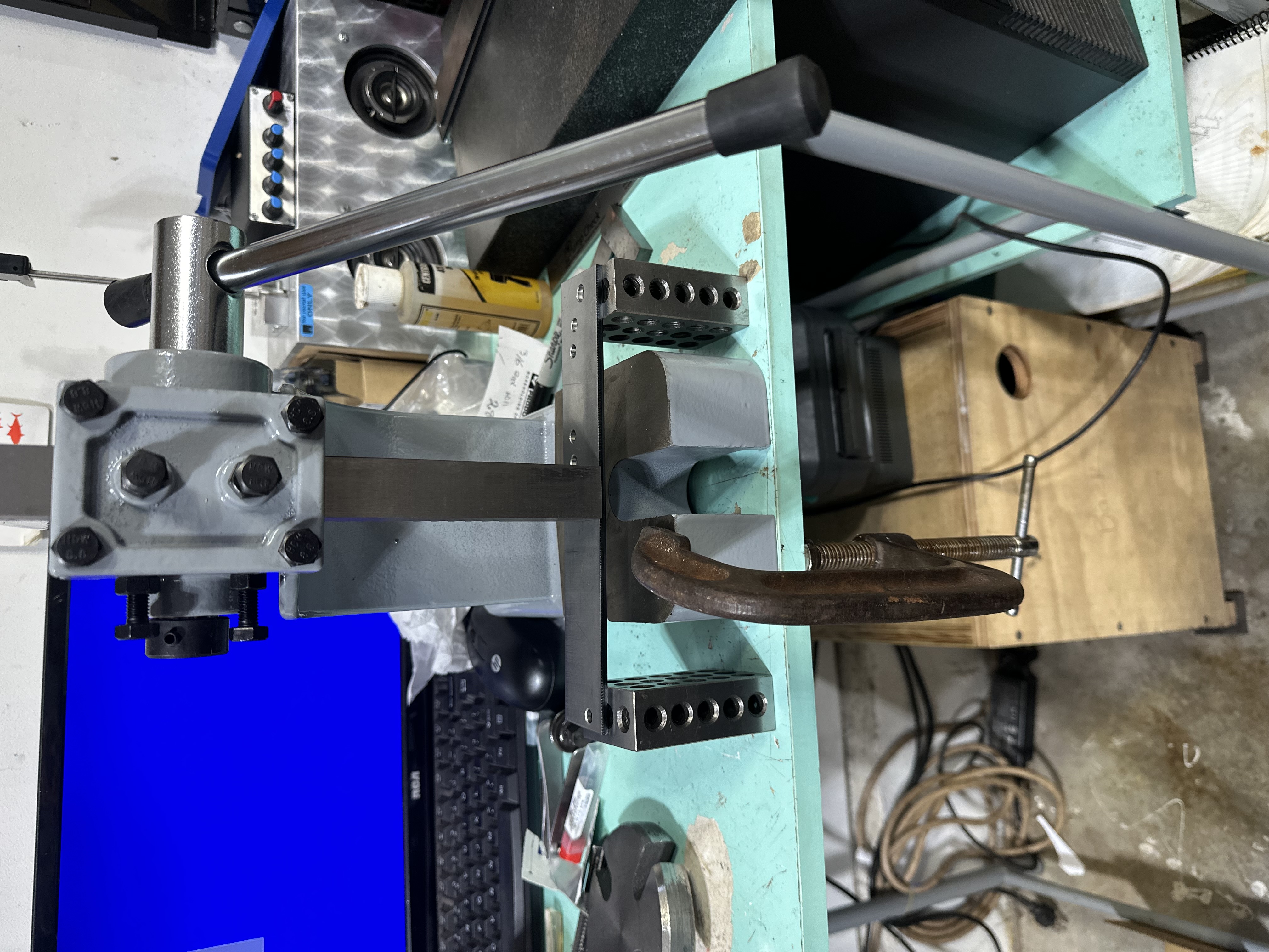

The other annoying part of mill finish stock is it’s a bit warped. Not much, but enough to see. So I bought something one needed for a LONG time. An arbor press. After using it, I realized just how much I could have been using one over the years. Works awesome for tweaking the blades flat.

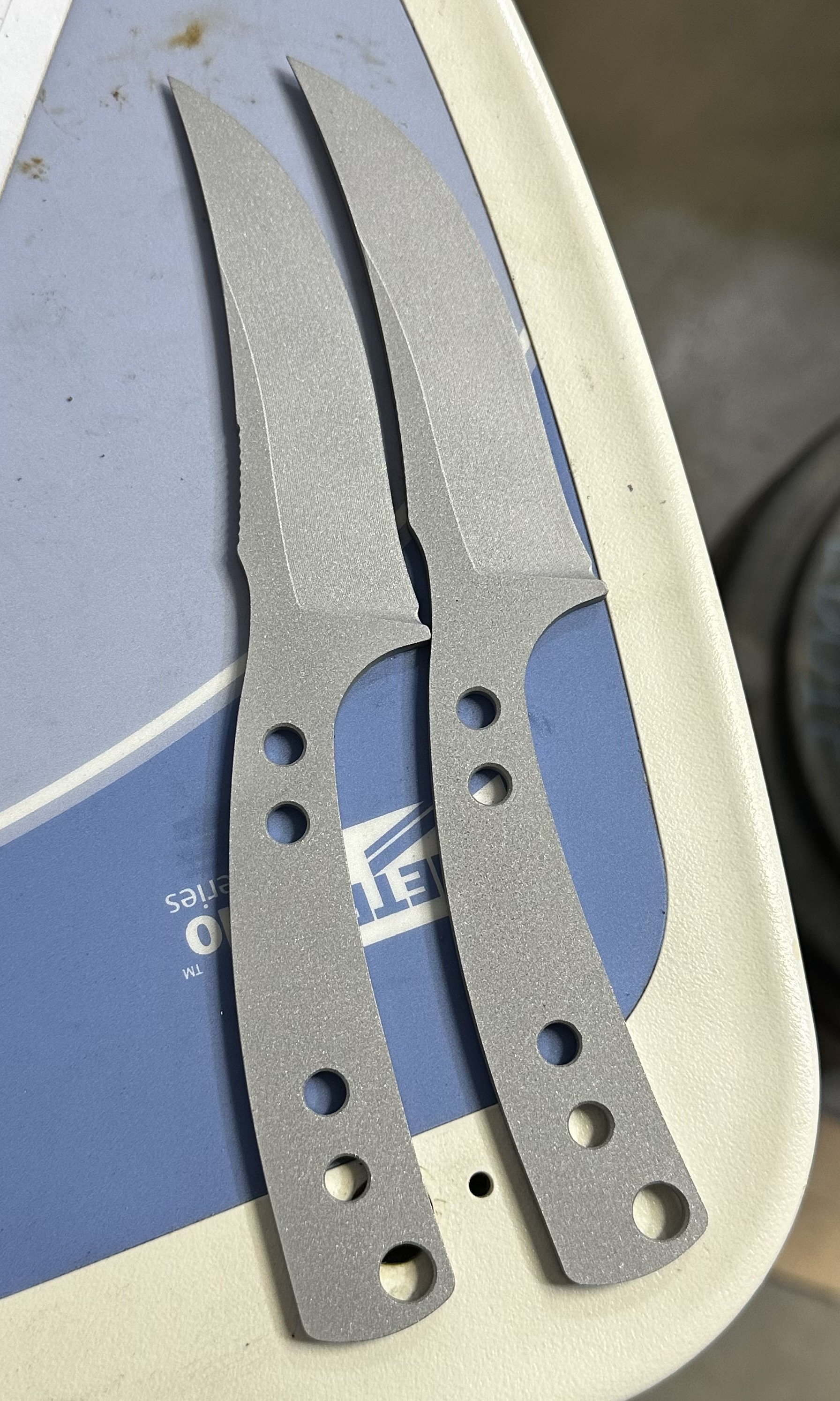

Tell me which one was sanded before bead blasting.
Posts: 1400
CPJ 2.0 wrote: ↑Sat Feb 24, 2024 12:31 am Tell me which one was sanded before bead blasting.
One on the left
Posts: 2324
One on the right. Looking at the pic full sized can see more machining marks on the bevel on the one on the left.

GrapeApe wrote: ↑Sat Feb 24, 2024 12:54 am One on the right. Looking at the pic full sized can see more machining marks on the bevel on the one on the left.
The bevels weren’t sanded on either.
Posts: 4210
CPJ 2.0 wrote: ↑Sat Feb 24, 2024 1:11 am
But you’re correct. It’s the one on the right. Just not for the right reasons. 😬

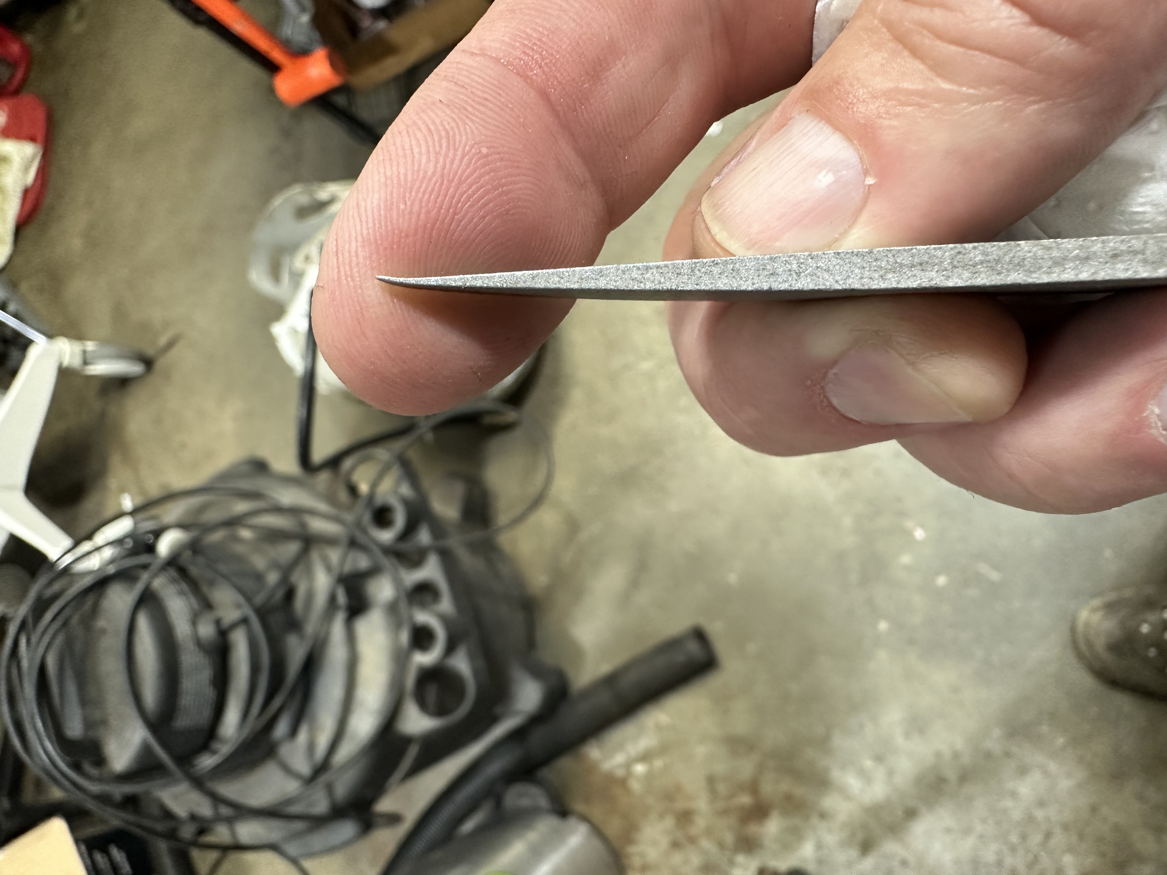

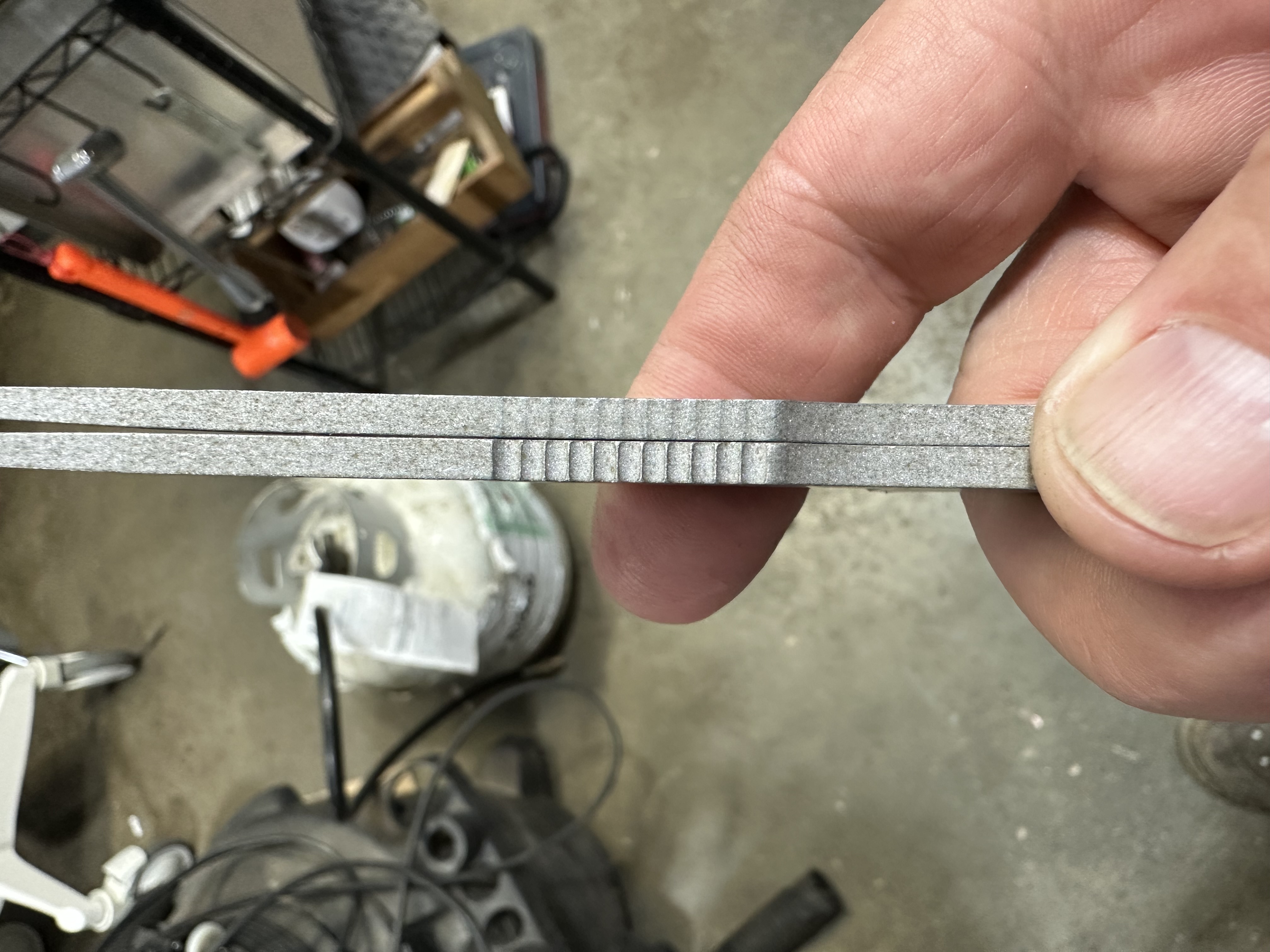

So. Problems.
Tip isn’t suited for spinny rock buckets.
Neither is the jimping.
(Blades are still in the annealed state)
Posts: 899
I'd file the jimping after the sand blast and tumble. Give you a nice shiny contrast.
Posts: 4210
“Stonewashed” finish.
Which if you see that term advertised for knives, now you know how they do it.
Isn’t worth poop testing on soft steel. I’ll harden tomorrow.
