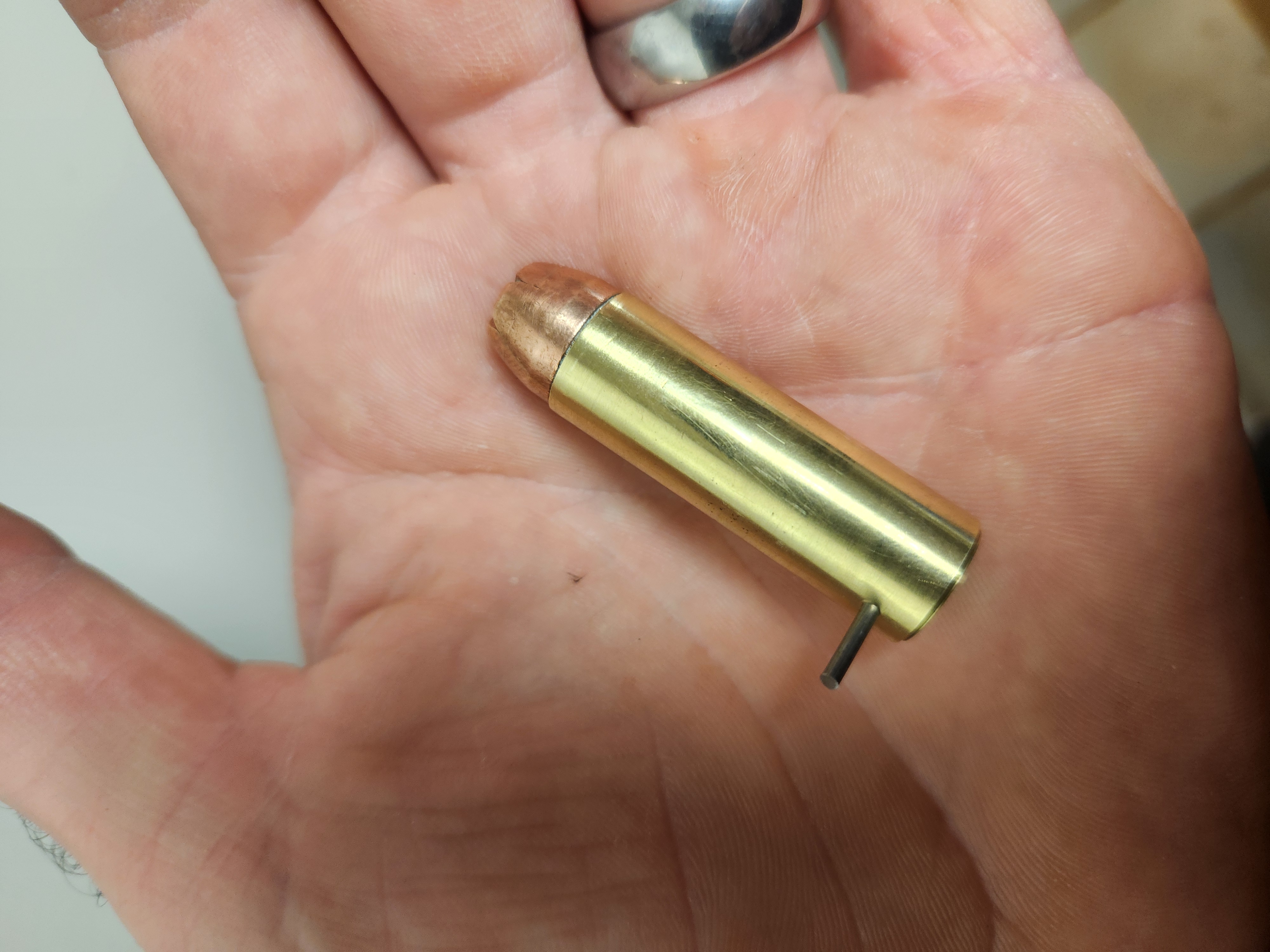

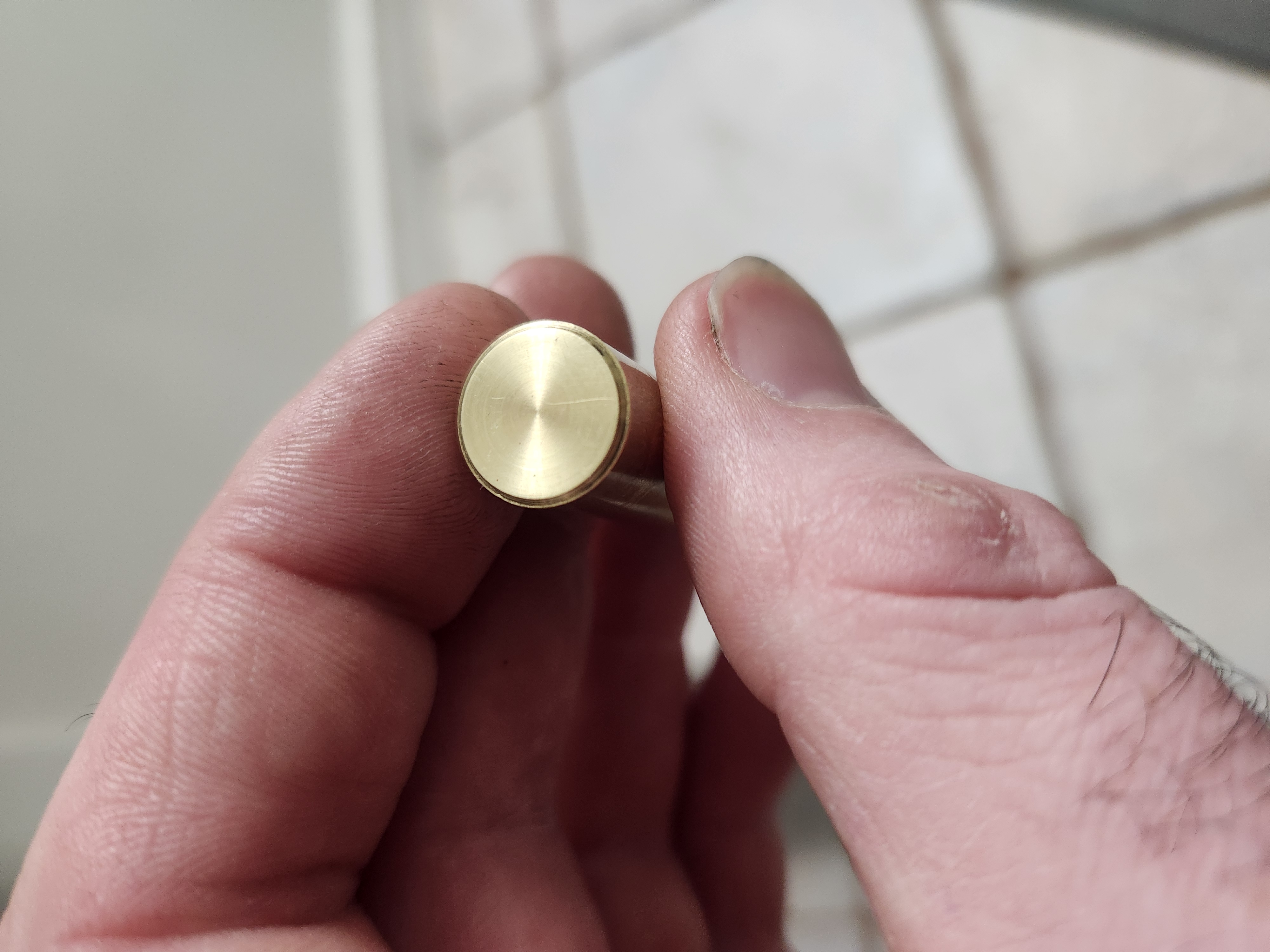

Yeah, you guys are probably right. I guess I probably shouldn't have ordered the brass tubing already. It's literally called cartridge brass and it wasn't cheap. I got it to where I could ream the majority of it to .500 but not to full depth and turn down the outside to .530 which would leave a web thickness of whatever I figured looked about right at the time in the bottom of the case. Then silver solder caps in place. I determined last night that 2.5" long would hold the 100 grains just right. I MAY still experiment around but will likely just use the abundance of 500 brass I have, because you guys made solid points. I could always just bump up to using Unique if I wanted more performance but there's really no use because I'm not a hunter, just Tim the Tool Man of the firearm world 😂. Oh yeah, I plugged and soldered the primer pocket and flash hole of my brass and am amazed that you can't even see a hint of a seam or solder.

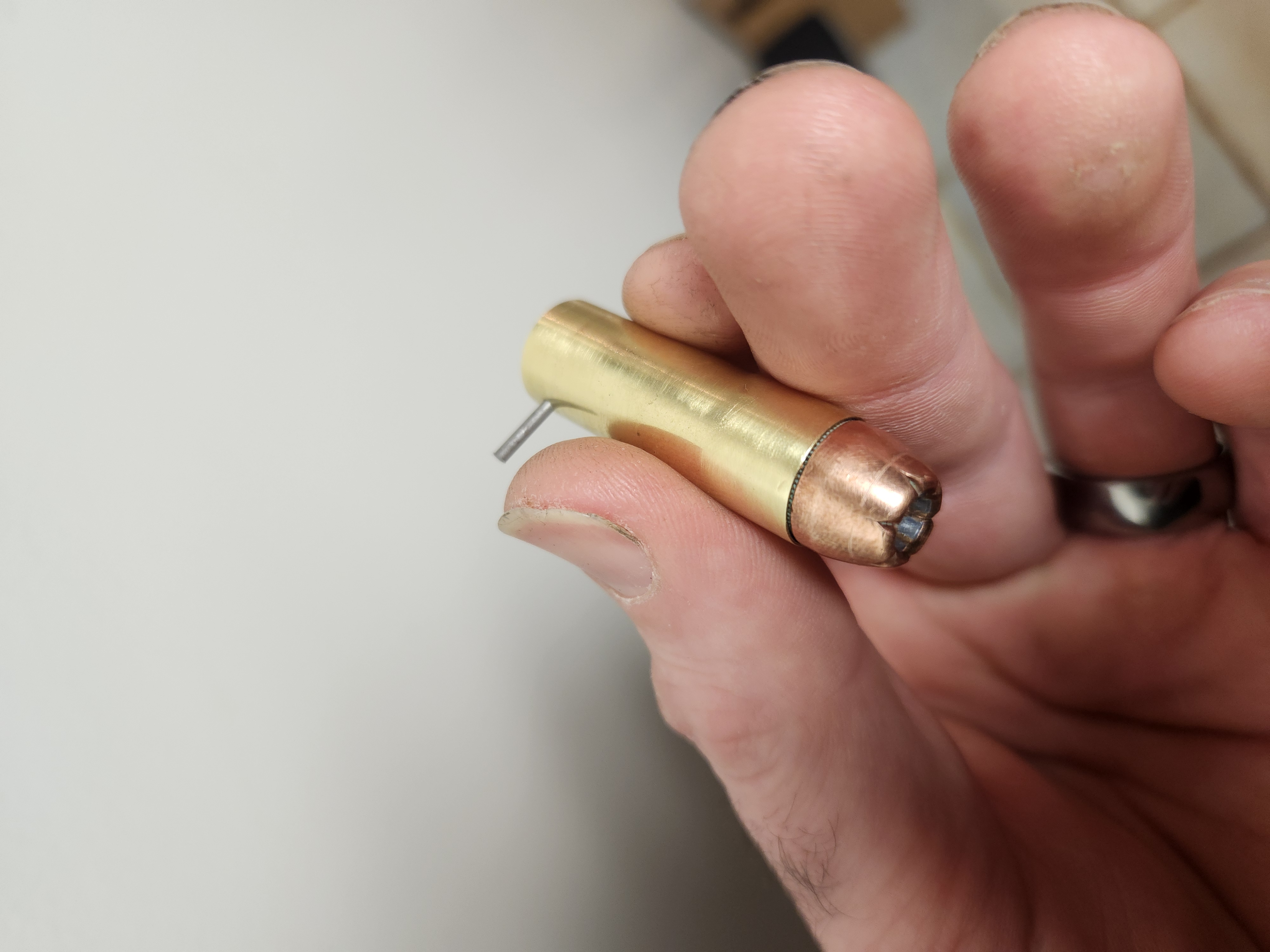

That's pretty much how I make them also, with the exception of making plugs and soldering them in the primer pockets before I face the back of the brass in the lathe. Apparently alot of people have the misconception that pinfire cartridges are/were low powered but they were really no different than any of the other black powder cartridges that came later. And I can't remember the exact number, but if I recall I was getting 32acp velocities out of the 7mm revolver I converted to 32 pinfire.

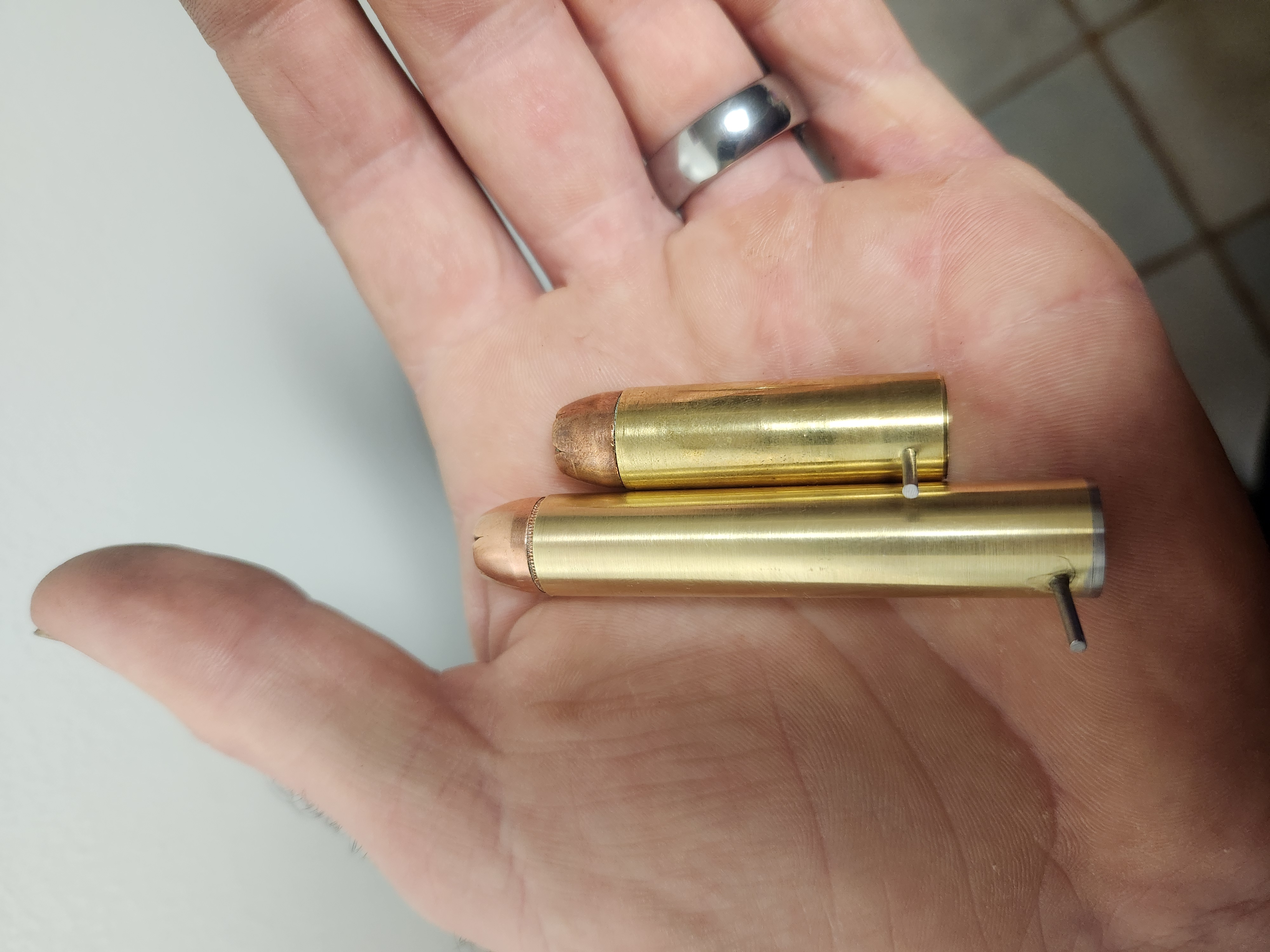

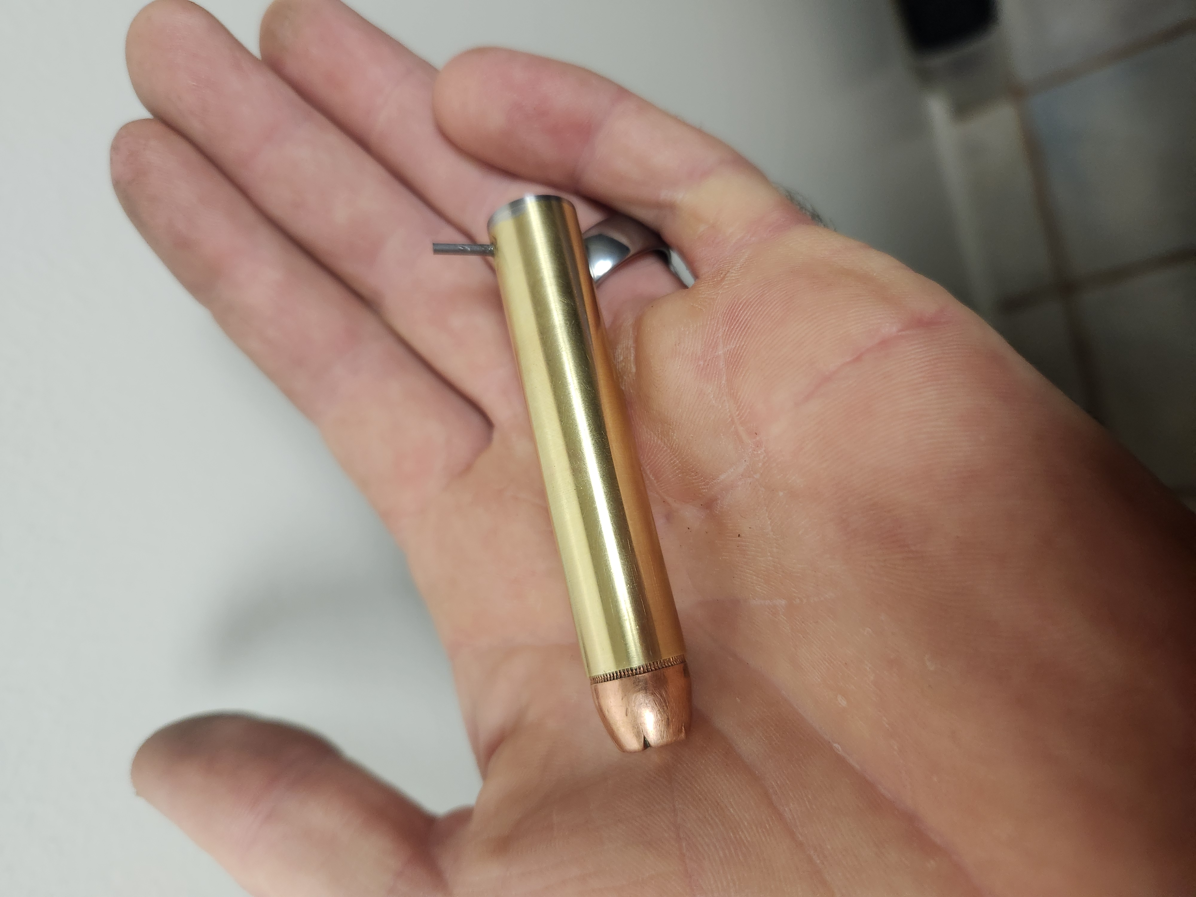

Since I got the brass, I might as well just to see 🤷‍♂️
Ended up holding 120 grains of powder and this thing is a hoss. The first one took a bit of time to make and I didn't have any brass to solder as end caps so I just used steel. I'm sure I could make the rest pretty quickly but this really is overkill.
