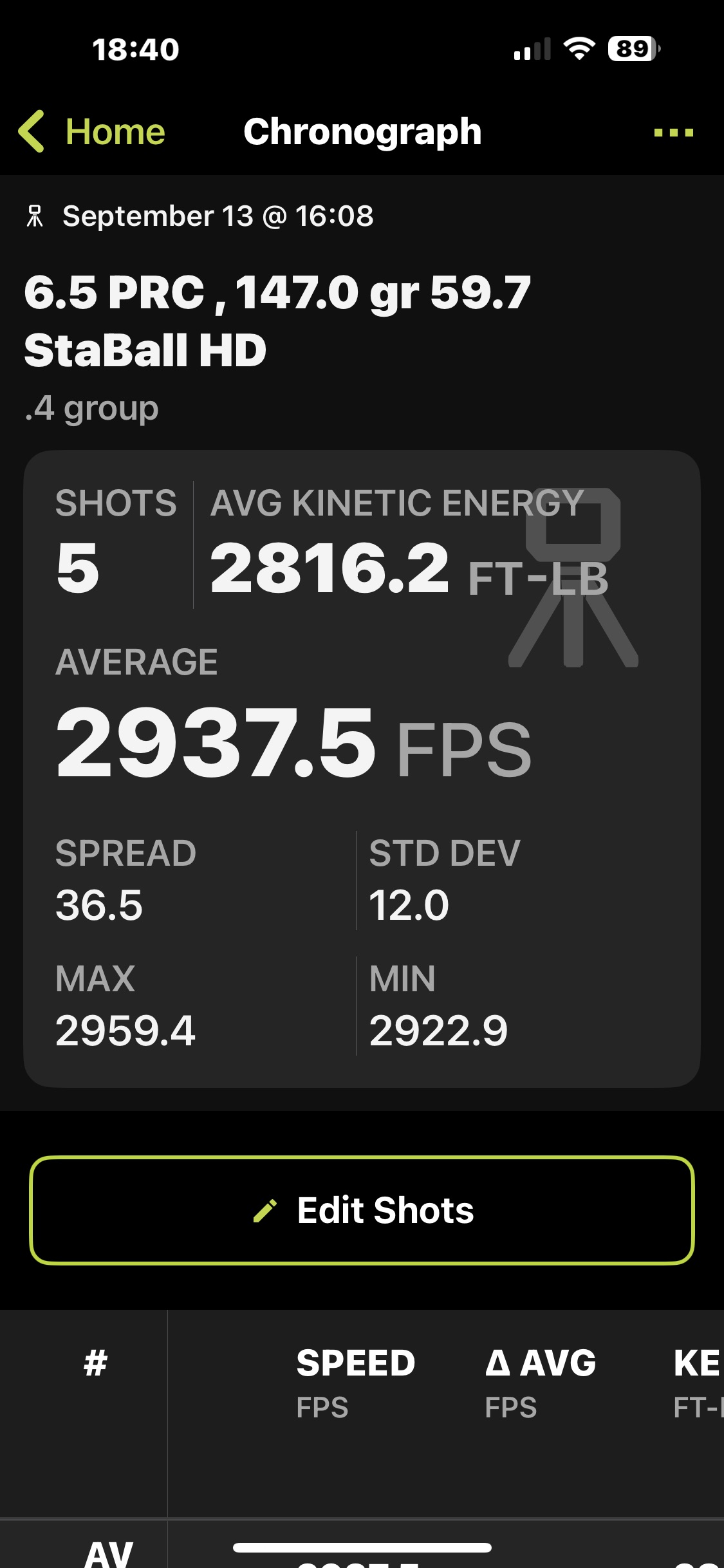

I would say that an SD of 40 is not desirable. For long range consistency. Do you think it’s the powder or some loading process causing that?

Extreme spread was 40. Standard deviation was 20. On the previous loads. But a small sample size just for load work. So the idea of loading more of the best group size load to check for SD and ES. Since I only got one chronograph reading on that load.
This is a new powder to me. It’s what was available. The local Cabelas had 8 pound jugs last time I was there. Might end up grabbing one.

My first load was a larger sample size, since I was fouling the bore and checking zero. It was extreme spread 50.8, std dev 19.1, velocity 2890
Second load was extreme spread 39.4, std dev 17.5, velocity 2907
Third load was ES 43.1, std dev 21.5, velocity 2932
Last load tested was the sub 3/8” group, but the chronograph only got one reading.

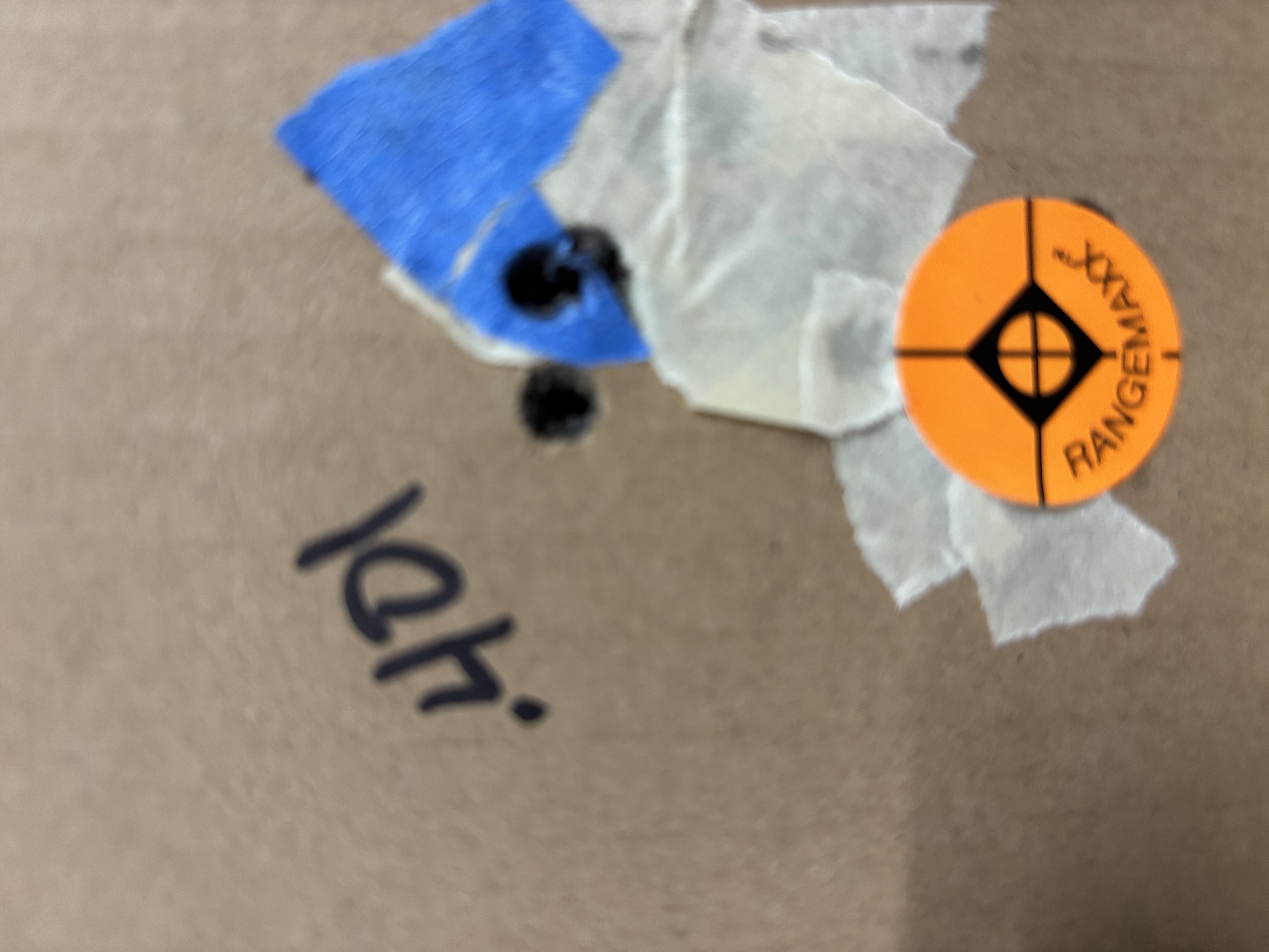

I got some more ammo loaded for the PRC. Changed things up a bit.
Max book load is 59.5 grains. That load shot just over 1/2”. But the numbers on the chronograph looked pretty good. Just a small sample size. So I loaded 6 more of those. The best group was the one pictured previously at 59.7 grains. But didn’t get enough chronograph info to get any info out of. So I loaded 6 more of those.
I still have 3 rounds at 60.0 grains I didn’t shoot last time. So I loaded 6 at 59.8 grains to get info on. I also seated .010 longer this time. So that could make up a little difference with a touch more powder. And that will give me some ammo to try just short of the 60 grain load to look for pressure signs.
With enough ammo to shoot two three round groups with each charge and get a little more group and chronograph info, then take it from there.
One other thing I changed this time. Previous ammo was loaded using a scale that reads to .001 grain, trickling up to the tenth of a grain. I don’t care that the scale reads to .001. I wanted the .01 part to get as close as possible to exactly the tenth of a grain mark. Just for consistency. However, that process is very tedious and I lost interest in it quickly. So these are to the tenth according to my Chargemaster. Once I settle on a load, I’ll spend the time trickling all my handloads with the other scale.

Next step in the process complete. I think I have a load.
Same load as the last time.
But I went a little under and a little over on the powder charge, just to see what happened. All loads this time were around 1/2 to 3/4”. This one is proving to be consistent. And the chronograph agrees.
Consistent sub 1/2” groups with decent velocity. No signs of pressure, easy bolt lift.. I could probably push this one a little faster. But a load that consistently shoots under 1/2” and has chronograph numbers like that, I’m good. See what happens when I go from new brass to once fired brass.
I’m VERY happy with this rifle.

I don’t know why it’s posting the extra pic of the group. That doesn’t show on my preview 🤷🏻‍♂️
