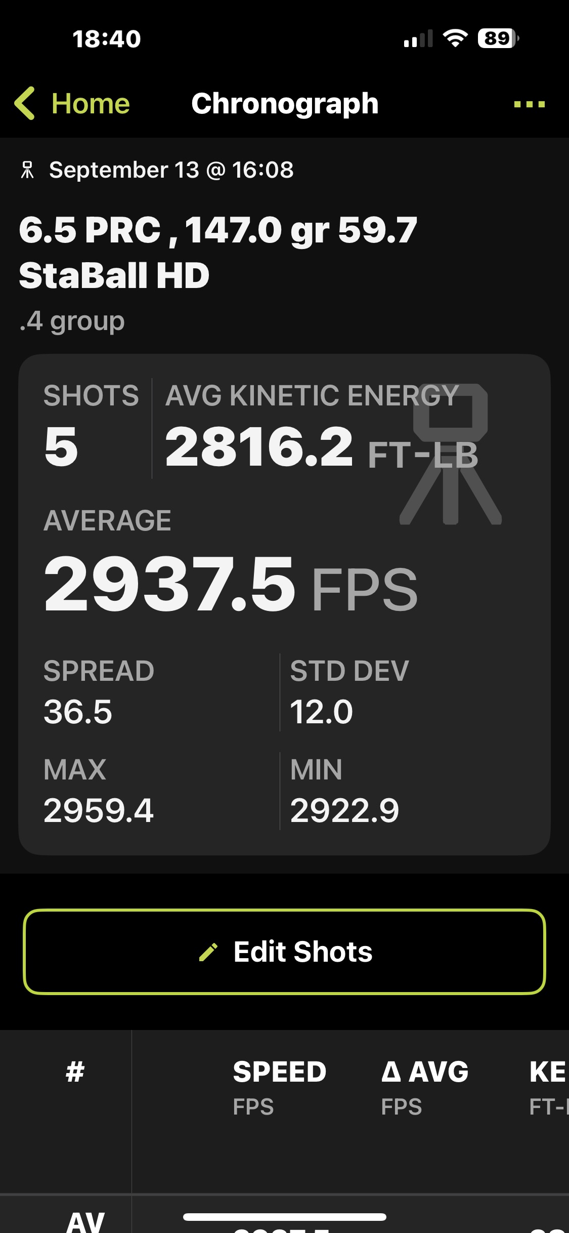

Next step in the process complete. I think I have a load.
Same load as the last time.
But I went a little under and a little over on the powder charge, just to see what happened. All loads this time were around 1/2 to 3/4”. This one is proving to be consistent. And the chronograph agrees.
Consistent sub 1/2” groups with decent velocity. No signs of pressure, easy bolt lift.. I could probably push this one a little faster. But a load that consistently shoots under 1/2” and has chronograph numbers like that, I’m good. See what happens when I go from new brass to once fired brass.
I’m VERY happy with this rifle.
