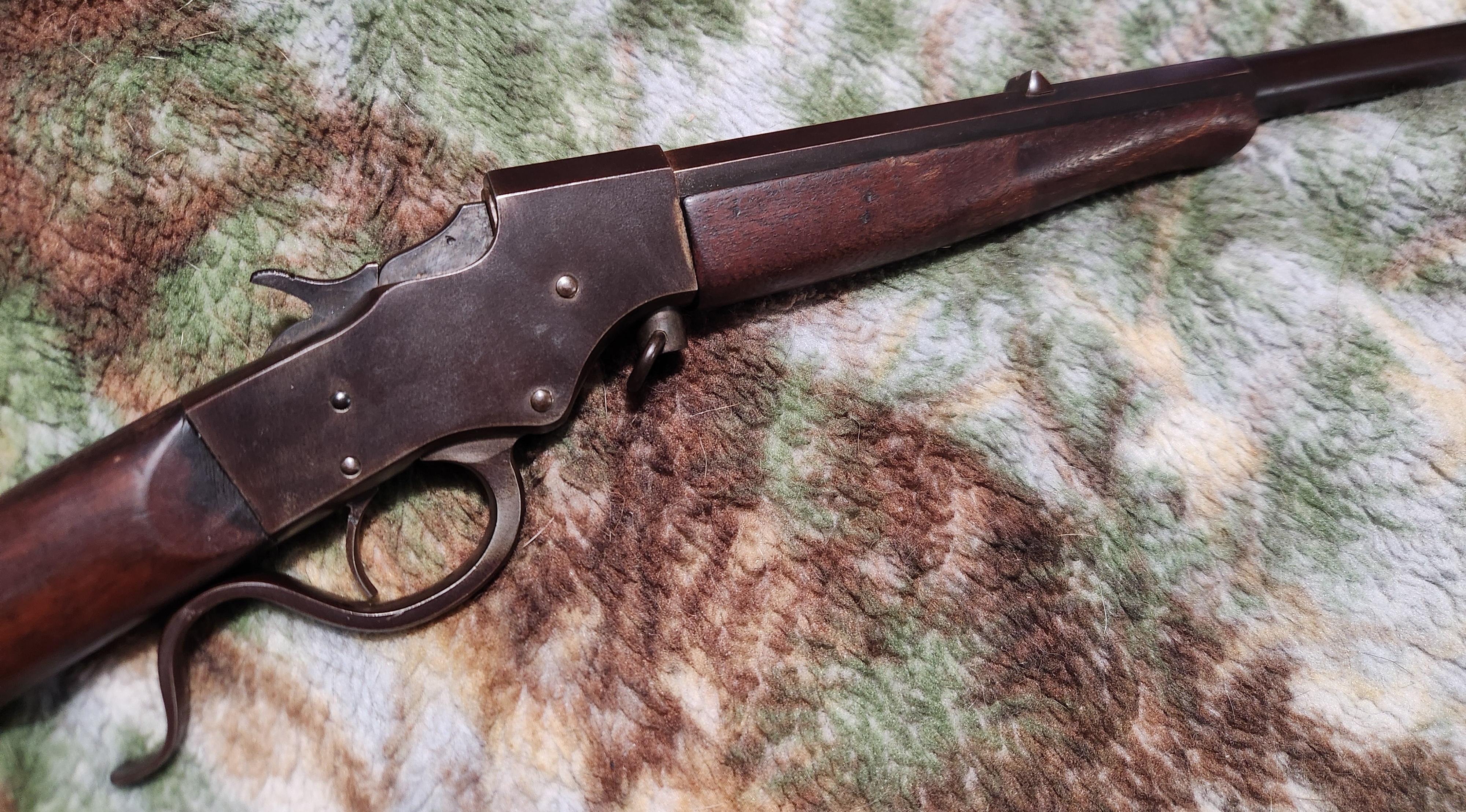

Wambli Ska wrote: ↑Thu Mar 26, 2026 2:30 am Oh I’m quite Ok with it. I just wondered what all the options were. So now I’m really thinking .32 H&R might be the ticket for a cool little walkabout rifle. Maybe a 20” tapered octagon tube? Or half octagon, half round? Is the forend inleted at all?
Got a chance to check today. The forearm is inletted fully for a straight octagonal barrel.

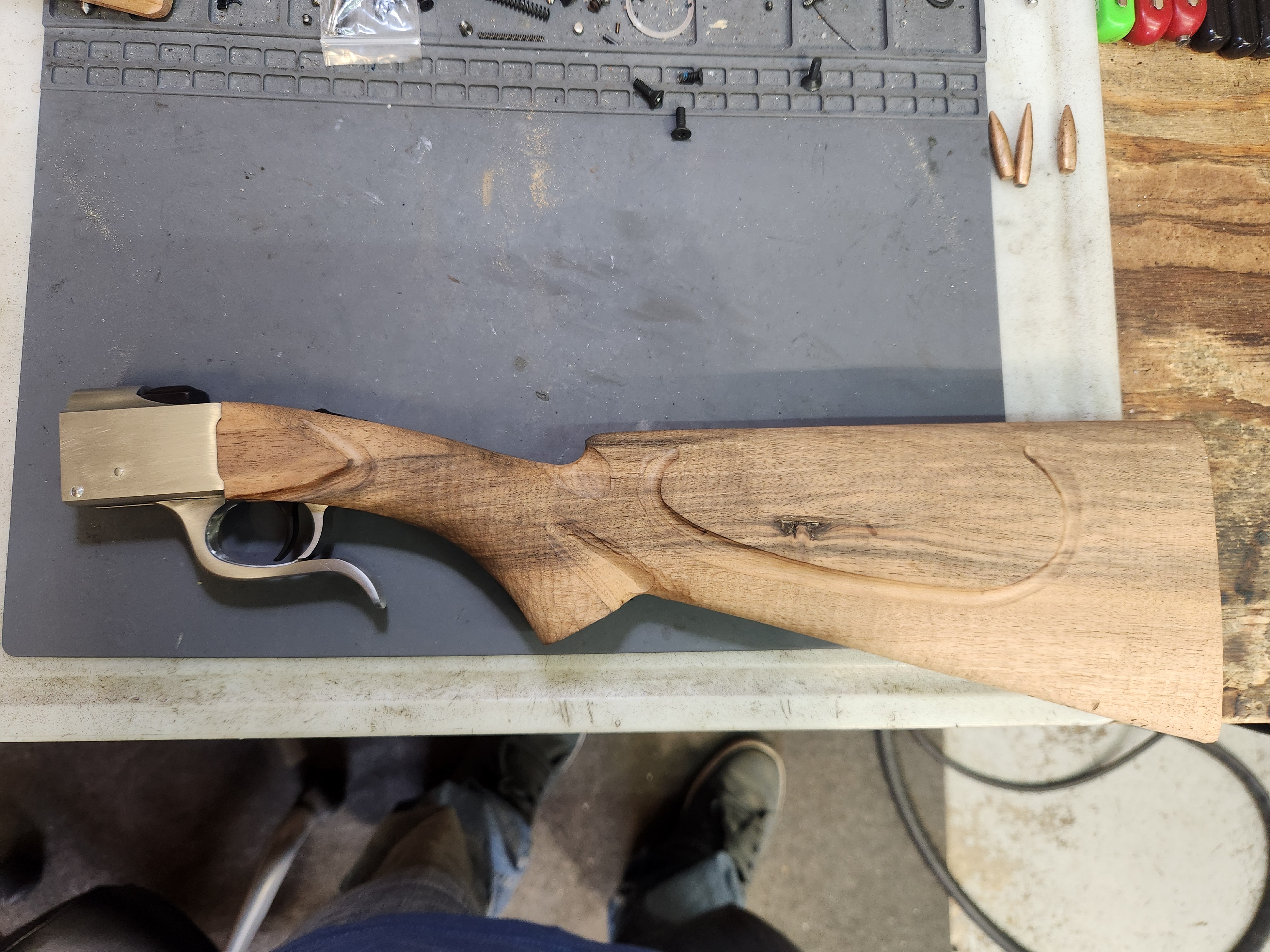

I got alot done so far. Most of the stock fitting to receiver but leaving the bulk because IIRC, you said you'd like to finish the wood. I got the receiver and parts buttery smooth after alot of hand fitting.
Re: Not ready for unveiling, at the planing/build stage...
Posted: Tue Apr 14, 2026 10:46 am
Damn!!!!!!!!!!!!! 😍❤️😍❤️😍❤️😍

Whoever drilled the stock for the bolt should be fired. They drilled from both ends of the stock (crooked) and didnt meet up either hole. I'm going to have to just drill it oversized, glue in a dowel and redo it.
Posted: Tue Apr 14, 2026 6:52 pm
Sorry to hear that! Didn’t want to cause you extra work but I’m glad you caught that.
