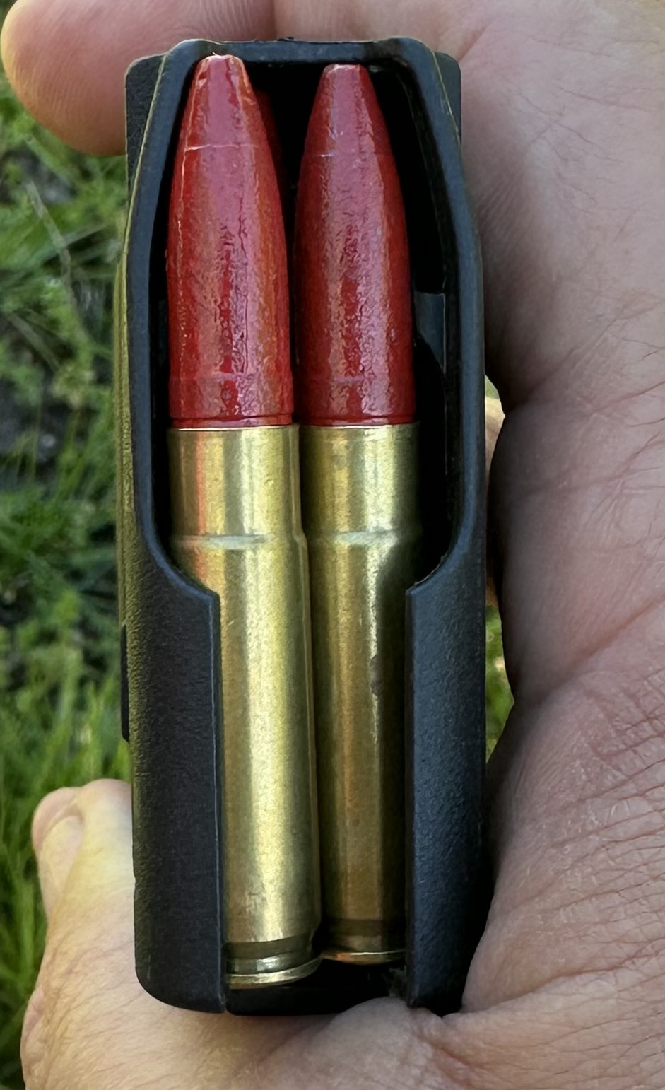

What's the cartridge length on those?
Posts: 3935
Re: Long boi bullet mold
jkp wrote: Sun Sep 22, 2024 11:10 pm What's the cartridge length on those?
All of it. 😬
I don’t have any handy, but it’s basically max mag length.

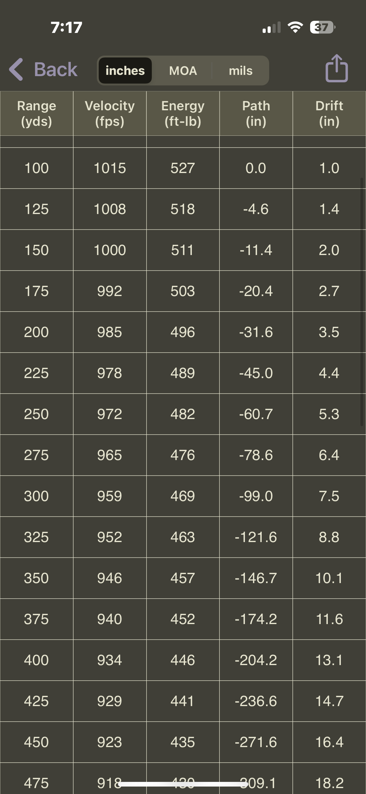

Posts: 3935
Assuming it’s leaving at 1050, which is close-ish,
Here’s the dope.

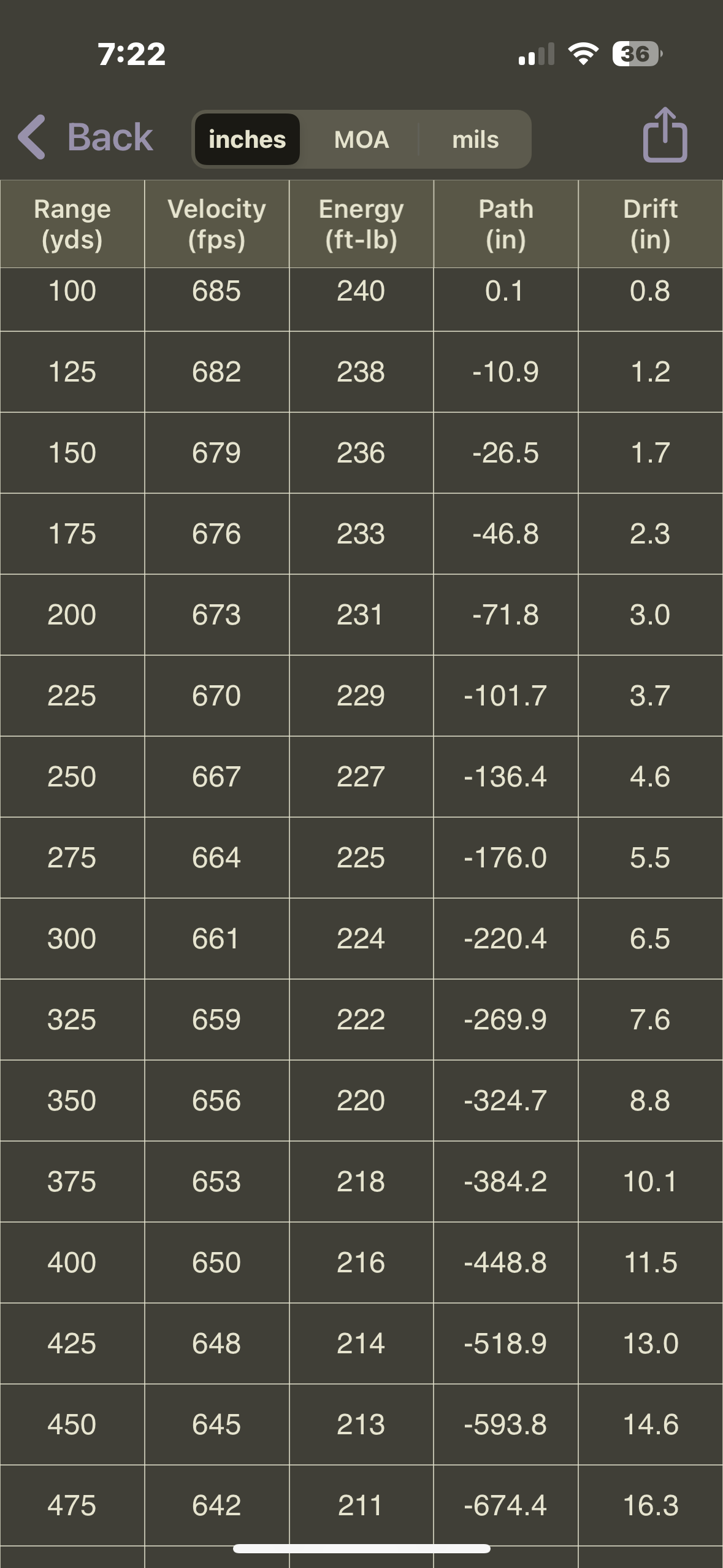

Posts: 3935
Leaving at 698 FPS, here’s the dope. Does NOT lose much speed as KP mentioned from muzzle to 300
Posts: 1185
CPJ 2.0 wrote: Mon Sep 23, 2024 12:23 am Leaving at 698 FPS, here’s the dope. Does NOT lose much speed as KP mentioned from muzzle to 300
I think that qualifies as a mortar.

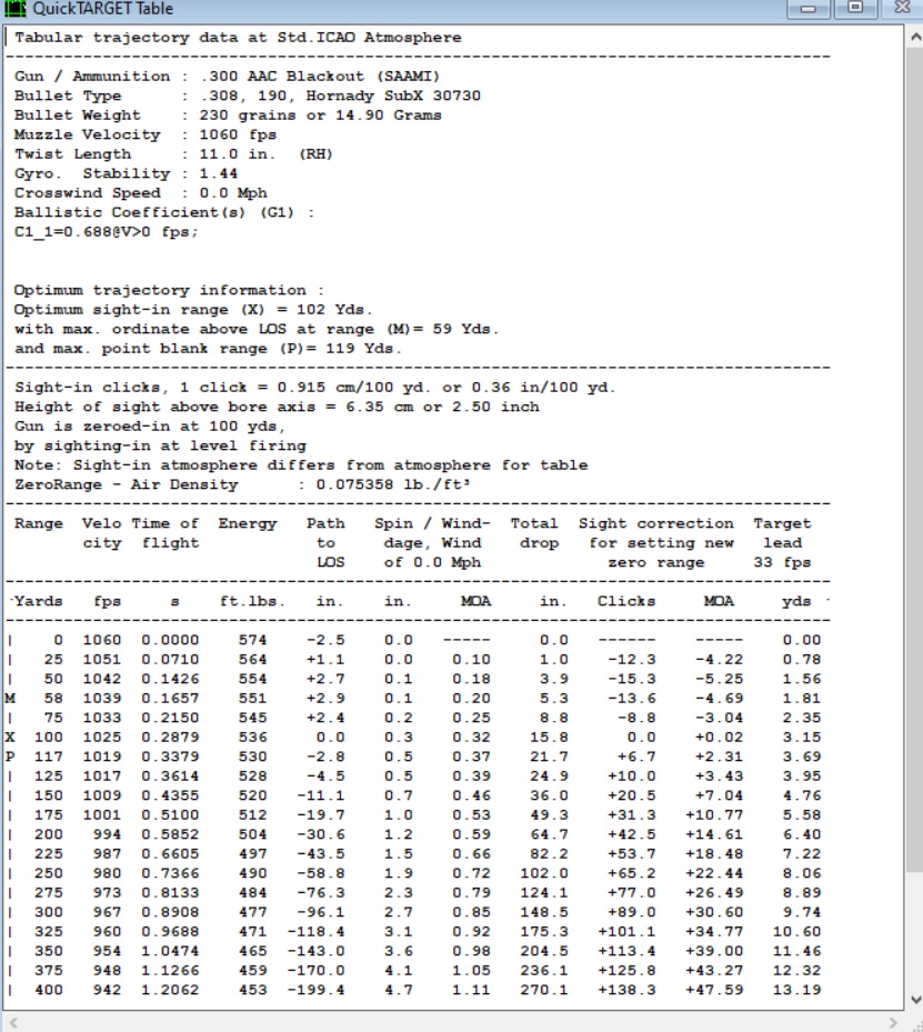

Main difference is that you mentioned
CPJ 2.0 wrote: Sat Sep 21, 2024 11:33 pm Single-ish hole groups at 25 yards.
So I figured that was your zero range.
Using the same 100yd zero you did, QuickTarget puts the drop of the 190gr @ 101" vs the 116" for the 25yrd zero
That 40ish extra grains of bullet weight carries momentum/velocity even better

Posts: 2241
Here's QT's numbers using 230gr and the 0.688 BC Bream listed and 1060fps
Posts: 2241
Sight in 7' above your 100 yard aiming point and you ought to be CLOSE at 300 yards

Posts: 2241
:oops: I looked at the irrelevant "Clicks" instead of MOA :oops:
32" high @ 100 should be close @ 300
3' high should put you on @ 325
