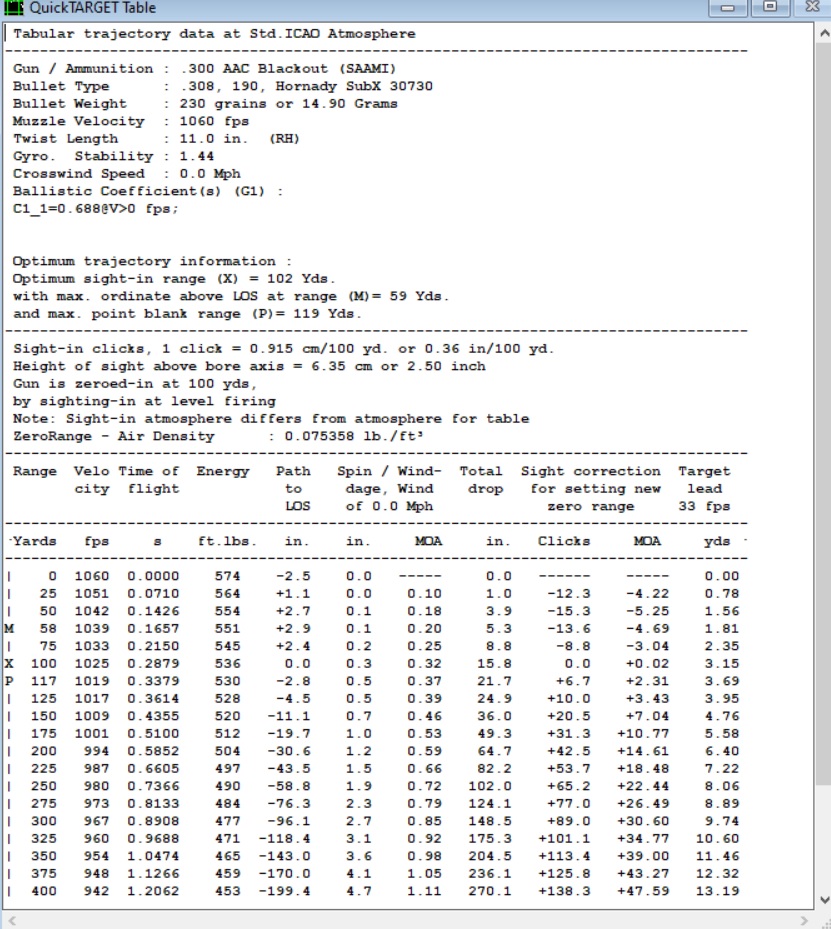

Using the same 100yd zero you did, QuickTarget puts the drop of the 190gr @ 101" vs the 116" for the 25yrd zero
That 40ish extra grains of bullet weight carries momentum/velocity even better

Here's QT's numbers using 230gr and the 0.688 BC Bream listed and 1060fps

Sight in 7' above your 100 yard aiming point and you ought to be CLOSE at 300 yards
Re: Long boi bullet mold
Posted: Mon Sep 23, 2024 2:22 am
Seven FEET! 🤣
Posted: Mon Sep 23, 2024 2:42 am
:oops: I looked at the irrelevant "Clicks" instead of MOA :oops:
32" high @ 100 should be close @ 300
3' high should put you on @ 325
