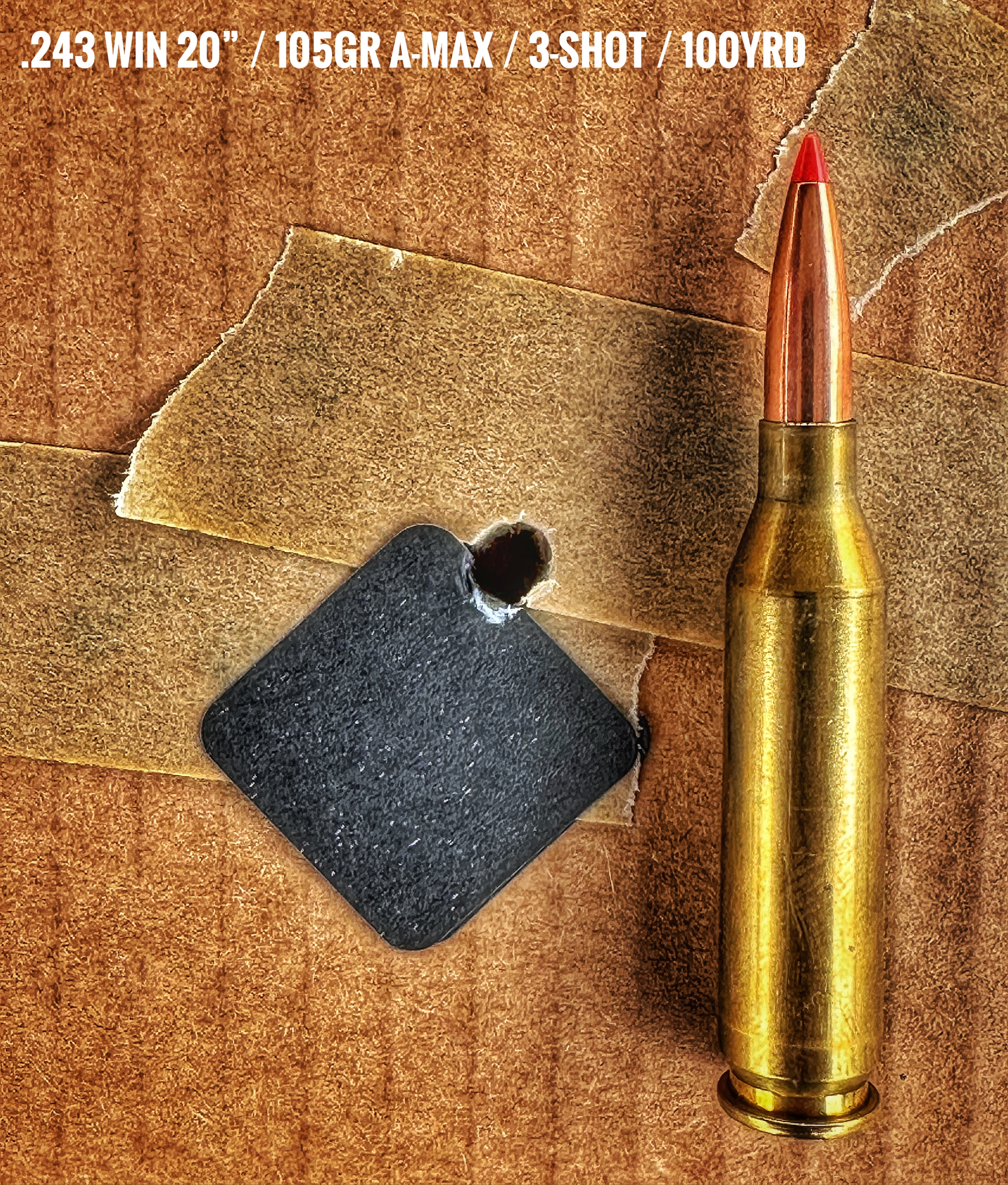

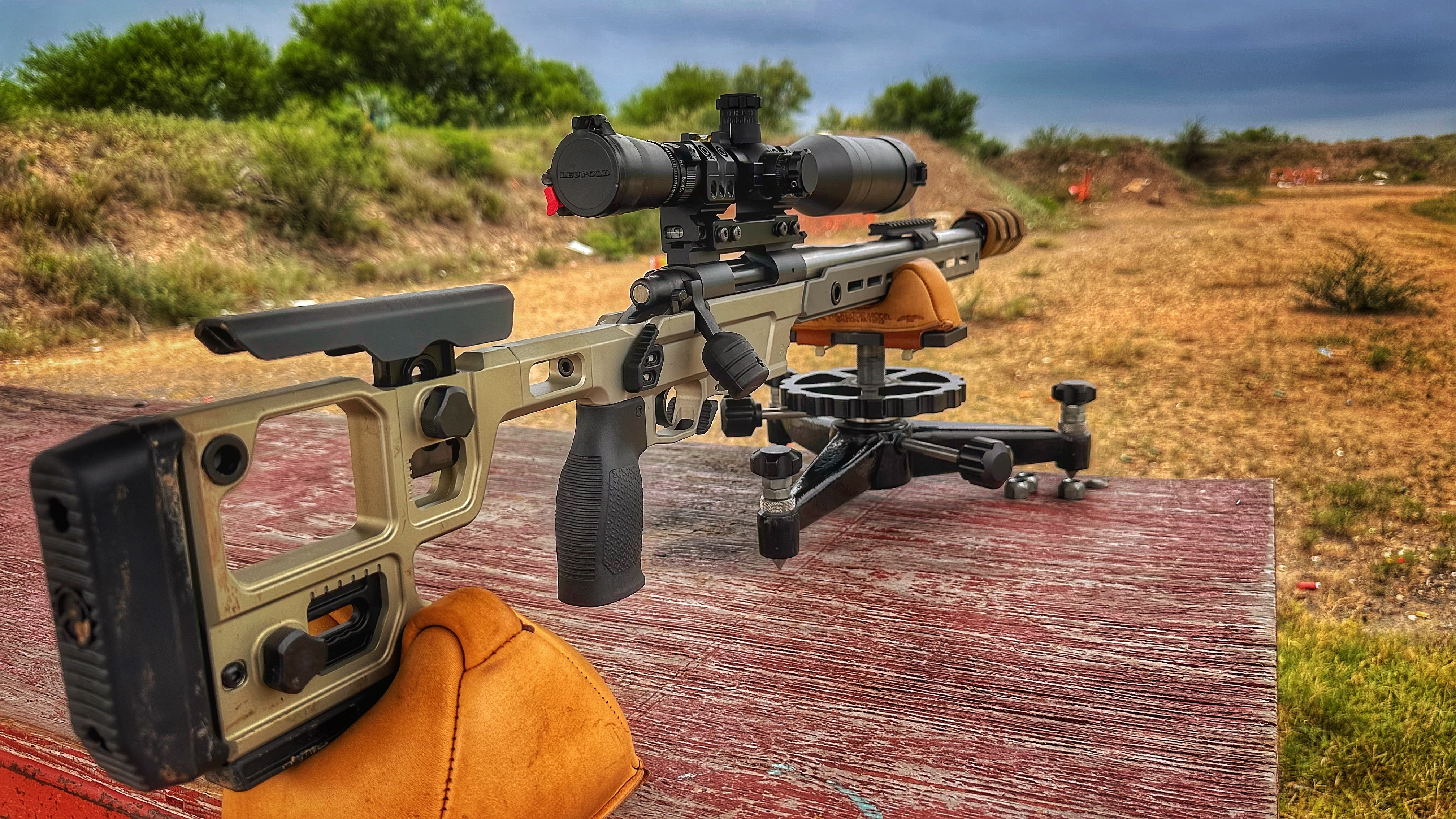

I clenched right getting the .243 Win sighted in this morning.

Zee wrote: ↑Sat Jun 01, 2024 3:30 pm I clenched right getting the .243 Win sighted in this morning.
Is thar the same .243 in a different chassis that I liked so much even though it is HEAVY
Posts: 2965
Diver43 wrote: ↑Sat Jun 01, 2024 4:30 pm
She still ain’t light.
Posts: 1796
I see 2 misses :twisted:
That is good shooting, no excuses with that one. Is that blood or mud on the right rear stock?
Posts: 2965
Chiro1989 wrote: ↑Sat Jun 01, 2024 6:54 pm I see 2 misses :twisted:
I was aiming at the top corner. Adjusted left a 1/4” and called it good.
Yes. A bit of both.

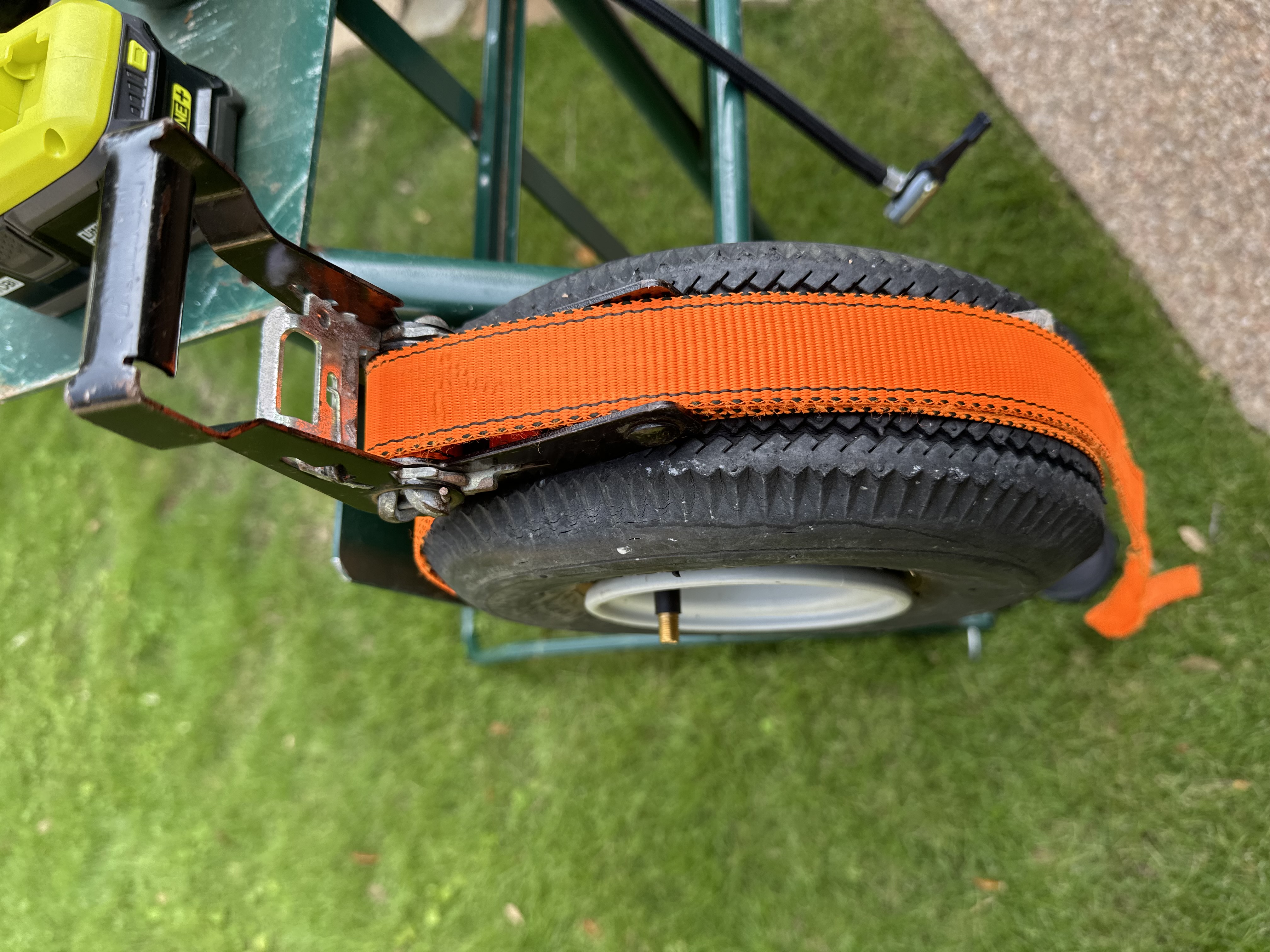

If you haven’t “seat’ed a bead” with a ratchet strap, can you really call yourself a redneck?

Rank amateur at BEST.
You can’t call yourself a redneck till you have seated a bead with a screwdriver and a piece of rope.

Haven't done it myself but I've always been impressed by videos stating a bead with carb cleaner or starting fluid.
The strap thing does work well for quad tires.

Done that also. Waaaaaaay more exciting than straps and ropes.
I do prefer the rope and screwdriver method over ratchet straps. Just twist up the tension, hit the air, and unwind the tension. More handy than ratcheting.
But, the starting fluid is more fun.
Posts: 1339
Doing it with starting fluid or brake parts cleaner was always something that I couldn't get to work, ironically when I worked as a mechanic. The fuggin tire would always just catch on fire.
Wasn't until one day in my driveway changing a tire on a Honda Civic that it actually worked for me and I still don't know why it did that time. Tickled me proud though.

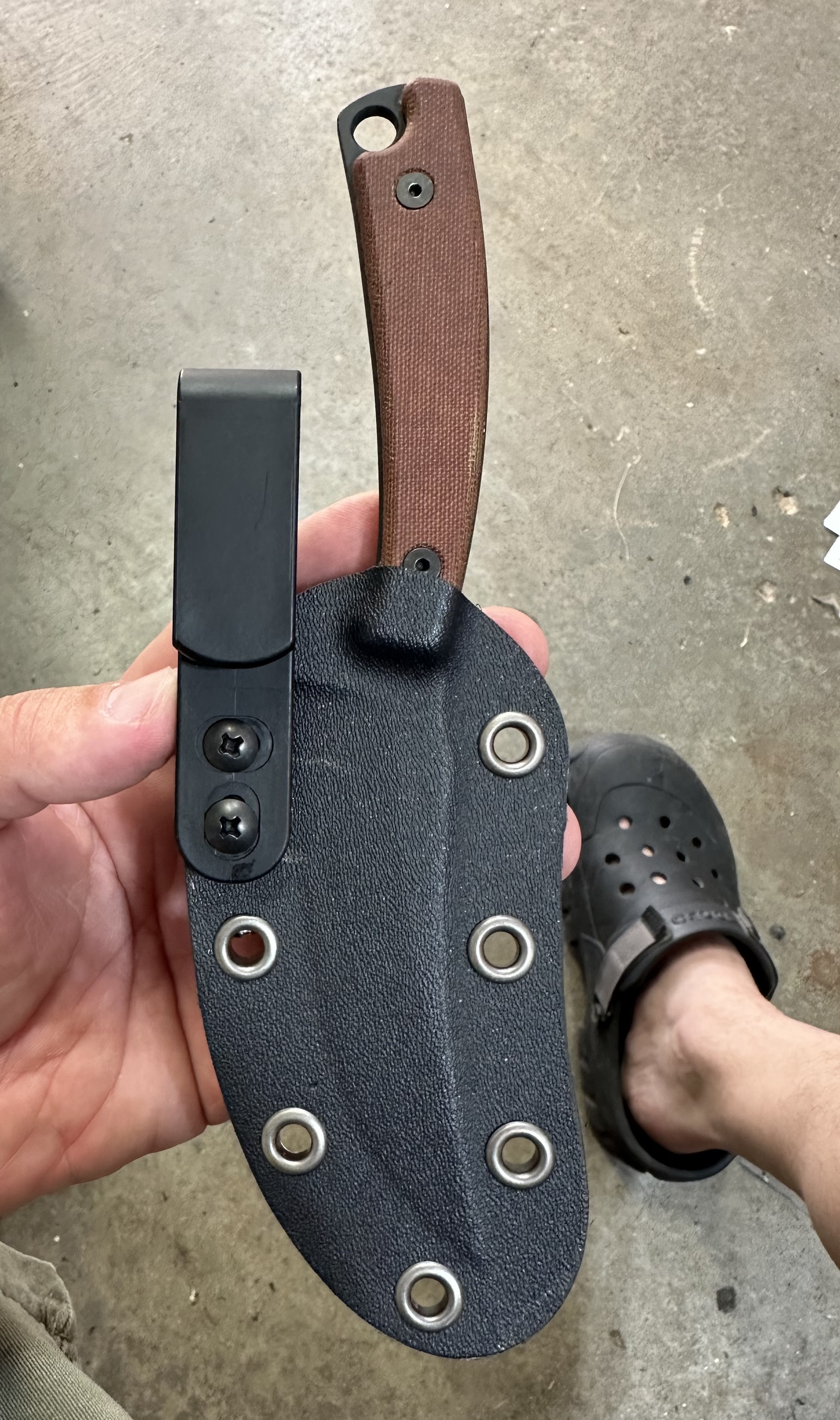

Oh. Lookie here. What is this? A kydex sheath for the Jackson Built SMF?
Since this is a prototype, lets just focus on the good side. 😬
Posts: 572
I like it!!
Posts: 2965
Looks good.

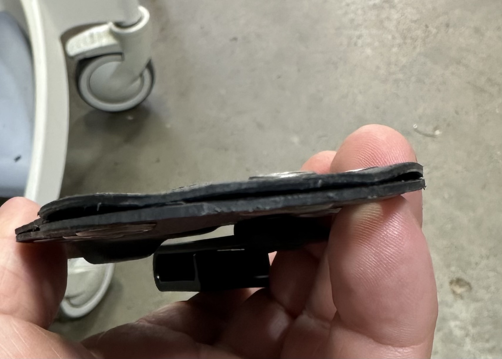

OK, I'll bite. What does the other side look like?
Posts: 4214
Diver43 wrote: ↑Sun Jun 02, 2024 8:11 pm
CPJ 2.0 wrote: ↑Sun Jun 02, 2024 4:48 pm Oh. Lookie here. What is this? A kydex sheath for the Jackson Built SMF?
Wavy. The 3d printed mold melted due to the heat from the kydex.
Posts: 1402
Have you found a work around yet?
Posts: 4214
Diver43 wrote: ↑Sun Jun 02, 2024 8:39 pm Have you found a work around yet?
Mill the mold from solid plastic. Which was always the plan. 3D printing allows for quick and cheap and easy prototyping. Id be $50 plus in wasted material at this point if I milled each one. Not counting the hours lost programming and machining. Printing the parts I can do faster. And while Ill sleep. Im a few bucks in at this point with 3d filament.
Posts: 1402
CPJ 2.0 wrote: ↑Sun Jun 02, 2024 9:16 pm
Makes sense time and money wise

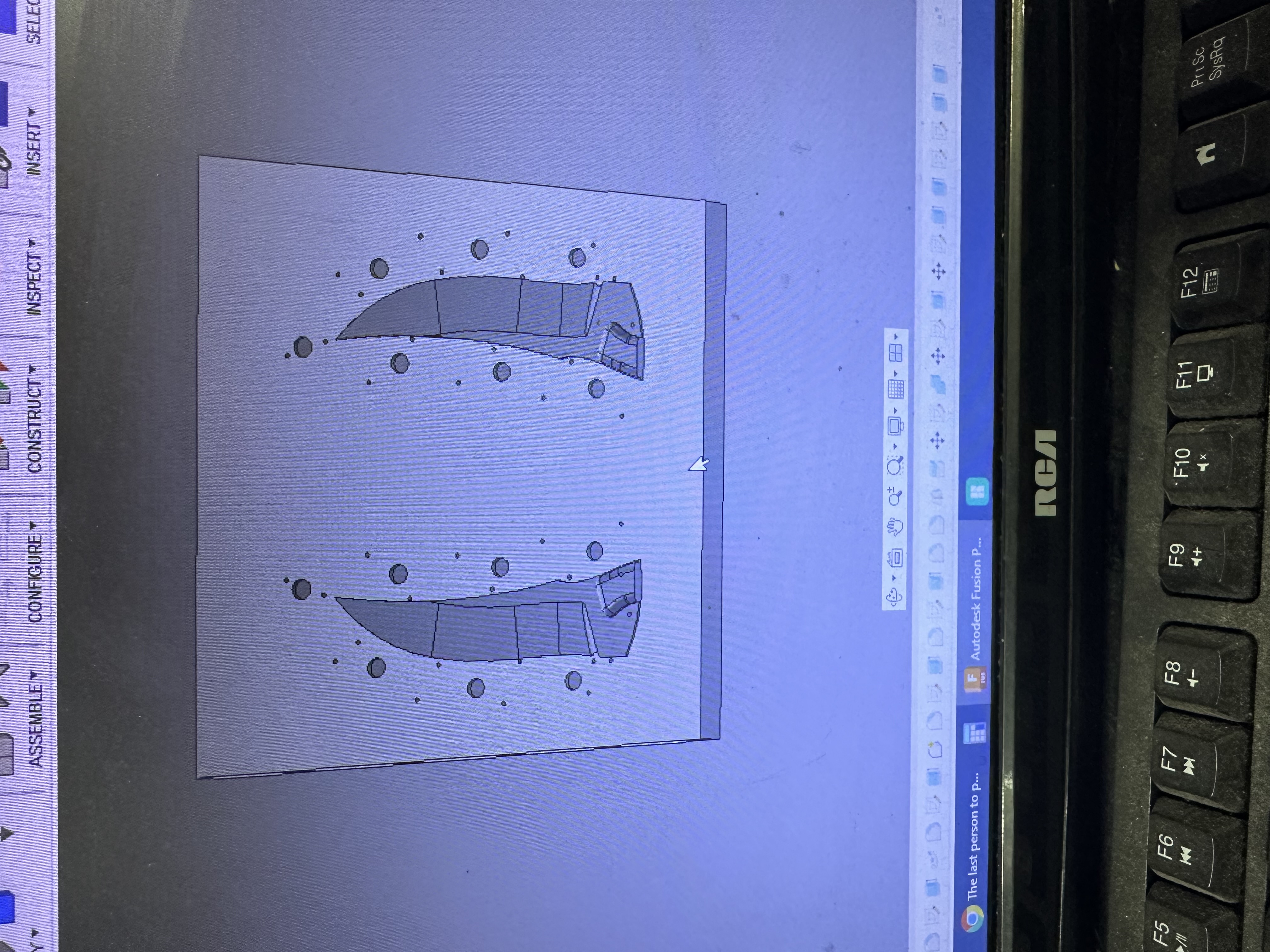

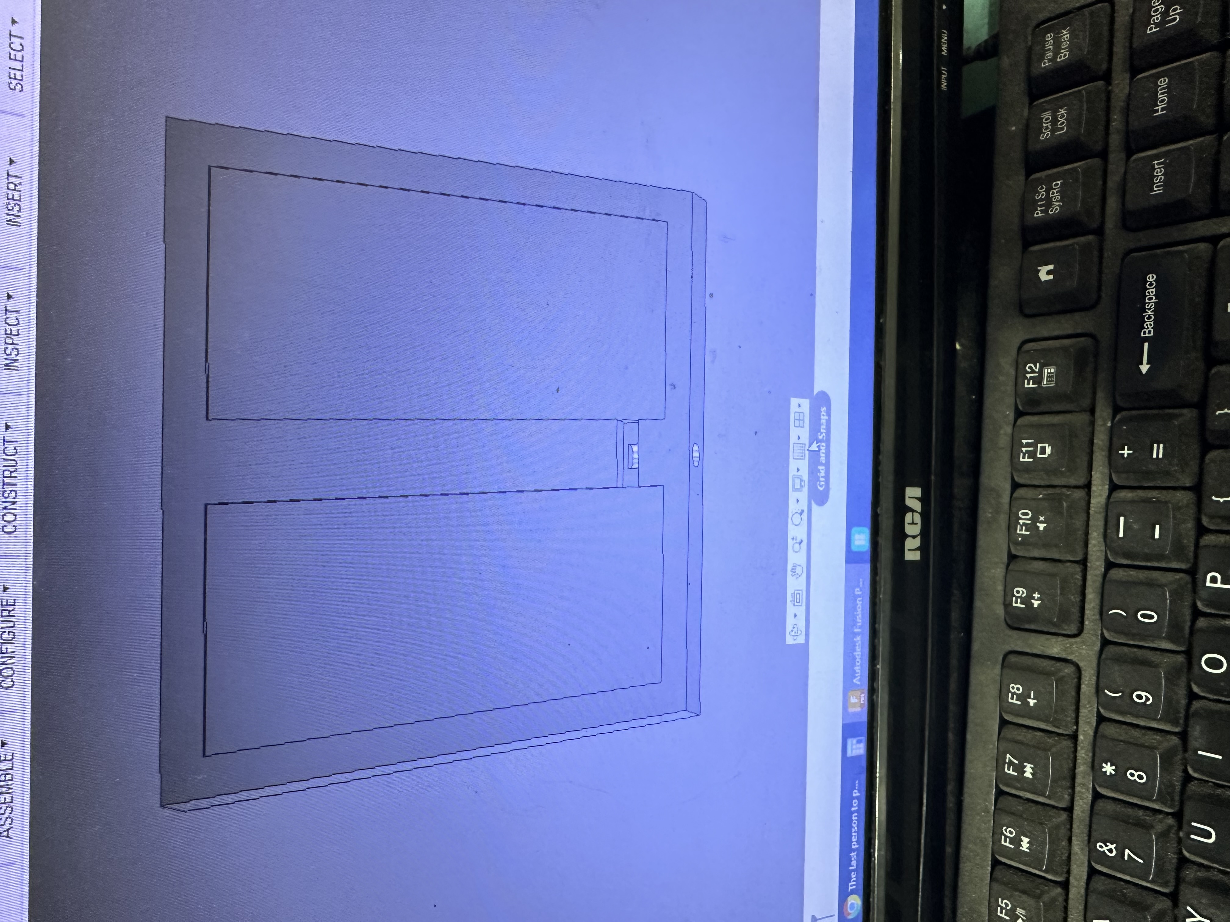

CAD model of the vacuum mold and the base it sits on.
Once it’s formed, the CNC machine will cut the outer profile, and drill the rivet holes. All the small 1/16th holes you see are where the suckage from below transfers to the kydex.

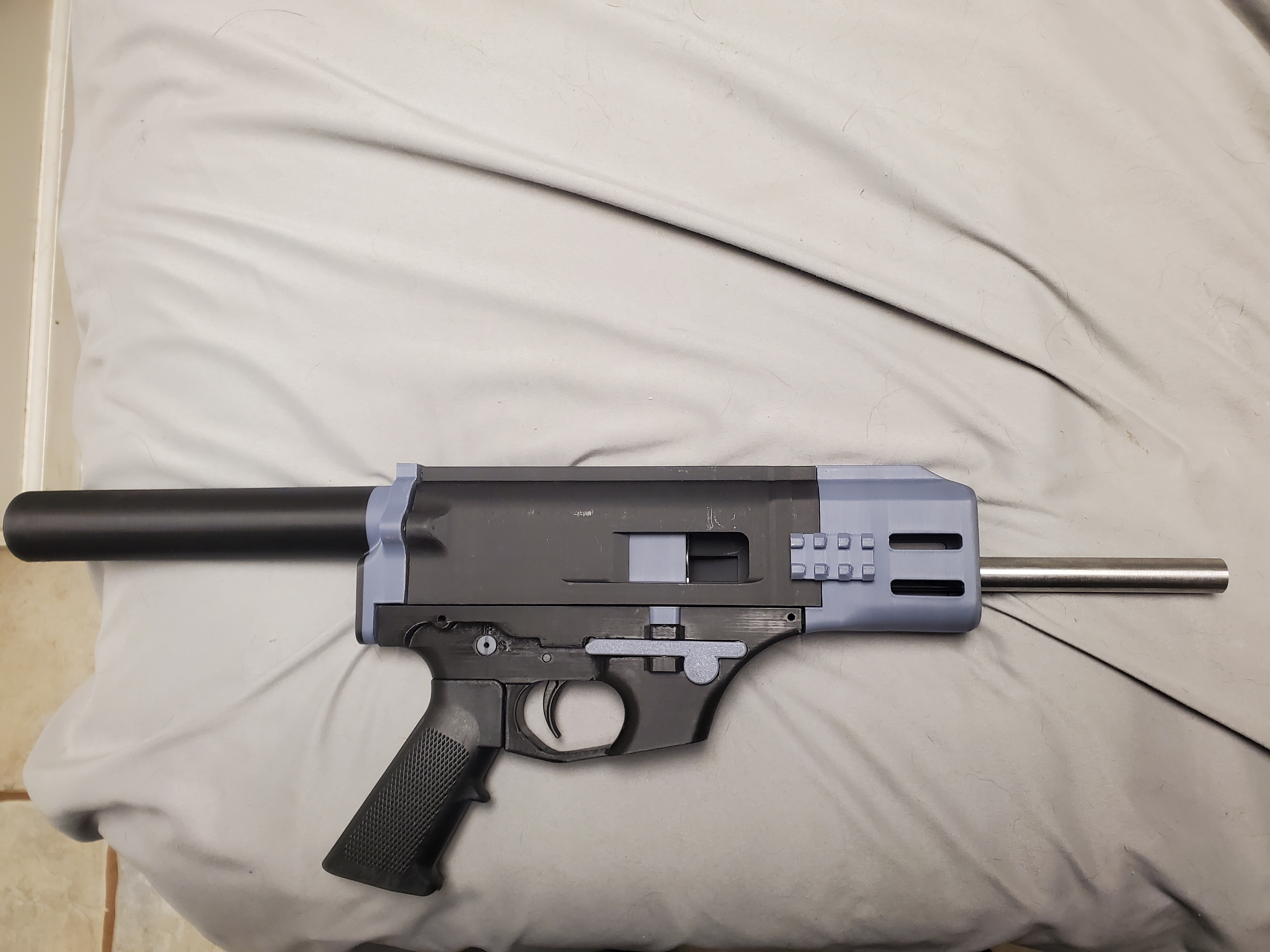

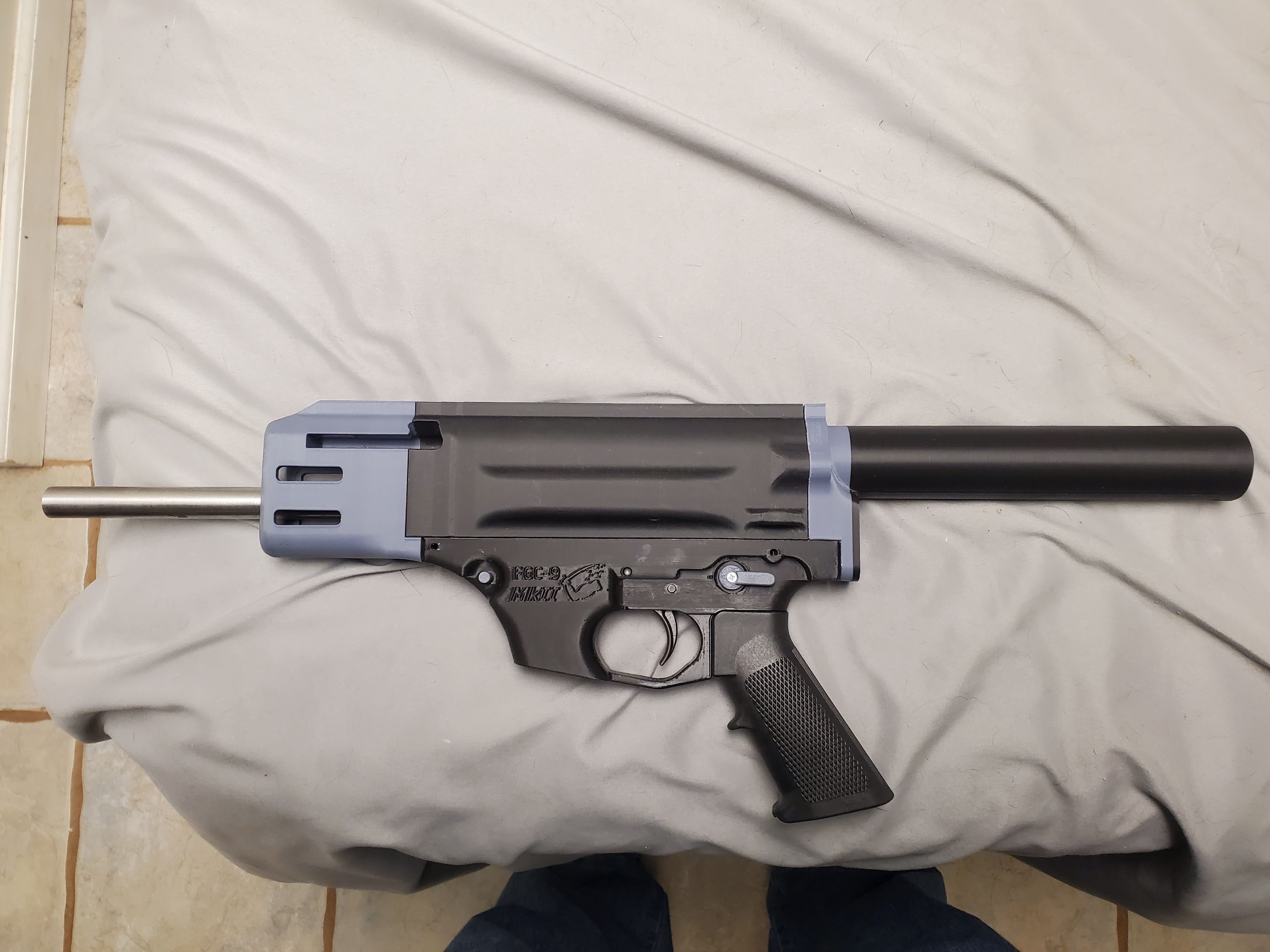

It's coming along. Instead of buying the hardware individually, I found a place online that sells it as a kit so it'll be here in a few days. Until then I'll get the chamber cut but I'm still deciding on whether or not I want to use a boring bar or rent a reamer. I like the way it looks.
Posts: 4214
Boring bar. 100%.
Unless you have the reamer
