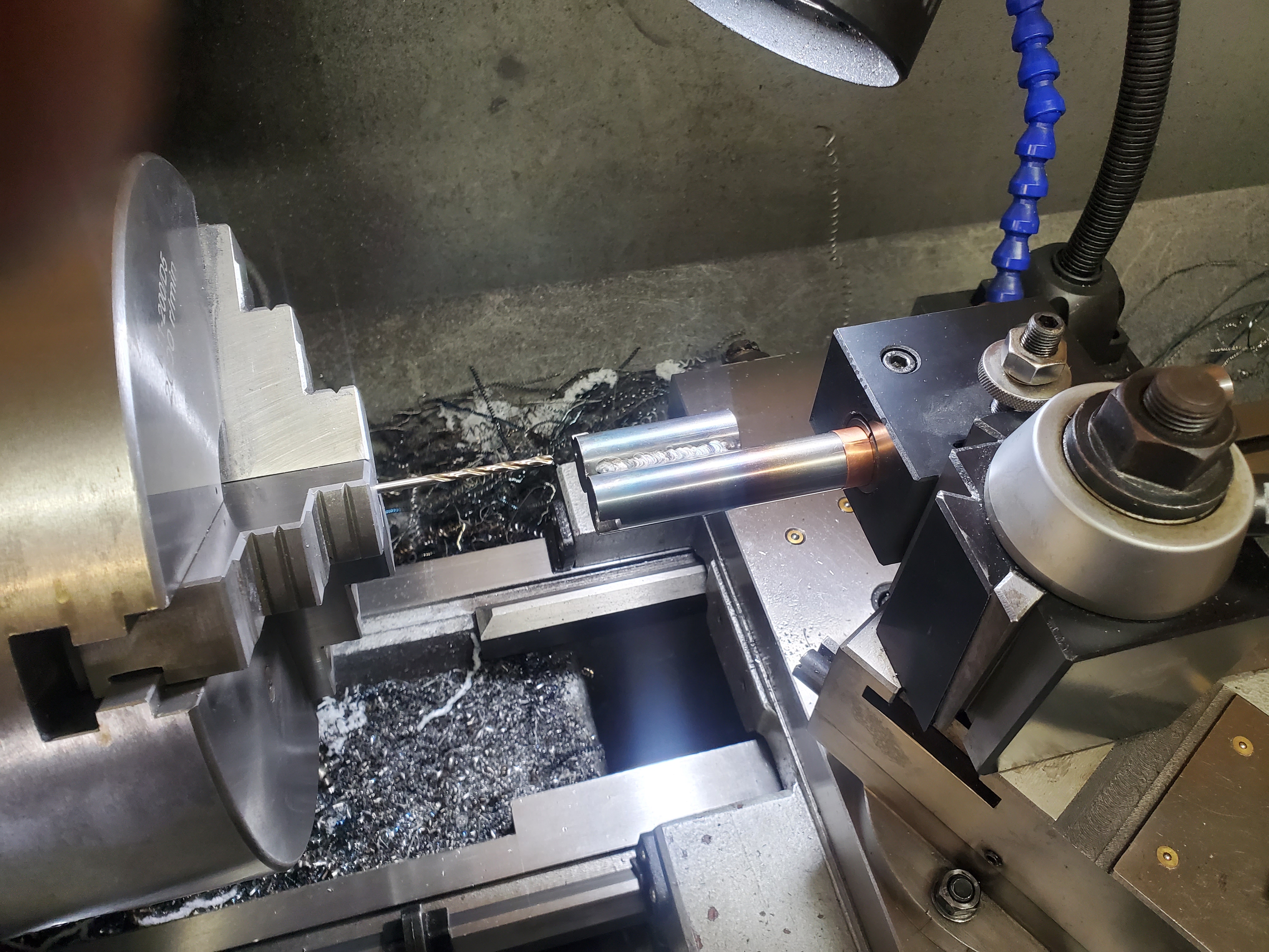

What a pain in the ****. Apparently you're supposed to drill the firing pin hole before joint the two metal rods together which most people do with a hand drill. Yeah right. Even so, after having them welded together it wouldn't fit the 4 jaw chuck in the lathe because of the offset and I didn't feel like making a fixture so I got creative.
It worked out really well and left me with a nice drilled and reamed hole.

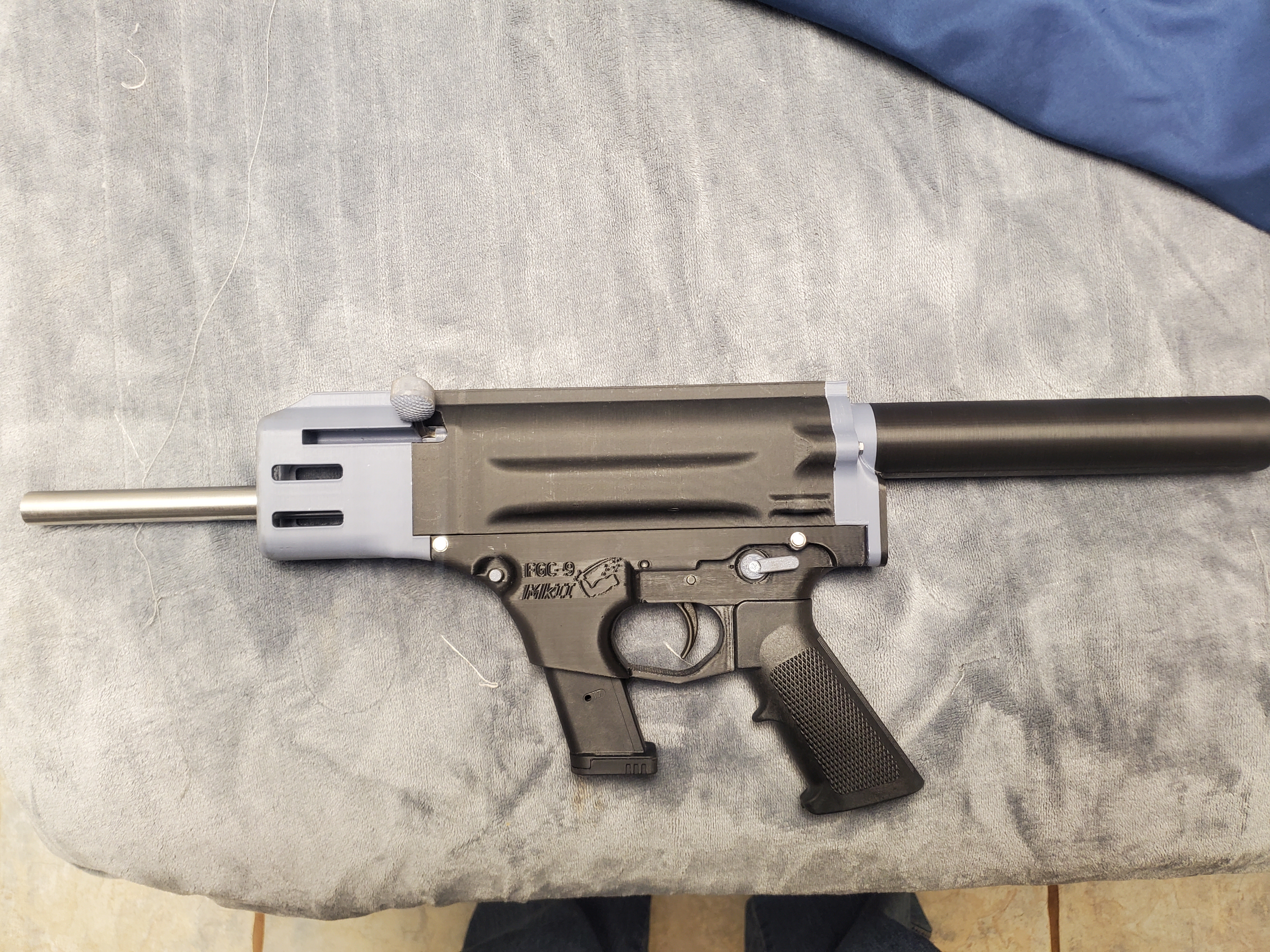

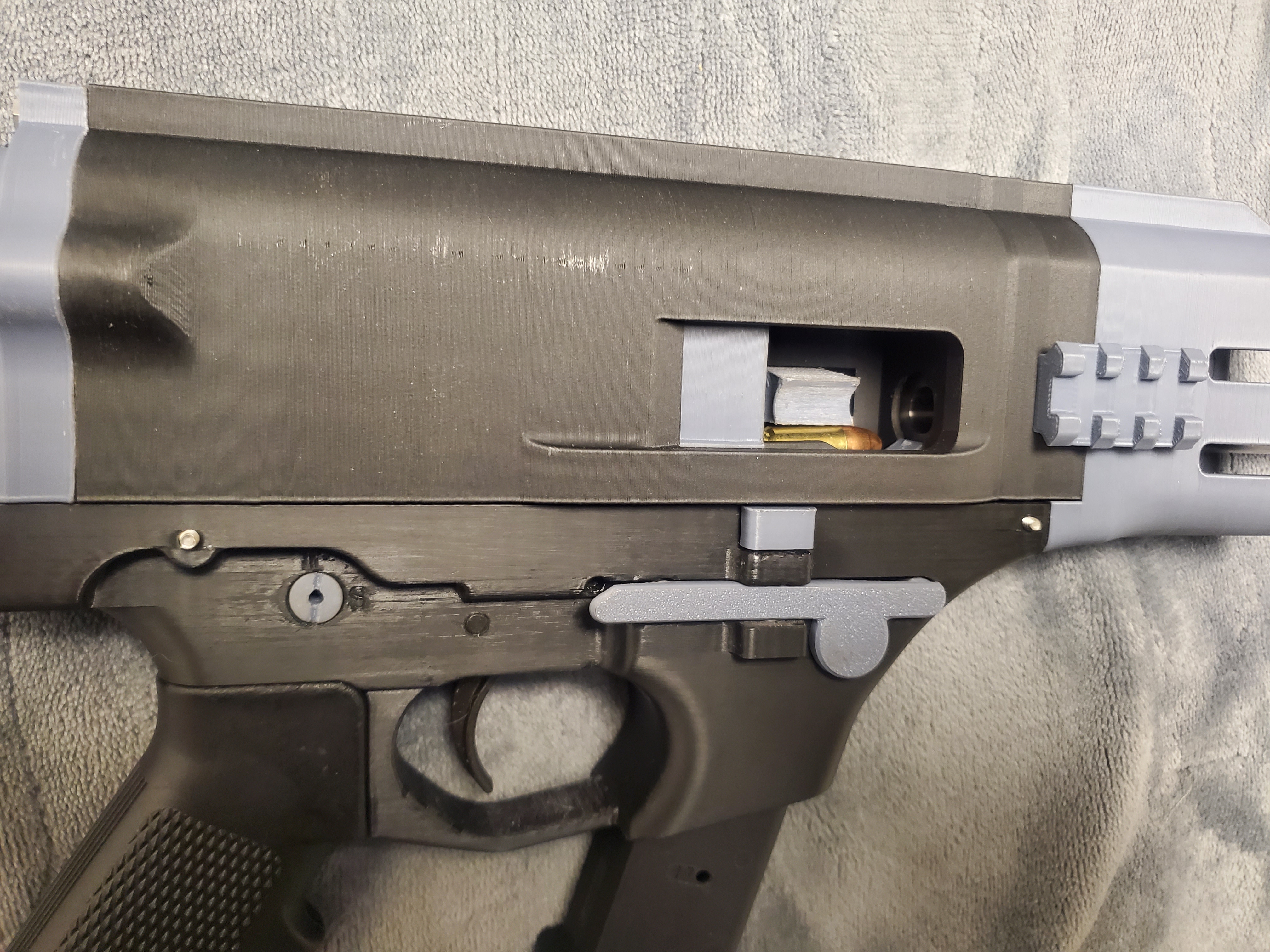

Well it works, and works well too! I get perfect primer strikes because instead of using the 3d printed template guide to hand drill the firing pin channel, I found the dead center to where the pin needs to be by making a hardened center punch that fit the bore and assembled it to punch the bolt. And it absolutely throws the cases out really good for a gun without an extractor. And now it'll go in the safe with the rest of the stuff I own and never shoot.

Nicely done hey, needs a red dot, bayonet mount if you want to go full Redneck ;)

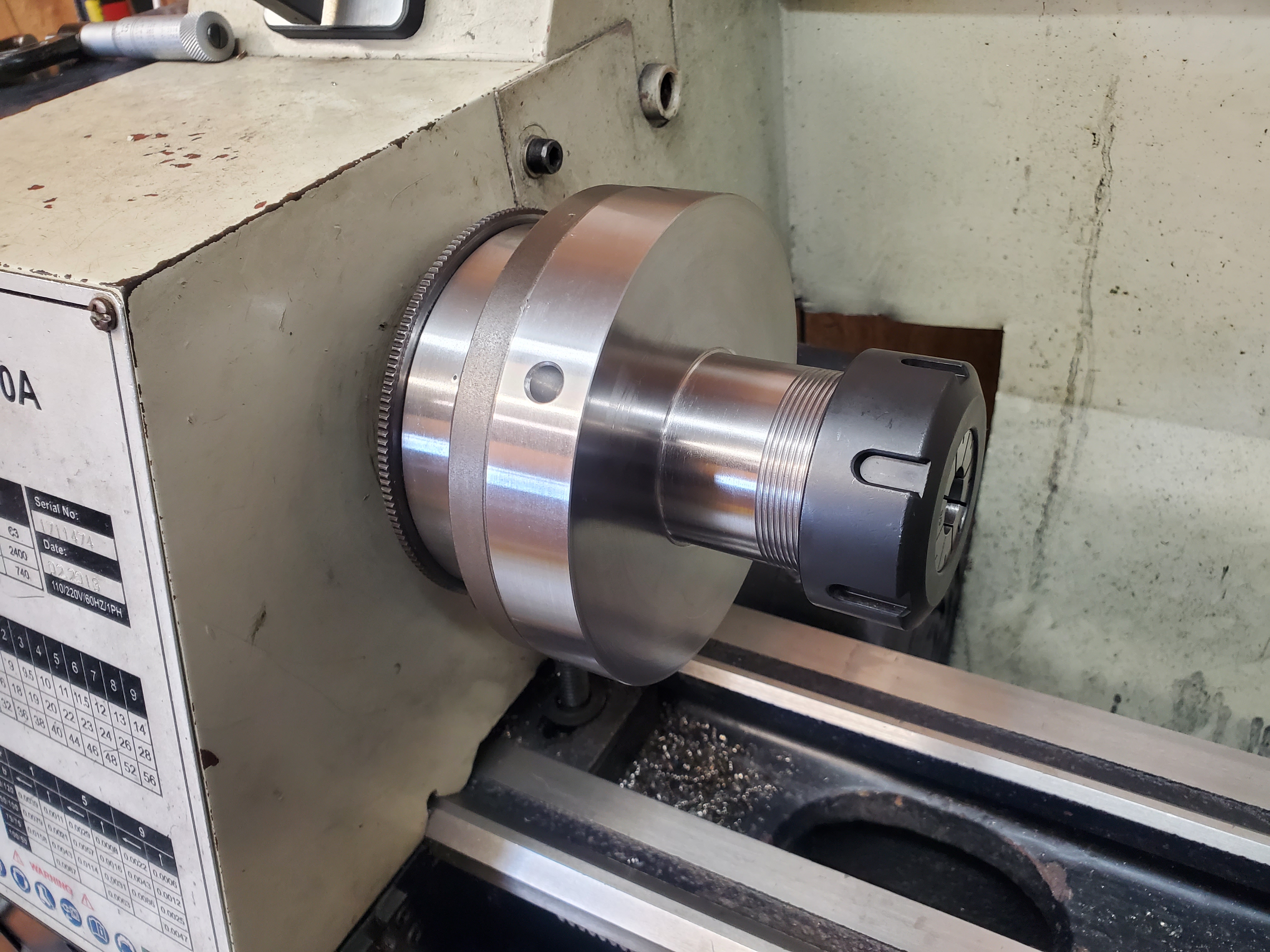

Been wanting to make an ER40 collet chuck for my small 10x30 benchtop lathe for a while. I used to use mostly the 3 jaw chuck for it because it had .0003 runout over 6 inches but the jaws got bell mouthed. I typically keep my 4 jaw in my 14x40 lathe for indicating barrels and larger stuff because it has a 2.25 inch spindle bore. Anyhow, ordered a piece of 1045 from ebay and got started on it yesterday and finished today. It has absolutely zero runout since I machined it on the spindle. I'll use the hell out of this thing.

Collet chucks can NOT be beat as long as you can turn whatever run out the stock has out before you get to the final diameter. Just like a 3 jaw.
But the repeatability is sooooo much better than a three jaw. More importantly, you don’t foul up the part finish with the collet.

Exactly. Aaaannd, the part doesn't deflect nearly as much as it does being in a 3 or 4 jaw.

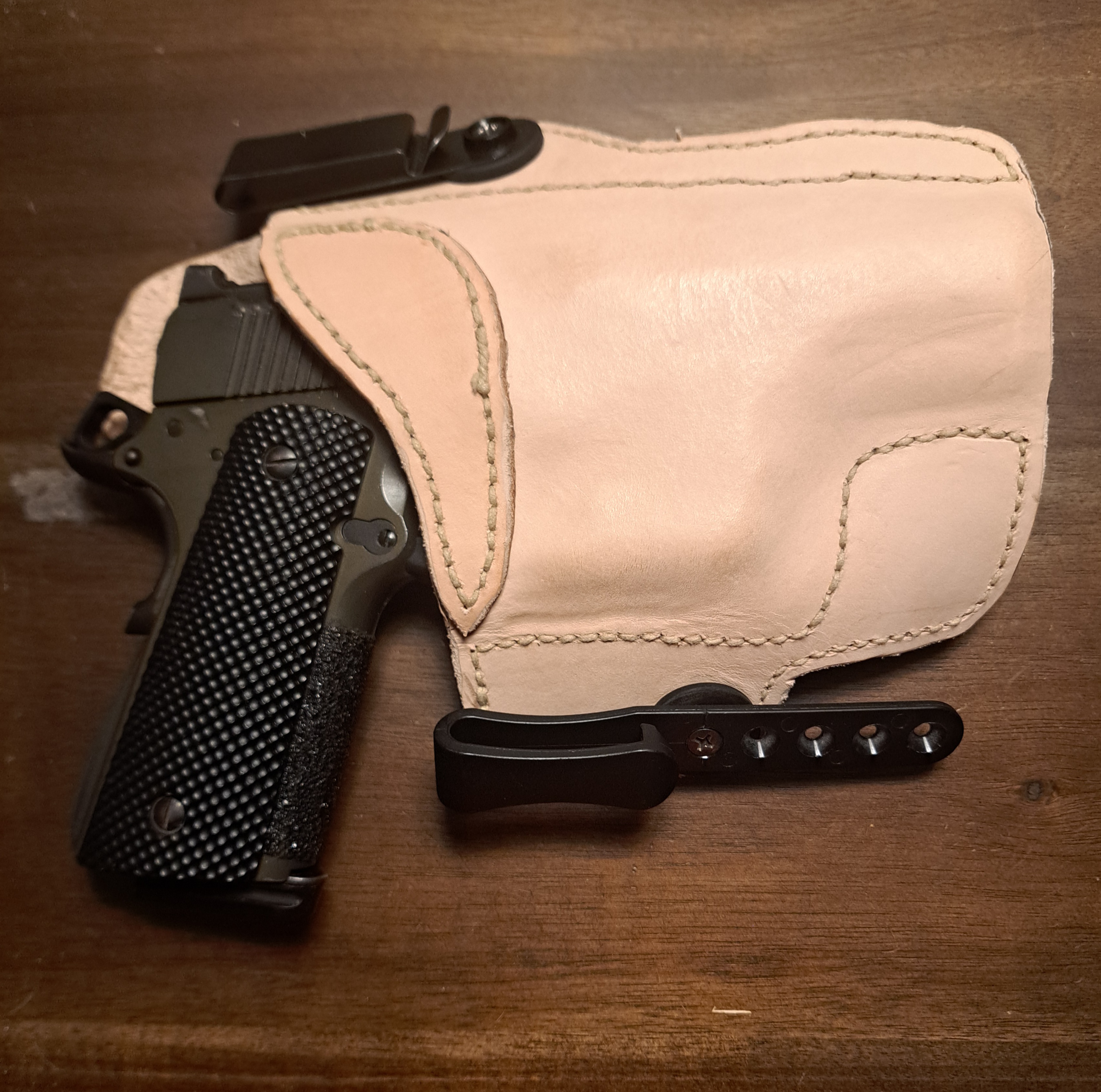

What do you do when you get tired of having a "nightstand" and a "carry" pistol because you can't find a holster for your light-equipped pistol?
Make a holster. It's crude, and the supplies are from Hobby Lobby, but it's IWB so nobody should see it and it seems to work.
It's based on a Wright Leatherworks Banshee.
Now to sweat in it and get it broken in.
