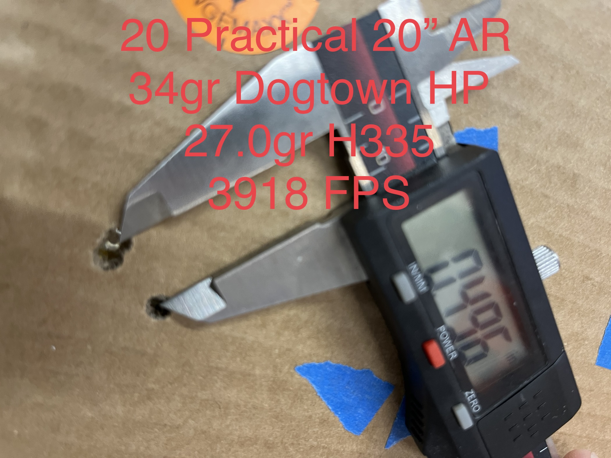

I considered the 204, but ended up going with 20 Practical. Very similar ballistics, but I went with the AR platform.
I’ve found H335 gives great velocity and good enough accuracy. Benchmark gave the best accuracy, but was very slow. My 34gr hollow point load is using H335 and going just a touch over 3900 fps. It’s killed 3 coyotes so far, with some pretty impressive results. With proper load data, I’m sure working up a similar load for the 204 wouldn’t be hard.

Jay wrote: Wed May 29, 2024 12:14 am I considered the 204, but ended up going with 20 Practical. Very similar ballistics, but I went with the AR platform.
That's moving along for a 20" barrel!
It’s pretty quick. Still trying to work on a 40gr Vmax load for it. The goal being a varmint and predator rig, I kept it at 20” as a happy medium. Could have gone with 24” and got a bit more speed. But turns out I really don’t need it. And adding a suppressor to it, 24” plus suppressor would have made it not so handy. But ballistically, very similar to the 204, but standard AR length.
H335 will probably be your friend to keep velocity up.

The 20 Practical in the link is what I’m running. 20 Tac is the same thing, with a different shoulder angle. Both wildcats. Using 223 brass. Very similar ballistics, along with the 204 Ruger. Big difference being, you can buy 20 Tac dies and there is published load data for it. :D
But, 20P is easy. I’m using a Redding 223 Remington bushing die with a .230 titanium nitride bushing. Just neck down, prime, charge, seat. Done. Sub 1/2” groups, 3900 and some change out of a 20” AR… :D
