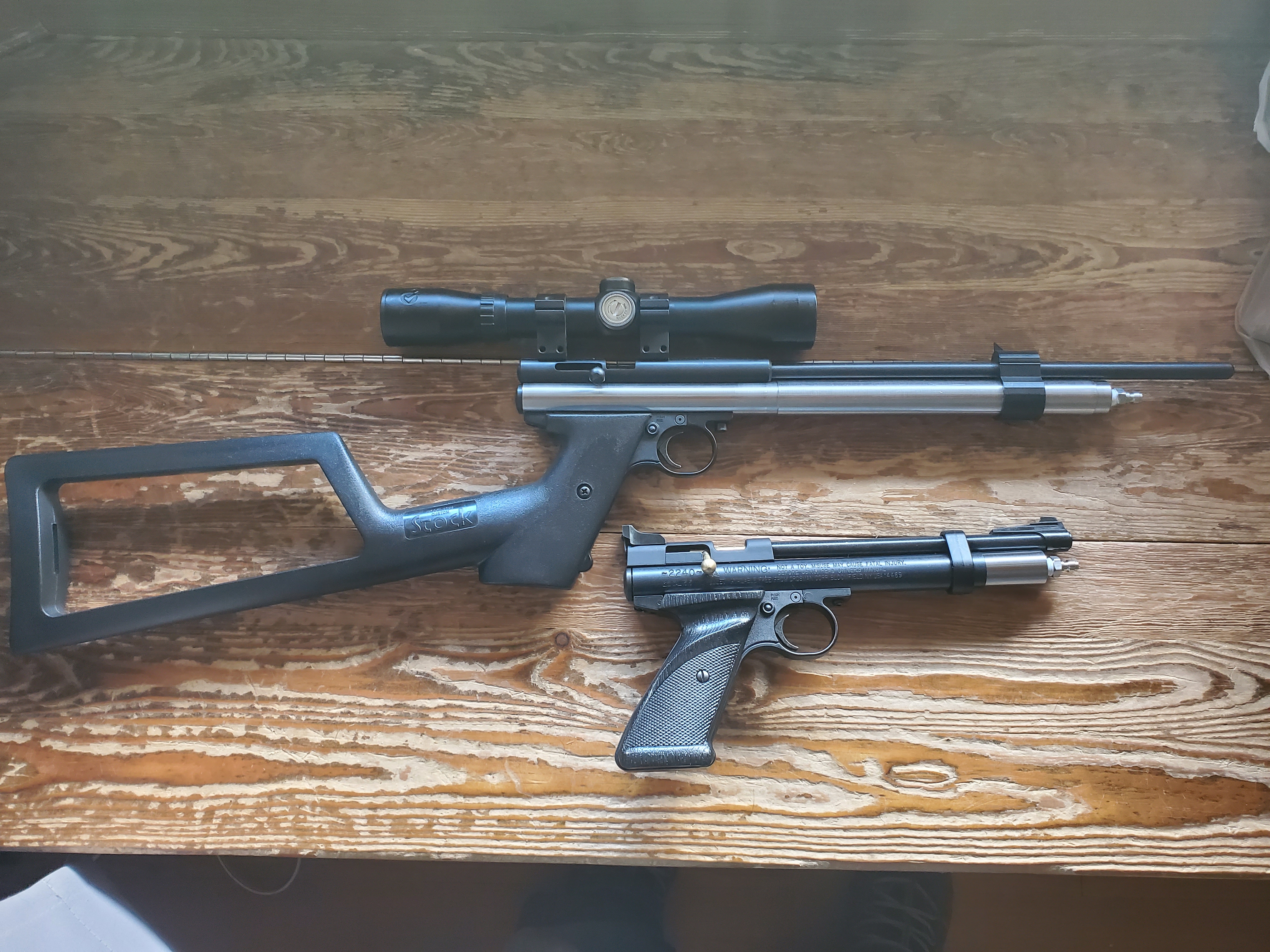

This started out as a Crosman 1332, the one that you had to work up a sweat hand pumping it 10 times between shots. I put it on the chronograph beforehand and it hovered at around 390fps when pumped 10 times.
I always wanted to convert one to a PCP so I got started on it. Ended up making a housing/pressure tank that holds the valve and hammer. I also disassembled the valve, opened the passages and replaced the orings with harder teflon rings to take the higher pressures.
Had to come up with a barrel band for the front since the old one that incorporated the hand pump wouldn't work anymore so I got to take a crash course in CAD design for the 3d printer but it turned out fantastic. I also made a front sight blade into it.
Got it all assembled and hand pumped up to 2000psi which gave me a velocity of 638fps. Not bad out of an 8 inch barrel. I might throw a longer barrel on it later just for the velocity increase but this thing is fun! Not sure what the shot count will be but it's not using much pressure between shots.

What kind of pellets did you use? What weight? How big is the tank? Just wondering.

2.5 cubic inches for the tank volume. Not sure on the pellet weight but I used the same ones for before and after velocity. I cant remember if I stated that this is a 22 caliber.

If you have the opportunity, could you chronograph, at least, five pellets back to back? I'll have a better idea of how much pressure you're dropping per shot. I'm guessing not too much but measuring would be better than guessing.
I measured my own Crosman pellets, both the Flat Points and the kinda pointed RN, they both weighed 14.2 gr. If you don't know the weight of your own hollow point pellets, I'll use 14.2 gr as a guess, just to get started.
With those velocity numbers, along with barrel length, pressure, tank volume and pellet weight, I'll have enough to get started. I want to play with some numbers. You know, just for fun. :mrgreen:

Turns out that you can buy the steel breech at Pyramidair so I ordered one of those and the 14 inch barrel. I'm going to make a threaded adapter so that I can put my can on this thing.

Oh, I will get some chronograph numbers for you as well when I get back in the shop. I'm curious to see the velocity drop also.

Well I did get some numbers today. Did the steel breach conversion with longer barrel and also made a PCP conversion for the 2240 model which actually works incredibly well. Pumped up to 2250psi, the SBR does 784, 792, 796, 792, 789. I think I hit the pressure that the valve was starting to have lockup at because as the pressure dropped, the velocity went up. Overall, not a bad velocity string. After that the shots were dropping by roughly 5 psi, then 10 psi.

Justsomedude wrote: Sat Jul 15, 2023 9:00 pm 20230715_165345.jpgWell I did get some numbers today. Did the steel breach conversion with longer barrel and also made a PCP conversion for the 2240 model which actually works incredibly well. Pumped up to 2250psi, the SBR does 784, 792, 796, 792, 789. I think I hit the pressure that the valve was starting to have lockup at because as the pressure dropped, the velocity went up. Overall, not a bad velocity string. After that the shots were dropping by roughly 5 psi, then 10 psi.
Yeah, I agree on the lockup.
You used a longer barrel? How long?
BTW, those are good velocities from a pistol airgun. 👍
"After that the shots were dropping by roughly 5 psi, then 10 psi."
You were measuring the tank pressure directly? Just wondering.
How many shots did you manage to fire before you were about 90% velocity?
Thanks for the update.

I definitely wasn't as thorough with testing as I could have been. I tried different tank pressures before I finally got to where I took these velocities because I tried 2500psi and it wouldn't even smack the valve open. That's when I backed off to 2250. It's also a 14.7" bbl. I'm not sure about the 90% velocity part but it hovered around 780 ish for quite a while. I should also add that I misspoke. It was dropping 5fps then later on 10fps with subsequent shots.

Justsomedude wrote: Sat Jul 15, 2023 9:59 pm I definitely wasn't as thorough with testing as I could have been. I tried different tank pressures before I finally got to where I took these velocities because I tried 2500psi and it wouldn't even smack the valve open. That's when I backed off to 2250. It's also a 14.7" bbl. I'm not sure about the 90% velocity part but it hovered around 780 ish for quite a while. I should also add that I misspoke. It was dropping 5fps then later on 10fps with subsequent shots.
Ok, that makes sense... I wouldn't expect it to decrease linearly. I think I have enough info to start guessing at a few things.
