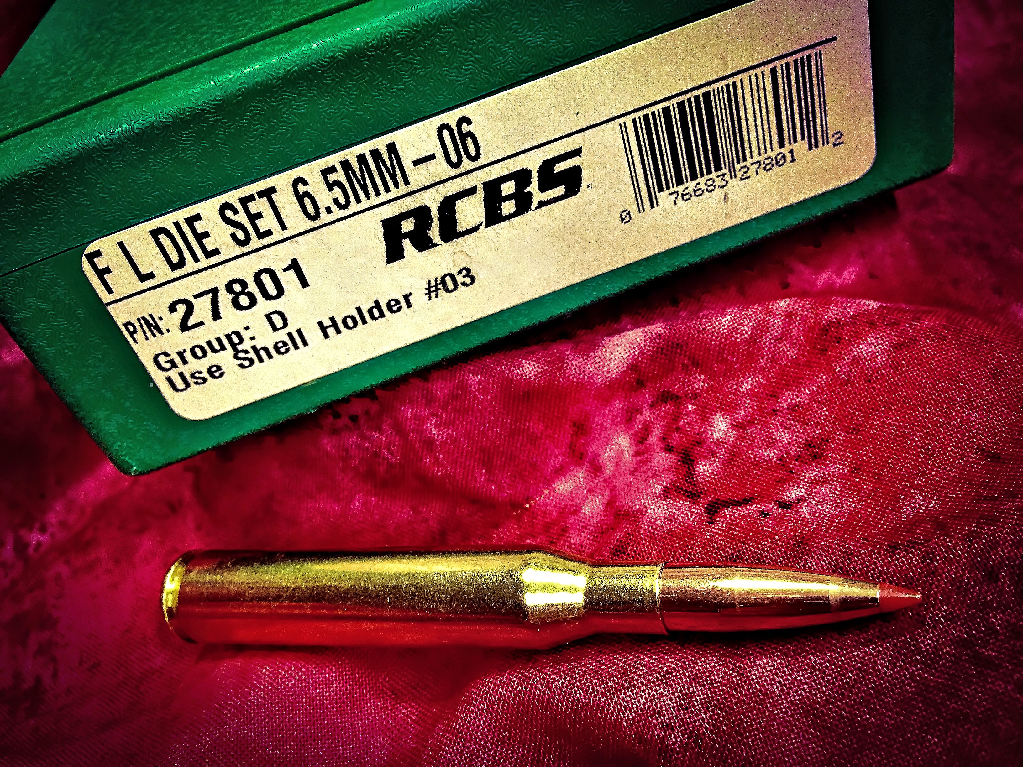

I never even considered it! I used to reload a lot! I never like Nickel brass. I haven't had the need to resize brass like this. I had a 7TCU that I fire formed brass, but what was a different procedure. I used unique, corn meal and paraffin wax fired into a homemade sewer pipe fire forming silencer with a steel plate in the bottom.
I'm excited about this project, it's the rifle Jerry and my late friend John worked on. After 15 years, I'll finally get to shoot it!
The dies for the Creedmoor and 6.5-06 came today $130
Primers are on the way $130
Bullets $110
Powder Varget and IMR4350 $115
I still need 30–06 cases! It will be close to $600 before I start reloading for these two rifles!
