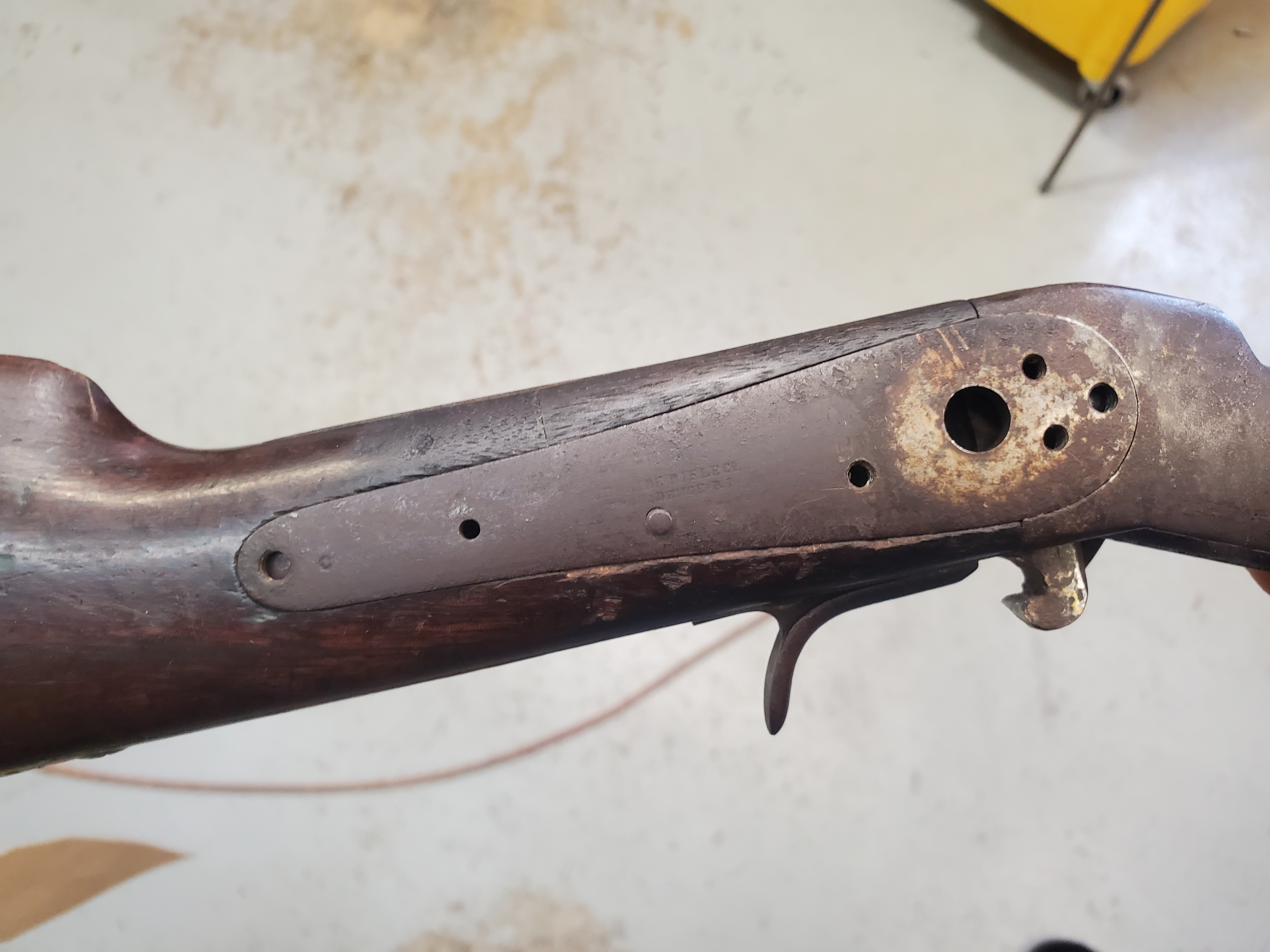

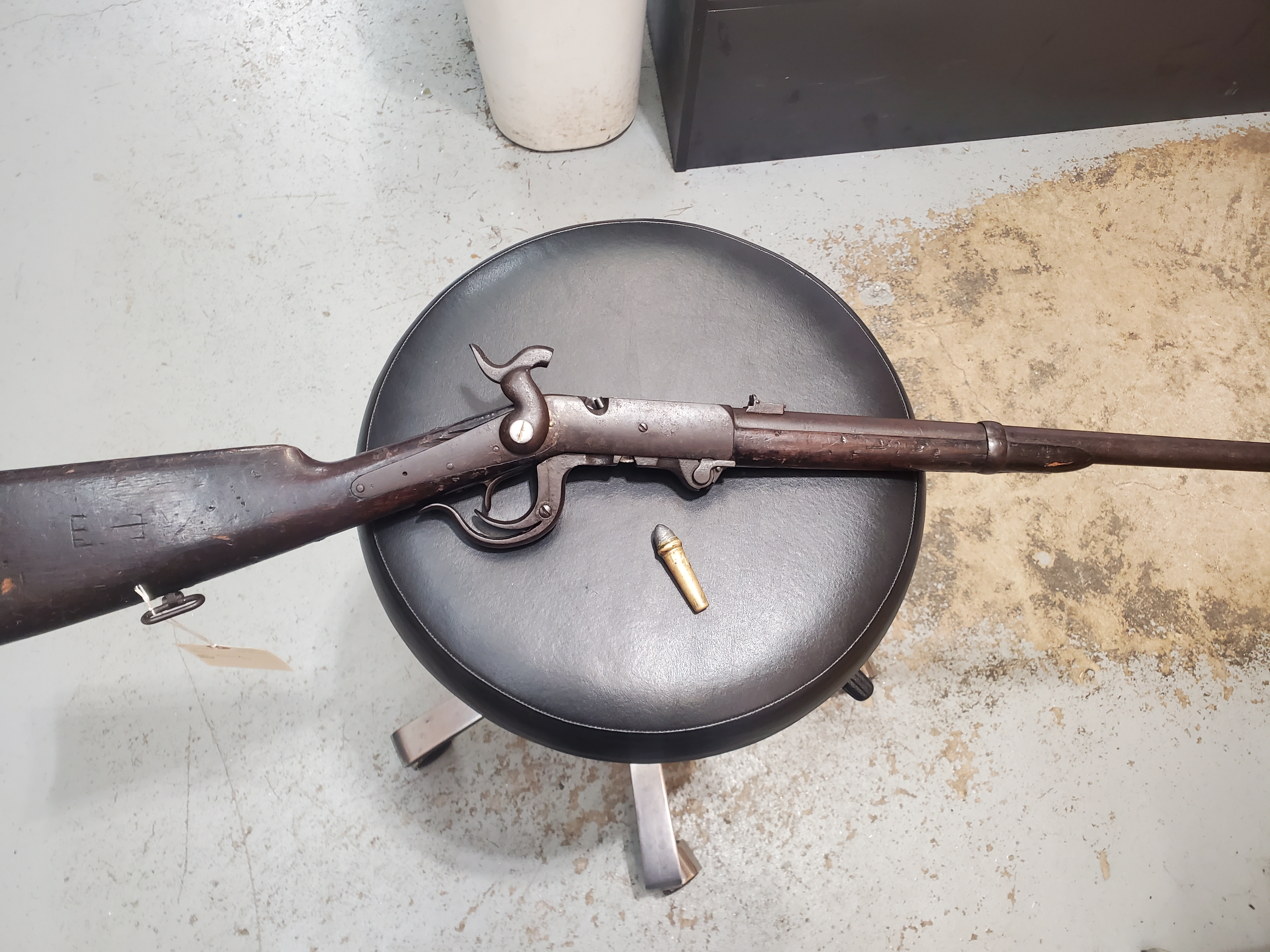

It's not everyday that a customer brings in the predecessor to the modern breech loading cartridge ammunition. He bought it for $200 from a pawnshop. I'm not sure where he got an original round from but you can see the strange ice cream cone shaped brass.

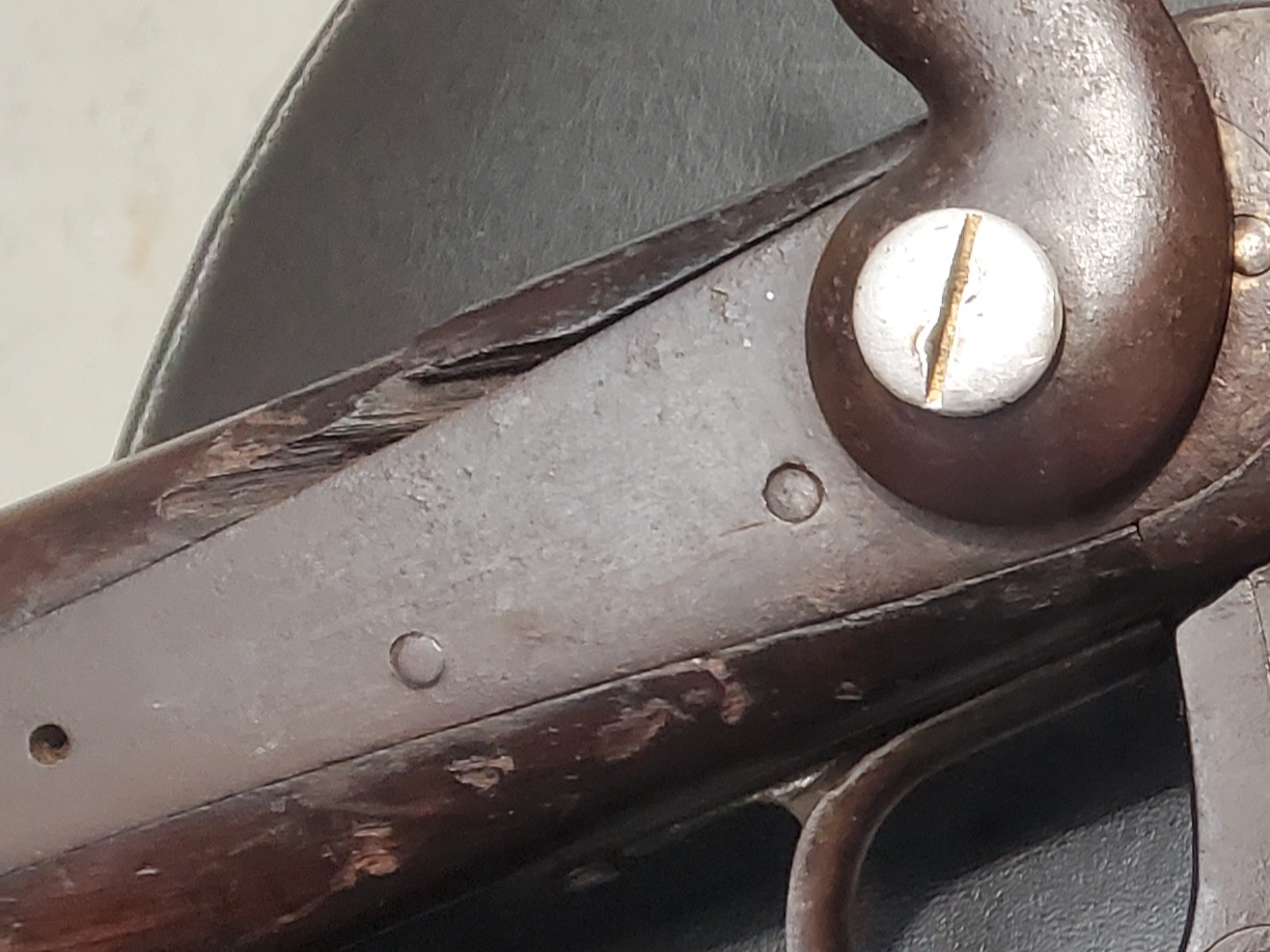

It was missing a mainspring and the hammer stirrup, along with having the stock broken right above the lock. Looking online, nobody makes an aftermarket main spring for these but I found that a Sharps spring is pretty close so I ordered one and adapted it to work after making a new stirrup.

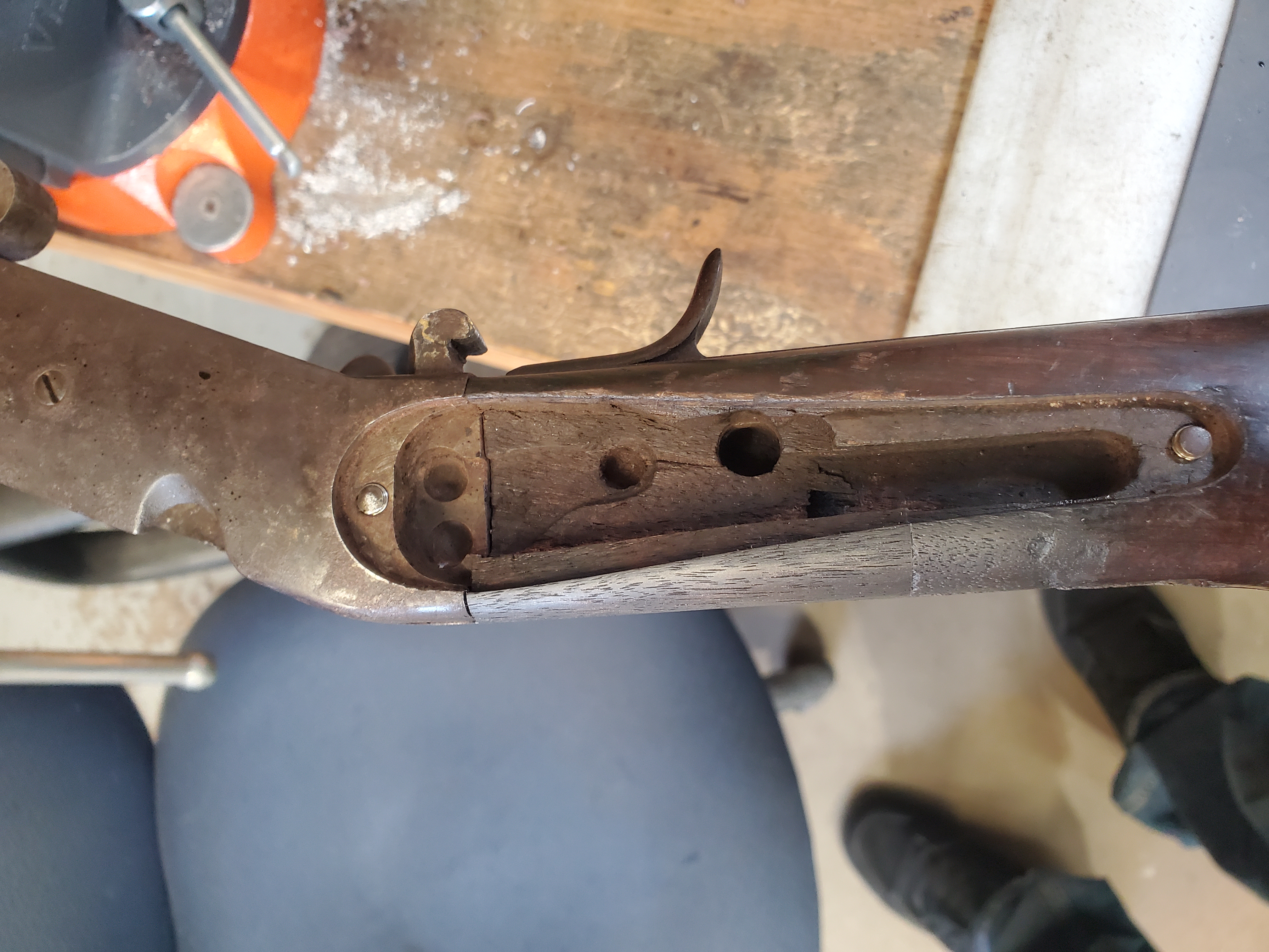

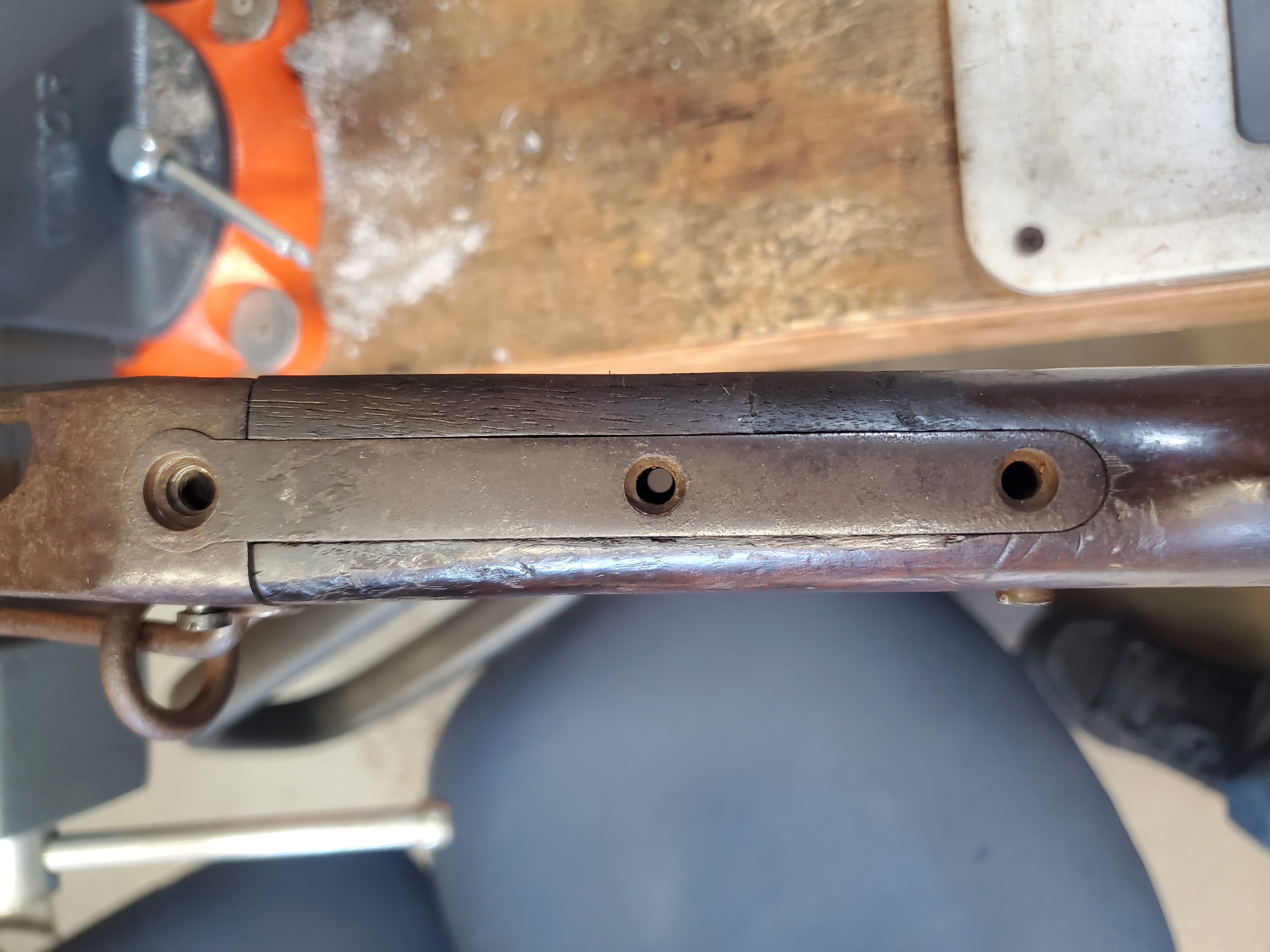

Then I patched in a piece of walnut and spent some time with a chisel and got a perfect fit. The only evidence of the patch is the seam line but it matches pretty well. I also put in a period correct looking hammer screw and got rid of that aluminum abomination that was in it. He was pretty happy when he picked it up. I also made him 5 rounds after finding the brass online for $9 a piece and a member of a muzzleloading forum that I belong to was kind enough to send me 5 lead cast bullets for it so it was easy to fill the cases with some FF powder and seat the bullets.

So to load it, do you push the cartridge rear ward into a breach chamber?
Posts: 1310
Re: 54 Burnside
PFD45 wrote: Fri Sep 27, 2024 1:19 am So to load it, do you push the cartridge rear ward into a breach chamber?
It has a tilt out breech block that accepts the round and then locks back into place. It's a pretty ingenious design to be honest.

Played with Maynards, paper cartridge Sharps, and the French Chassepot needle rifle - - haven't fiddled with a Burnside yet, but that's one of the more unique solutions to headspacing you're going to find. Cool era to study, this Period of Prototypes.
