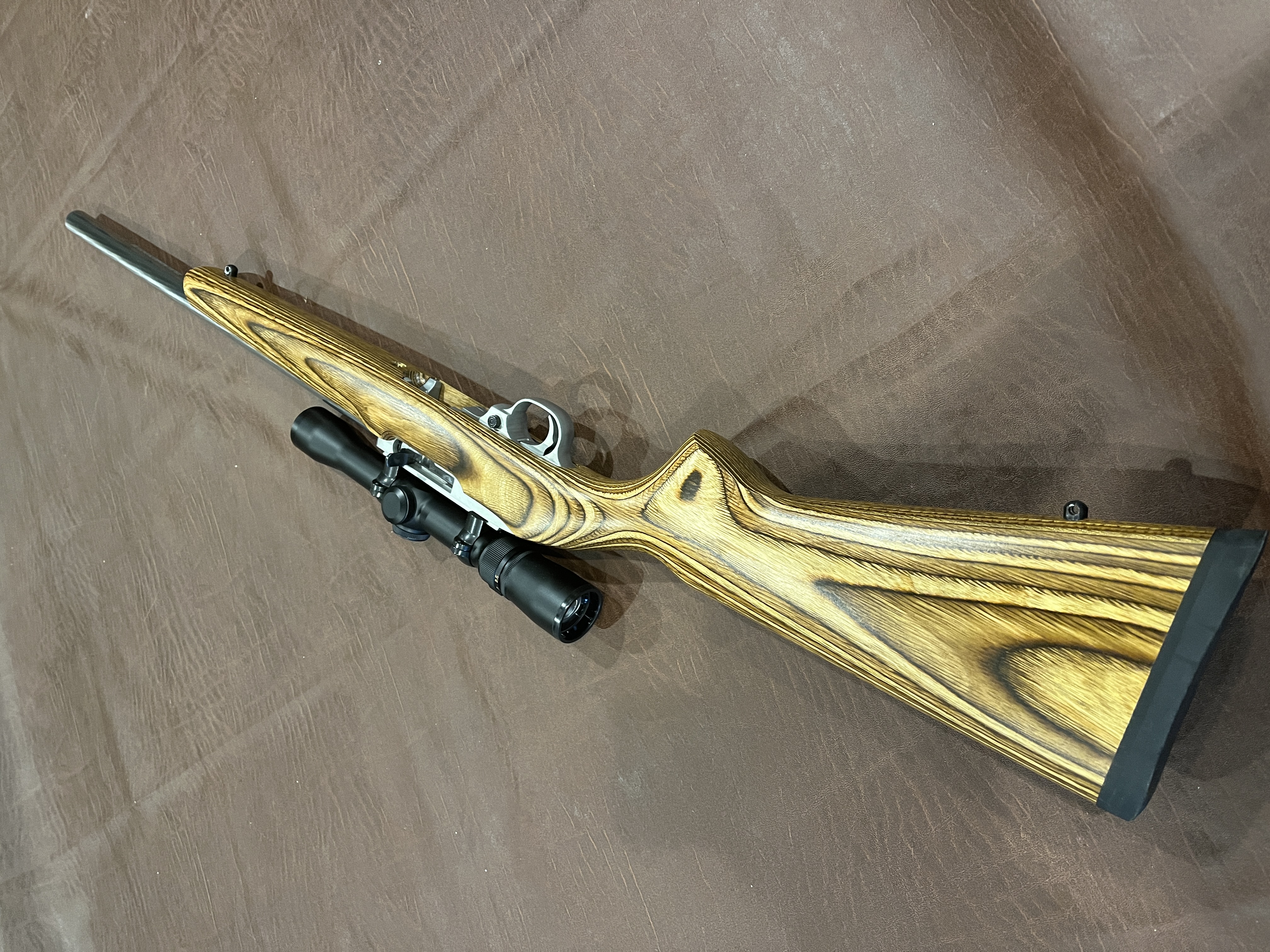

I've got a 10/22 Target model that I've never really found great accuracy in. It's been in timeout for a while as other projects take precedence.

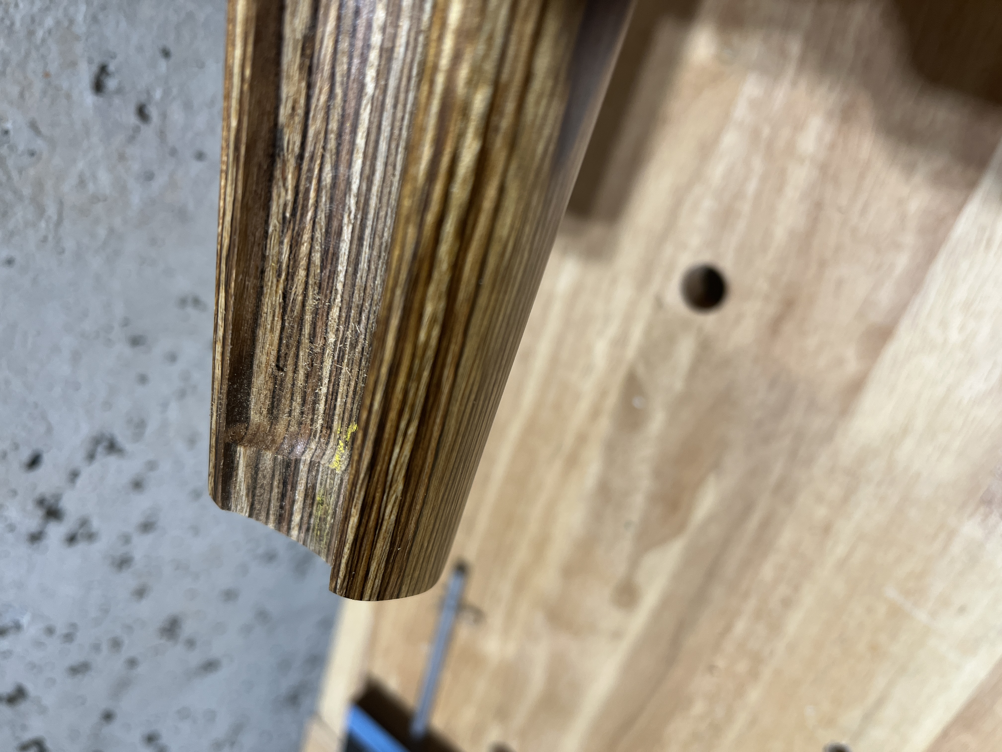

The barrel isn't even close to free floated. I don't know why, but Ruger found it necessary to leave a "groove" of stock up from with the obvious intention of supporting the barrel (see pics). It's even got some half ass looking adhesive in that area.
I know I can take the Dremel to it and achieve free floating, but a better stock altogether might be the preferred route as the factory stock is also pretty tight all down the sides of the barrel.
So, any recommendations? Magpul Hunter? Maybe one of these:
https://kineticresearchgroup.com/produc ... s-rimfire/

Considering that they're hanging a Dana 44 axle off an aluminum receiver originally designed for a lightweight pencil barrel, I would NOT be inclined to free float it.
I would stick with that nice rigid laminate stock, free float all but the last two inches, and shore up or outright replace that front saddle with bedding compound in that last two inches of stock.
I've never bedded a 10/22 action - just looking a photos right now, I'd have to scratch my head about this next bit, but I'd probably also want to figure out how to bed up the rear couple inches of barrel, recoil lug area, and maybe the receiver tang. The ultimate goal is to form a rock solid union that allows ZERO positional shifting between the barrel and your optic.
Another option would be to bed the front of the stock as above with pliable RTV gasket sealer, and bed the stern as above with the harder stuff. I've gotten good mileage on the RTV stuff as a vibration damper between lever action's barrels and mag tubes, and forend bedding on 2-piece stocks.
Easiest way to test if the concept has any merit is to shim the forend tip with business card stock & see what happens.
