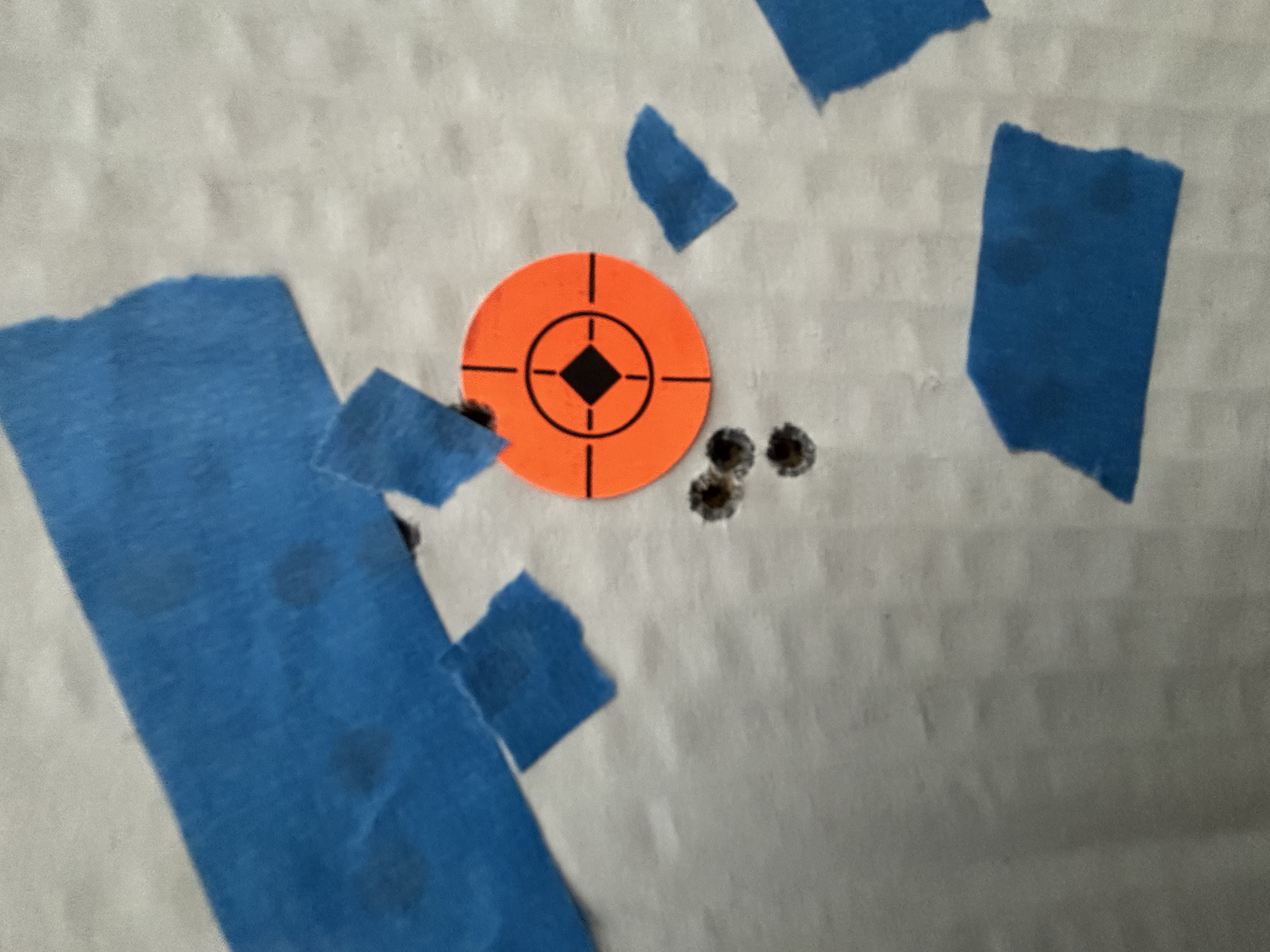

I have a 50 yard range in the dry tank/pond just outside my shop door. First round out of it, brand new, was 1” left and a touch high. After adjusting the scope the wrong way, then coming back, I shot a 3 round group. Well under 1/2” at 50 yards. Made one last adjustment, and it’s done..

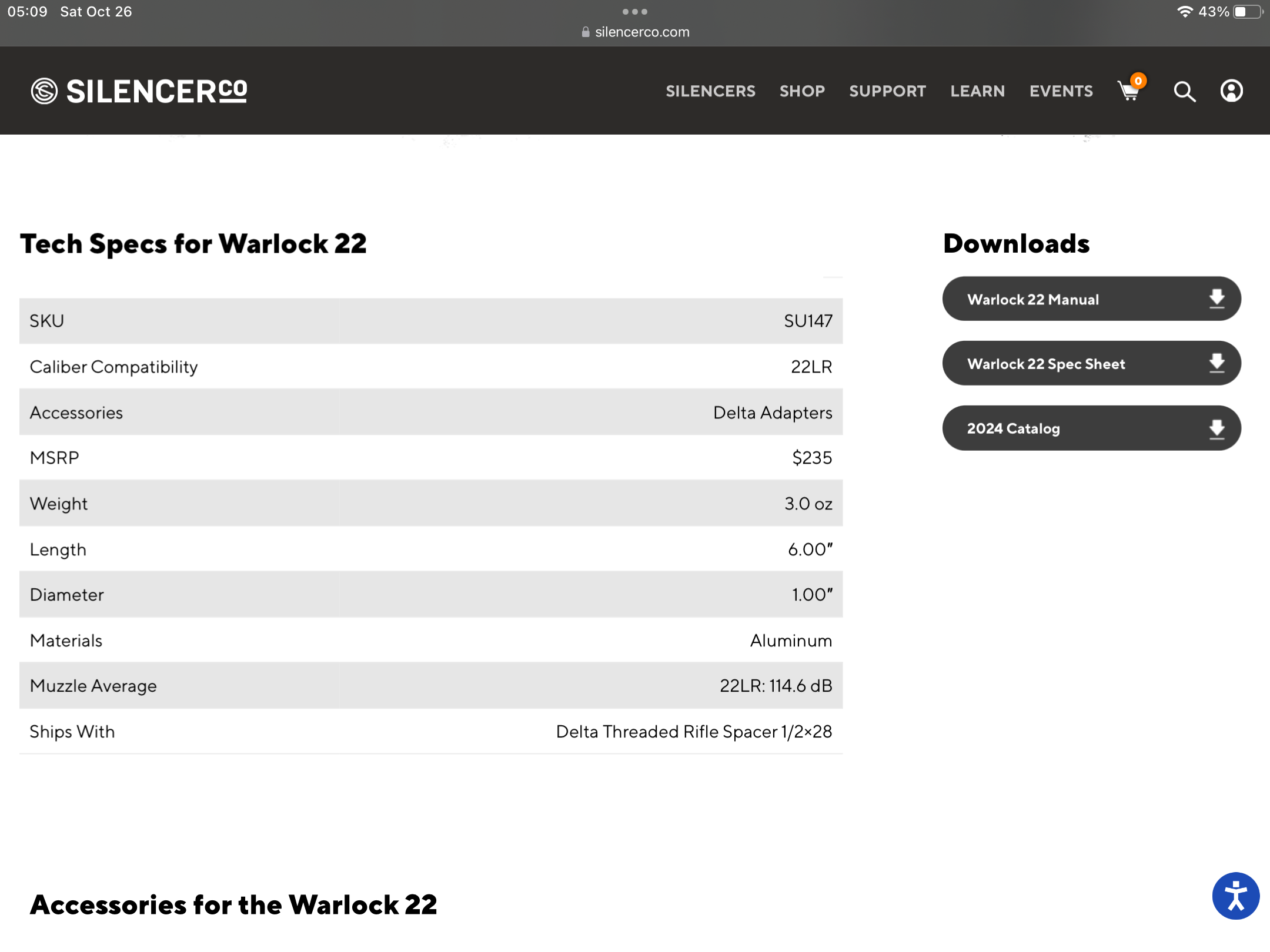

That looks really slick. Your suppressor only weighs in at 3 ounces?

Justsomedude wrote: Fri Oct 25, 2024 10:14 pm That looks really slick. Your suppressor only weighs in at 3 ounces?
Thanks.
And yes. 3 ounces. The down side is, it’s not magnum or 17HMR rated. So I’ll probably have to get another rimfire suppressor. :D

Jay wrote: Sat Oct 26, 2024 11:10 am
Thanks.
Your Warlock is 0.4" longer and 0.5oz lighter than my CGS Hydra-AL
https://www.silencershop.com/cgs-hydra-al.html
