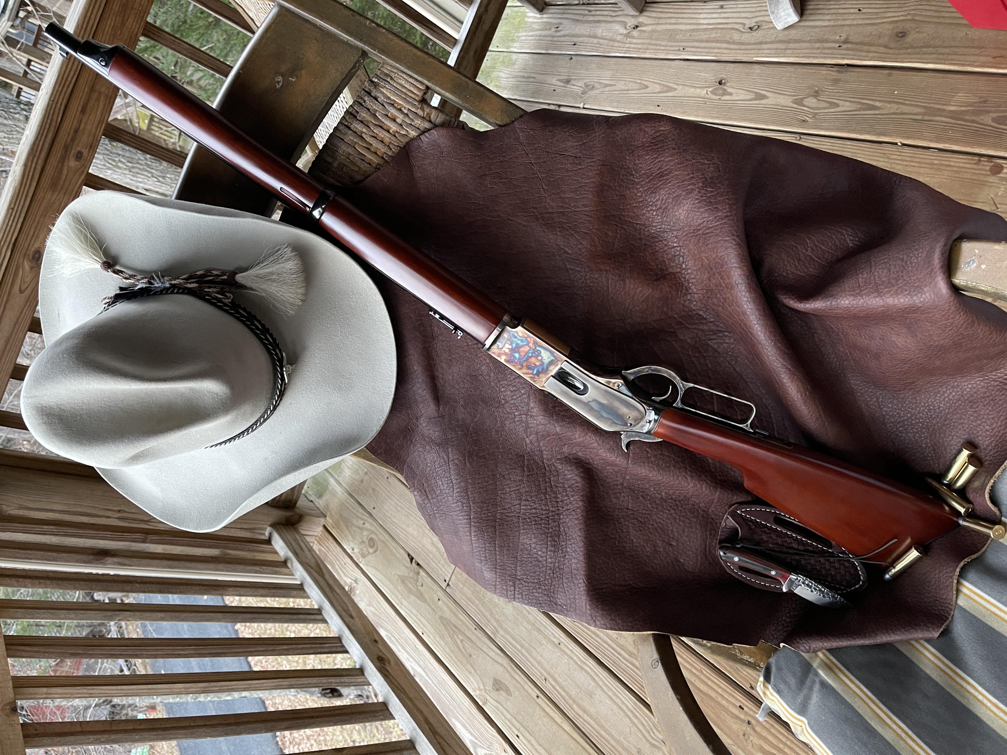

This one is a truly niche topic. I’m thinking about developing a 405 JSP load for the 45-60. The old Winchester 1876 rifles couldn’t handle it but the new Uberti’s should have no pressure issues. I’m already shooting 350gr loads comfortably so I don’t know that another 55 grains would be an issue. I think I can get the OAL work even though the 350s are already at max length. Just kind of thinking I’d like a real 45-70 load out of my gun. Thoughts?

PFD45 wrote: Tue Oct 29, 2024 8:30 pm Sounds like a REAL good reason to look for a .45-70. :lol:
Oh I already have my bucket list 45/70. 😎
I just want a vintage lever action option and I keep thinking that an 1886 would be nice BUT I LOVE my Centennial 1876 musket and I don’t know that I’d ever take an 1886 off the rack if the 1876 is there wanting to get out…
Besides I have the hat to match it 🤠
