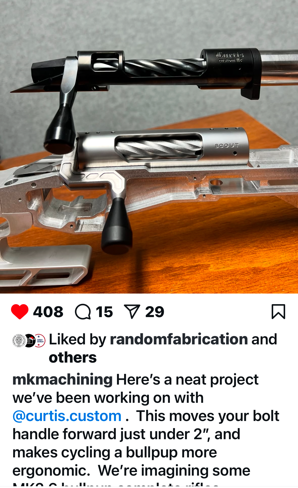

breamfisher wrote: ↑Mon Dec 23, 2024 2:27 am I'm wondering if a bullpup bol5 action will be a little... awkward to manipulate.
Beyond awkward.
There is a soloution I saw, lemme see if I can find.

Re: an idea for a new woods gun
Posted: Mon Dec 23, 2024 9:53 am
by mitdr774
Looks like an exaggerated Remington 600 bolt design.

I really appreciate the input and ideas. The 1500 with a 20"barrel weighs 3.9 lbs meaning if you can find a bullpup stock you will be at 6 lbs before a scope. The current project as it stands should be about 4.25 Lbs.
I really like the bolt idea! Since the BCA bolt handle is screwed to the bolt having an off set bolt milled wouldn't be out of the question!

Freezer, your statement about me and whose belief is, "If it's not an AR, it's antiquated.". Is simply not true, I have a Remington 700 action in 6.5 creed. I just prefer the ergonomic of newer designs. Some people think the Steyr AUG is antiquated, but that is my first love.
Do to my love of bullpups, I made a 6.5 Grendel bolt action built on the AR-15 lower. Which allows me to hunt with in Pa. On my current build and the new ones we are working on, the bolt handle is forward compared to a traditional style . The action can be worked easily without having to move your head.
