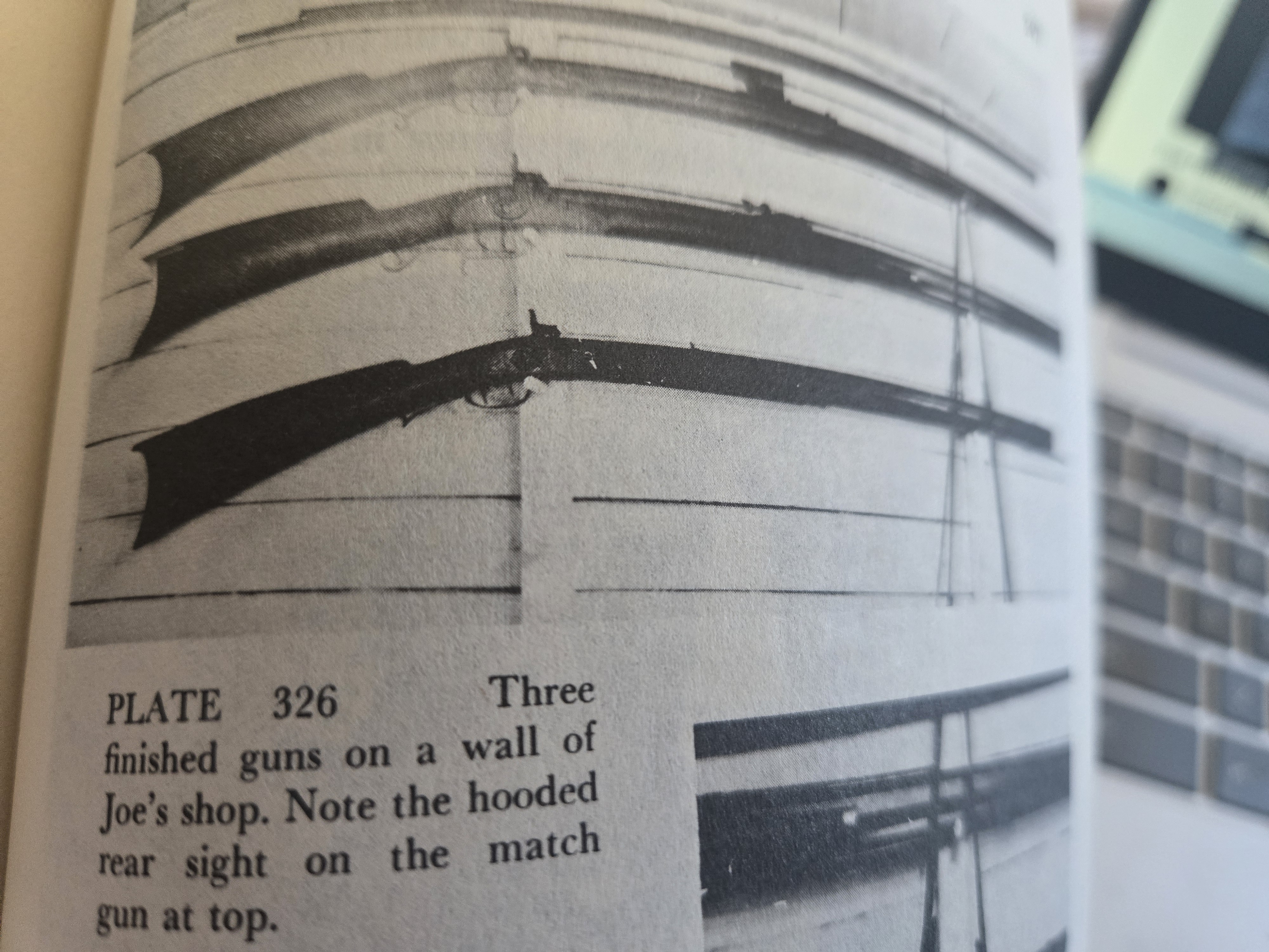

I've been ordered by my doctor to keep my foot elevated and iced for three weeks. I've been in my recliner for a week and a half and another week and a half to go. I have a 15 book set of Foxfire, a series on Appalachian Folklore. These books inspired me to make the two banjos and scalper knife I posted a few years ago. Well, I'm in volume 5 and there's a long portion on gunsmithing and building ML rifles and what do I see?
If it's redneck, it's been done!
