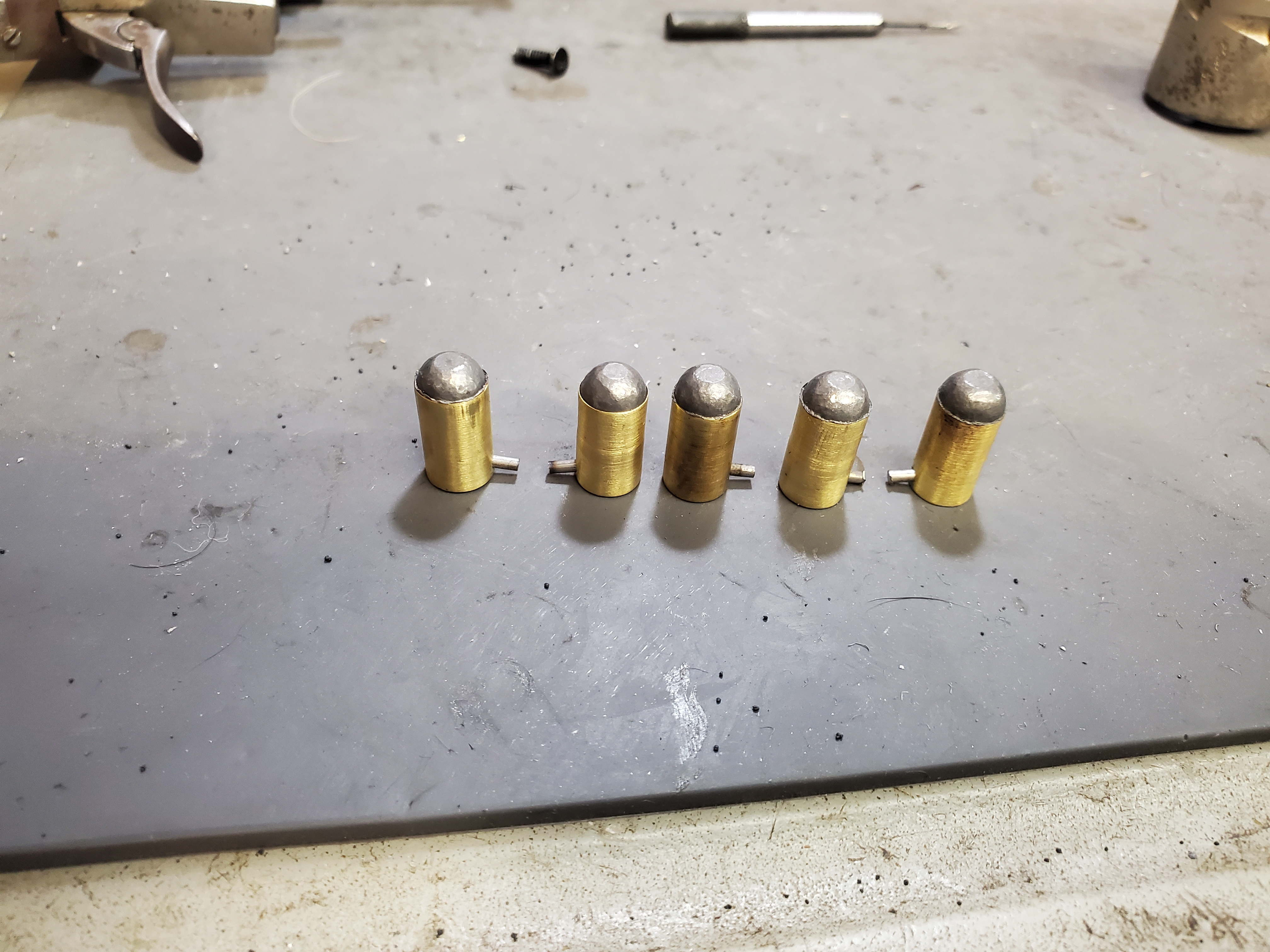

Some of you may remember the 7mm pinfire I made a post about a couple of months ago. I bought it from gunbroker for pretty cheap and it was in fair condition except for the bore and other cosmetics so it was a good candidate to modify.
I decided to turn it into a 32 caliber because of the limitations in the bore diameter and cylinder wall thickness. I had previously reamed the barrel out to the land diameter of 32 caliber and then pressed a 32 rifling button through it and ended up with this. Not perfect, but usable.
Today I started back on it by reaming the cylinder bores to .310 and then figuring the length of my brass and reaming the chambers to a thou over the brass diameter. Thankfully I have a bunch of 32acp so I used those to make my brass. Pulled the bullets, dumped powder and removed primers and then faced the rims off in my collet chuck in the lathe. I just soft soldered all of the flash holes closed and refaced them again afterwards. So then I drilled the holes for the pins which I made out of music wire and stuck them into some of my homemade percussion caps that were placed inside the brass. Filled them with 777 powder and used the vice to seat some 50 grain. 310 round balls. They look mostly legit
I was surprised at the first one I fired because I was expecting little to no recoil but it had more than a 22lr so I fired the next one through my chrono and got 696 fps. Thatll do! A bit surprising based off of how small they are with such a little powder charge which I didn't weigh but it's as much as a 32acp can hold. I posted a YouTube short of the test fire. Don't mind my confused rambling in the video because I got minimal sleep last night and it's been a long day.

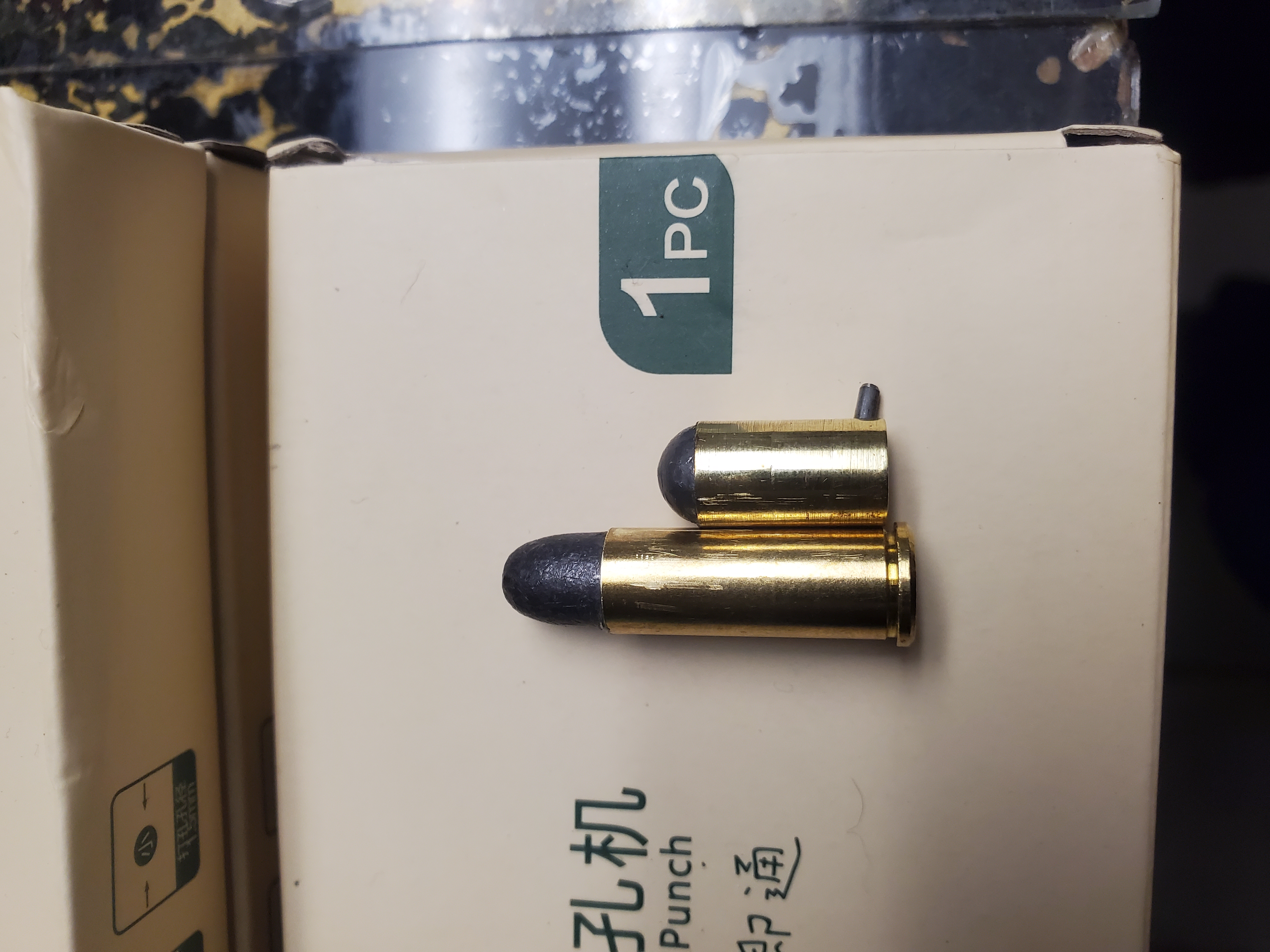

I realized that I could be using bigger and better brass. It'll hold as much powder as I can get in my 1849 pocket revolver and I've gotten 1000 fps using 777 in it.
