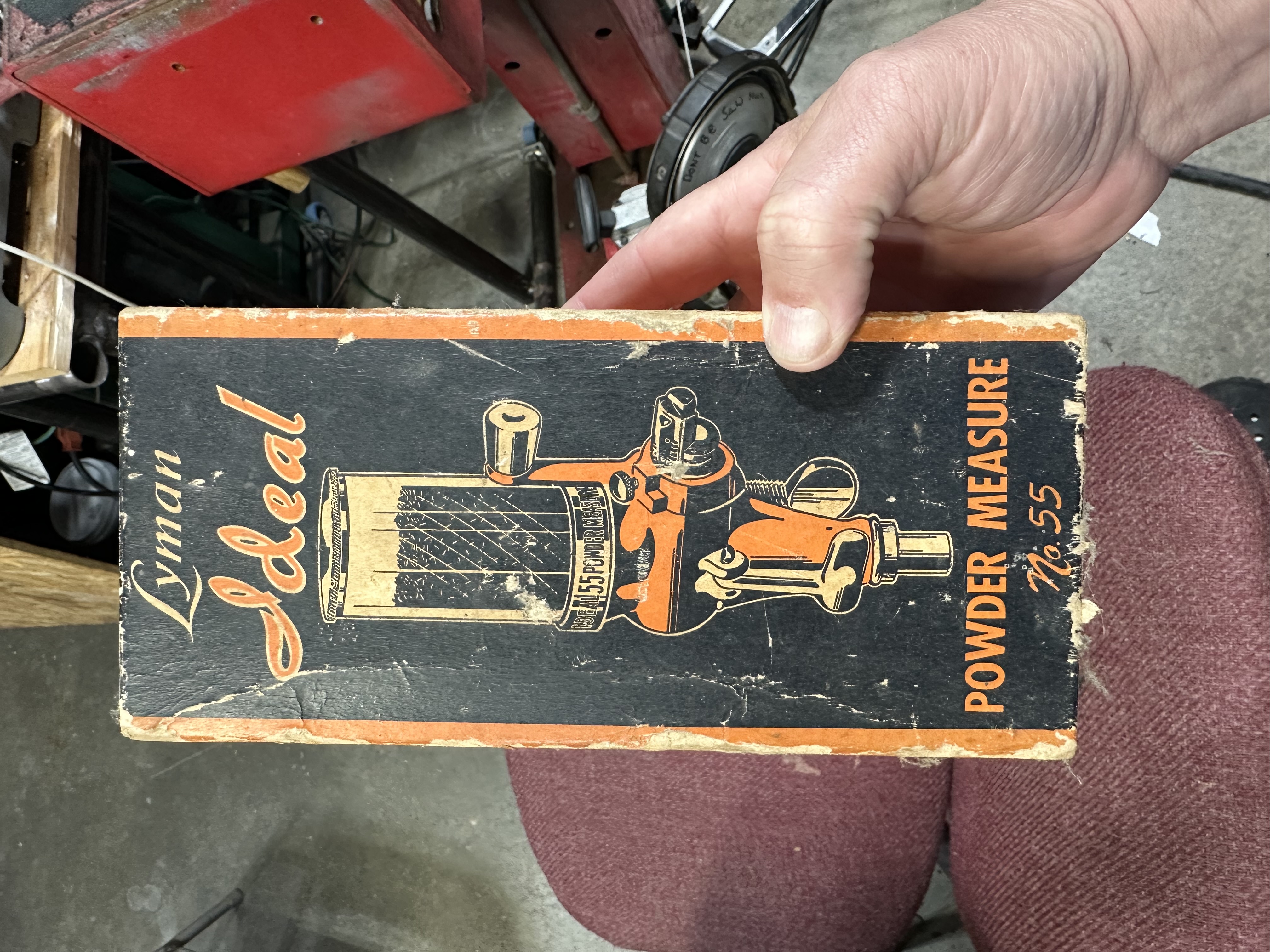

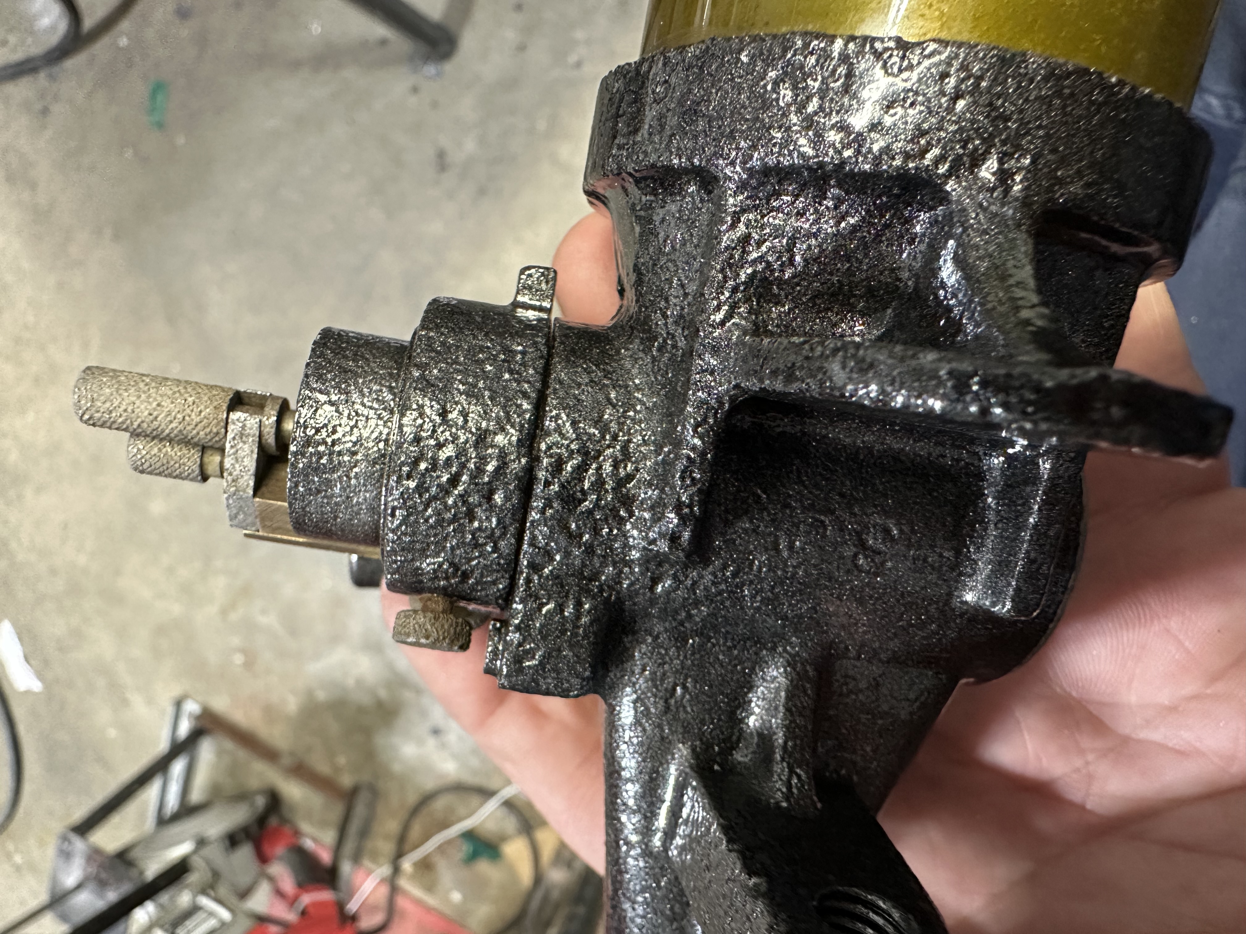

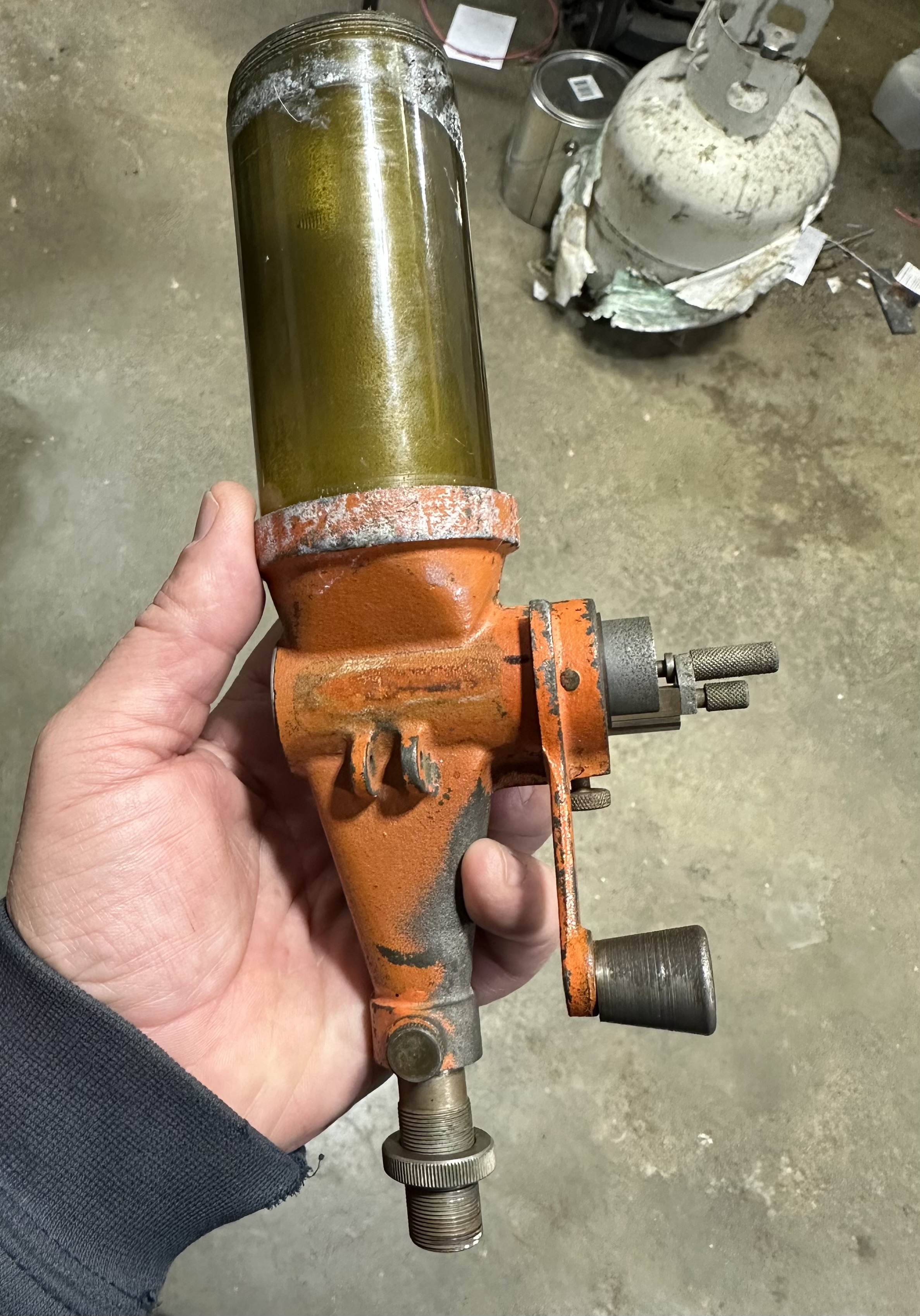

Few years back I was given an old Lyman powder measure. Original box, not abused but kind of icky. Mice had made a home in the box, and pissed all over it. Time and piss caused rust, pitting, etc.

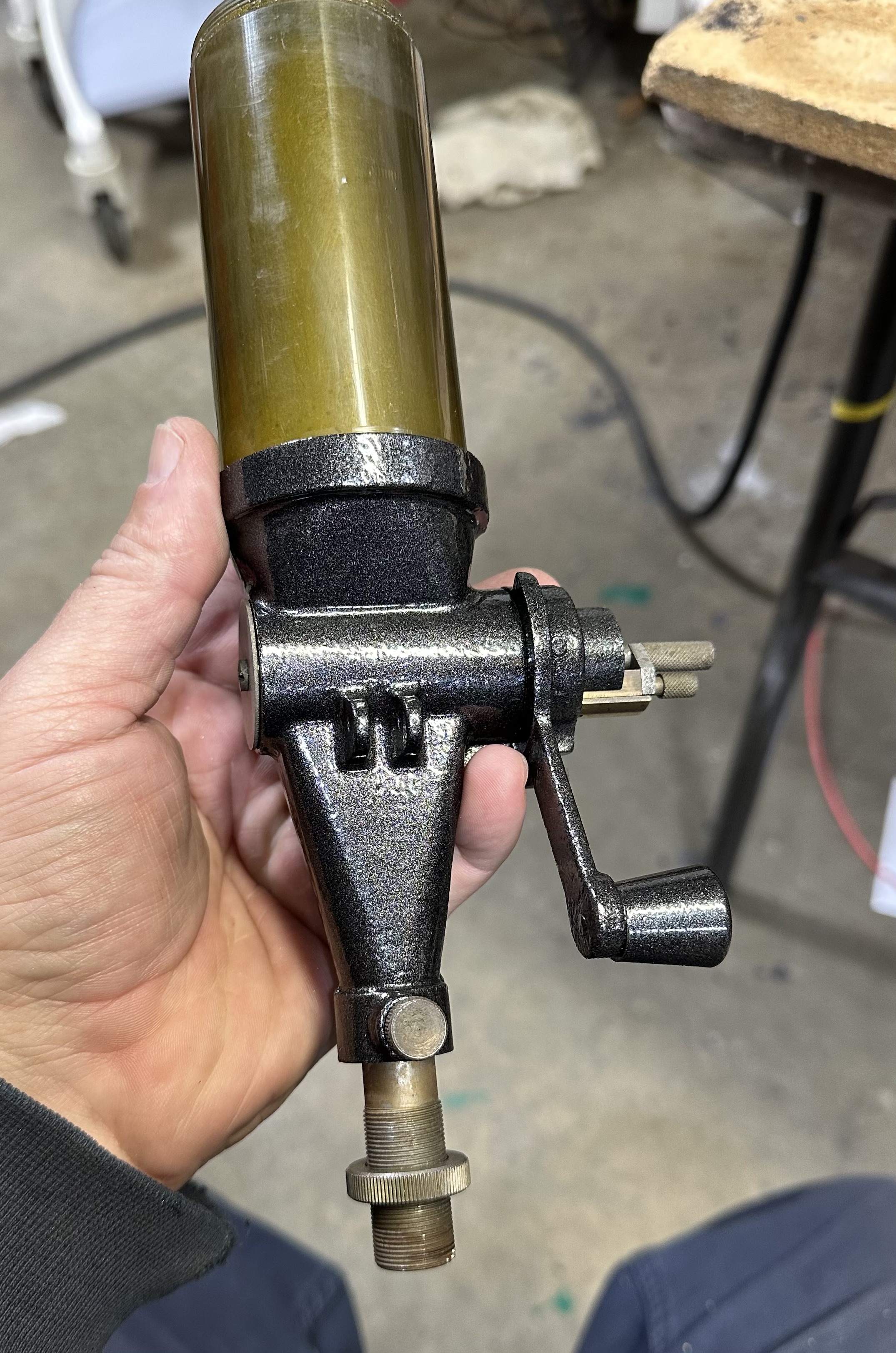

I cleaned it up with the intention of repainting, and making it automatic, but didn’t do either. Last night I bead blasted it and threw on some powder coat. Which is so much better than paint.
Turned out pretty decent. I laid the PC on thick, to try and hide the putting. It worked well on the not so bad parts, and is certainly better than it was before on the really pitted parts.
It works well, and drops H110 within a tenth of a grain. The hopper is kinda jacked, I flipped it from the threaded end to the plain end and “threaded” it by forcing it into the measures threads. It’s assembled, so, I’m not pushing it. Worst case I 3D print a new one. Or machine one.
I MAY carry on with making it automatic, maybe not. Plan was to hold an empty case up to it, and it would operate itself. Why? Because I can.

Nice job on the PC.

PFD45 wrote: Sun Jan 19, 2025 6:51 pm Nice job on the PC.
Thanks. It’s easy, as long as you follow the rules.
1. Good surface prep. Aka sandblasting.
2. Wipe with acetone.
That’s really it. The process kind of does it on its own.
The other rule is don’t bump the parts placing them in the oven. There’s ZERO touching allowed. No matter how light you THINK you can touch it, you can’t. Period. Point blank. End of story. You’ll wipe the powder right off.
Now, the nice thing is you can *maybe get away with just spraying more powder over the blemish before baking. (I got away with it. 😬)
Worst case you blow it off with the air hose and start over.

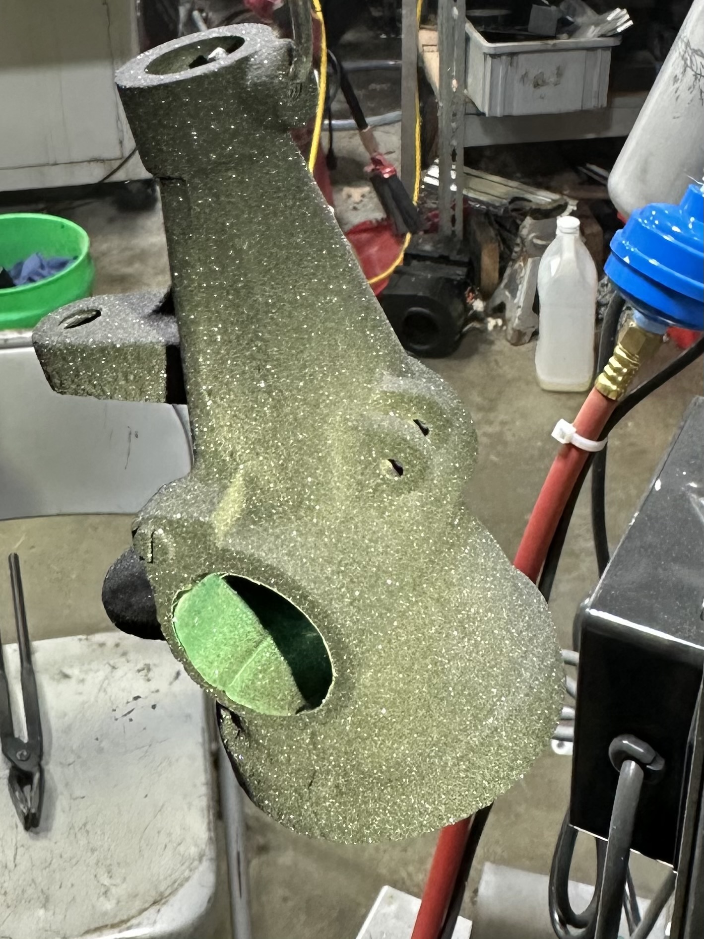

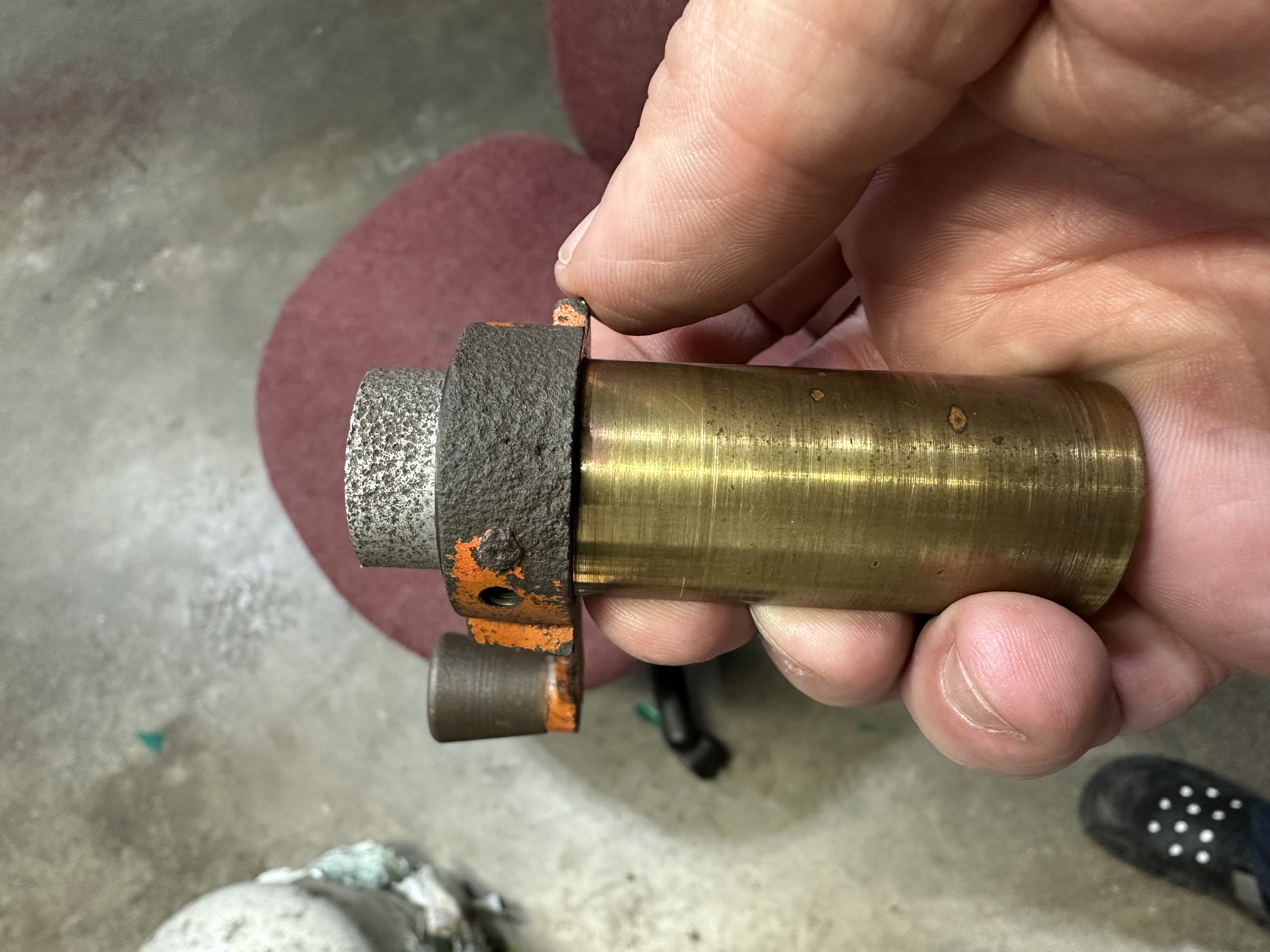

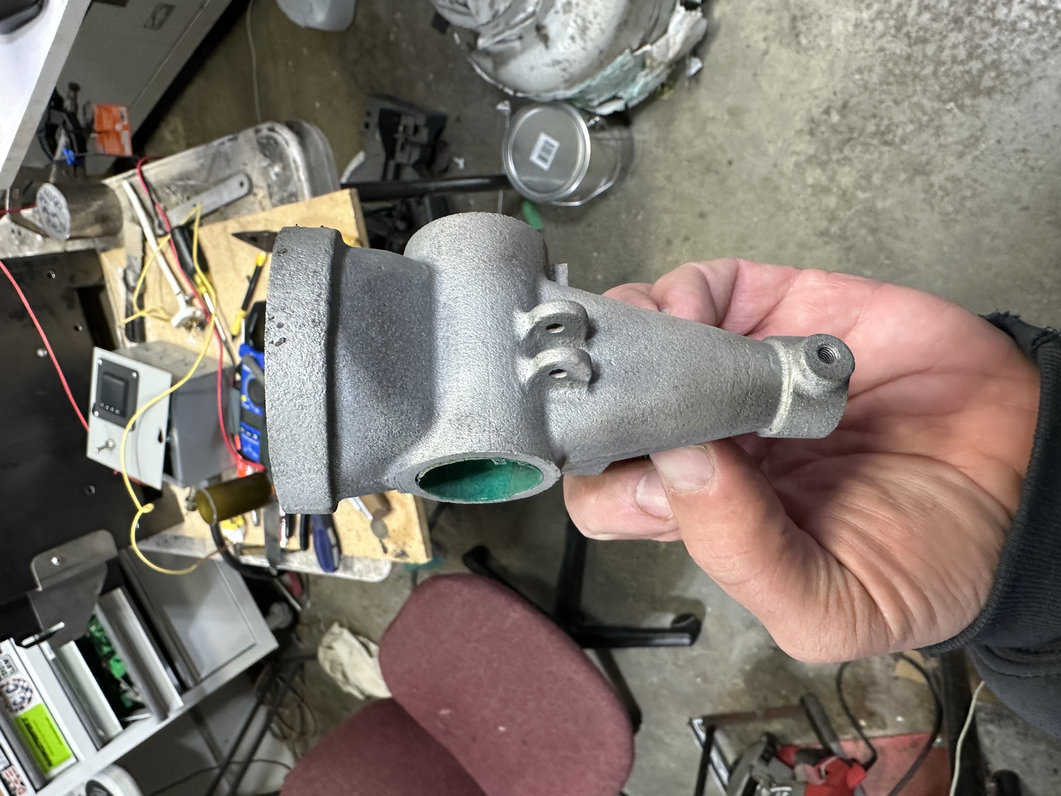

Pics of it blasted and with the uncured powder. The tape is there to keep powder from going where it shouldn’t. It’s specifically designed for this purpose, doesn’t leave any residue after baking.

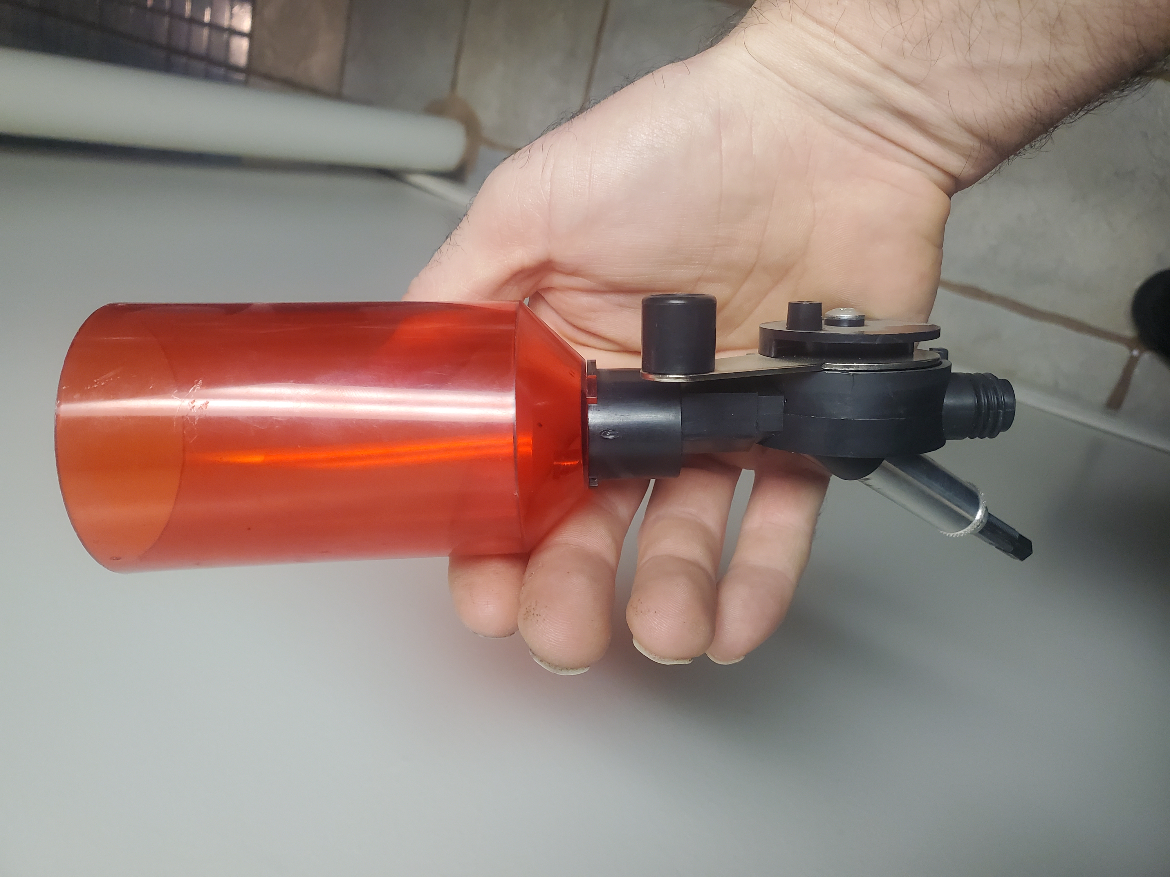

Ironically I found this thing last night. Didn't even know I had it. Not sure who it's made by but I'm going to test its accuracy later today.
Posts: 772
Re: Powder measure spruce up.
Lee Perfect Powder Measure.
Sucks with ball powder like H110. It either binds or leaks.
Lyman is better.

Justsomedude wrote: Sun Jan 19, 2025 7:53 pm That turned out nice. My brother got me hip to powder coat and how durable it is. He does it alot and has a whole setup but won't take the jump to open a business doing it for people 🤷‍♂️.
I *had* one of those.
I smashed it with a hammer so that I wouldn’t be tempted to use it again, and that another innocent person wouldn’t have to deal with it.

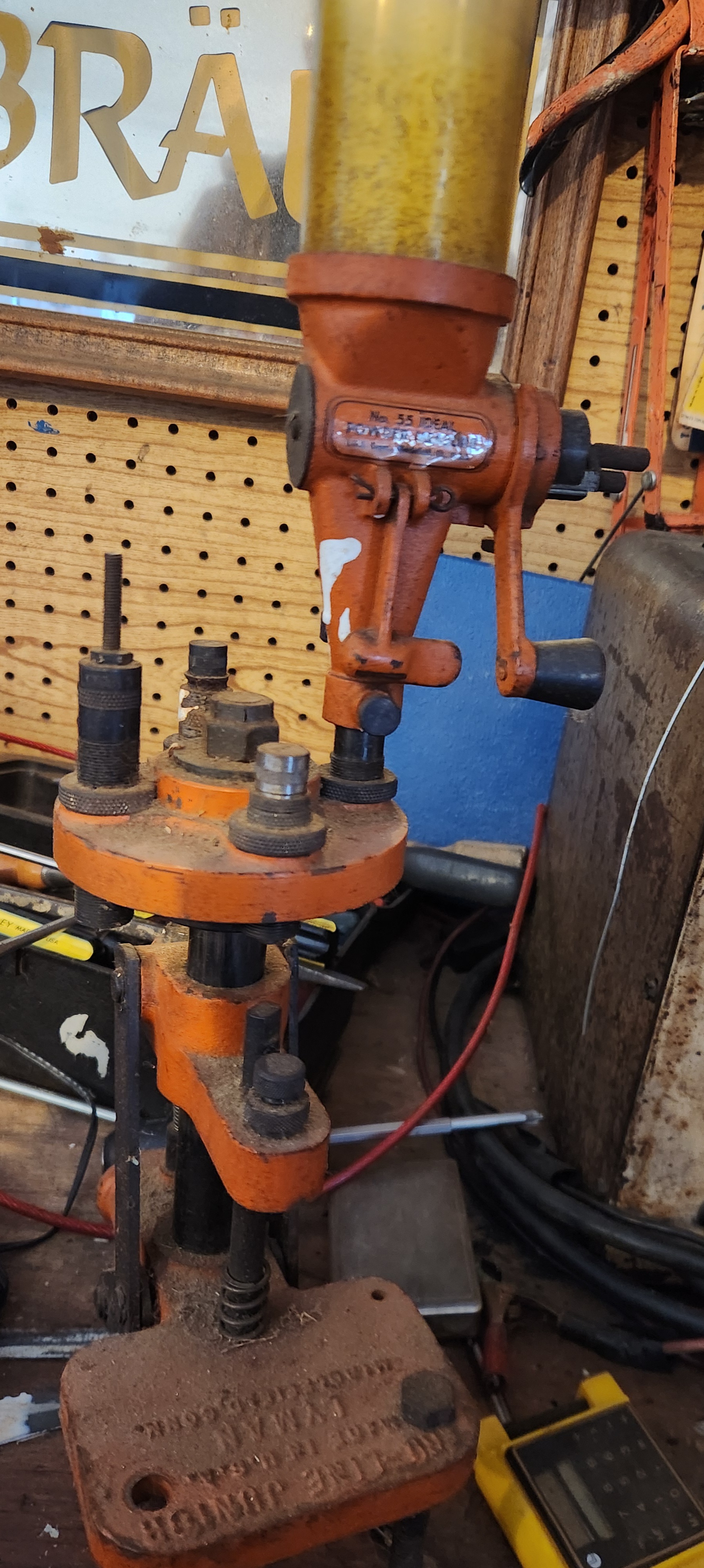

I’ve got the hammer dingus. I took it off because I was offended at the horrible way it was attached. And, other measures don’t use one, and they work fine. So does this one. It meets the accuracy of my scale, so I can’t prove one way or the other if it helps. If I ever get a scale with better resolution, I’ll for sure try it. If I end up automating it, I’ll add a vibrating dingus to it to perform the same function.

CPJ 2.0 wrote: Sun Jan 19, 2025 6:41 pm

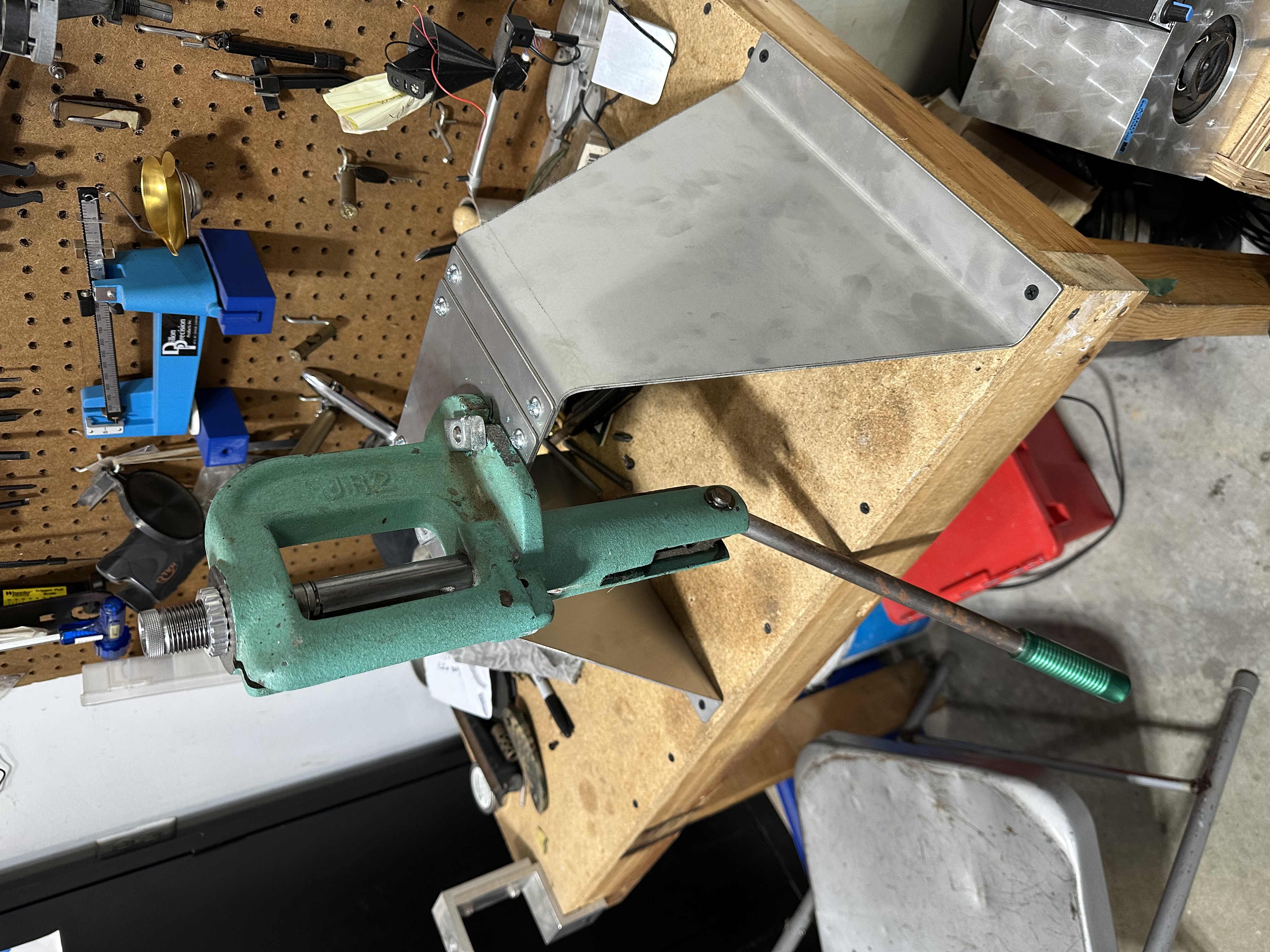

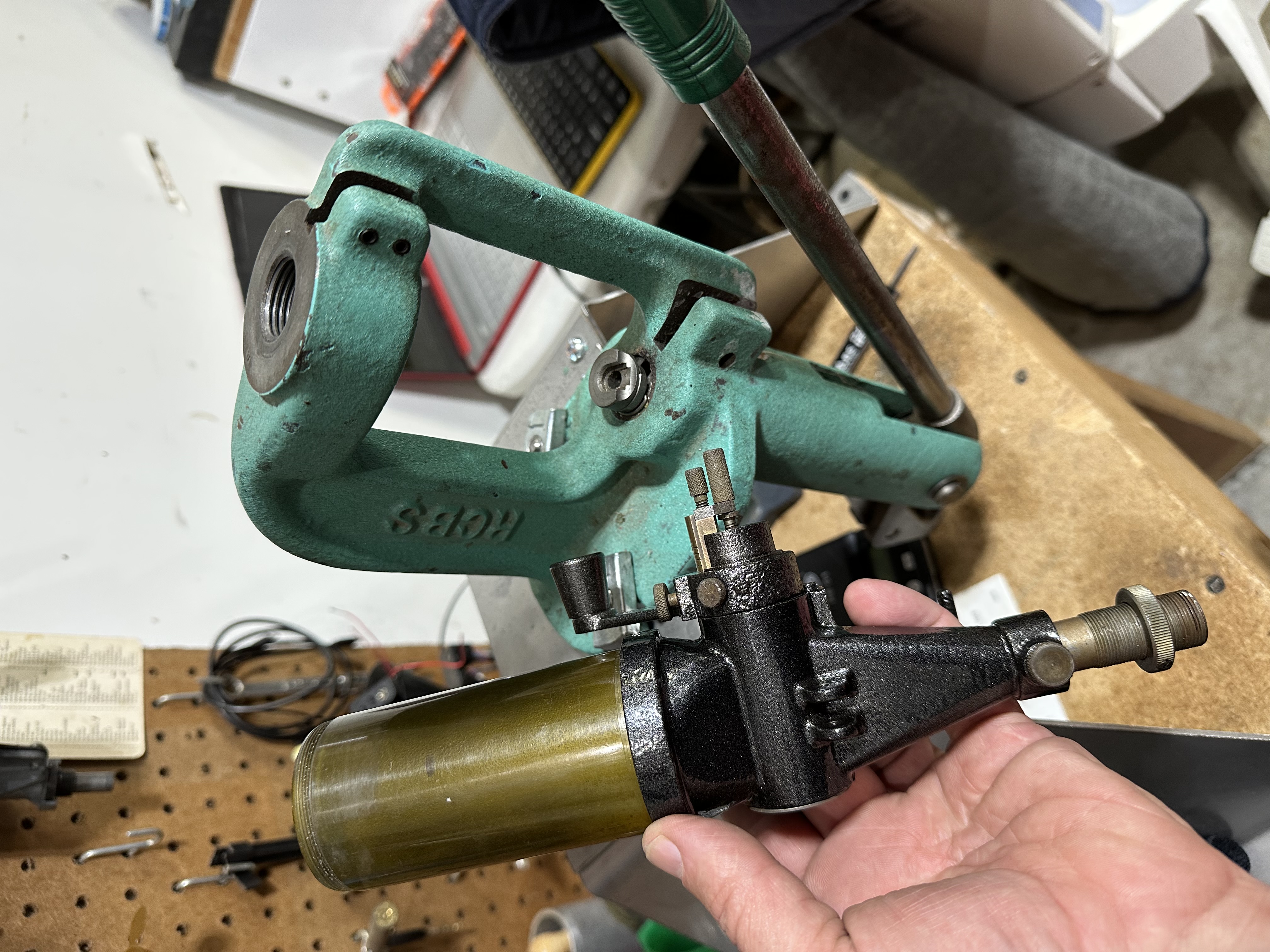

Off topic here, I notice that your press is mounted on a stand. Did you fabricate it? Is there any flex? The press is a JR? I have one also but went with the Rockchucker when I started forming cases. The extra leverage made doing that easier.
I wanted to try elevating my press but haven't gone there yet.
Posts: 3925
jwv2023 wrote: Mon Jan 20, 2025 4:26 am Off topic here, I notice that your press is mounted on a stand. Did you fabricate it? Is there any flex? The press is a JR? I have one also but went with the Rockchucker when I started forming cases. The extra leverage made doing that easier.
1. Yes.
2. Yes.
3. Yes.
It’s better elevated than not, but I need to add a brace or two because it flexes more than I like.
They sell them, but I have pretend design skills and know a guy with access to metal, a waterjet, and press brake.
