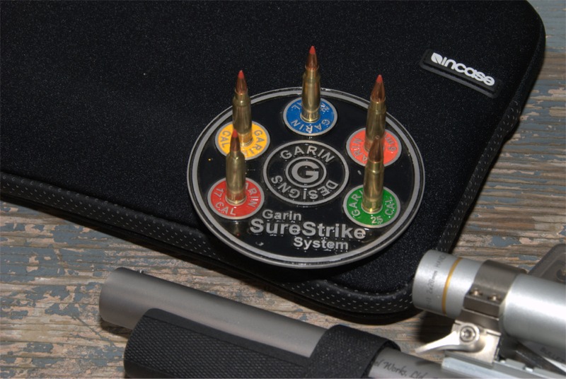

I just looked up Starline brass. They have 32-20 brass, but there is a caveat "*The SAAMI spec for .25-20 & .218 Bee is smaller at the base than the .32-20 which can cause clearance issues on some rifles."
I just searched the net for an acquaintance of mine that was manufacturing a line of cartridges based on the 30 carbine case. His line started at 17 cal. and went up to 25 cal. The last few times I saw him, he was in declining health, so he probably closed up shop. He marketed dies to form and load the cartridges. He thought he had a deal with Hornady to produce his cartridges, but they dropped out at the last minute.
Anyway my point is, if you can form a 30 carbine case from 17 to 25 cal. there should be an easier way to form 32-20 to 25-20. edited to add another link http://www.surestrikesystem.com/docs/Ga ... orming.pdf
Google Garin surestrike
