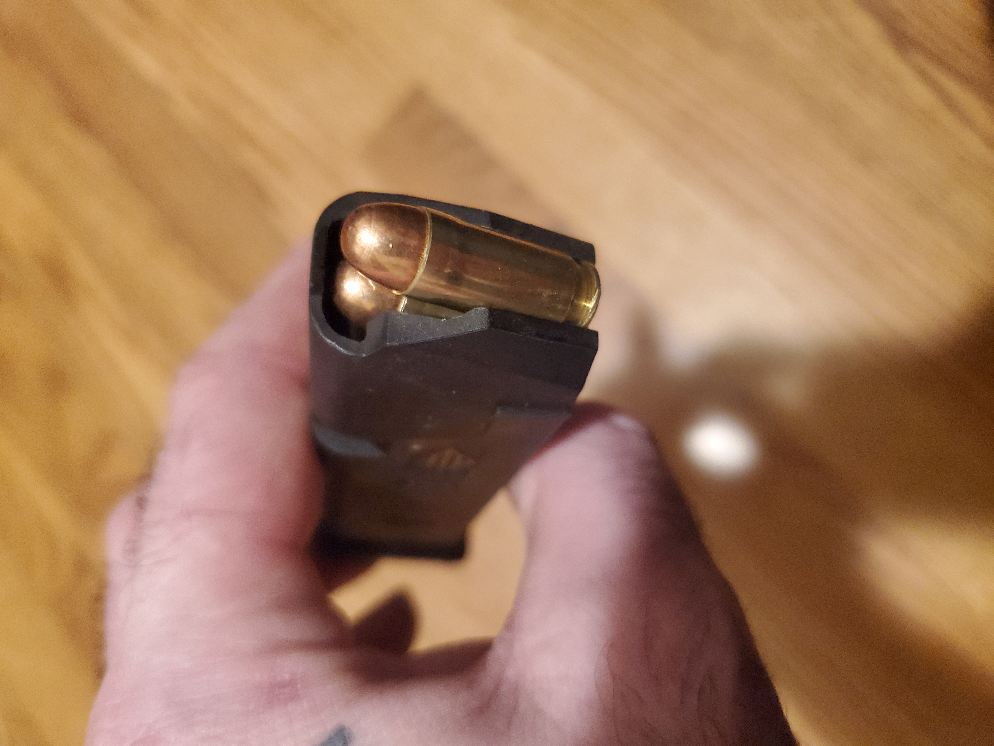

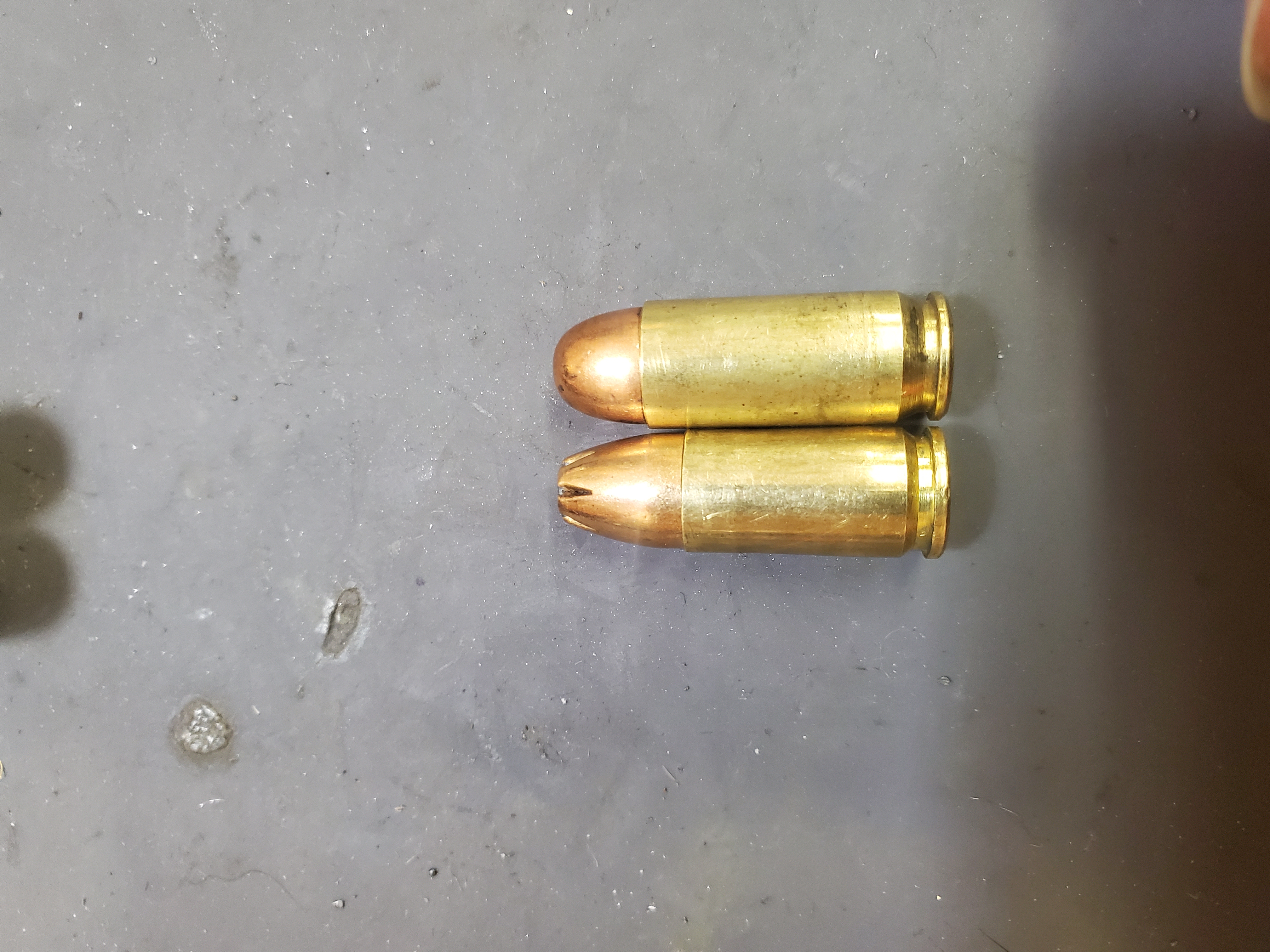

I made a wildcat.
Posts: 1340
I made a wildcat.
For my glock. Took 350 legend brass and cut it to 22mm in length. It has a 100 grain bullet in it, because it's what I have but I should be able to load 115 and it still load in glock magazines. It "should" have the performance of a 38 Super and I have a G19 barrel on the way. Although I could use a reamer from a different 9mm, I'm just going to do it in the lathe. The rim diameter is slightly smaller by .009 but it still seems to work against the breech and extractor. I'm just doing it because I'm weird and like one off stuff.

CPJ 2.0 wrote: ↑Fri Feb 28, 2025 2:29 am https://en.wikipedia.org/wiki/.356_TSW
I didnt know that was a thing but at least I have an extra mm in length to be different enough 🤷‍♂️
