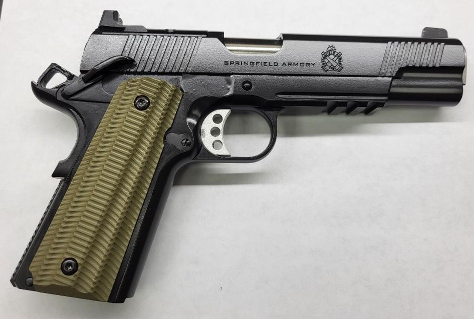

So when Springfield dropped their "AOS Operator", it made me go "Hmmm". Please consider:
SA9X19 4.jpeg (123.62 KiB) Viewed 3041 times
So it's got a light rail on the frame and an optics cut on the slide, but it's otherwise a 1911. . .

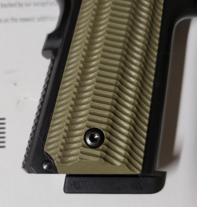

So it's got a pretty nice set of G-10 fiberglass "Alien" grips in "Military Brown" from the factory already:
SA9x19 1.jpeg (70.12 KiB) Viewed 3038 times

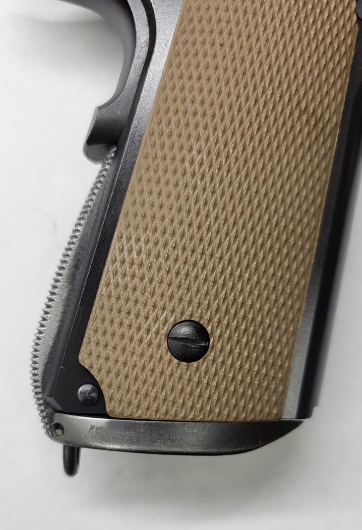

Not traditional enough, and it's got a WW1/1911-spec flat mainspring housing that points the gun low for me. People send their Glocks out to have the "Glock hump" removed; I want it put back on! Except for my actual WW1 Colt, I go to WW2/1911-A1 spec across the board.
SA9X19 6.jpeg (169.22 KiB) Viewed 3038 times
So I ordered up a set of VZ's "Tactical Diamonds" which nicely approximate Uncle Sam's earliest "small diamonds" plastic grips from 1942, made in the narrow window after they went away from wood, but before they started molding "reinforcing rings" around the screw holes. This "Earth Brown" G-10 fiberglass is a little closer to the true military reddish brown. It should darken up as exposed to hand oils and cleaning solvents and turn into a pretty good match.

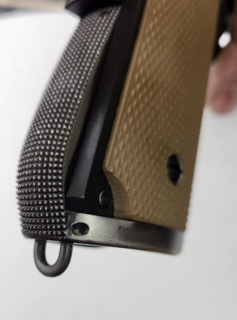

I swapped in a Smith & Alexander arched mainspring housing/mag guide from one of my .45's. Recent attempts to contact S&A for a new one have been met with dead air. I've got a gunsmith friend a little bit closer trying to determine if the aging proprietor has closed the business, or worse. I may have it Cera-Koted to match the pistol. . .or not. . .
I also ditched the T-15 Torx head grip screws in favor of Cera-Koted slot head from Wilson Combat. I DETEST needing specialized tools to disassemble, reassemble, or simply tighten things down!
SA9X19 7.jpeg (110.06 KiB) Viewed 3038 times
And yes Virginia, it has a lanyard loop. Not because I plan to use it, but because it helps me point out to the 2011 guys that their new Wunder-Pistole is just a 115 year old mechanism designed with heavy input from the U.S. Cavalry with a fat grip. Yes, we have thousand-lumen flashlights and electronic sights bolted on, but ROOTS BABY! :mrgreen:

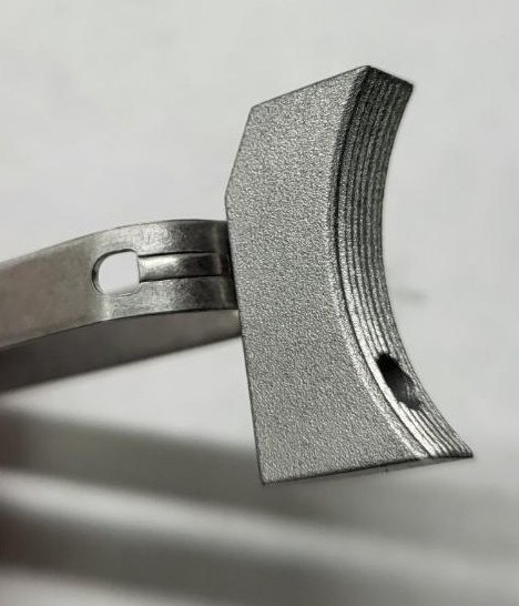

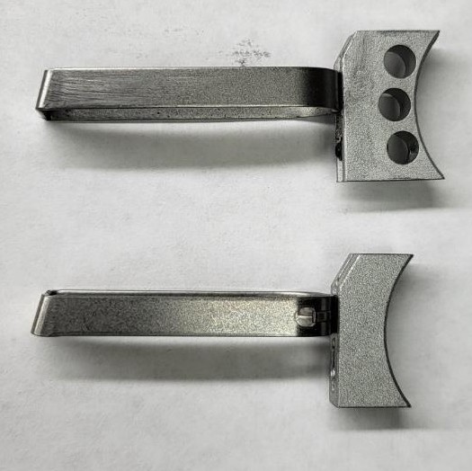

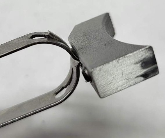

Pre-travel tabs that allow you to reduce the amount of take-up you experience before getting onto the actual trigger pull. . .
SA9X19 11.jpeg (37.98 KiB) Viewed 3033 times
Bending these forward has the effect of pushing the trigger rearward slightly in the frame. You don't want to take ALL the pre-travel out as that amounts to having your trigger partially pulled while at rest, but this feature, coupled with carefully stoning the top and bottom surfaces of the shoe so that it fits snugly inside the frame makes for a much more "polished" feel without the "GI slop" common to more hasty, generic assembly.

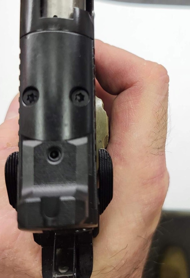

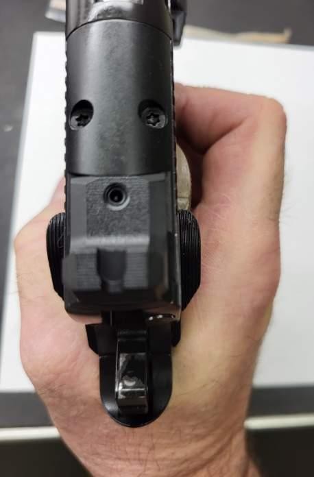

But here's why I like short triggers: One trick I learned in shooting and teaching others to shoot Glocks is to straighten the first joint of the index finger in from the pad, and try to make a 90-degree bend with the second joint. This does two things: (1.) it lets you pull the finger farther out of the triggerguard so that the palm-most end of the finger isn't rubbing against the frame, causing a right hander to push the gun left; (2.) it lets you pull the trigger more directly straight to the rear, again, reducing a right-hander's tendency to push the gun left.
Trigger finger contact on the "long" trigger:
SA9X19 5.jpeg (115.95 KiB) Viewed 3033 times
Versus trigger finger contact on the "short" trigger:
SA9X19 12.jpeg (35.75 KiB) Viewed 3033 times
I'm a 6'3" dude with large-ish hands and the short trigger is a better way to go. The Army got this right in 1924. I'm not sure why the industry insists on reversing it with most of their builds.

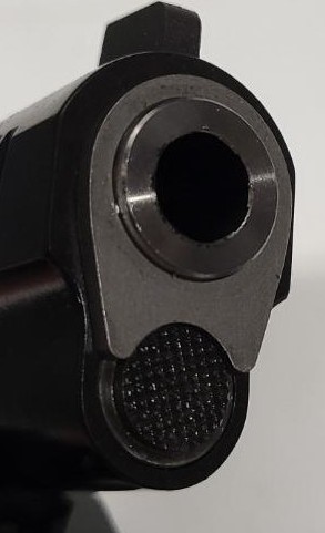

. . .you'll know that I love mocking people who come to me looking for the Allen wrench or paper clip they need to take their modern, "improved" 1911 apart. I get an equal kick out of those who upgrade those guns to a "tool-less" guide rod assembly. Yeah guys. We already had that one solved. . .IN 1911!
Cylinder & Slide makes a copy of the "True GI" spec recoil spring plug which has the stamped dimple cut allowing you to thread it on to the end of the spring to prevent launch and loss. Not that I feel I need it after 40+ years of taking this platform apart with much stronger .45-rated recoil springs than this gun's mild 11-pounder, but again, tradition/purist.

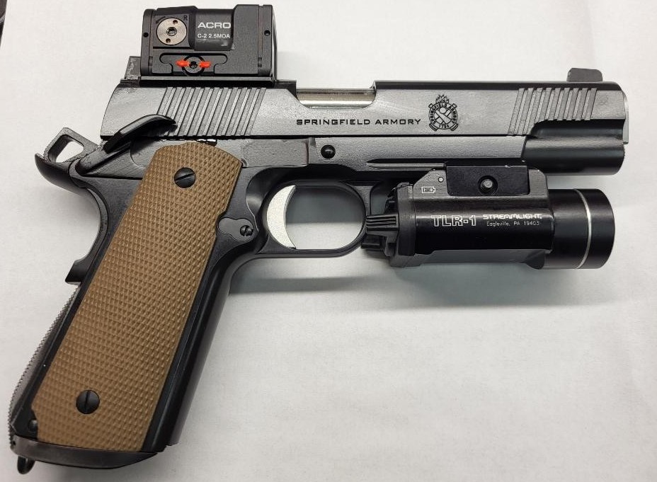

ON TO THE OPTIC!
SA9X19 19.jpeg (67.5 KiB) Viewed 3021 times

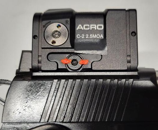

While I've been very happy with Holosuns for the last few years, I wanted to crash test an Aimpoint ACRO for the troops at work, and also wanted something a little more "NATO" than "People's Republic" on this heavily American pistol. The Aimpoint rifle optics have a reputaion of being "Marine-proof", plus Zee hasn't managed to break one in his "shoe store". Seemed like endorsement enough.
This is the new C2 version of the ACRO, which has a smaller 2.5MOA dot compared to the P2's 3.5. They're marketing it as a carbine optic, so it came with an AR-cowitness Picatinny mount (which I left in the box) and a set of flip-up lens covers (which I promptly took off). But they didn't charge extra for them compared to the P2, so no real grief there.
The Springfield/Agency Optic System mounting plate / rear backup iron sight combo zeroed correctly without any need to replace the OEM front sight. YAY!
Only two minor gripes with the optic. Number one gripe is that it uses a T-10 Torx bit to adjust windage and elevation. Trijicon knocked it out of the park with dials that will accept the rim of a 9mm or 5.56 case to turn them, but I REALLY don't like the fact that Trijicon puts their "plus" and "minus" brightness controls on opposite side of the optic, so Aimpoint for the win there. Number two gripe is that the top of the Aimpoint is rounded, not square. When you have disassembled and cleaned pistol sides for decades by resting them upside-down on their sights, having your slide roll over on it's rounded optic is a bit disconcerting. I expect I'll get used to it.
The finished package:
SA9X19 13.jpeg (131.81 KiB) Viewed 3021 times
So what we end up with is:
An all-steel gun that, with light and a full load, weighs about 54 ounces. . .
. . .it points like a 1911-A1, because it IS a 1911-A1, without the crappy ergonomics a double-stack mag forces upon you. . .
. . .in 9mm it doesn't hardly recoil at all. . .
. . .and with a dot has INSANELY fast recovery time.
I sent my older .45 version out to have it milled for a dot a few months back. My plan is to do some shot timer work for a truly apples-to-apples comparison of one cartridge versus the other. Should be some fun science!

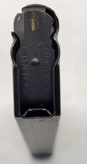

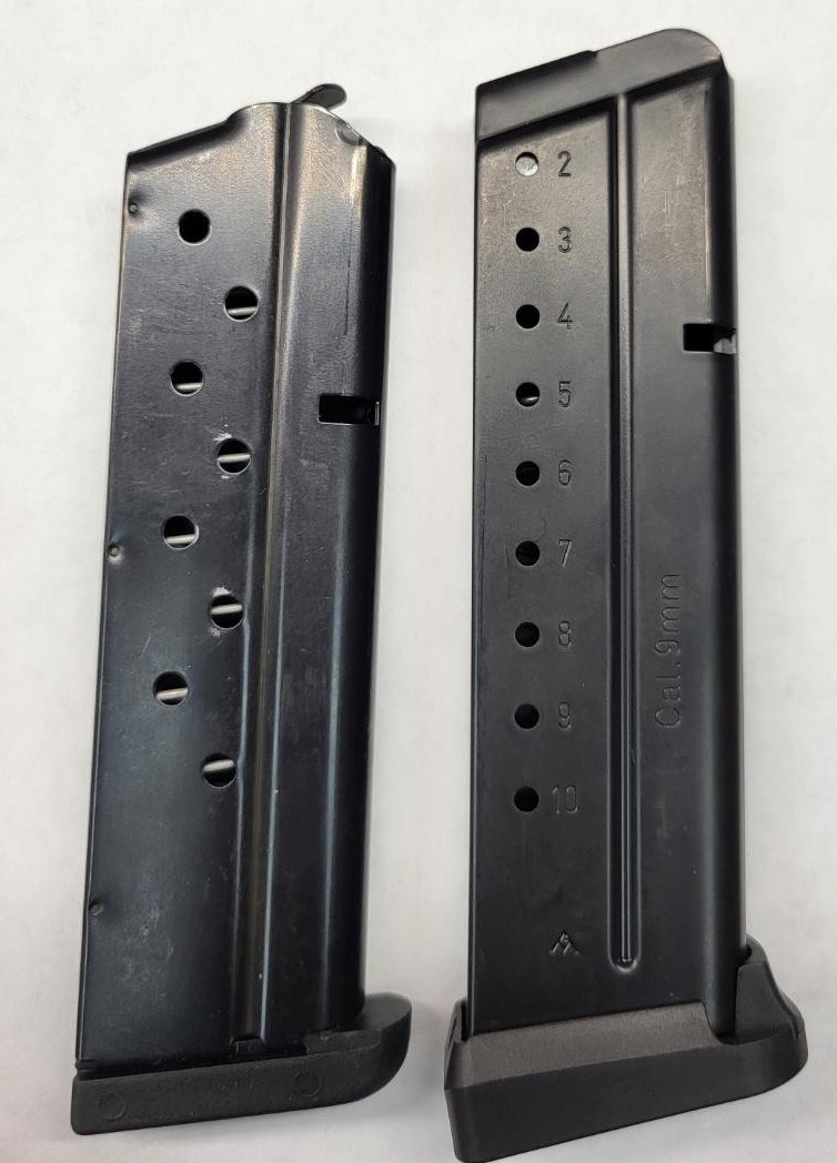

On kind of a neat side-bar - MAGAZINES!
SA9x19 15.jpeg (129.87 KiB) Viewed 3020 times

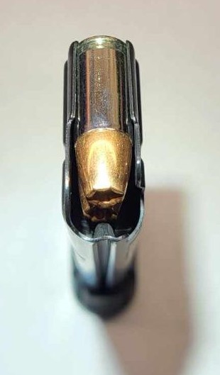

On left is the OEM Springfield 9-rounder, which is typical of most 9x19 1911 mags I've run across. On right is the 10-round Mec-Gar that I purchased a few of for this project.
Note the three dimples stamped in the rear edge of the Springfield. That's to help lock in the spacer insert that's installed to take up space in what is nominally a .45-sized mag body. Here's a top view of that insert:
SA9x19 16.jpeg (23.17 KiB) Viewed 3020 times
In contrast, here's how Mec-Gar does it:
SA919 17.jpeg (24.45 KiB) Viewed 3020 times
They stamp a groove along the front surface to shorten the interior volume, but the CLEVER bit is that they have rounded the top edge of that groove in order to make it act as an extension of the pistol's feed ramp, which in the case of Springfields, is extended and integral to the barrel, versus the original .45's 2-piece system where the frame is blended into the barrel. I had two failures to feed/fully lock up within the first 20 rounds of shooting this gun, which I chalk up to it being a new pistol with tight tolerances. Since then, I'm approaching a thousand rounds and it's been flawless with ball, duty HP, flat point "low lead emission" training rounds, and my cast flat point handloads.
As in Zee-Land, the Glocks will continue to be my workhorse, but this one was something of a cathartic a "need to do". Go figure. :?

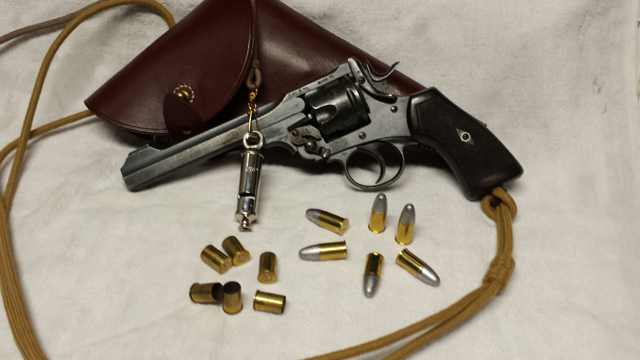

But. . .but. . .
Webley MK-VI.jpeg (959.92 KiB) Viewed 2977 times
. . .It goes with the cross-chest strap on my Sam Brown and swagger stick! :mrgreen:
Yeah. . .the Brits tended to wear their pistol lanyards across the chest and held them in place with their epaulets, which made for a lot less lanyard flopping around loose below the waist to hang up on stuff.
Certainly they made sense on a horse. They probably made sense crossing No Man's Land if you were unfortunate enough to go there without a rifle. Boarding parties crossing between boats? Maybe. At the point we start talking about retention in modern helicopters, I tend to think "not so much".
But the 1911 lanyard loop can be used in conjunction with a partially dropped mag to open beer bottles! Hopefully someone can find that great photo from the Korean War. . . :lol:
