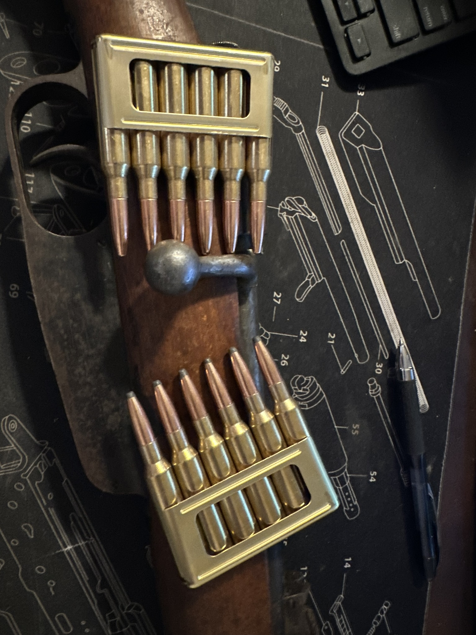

My plan is to JFK a deer with it this year

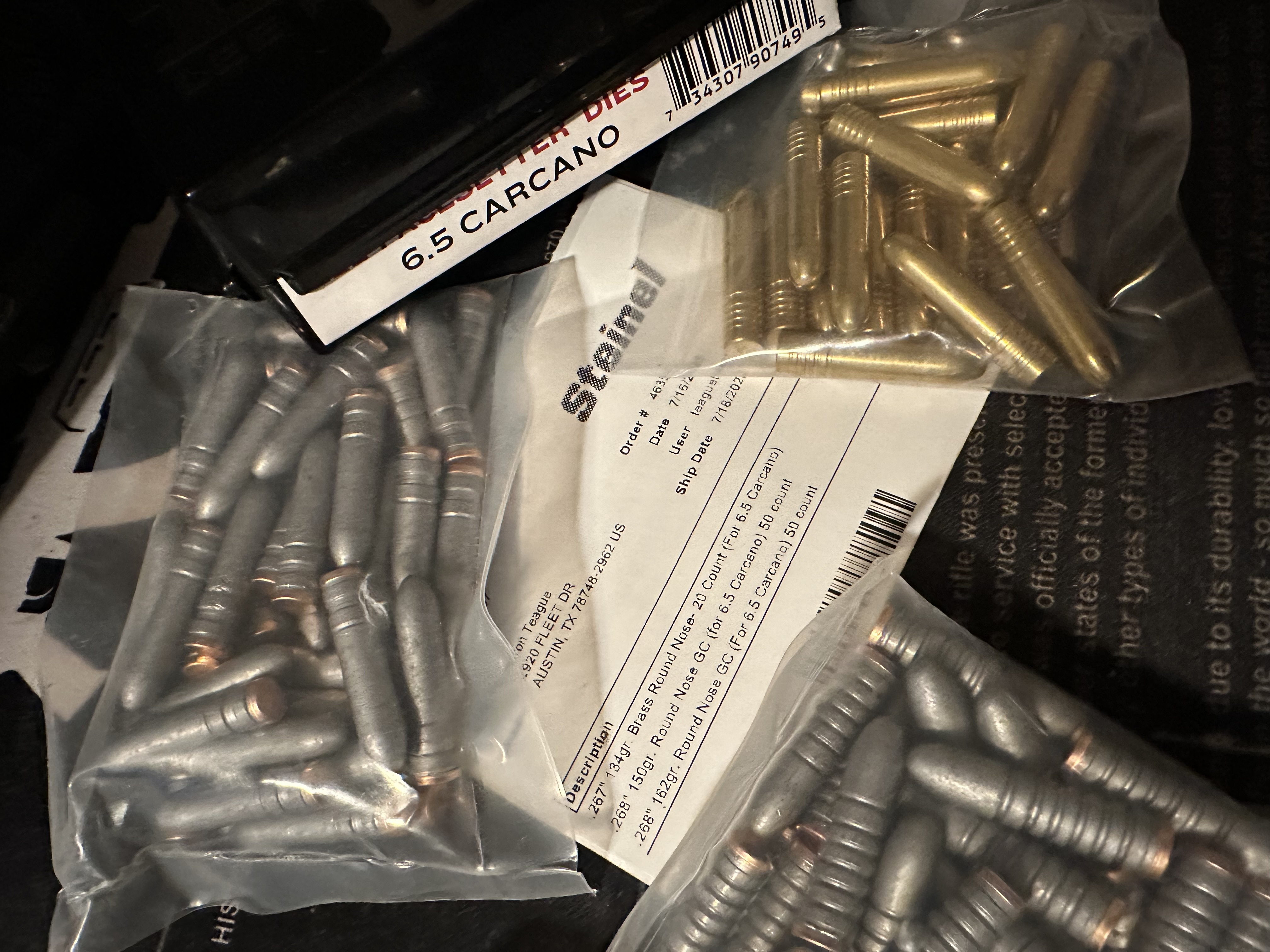

Btw, here are some of the components:

Those copper bullets are cool looking.

They are brass solids: https://www.steinelammo.com/product/267 ... 5-carcano/

Are they 6.5 cal as in fit a 6.5 Swede or some additional metrics involved? Not familiar with the Carcano.

https://www.steinelammo.com/product-cat ... s/bullets/
Re: 6.5 Carcano load data
Posted: Mon Jul 24, 2023 1:05 pm
Zee wrote: ↑Mon Jul 24, 2023 2:26 am Are they 6.5 cal as in fit a 6.5 Swede or some additional metrics involved? Not familiar with the Carcano.
The “6.5mm” for the Carcano is different from pretty much all the other 6.5s out there. Which is one of the reasons most people consider the Carcano to be inaccurate- because it’s normally shooting undersized bullets if you use the “wrong” 6.5 bullets.

by mitdr774
If memory is correct the Hornady 6.5 bullets for the Carcano are a .267" diameter compared to the normal .264" diameter used by probably every other 6.5 cartridge. I do not know if Hornady still produces that bullet though.

Reloading used to be complicated, as 6.5 Carcano is not the same as 6.5 Sweedish. I think Carcano bullets are slightly larger than the World's 6.5. Purpose built 6.5 Carcano bullets may be obtainable but weren't a few years ago, Of course lead bullets can make the bore diameter, but who wants to shoot lead bullets.

Hornaday occasionally makes the 267

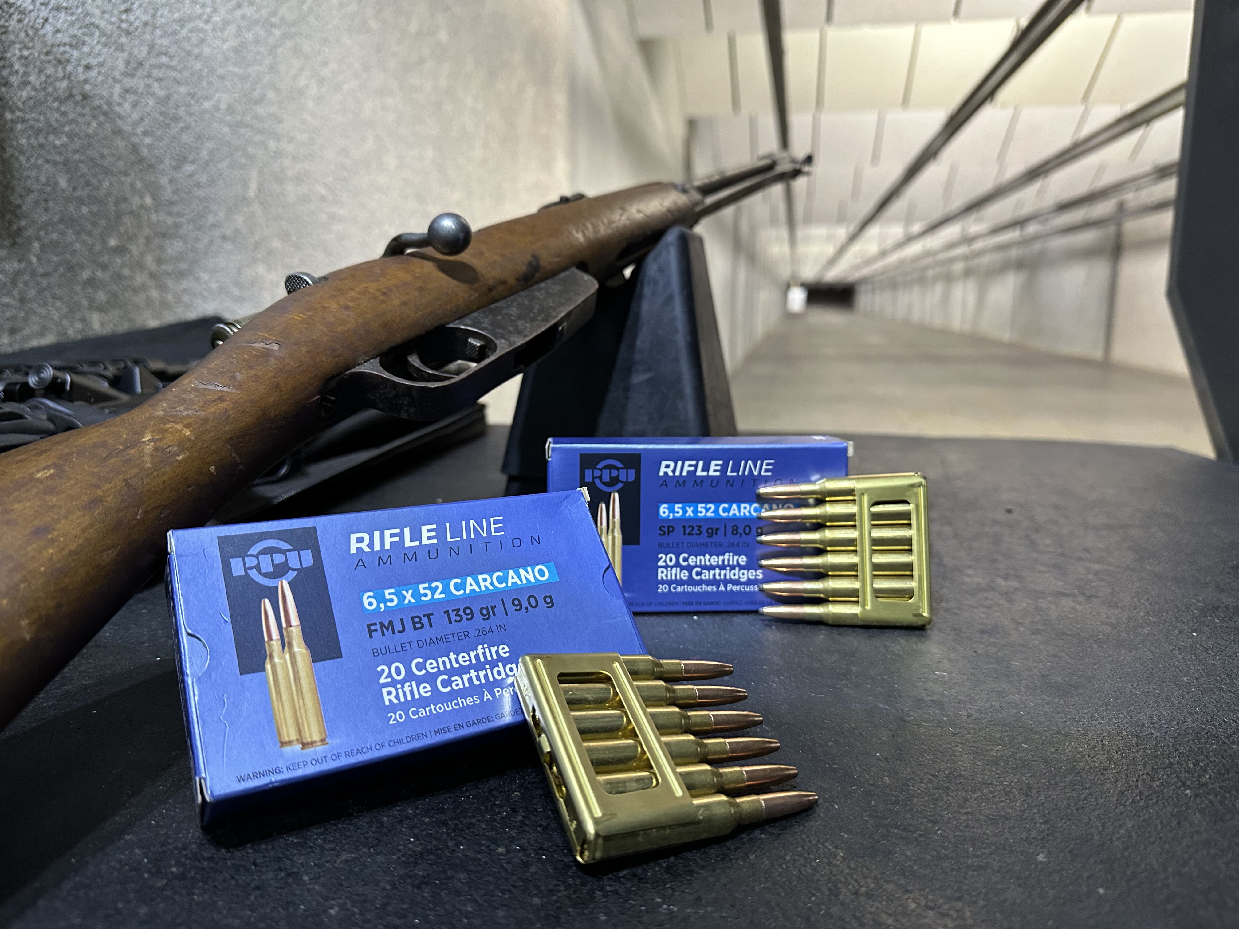

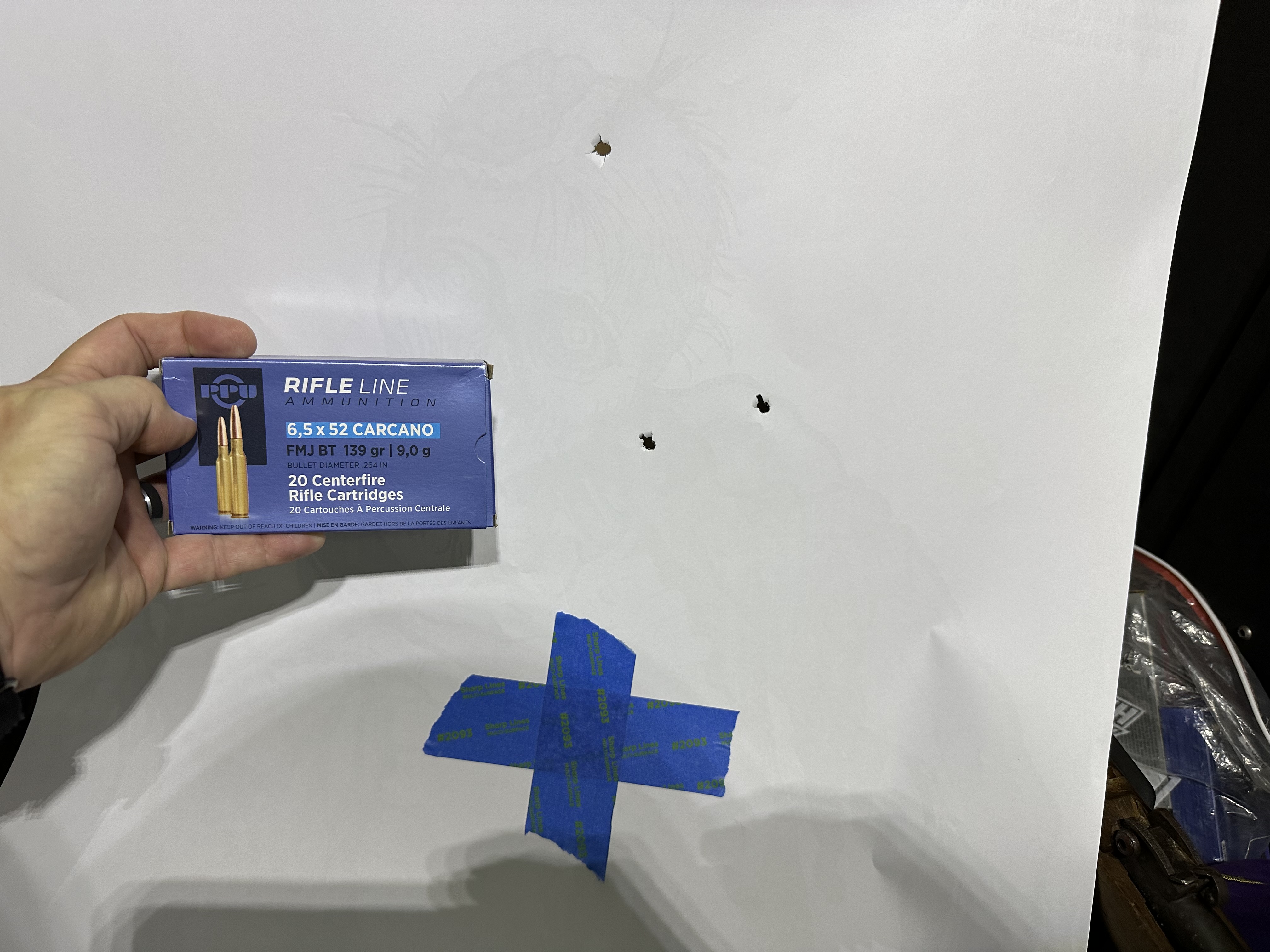

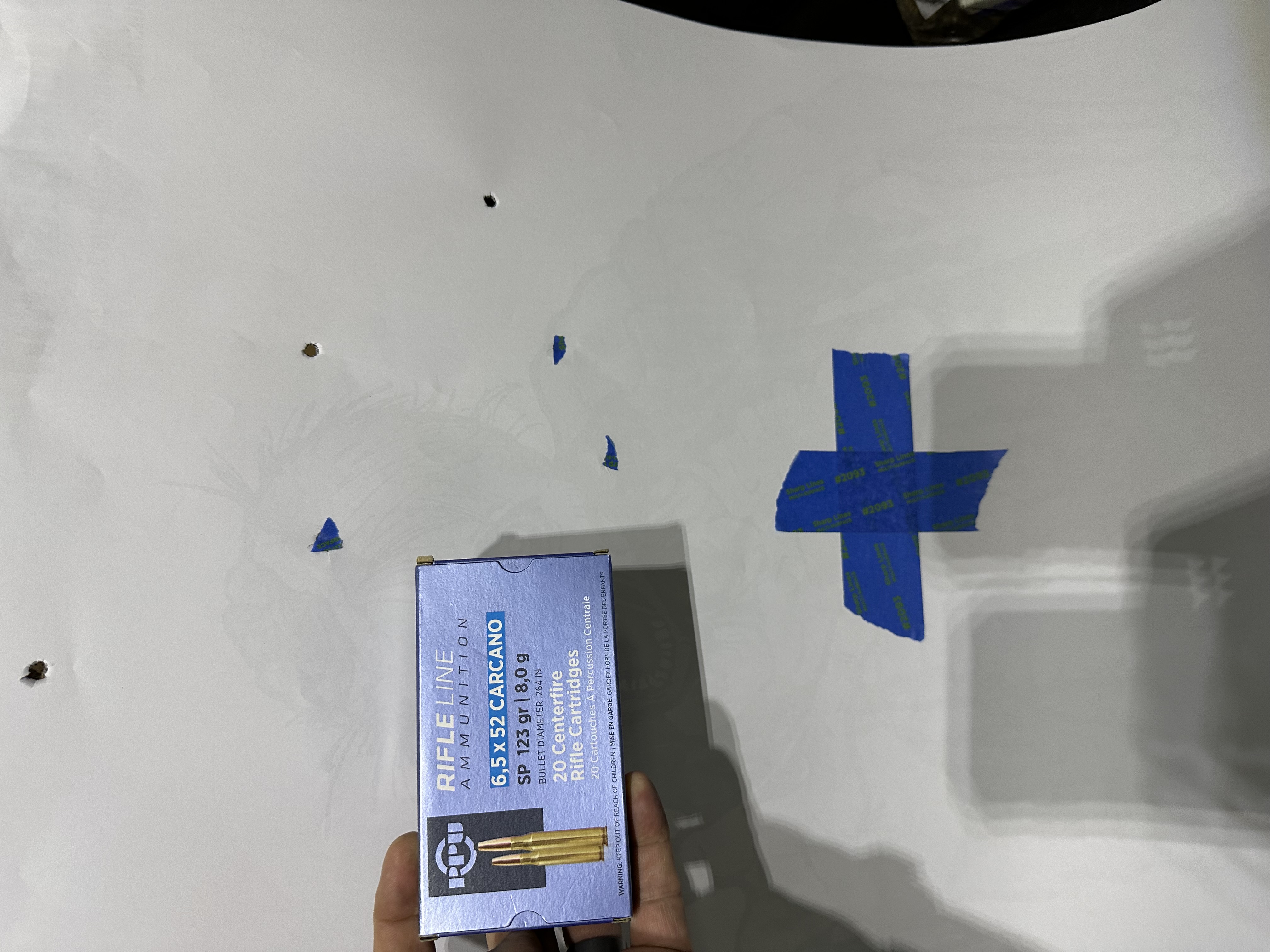

Finally was able to get the Carcano out to the range!
Had the two PPU loadings available. A 139gr FMJ and a 123gr soft point.
Neither of them did well. Not hitting point of aim or making anything close to a group.
Both of these were at 50 yards. Yikes.
Time to start a couple of hand loads.
